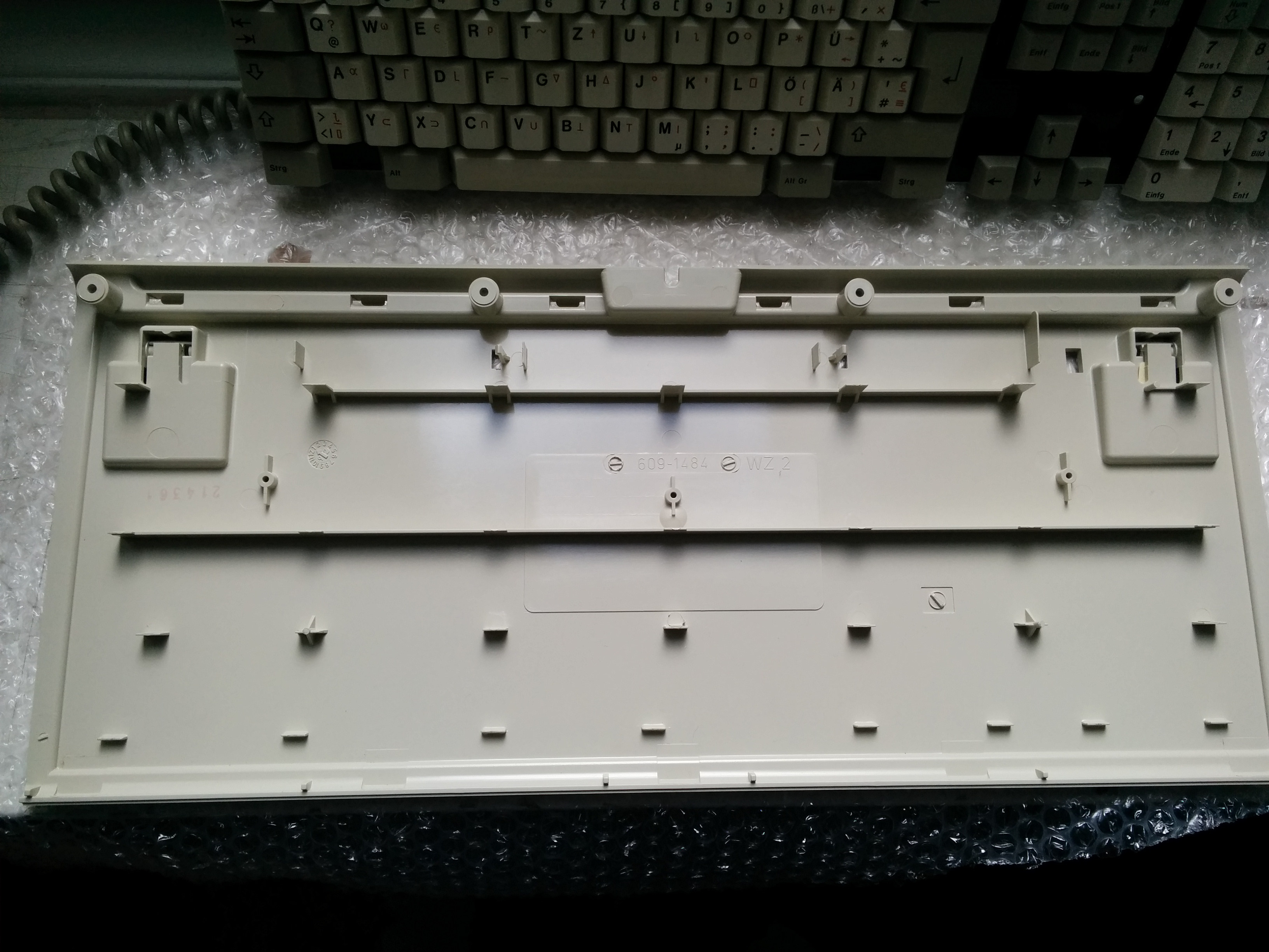

ok here's a nice little "problem" I have. I have this G80-3000 HAD which I use in this G81-1000 HBD case. Now the PCB flexes in the case uppon pressure on those plastic support rows (whatever they're called). This bothers me and I'm trying to come up with an idea to add more support so no flexing will occour. I really don't care what the solution looks like since it won't be visible.Of course the angle and hight of this support is imporatant. Ideas?

G81 metal backplate mod + foam under the backplate and between backplate and PCB. :)

right, I want to keep it simple though. A piece of plastic in the size of the PCB with some foam might be enough to kill the flexing. Or vertical pieces of plastic might do the trick.Not sure.

You would just have to fix it to the back of the PCB with bolts, and that would be much better than just plastic pieces I think. That would also add a lot of weight to the board, which is always good. :)

As ramnes said you could reuse the metal backplate of your G81-1000 and put it underneath the PCB with a isolating layer of some kind. The case will be a little bit harder to close then but it should be doable. Similar to this mod: https://geekhack.org/index.php?topic=13165.0

Some strategically placed drops of hot glue might do the trick. Build it up to the required height, and as it is still warm put the PCB in, it should conform nicely!

With the extra thickness, he could shave down the plastic ribs and posts to accommodate and still get the benefit of the metal backplate.
Also, stupid-fast support: cut a glue stick, leave it a little bit long. Melt the end with a lighter for 15 seconds or so and stick it in place. Melt the other end with lighters (you want to rotate so as not to get burned, they get hot) until it's the right height. Glue sticks aren't terribly sturdy, but at about 1 cm in diameter, they make up in bulk what they lack in stiffness.

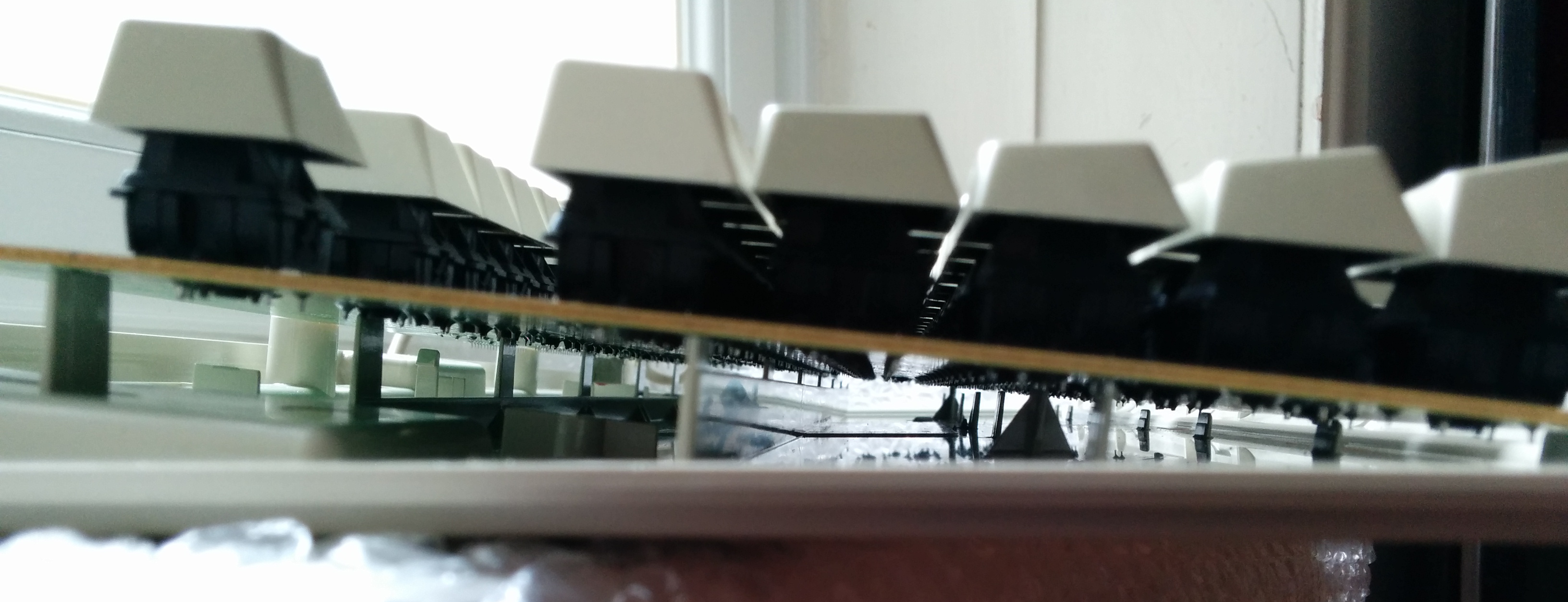

Looks like I'll have to do some shaving since the case won't snap in on the front:
this little bugger is in the way or I could simply place the plate a bit higher.
It's a friggin FAIL at this point. But I'm not giving up yet.

Desolder and bridge the DIP switch!
03 May 2015, 16:23
Well either shaving or moving that DIP switch, I'm not doing both. The MX blacks feel great on that plate by the way. The problem with shaving is doing so evenly.

seebart wrote: Looks like I'll have to do some shaving since the case won't snap in on the front:
Something like this will make short work of the rib trimming job: http://www.amazon.com/Channellock-358-8 ... B00004SBD8
