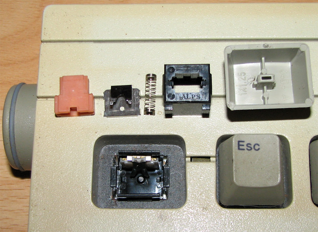

So I was right. Ripster, there's something I noticed in person that I didn't notice in your picture before (but I do now). The spring for orange is differently colored than the spring for pinks- one is a bronze color and one is a silver color. Any idea why that is?
Here are the pictures I took tonight.
So here's what I was right on: Orange ALPS do have a larger back plate. It isn't gray like with white/blue, though.
Pinks have the ALPS logo on the top, while the oranges do not.
The bottom has one difference. Pink on the left.
The orange and pink sliders are the same, but, they do come from different molds! The sprue mark is on the front of the orange slider but on the back of the pink slider.
Springs. They are different color. Like I said, I don't know exactly what this means, I don't know much about metals.
Here are the back plates inside of the switches.
I feel a lot better now. I had read somewhere that Pinks were more saught after than Oranges, and, that they felt better. Yet every person I had try both boards said they liked the Oranges more, including myself. So I'm not crazy. Oranges are to pinks what blues are to whites.

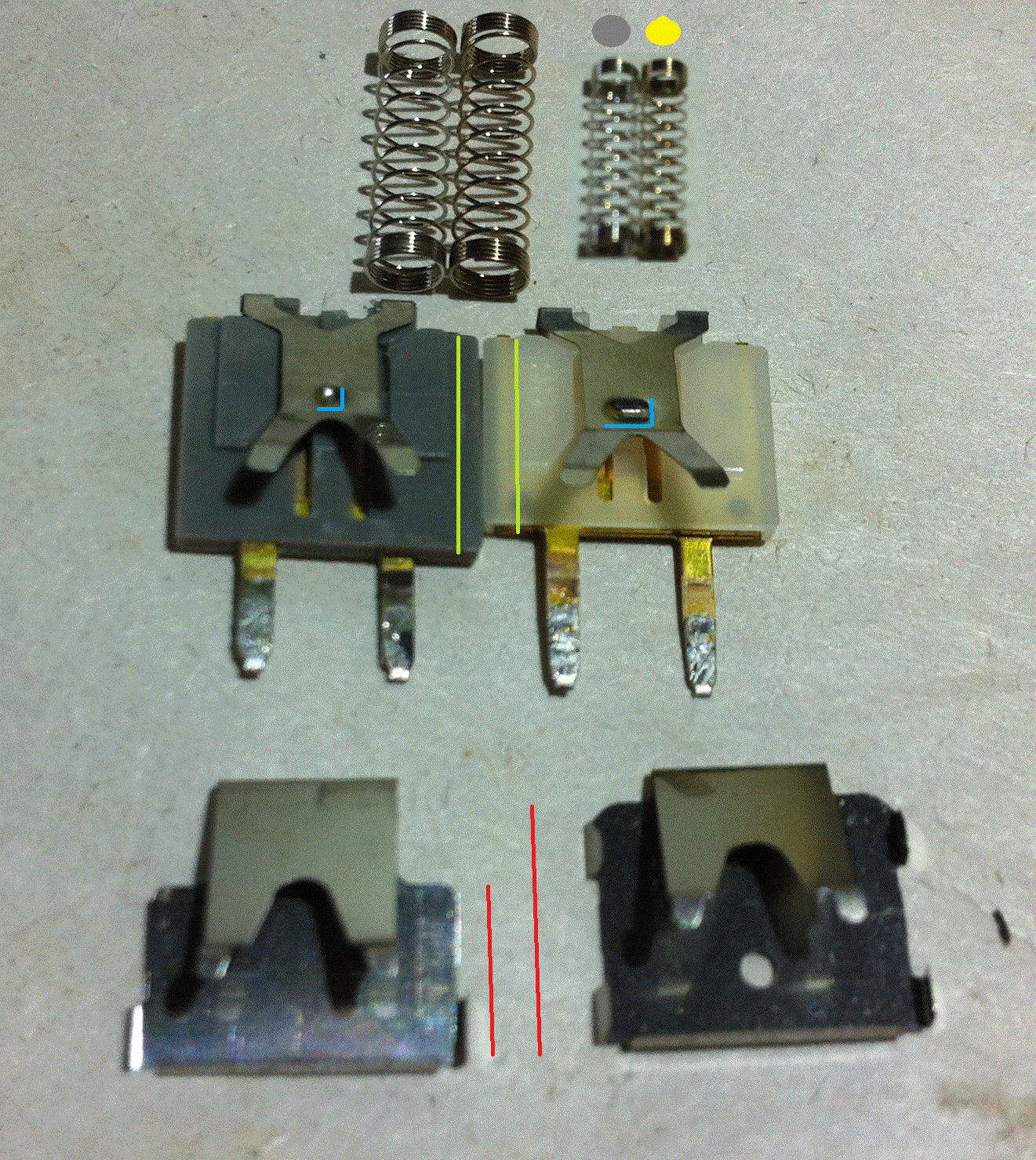

Hey, I am new to deskthority, but know most of you from geekhack. The orange ALPS can develop something that seems like clickiness but is actually not. The tactile metal gets pulled on the upstroke of the switch and pops back and forth to make a click that is unique (not like white alps). It is not what I would call true click, as it only happens on the upstroke and is due to damage/misformation of the switch and not meant to exist in that state.
My oranges have ALPS logo on the top, I will take one apart and compare photos with those posted here to see if there is actually multiple types of orange ALPS.
05 Oct 2011, 14:01
I noticed the same thing, you described it well. But only if you press the keys slowly, if I remember correctly. When I tapped the keys forcefully, there were less non-clicky clicks on the upstroke.
Clickey
08 Oct 2011, 22:22
Ok, I took a pic of pink vs blue alps, highlighting the differences. Pretty much the same differences as the orange vs pink (I thought my pinks were orange, because it really is not a true pink color, I think salmon is a better word too).
So if pinks are the worse version of orange, how do blacks fit in? They seem to be exactly the same as pinks, but I got rid of my AT101 so I can't compare. Anyone want to explain?
Blue on the left, pink on the right.
differences between Pink ALPS and Blue ALPS gif.gif (763.92 KiB) Viewed 24171 times
