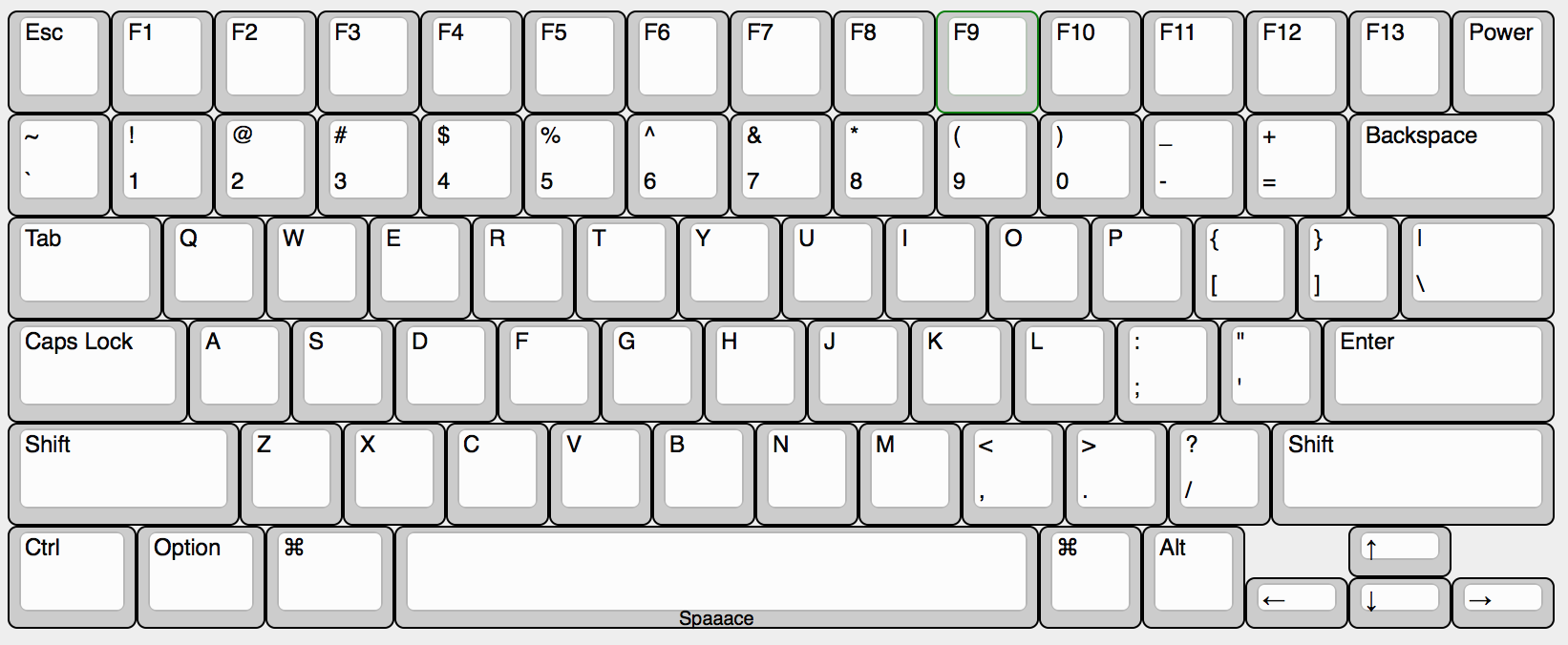

I just made a layout that is quite similar to hte keyboard I am using right now, but with small changes. A thing that really bothers me is that there are too many different key sizes on the one I am using. I fixed this and it looks far more appealing now.
Screenshot 2015-01-24 20.44.20.png (106.65 KiB) Viewed 3455 times

You can't get the arrow keys that small with Cherry MX switches.
The Matias company has made a special group order for enthusiasts for a keyboard that has almost that layout, except for the function keys. It uses Matias' own switches, which are clones of Alps switches for the bottom rows and arrow keys, but you could use Cherry MX for the keys on the other rows. I think the pre-order is ending soon, and I am afraid that it could take a while before it will be shipped.
http://matias.ca/60/pc/

An existing keyboard with a similar layout to yours but without the impossible arrow keys is the Noppoo Choc Mini: Image

I like those! I like them a lot, actually. Where can I get a matching PCB?
25 Jan 2015, 02:12
There's a similar board called the MX Mini that comes in DYI form. winkeyless.co.kr do (a variant of?) them. Here:
http://winkeyless.kr/en/?product=b-mini-pcb
These are restricted to the winkeyless firmware, as far as I know. It's fully configurable though, so you can choose the function of each key.
