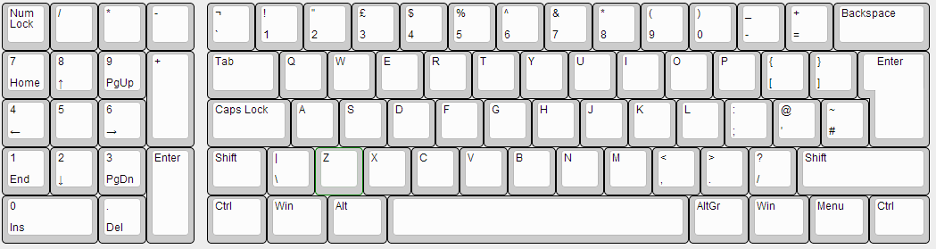

Hi so I want to first preface this with I am willing to spend a decent amount of money on a keyboard that meets my whole criteria but if it doesn't I wouldn't want to spend as much. That being said my budget would be up to ~$250 USD.
Here's what I'd like:
Least amount of input lag
Small for more room for my mouse pad
N-key rollover
Cherry Mx red switches (red or black)
I'm fine with ISO or ANSI.
This is kind of the ideal layout for what I'd want.
http://www.keyboard-layout-editor.com/# ... 0029ab6138

A left handed keyboard, eh? Take a look at this thread:
http://deskthority.net/keyboards-f2/lef ... t8528.html
I wonder what you're doing for arrow keys, though. Usually they're the last thing people like to chop off their custom layouts. And I don't see an Fn key for putting them on a layer, like the HHKB.

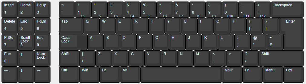

Thanks for the tip, I checked out that thread earlier the layouts there aren't exactly what I'd like. I did post on that thread showing a layout that would work for me, which I made from modifying scottc's post.
Here it is:
Also I'd like to point out that there are arrows on the standard numpad, if you don't have numlock activated you can use the arrow keys, home, page up/down, end, and delete then if you press it you have the numbers & period.
There have been some keyboards in the past that have allowed a layout similar to what I'd like but they have always had the arrow keys etc on the right side.
