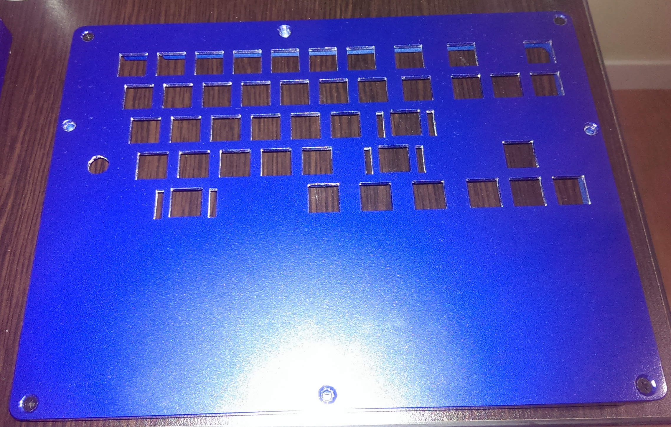

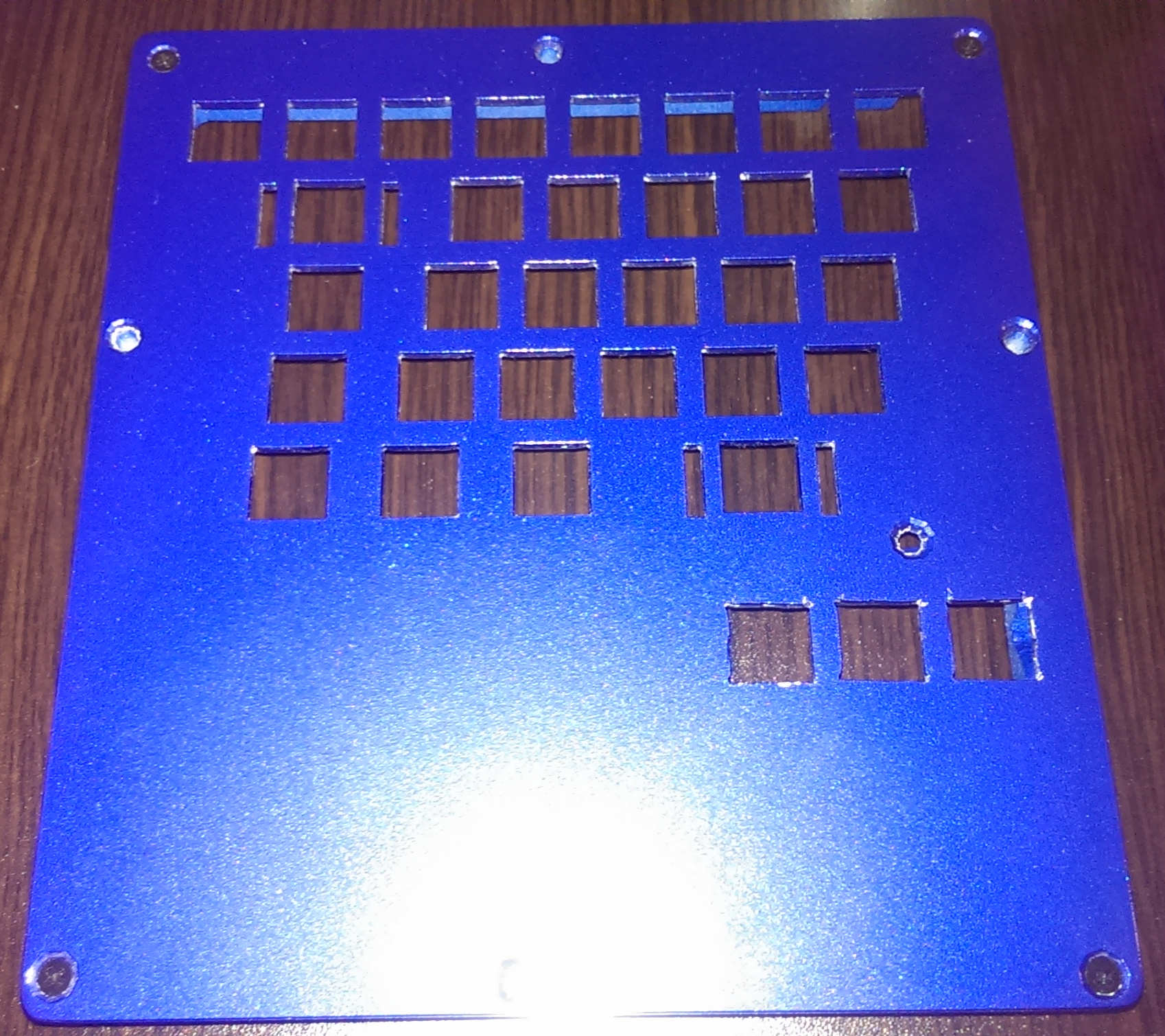

In terms of the material I went with a three layer setup very similar to Matt3o.
I got it all cut at Big Blue Saw and they did a great job. The top and bottom plate was cut out of 0.08 inch aluminum and the middle 0.375 aluminium

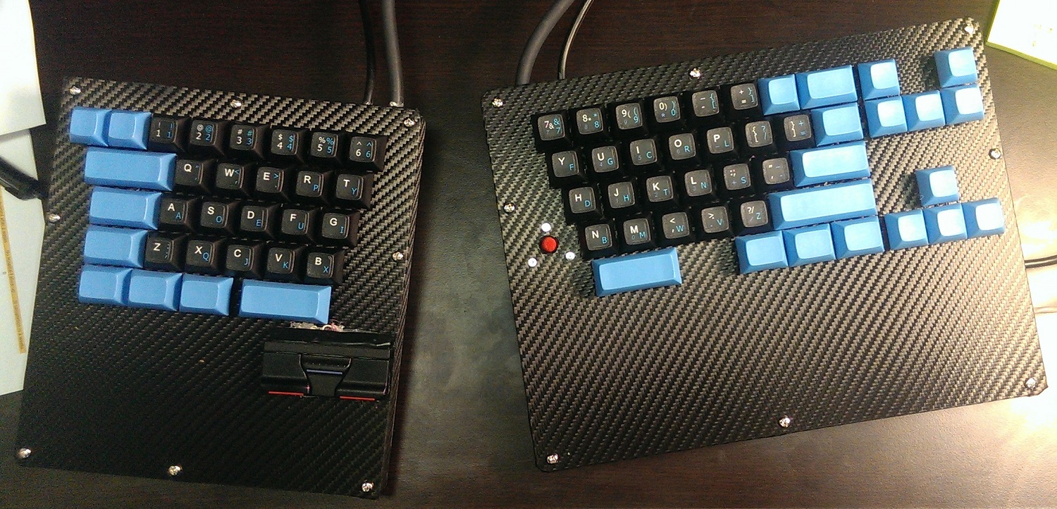

Well I got the new Teensy and put it in. I also wasnt happy with the finish so I got hold of some 3M carbon fiber and used that to cover the surface. Much happier with the finish now.
It works perfectly....... finally.
The only thing that is a little annoying is that I have to unplug and replug it in every now and again and I am not sure why. Both the keyboard and the mouse do this and just stop working until the replug.

Some final pictures with the new finish and you might get the nod!
I've had no stability issues with Soarer's firmware (and I use it in converter and controller forms for at least half all my typing) so I don't know what's biting you. Power perhaps? The only trouble I ever get from it is when I switch keyboards without unplugging USB first (sorry Soarer, I should know better) and then it's just stuck keys.

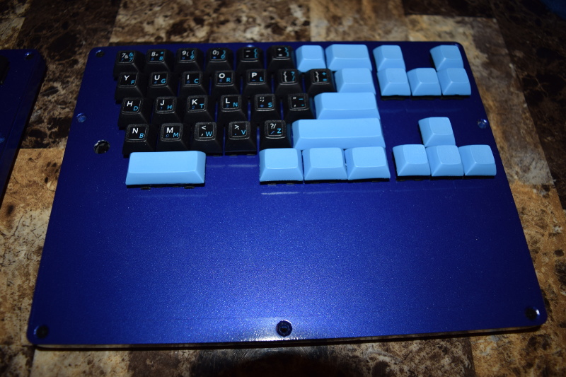

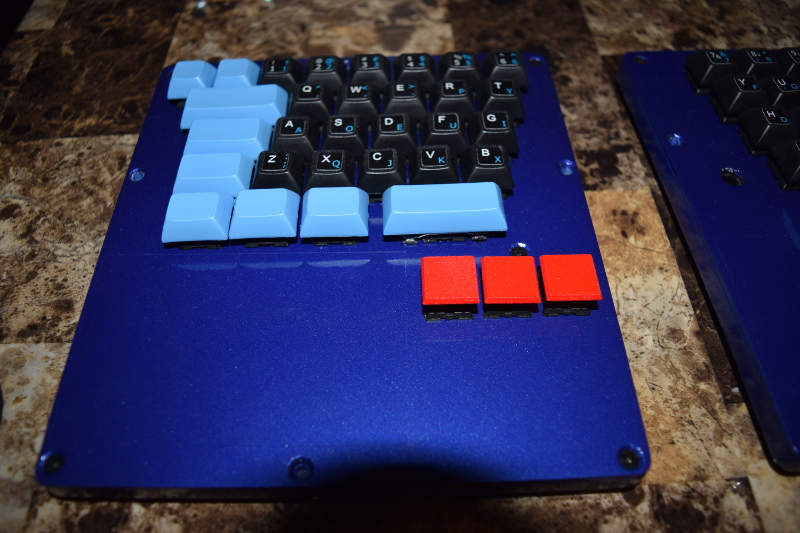

Well I just cant help myself. I took the original keyboard and decided to redesign it.
As Suka suggested, I got rid of the mousebuttons.
I also found that I had a problem with static electricity and the trackpoint. In particular the three screws holding in the trackpoint mounting bracket. So I countersunk the screws and used automotive filler to fill the gap. I also countersunk the edge screws and changed to nylon screws.
Finally, sprayed the entire case electron blue. This was done in the same way as your car, a lot of sanding, priming sanding, painting, clear coating polishing. I assumed that since I was painting aluminum the same principle as painting a car would apply.

Starting to finally get there. Got the firmware coded but waiting on some new pin connectors to make the internals wire up properly.
