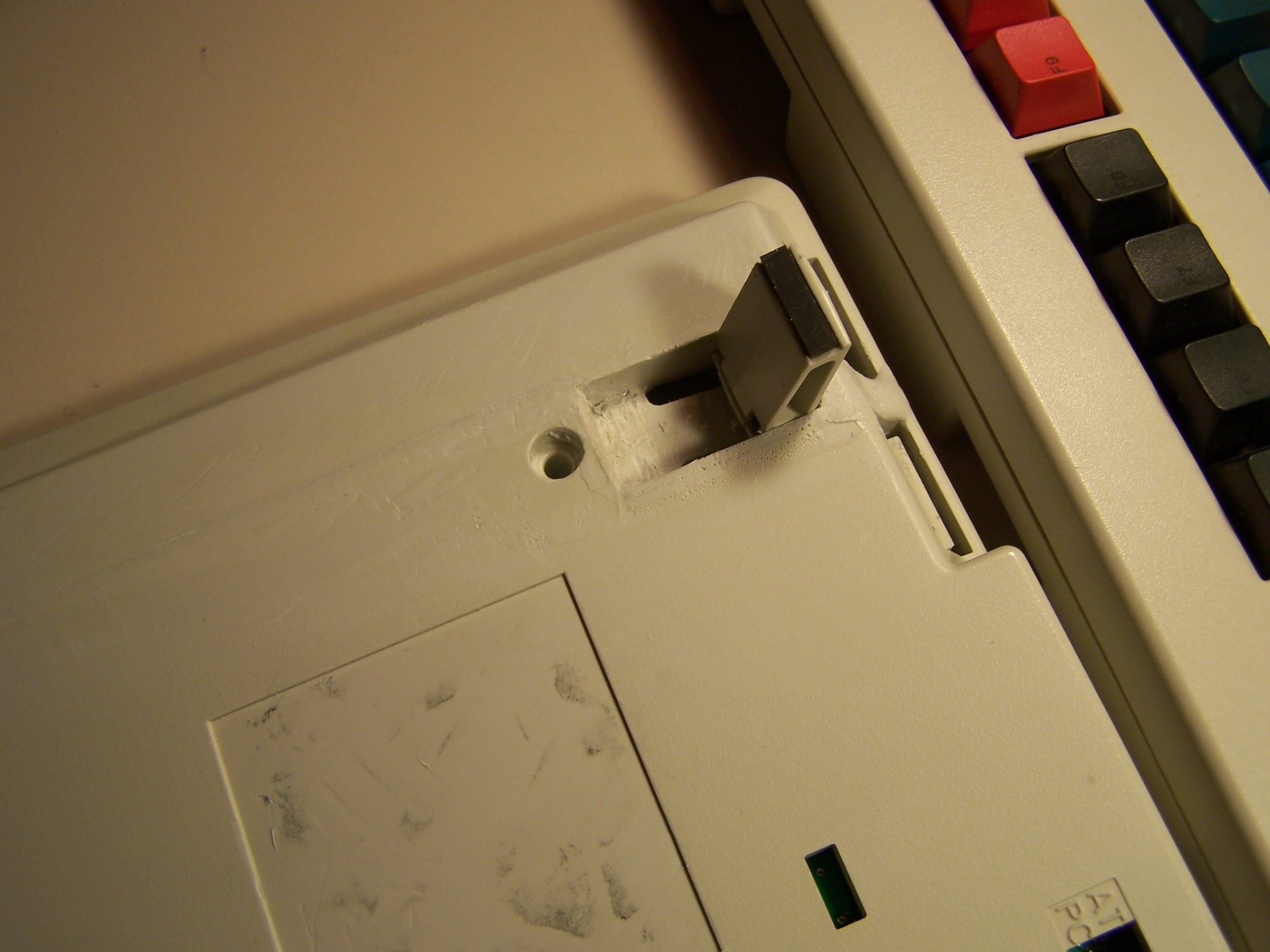

Heyho,
experimented some days ago with abs and acetone too :).
Like Findecanor said, using thin layers will prevent acetone bubbles to build up inside the drying abs. You can see the bubbles in the center of the filled arrow keyhole, after some sanding (wanted to use all the sludge I've got and applied it there in the end).
Inside the filled hole is another piece of the case. Being lazy, I didn't any cleaning on the case - quite surprising the piece that donated the abs chips (the strange looking thing in the upper left corner), combined really great with the case (you can push at it and fear breaking the part, but not ripping of the joint).
abs donor piece and filled hole (with another part of the case below the applied abs)
Dissolving the abs took about 30 minutes and applying the abs with a spoons handle (dipping it after each stroke in acetone allows you to create a smooth surface, since the sludge doesn't stick to the spoon for some time).
The main problem I'm seeing now, is how to remove unwanted material without sanding down some of the original case...

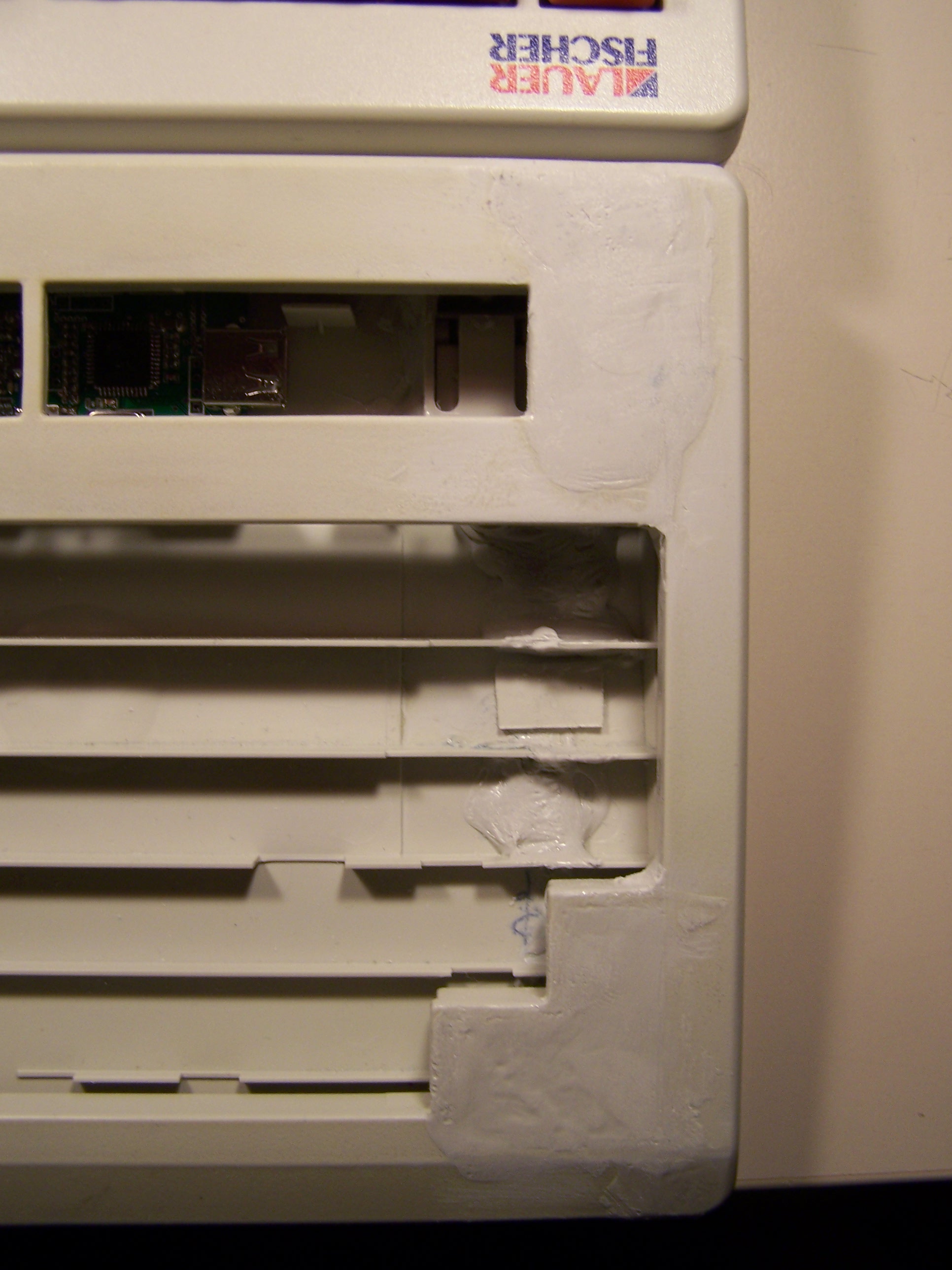

Well so far, so good. Did my first test with it.
Was surprised how easy it dissolves.. I read here and there that it might take a day to dissolve but it was more 30 minutes. At first I have cut the abs in really small bits but after that wasn't enough I just threw some bigger bits in and those dissolved really easy too.
Had a bit too much aceton so was left with a big layer of dissolved abs with a small layer of aceton on top of it.
The dissolved abs was/is very chewinggum like. Same feel to it and also sticks the same. Applied some with a spatula and was easy to do. Will see how the sanding goes :)
@imp I think if you sand it with a block that you'll get it flat without damaging the case.
Here is a pic of my first attempt:

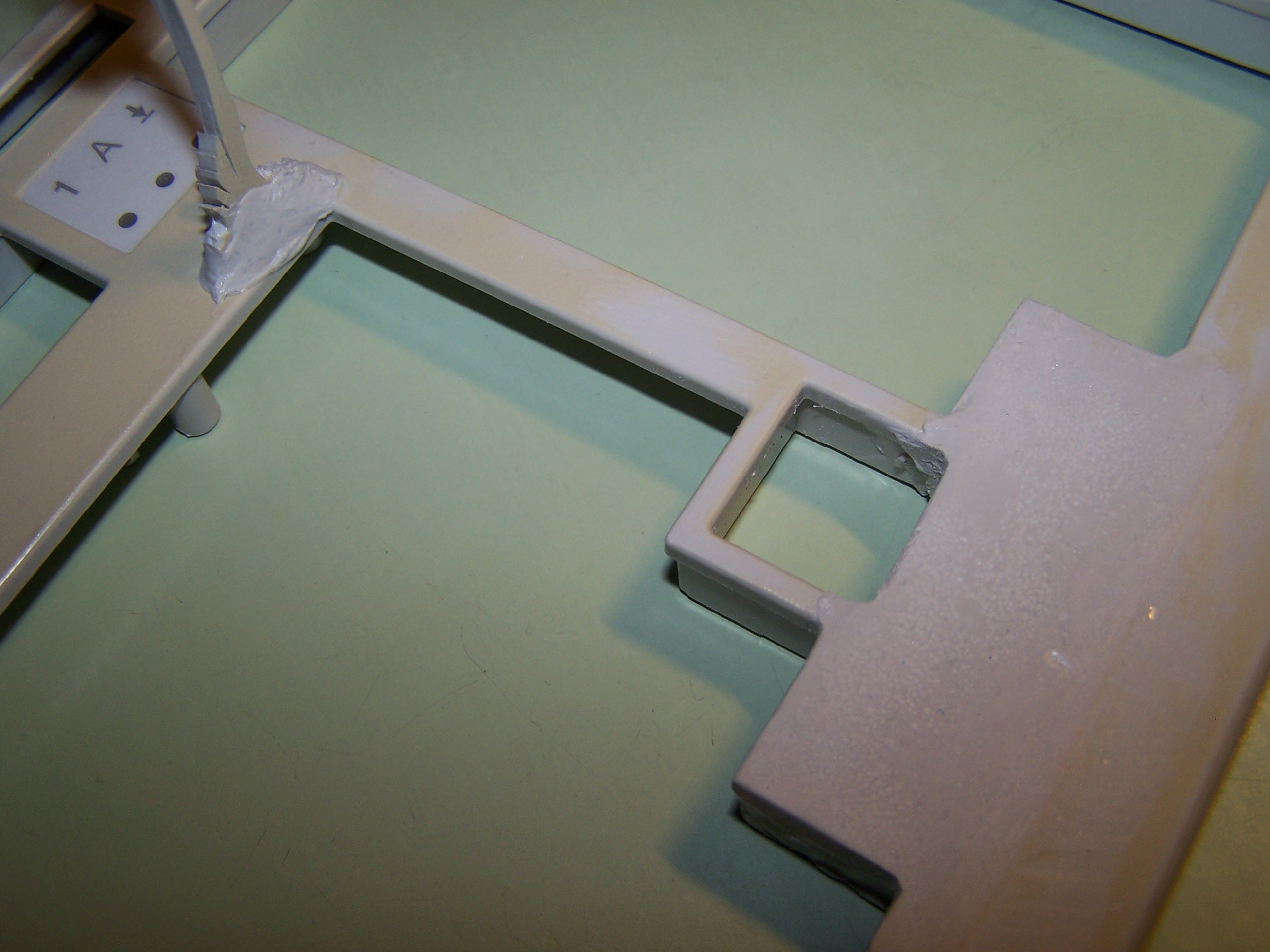

Here are my results after some work with a file:
re-attached side
re-attached side
case-leg
case-leg
Cutting the lower part of the case to keep the leg was imho the hardest part.
