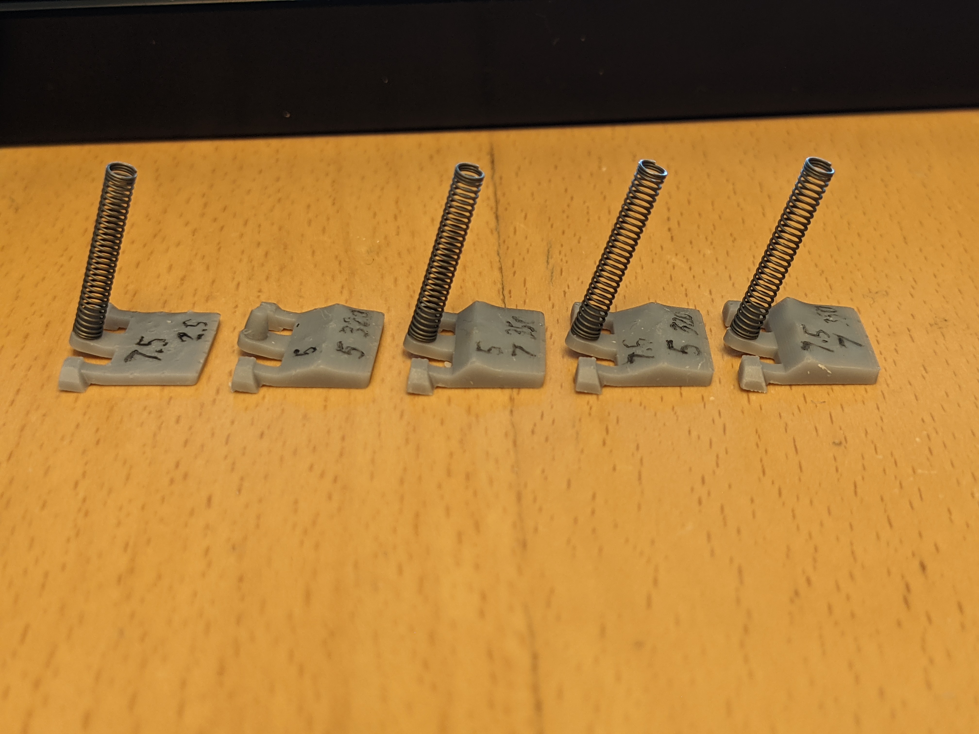

And so, I quickly designed some test flippers with varying degree of spring slant: 5 degree (varying spring support height), and 10 degree with default height.
Results: (flipper - actuation point)
5° - 3.5mm
5°+0.5mm - 2.75mm
5°+1mm - 2mm
5°+1.5mm - 1.5mm (fails to reset)
10° - 2mm
Somehow 5°+1mm feels crispier than 10°, and 5°+0.5mm even crispier - probably because the spring manages to store more energy before buckling, or there is such thing as too much pre-bending of the spring, so it buckles too readily - who knows!

..by experimenting with spring support length & angle I discovered a configuration which only clicks on the keypress - return trip is silent (unless you flick the key - this way stem hits the barrel on the way back with a pretty loud "thud" - but you need to be really intentional about it, even on medium-speed typing the rebound is pretty silent).
I also discovered a configuration that's nearly silent - but still tactile! (Also, turns out tactility is greatly hampered by 3D-printed surface roughness. Not only that - the key whistles as it moves, too
So I'm kinda ready to mold the switches - if there's anybody alive out there for a group buy.

Printed GINORMOUS 320mg and 350mg flippers:
Boy, do those SLAP! Checkmate!
I think it's because heavier flipper spends more time in flight, so spring has time to pump more energy into it (a = F/m, higher m -> lower a -> longer travel time).
Seems like 5-degree are slappier - also likely because of greater flipper impact energy: those activate deeper, so spring stores more energy at buckling time, resulting in greater force (which should result in flipper reaching the impact faster - but maybe total energy is still higher somehow - who knows..)
Also, 40-degree spring stand slope works, not worse than 45 - but should help with spring catching on the spring slide in assembly. Spring can still catch at the slope and not seat properly - Ellipse's keys not seating properly when spring is not totally vertical are likely exactly this problem: stem molds not being polished enough in the spring guide area, resulting in not smooth enough spring slide.
I found that pressing all the way down and then removing my finger tothe side has a good chance to reseat the spring properly - at least on my 3D-printed stems.
Tried to print couple solutions to aid re-seating - nothing worked so far, but I'm not out of ideas either.
