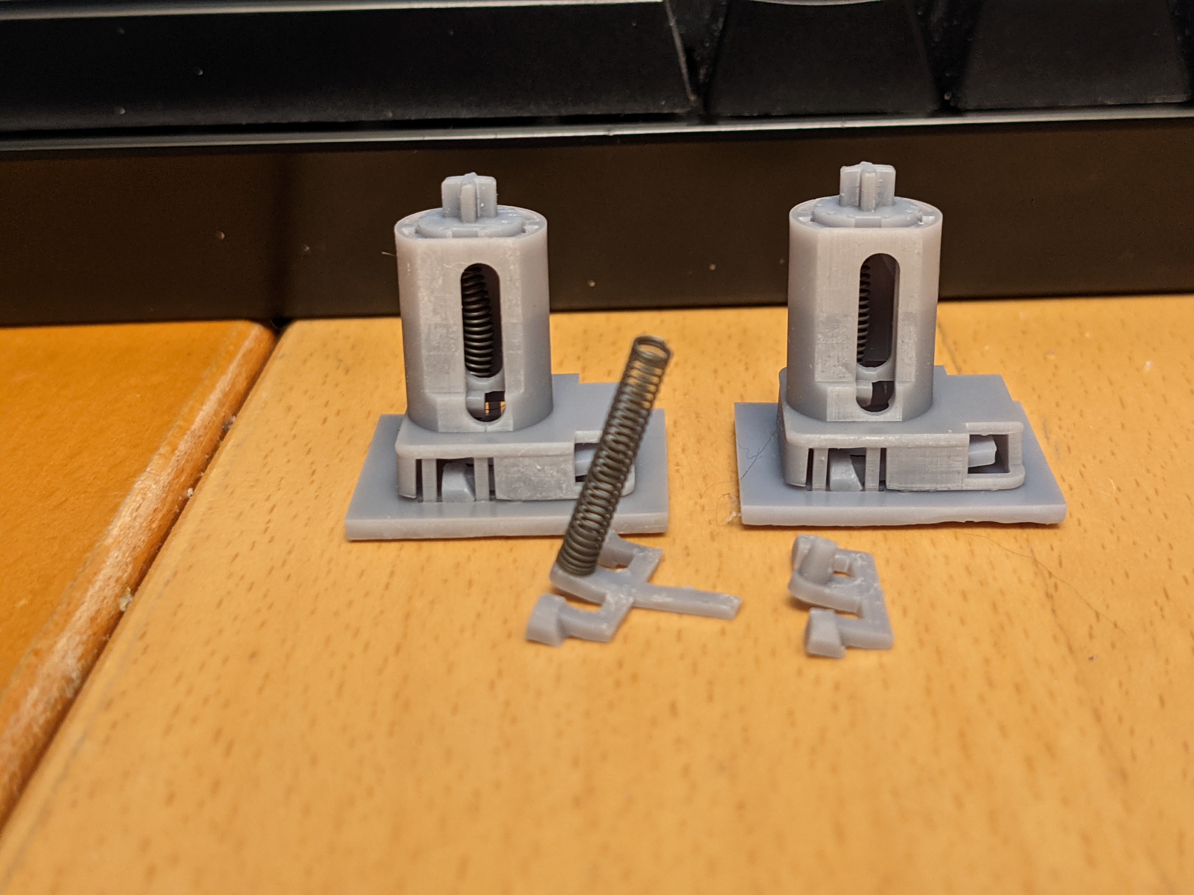

Printed!
It's moderately scratchy and moderately wobbly (kinda comparable to MX switches I have, may be tad more. Comparable to model F, actually).
It doesn't bind.
It doesn't click either. I mean it clicks outside of the barrel. It clicks when key is all the way down and flipper disturbed. The spring resets when key gets back up. It just doesn't click when fully assembled. Key travel is 3.8mm - but actuation is somehow even lower.
PS: Noticed a weird thing: assembled model F actuates at around 2mm travel, and original parts assembled on the table at around 3. Turns out, it does matter how spring is mounted: mounting spring in a correct position (see Fig. 1) produces initial incline (see Fig. 2) of about 5 degrees, which - together with initial ~2.5mm of compression pre-bends the spring, setting the direction of future buckling, as well as dictating it's future direction.
Interestingly, Brother flavor of buckling spring is mounted strictly vertically. And they buckle at ~3mm! Except Brother pre-compresses their spring 1mm more (and key stem end actually stops ~0.5mm below the flipper's bottom!) - so I'm kinda lucky my "improperly mounted model F" buckes at 3mm.
Also, Brother springs are essentially model M - so it looks like that extra 15 grams of force are coming solely from that extra 1mm of spring compression!

And so, I quickly designed some test flippers with varying degree of spring slant: 5 degree (varying spring support height), and 10 degree with default height.
Results: (flipper - actuation point)
5° - 3.5mm
5°+0.5mm - 2.75mm
5°+1mm - 2mm
5°+1.5mm - 1.5mm (fails to reset)
10° - 2mm
Somehow 5°+1mm feels crispier than 10°, and 5°+0.5mm even crispier - probably because the spring manages to store more energy before buckling, or there is such thing as too much pre-bending of the spring, so it buckles too readily - who knows!

..by experimenting with spring support length & angle I discovered a configuration which only clicks on the keypress - return trip is silent (unless you flick the key - this way stem hits the barrel on the way back with a pretty loud "thud" - but you need to be really intentional about it, even on medium-speed typing the rebound is pretty silent).
I also discovered a configuration that's nearly silent - but still tactile! (Also, turns out tactility is greatly hampered by 3D-printed surface roughness. Not only that - the key whistles as it moves, too

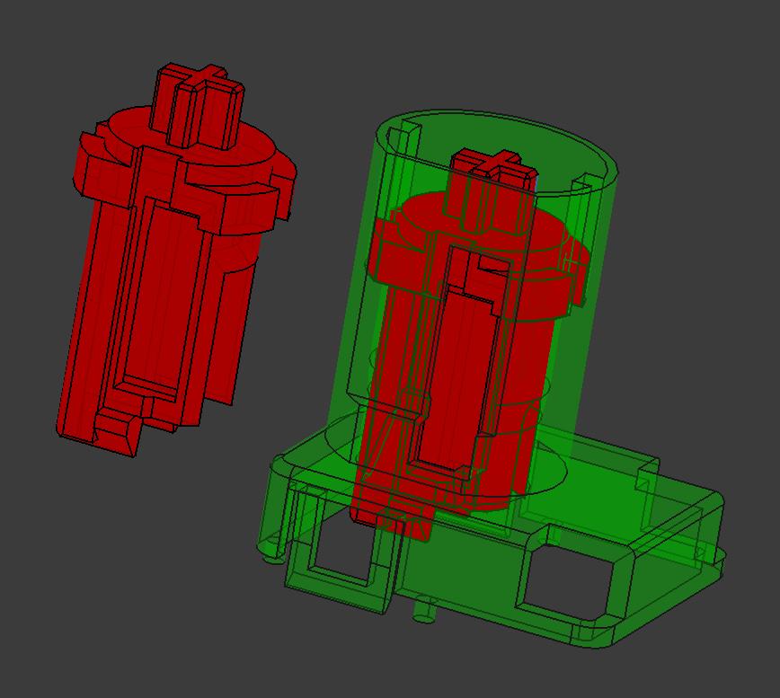

Today I remembered that with 3D printing one doesn't need to drill into things to see what's inside - can just punch a hole in the model itself and print.
So I now have a see-thru barrel and a see-thru stem.
Also I wanted to see what will happen if I make the spring rest angle sharper. Turns out, it becomes a momentary switch: the spring buckles, but there's not enough space - so it springs back as you press the key further. On the trip up, it produces another keypress.
Also I experimented with flipper size - thinner paddle, paddle so narrow it's a finger, and no paddle at all. Turns out, loudness of the click is kinda proportional to flipper mass - the heavier the flipper, the louder the click - while tactility is not affected at all. This paves the way for an office friendly model F, keeping all of the wonderful tactility (and supposed ergononic benefits with it), but having almost no click - with a single part change vs standard model! Also, EXTRA-THICC FLIPPERS for the extra-loud slaps!
(probably material also plays a role - ABS-like resin light flipper is 190mg, heavy is 220mg, and original model F one is 260mg and kind of disproportionately louder)
