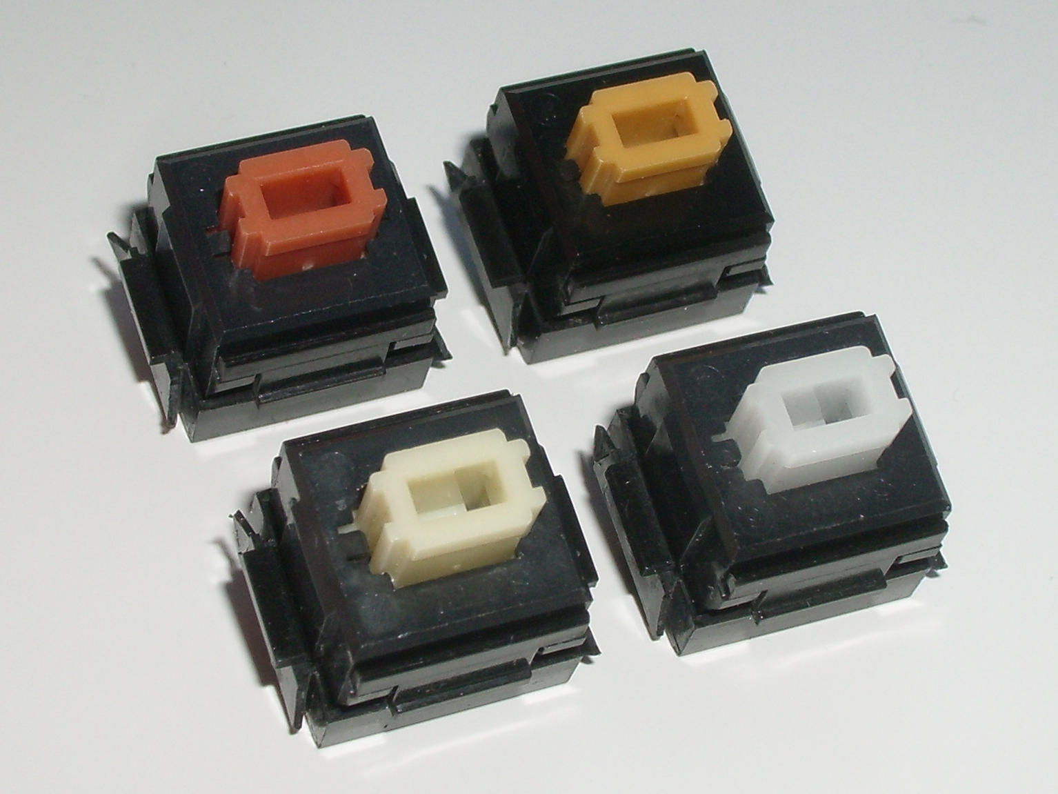

I got my "(NYC) taxi yellow" Alps switches in the post today!
This has prompted me to rename them from Alps SKCM Yellow to Alps SKCM Amber. The colour varies between switches, but overall it's a dull amber colour, rather than the pure yellow of linear Alps switches:
Alps orange-amber-cream-white colour comparison.jpg (152.4 KiB) Viewed 7106 times
Clockwise from top-left: [wiki]Alps SKCM Orange[/wiki], [wiki]Alps SKCM Amber[/wiki], [wiki]Alps SKCM White[/wiki], [wiki]Alps SKCM Cream Damped[/wiki].

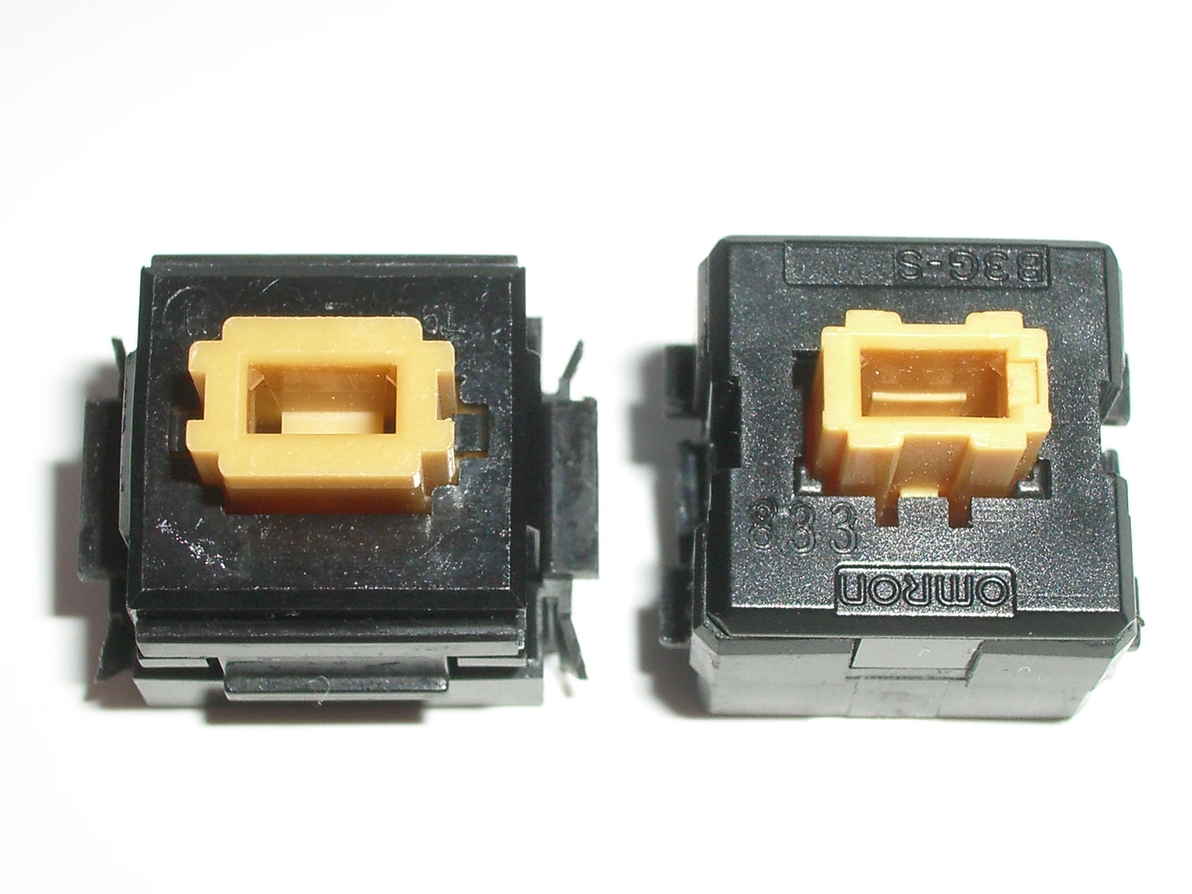

The colour is very similar to amber [wiki]Omron B3G-S series[/wiki] switches:
Amber Alps and Omron.jpg (211.02 KiB) Viewed 7106 times

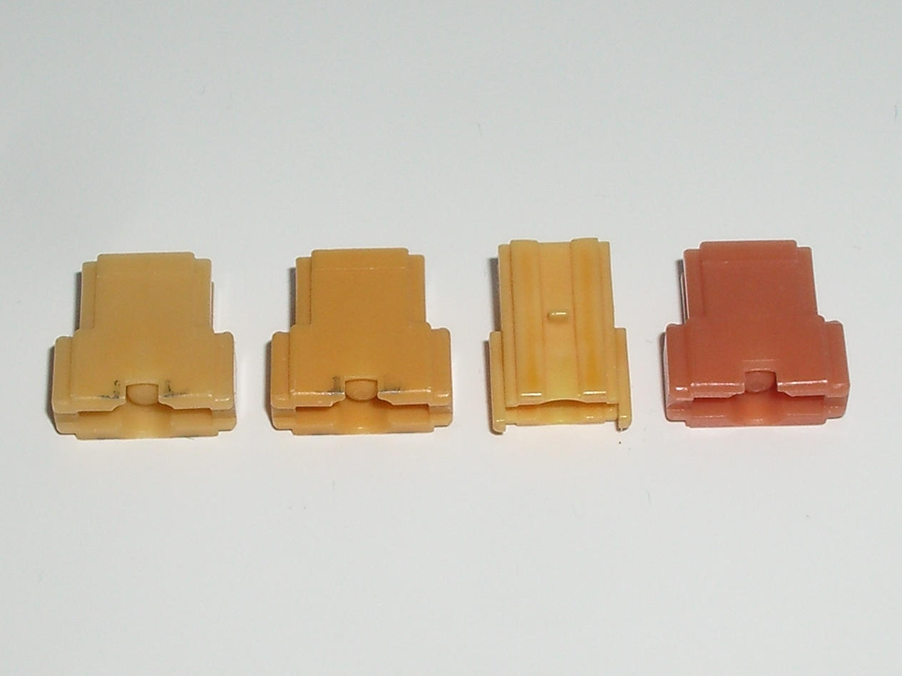

Slider comparison:
Amber and orange comparison.jpg (69.37 KiB) Viewed 7106 times
Two shades of amber Alps sliders; amber Omron B3G-S; orange Alps. My yellow Alps switches got shipped out today, so I'll have them to use as a colour comparison. (Note that there are also linear amber Alps switches — we don't know if they're the same as linear yellow Alps (i.e. change of pigment) or a different switch.)

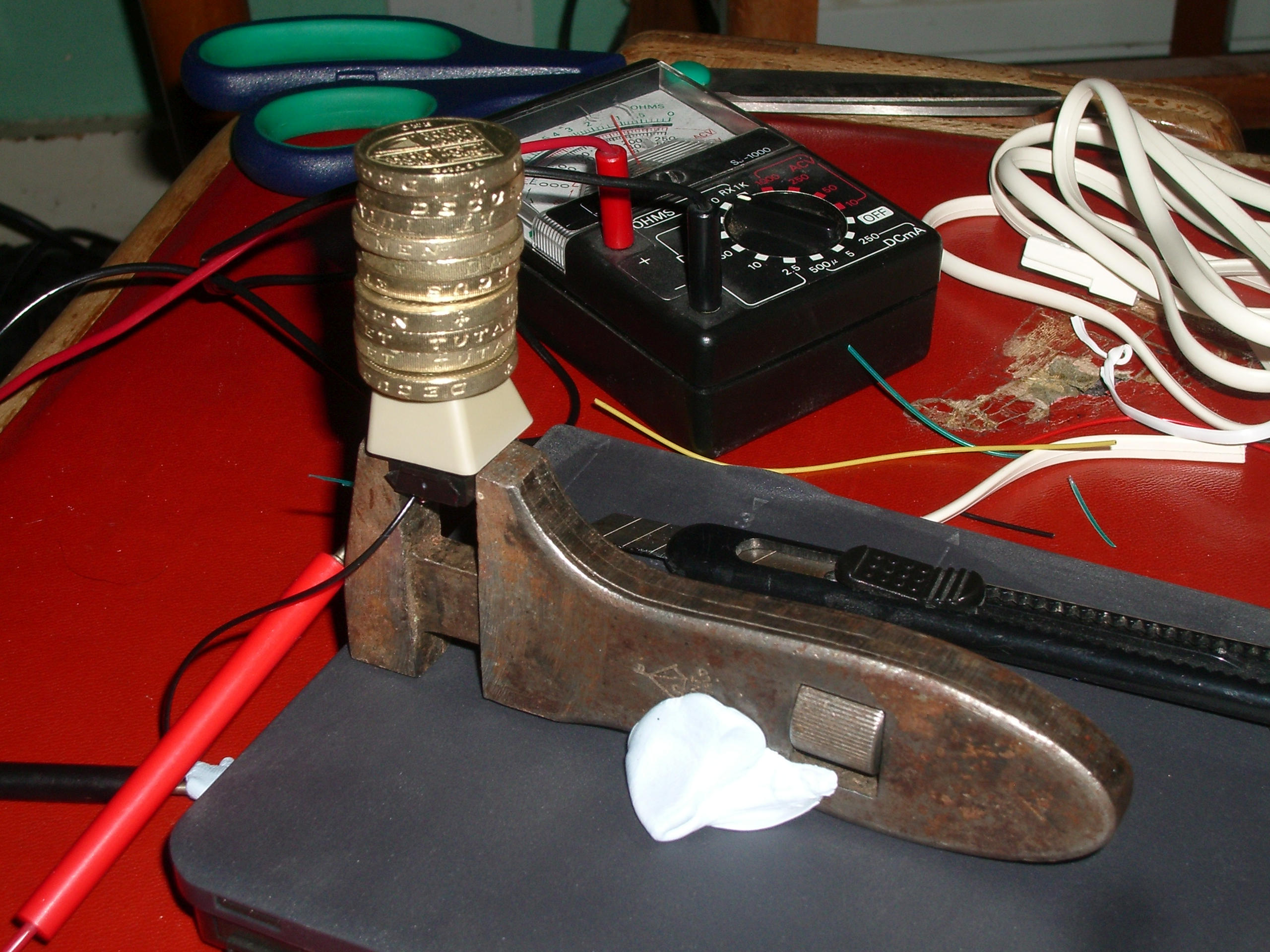

Somewhere between 83 and 97.5 g.

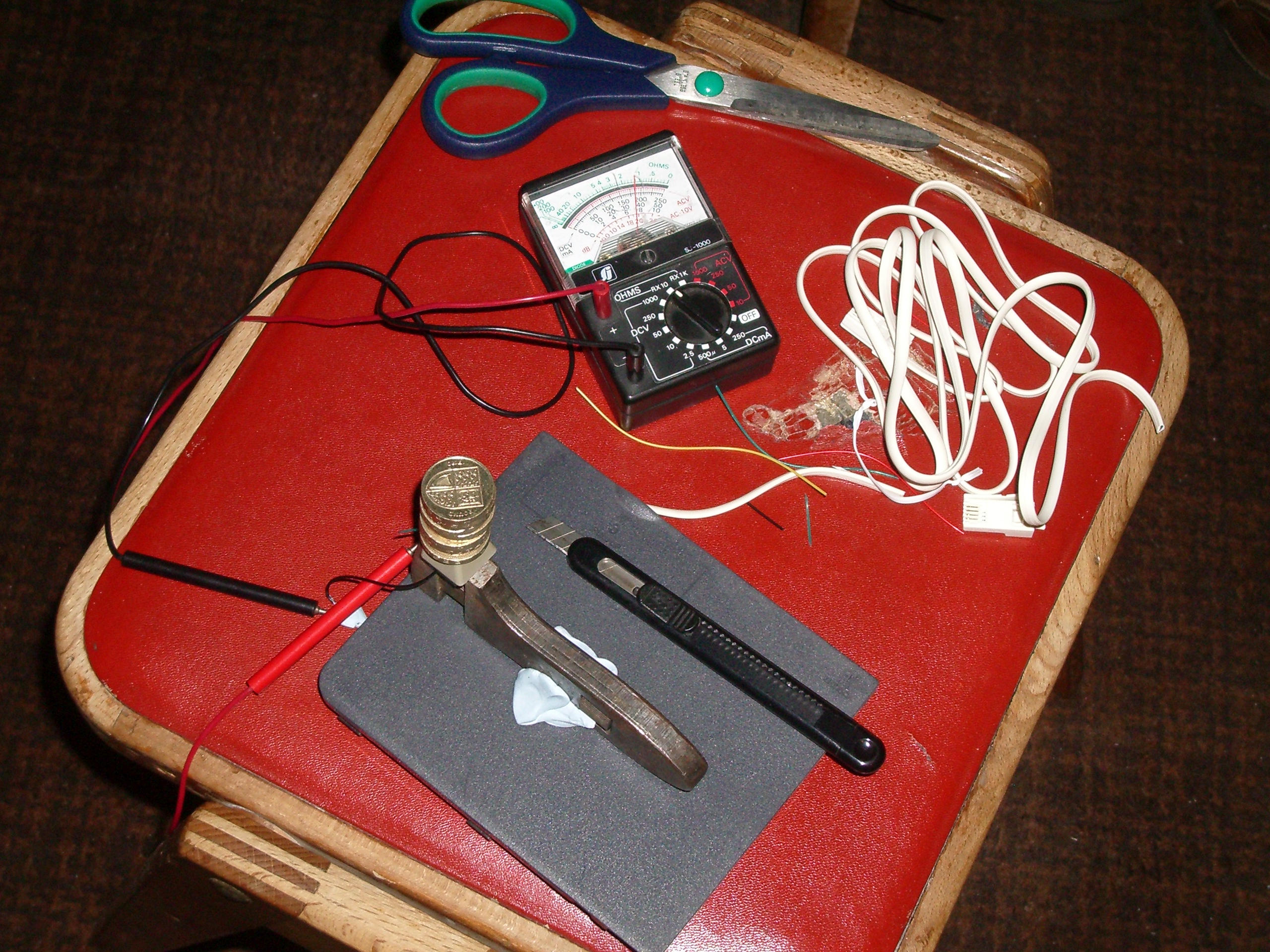

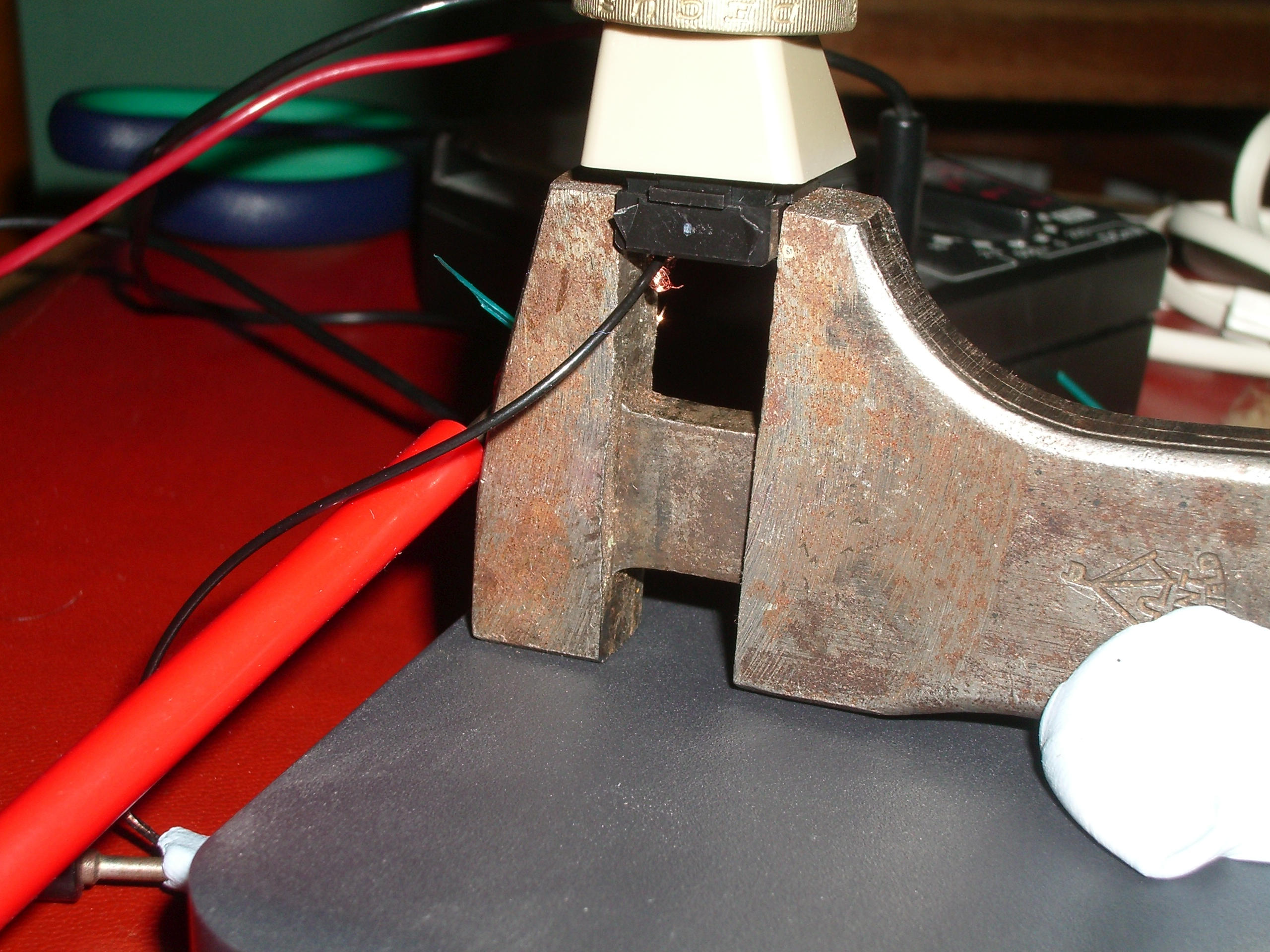

Behold!
The most ghetto attempt to measure force the world has ever seen!
Required (not including "tools"):
  • Analogue multimeter with probes
  • Adjustable spanner
  • BT telephone cable
  • Dead notebook battery
  • Blu-Tack
  • Every last 20 pence coin I've got, and since most of them are at work, I had to raid my interesting coins box for all my Guernsey, Jersey, Isle of Man and Gibraltar 20 p coins, and that was still only just enough

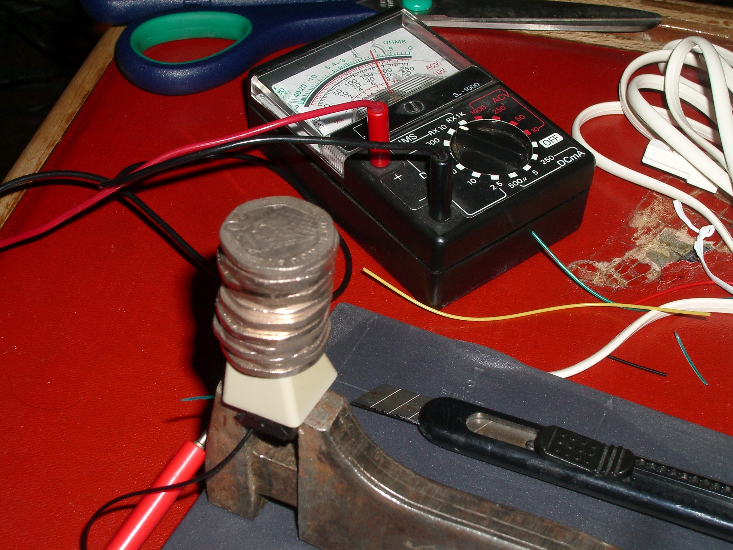

Setup:
Actuation with 10 £1 coins.jpg (934.55 KiB) Viewed 7065 times

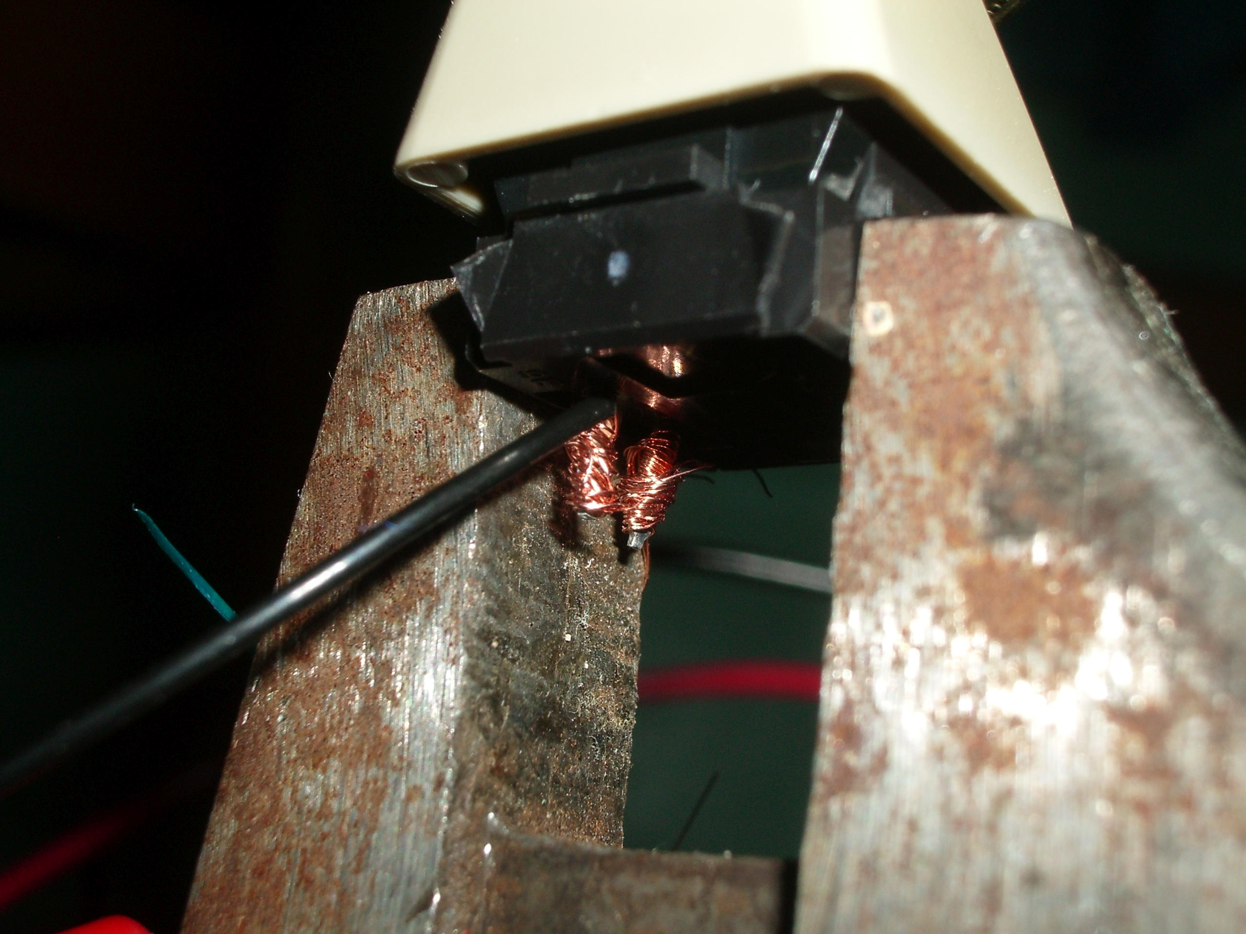

"Vice":
¿When do I get my certificate of insanity!.jpg (652.36 KiB) Viewed 7065 times
Wired-up switch:
Blu-tack stabilised vice 2.jpg (670.47 KiB) Viewed 7065 times
Wire wrapped Alps SKCM Amber.jpg (494.33 KiB) Viewed 7065 times
I tried using Blu-Tack to attach the probes, which didn't work, but also doubly didn't work as one of the switches is dud. Something is wrong with the actuator: it registers if I press the actuator manually, but the slider doesn't press it hard enough.
Registered:

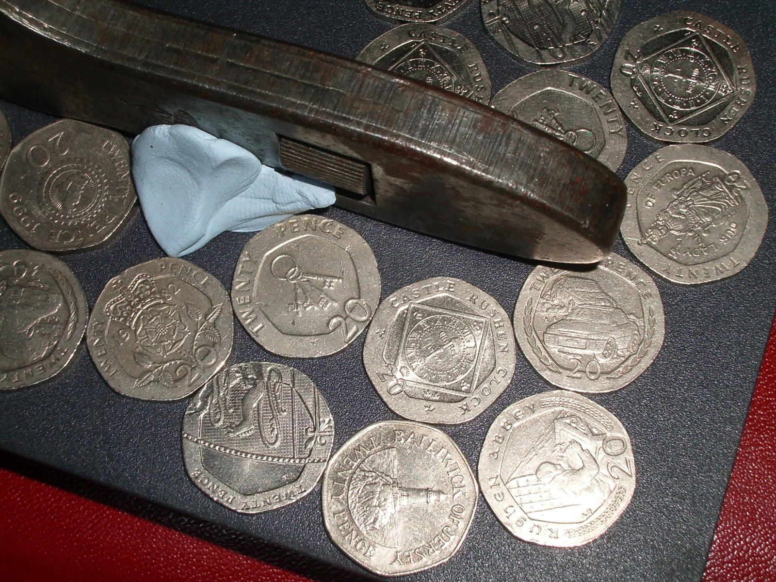

Coins:
Crown dependency and overseas territory coins make up the ranks.jpg (536.47 KiB) Viewed 7065 times
It works out as follows:
  • 9 × £1 @ 9.5 g = 85.5 g
  • 10 × £1 @ 9.5 g = 95 g
  • 17 × 20 p @ 5 g = 85 g (this was 100% consistent between tests)
  • (5 × £1 + 10 × 20 p) = 97.5 g (higher than expected: one fewer 20 p would have been 92 g!)
I weighed the stack of 20 p coins, and the best I could come up with was: 2 oz + 0.25 oz + 20 g, which comes to 83.8 g. BUT, I don't know, as there are two 2 oz weights that don't weigh the same as each other (?!?!), and not enough other weights to figure out which is the bad one. It took ages just to find a combination that balanced out the pile of 20s.
So yeah, somewhere in the 80–100 g range.

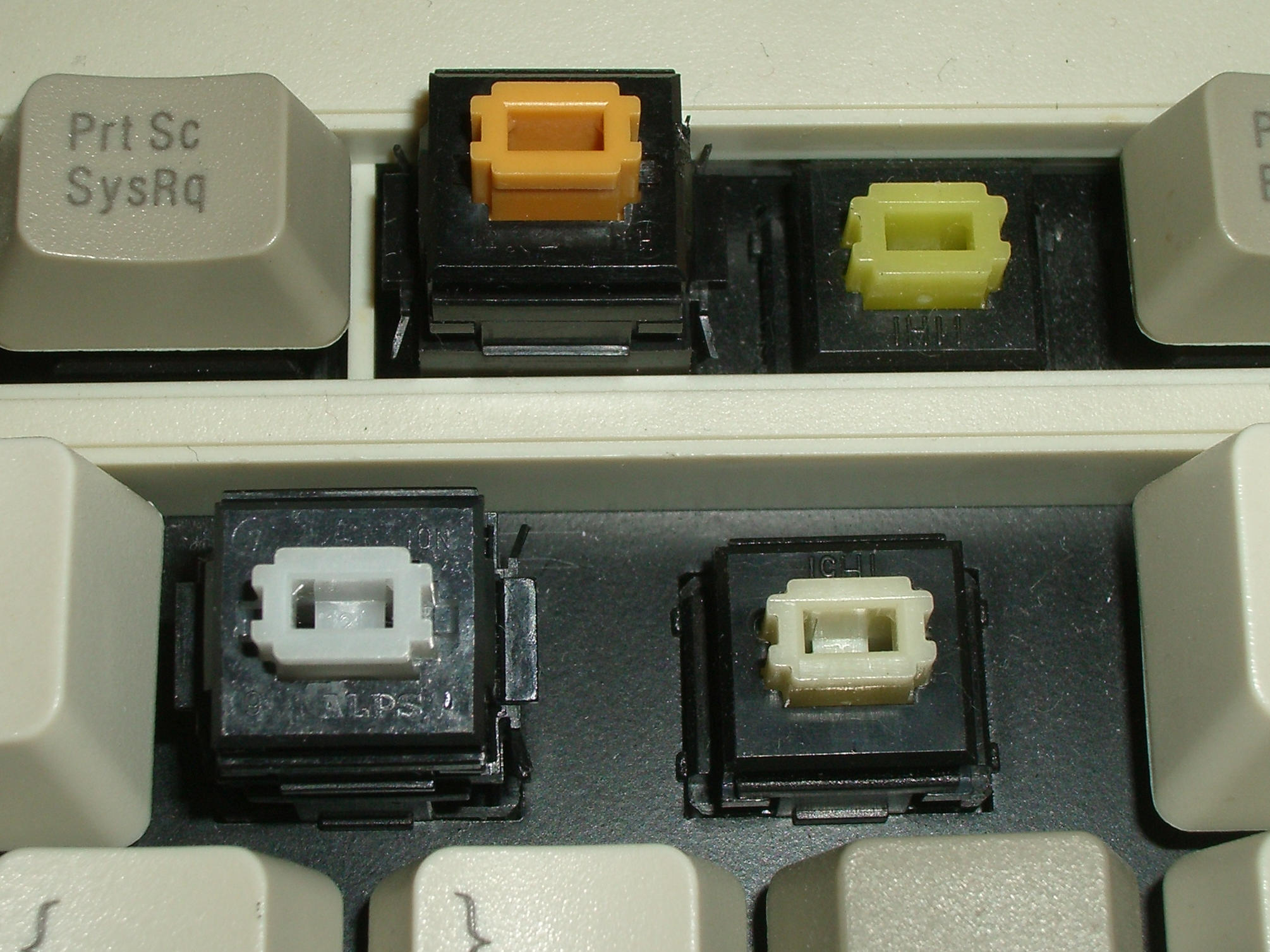

Here's another colour comparison:
Alps and Himake colour comparison.jpg (381.27 KiB) Viewed 6996 times
Clockwise from top left: amber Alps (with its really sharp slider moulding), AK-CN2 reduced travel variant (yellow), AK-CN2 (ivory, very similar shade to cream Alps), and white Alps. I have some actual yellow Alps switches on the way. I just need a loose salmon switch for a full six-way comparison between Alps red-orange-yellow colour range.
Amber Alps has only been found to date in some Apple IIc keyboards.

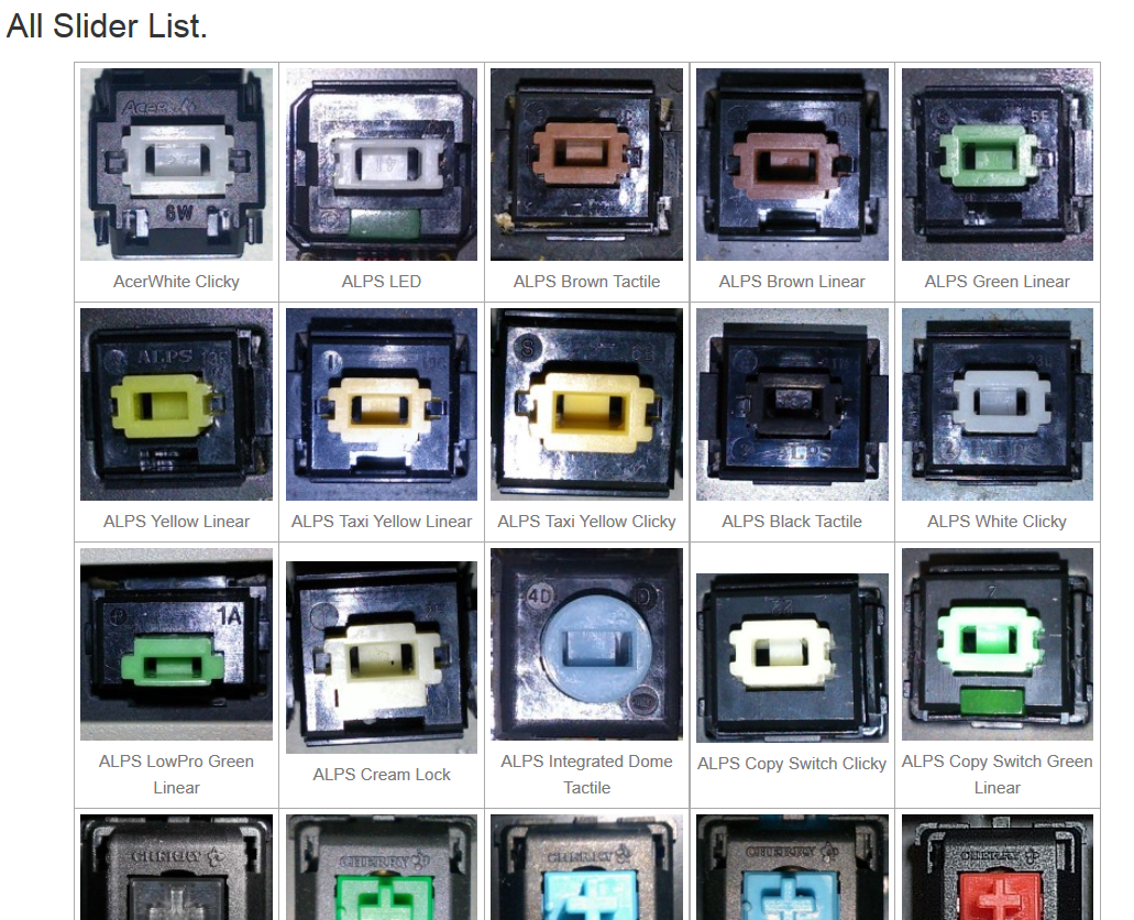

Posted: 13 Feb 2014, 14:45
by rzwv
It is a page of an axis.
In practice, it is written in Japanese.
The list is carried for comparison.
Probably ALPS Taxi Yellow Linear is unidentified.
Details.
Postscript.
Since it is a precious picture, it has permitted publishing the picture of a "kbd.rzw.jp" to Deskthority wiki as reference data.
Please publish together with a quoting agency.
The permission is granted by all the pictures including this picture.
貴重な画像なので、参考資料として"kbd.rzw.jp"の画像をDeskthority wikiへ掲載することを許可しています。
引用元と一緒に掲載して下さい。この画像を含め、全ての画像で許可をしています。
Posted: 13 Feb 2014, 14:58
