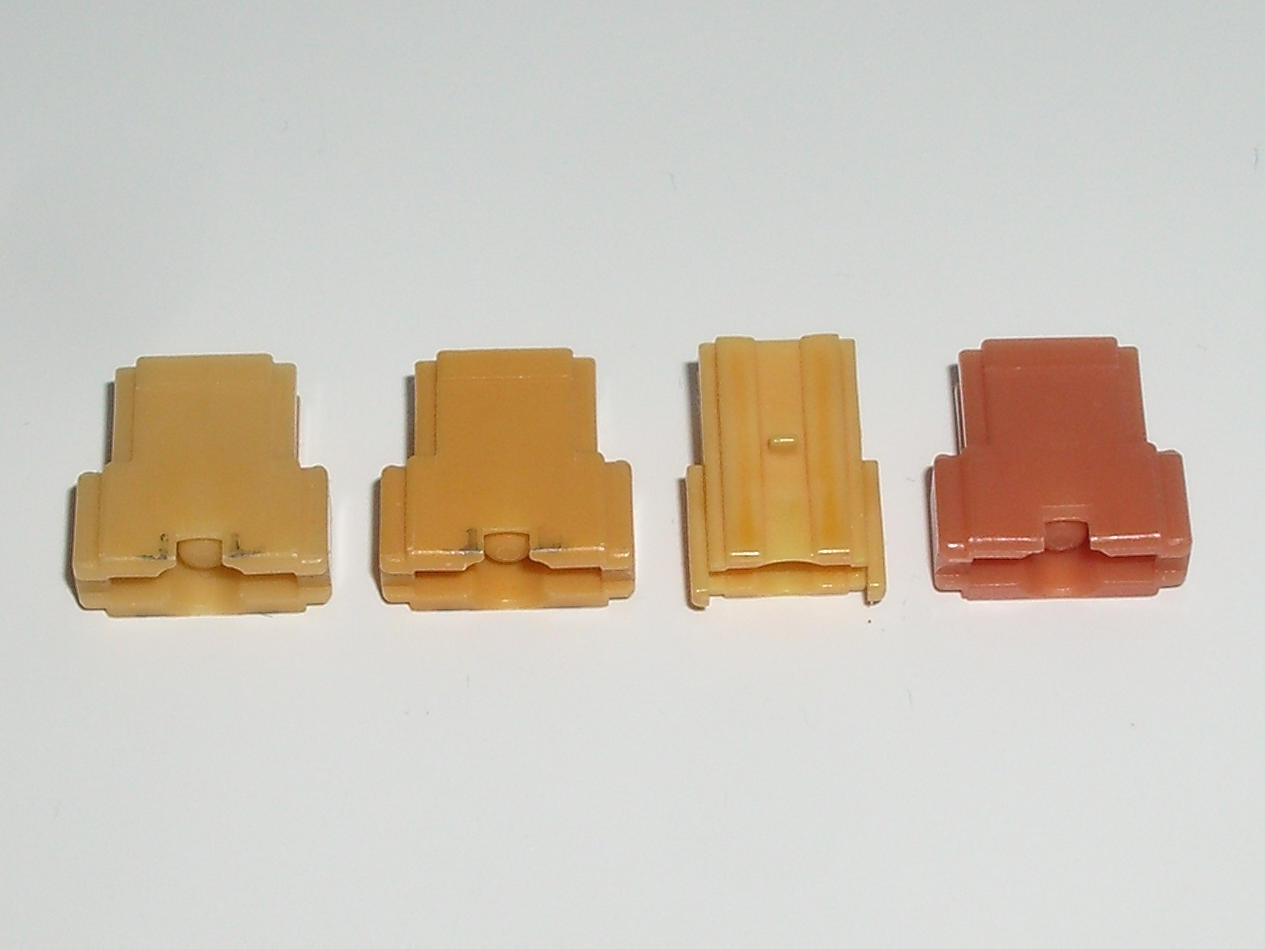

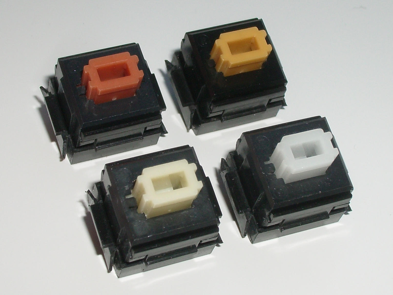

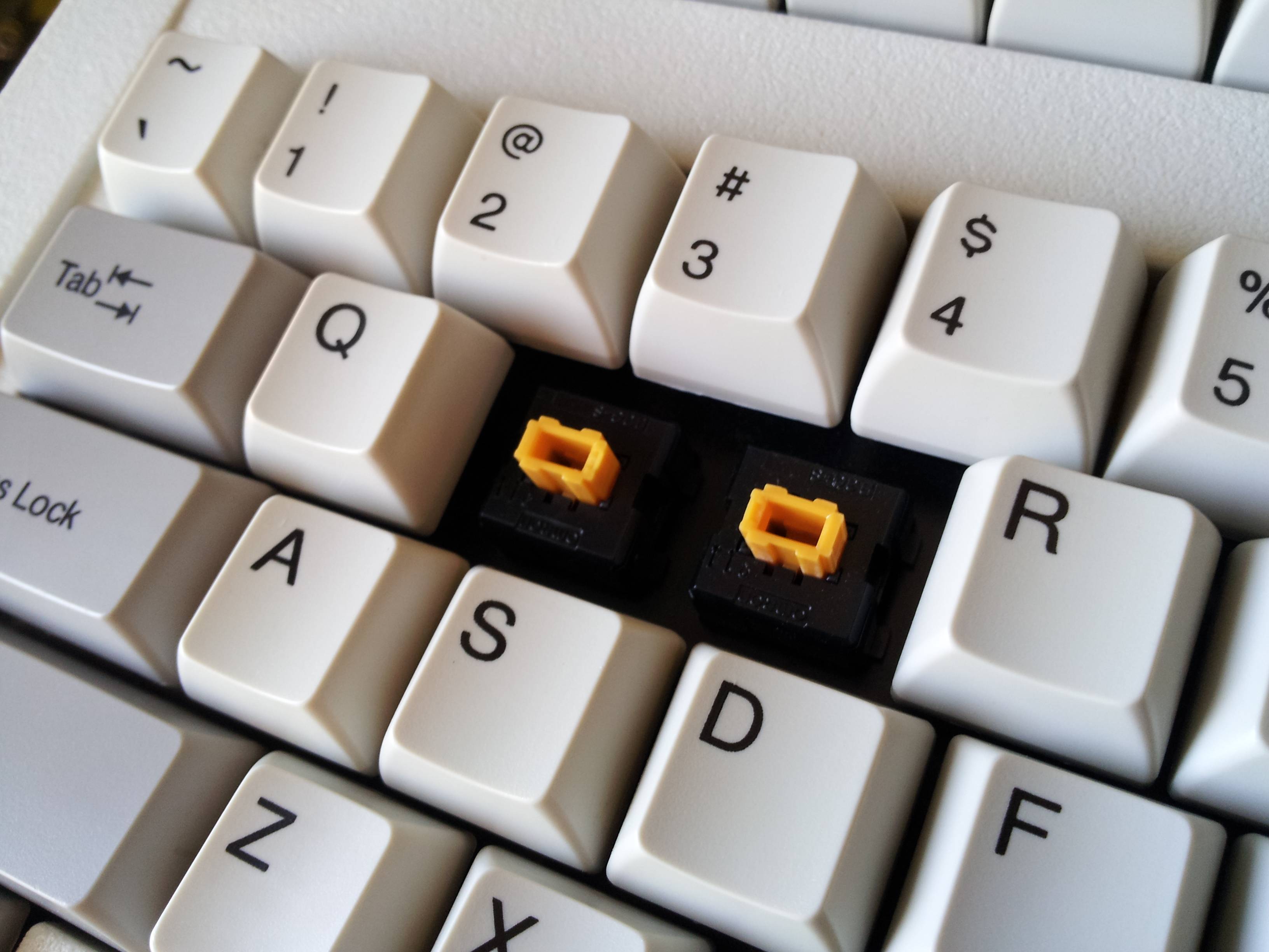

I got my "(NYC) taxi yellow" Alps switches in the post today!
This has prompted me to rename them from Alps SKCM Yellow to Alps SKCM Amber. The colour varies between switches, but overall it's a dull amber colour, rather than the pure yellow of linear Alps switches:

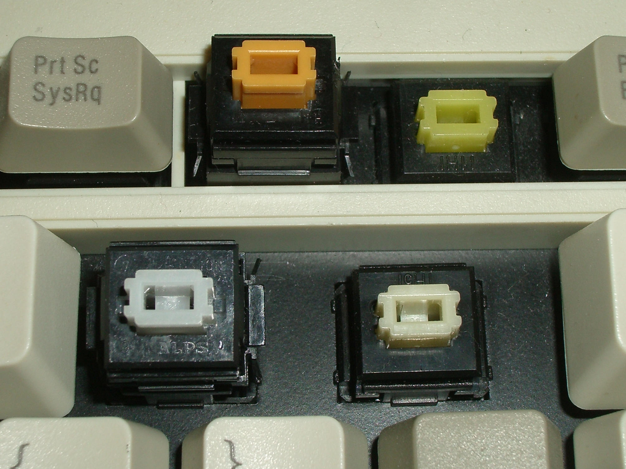

Clockwise from top-left: [wiki]Alps SKCM Orange[/wiki], [wiki]Alps SKCM Amber[/wiki], [wiki]Alps SKCM White[/wiki], [wiki]Alps SKCM Cream Damped[/wiki].

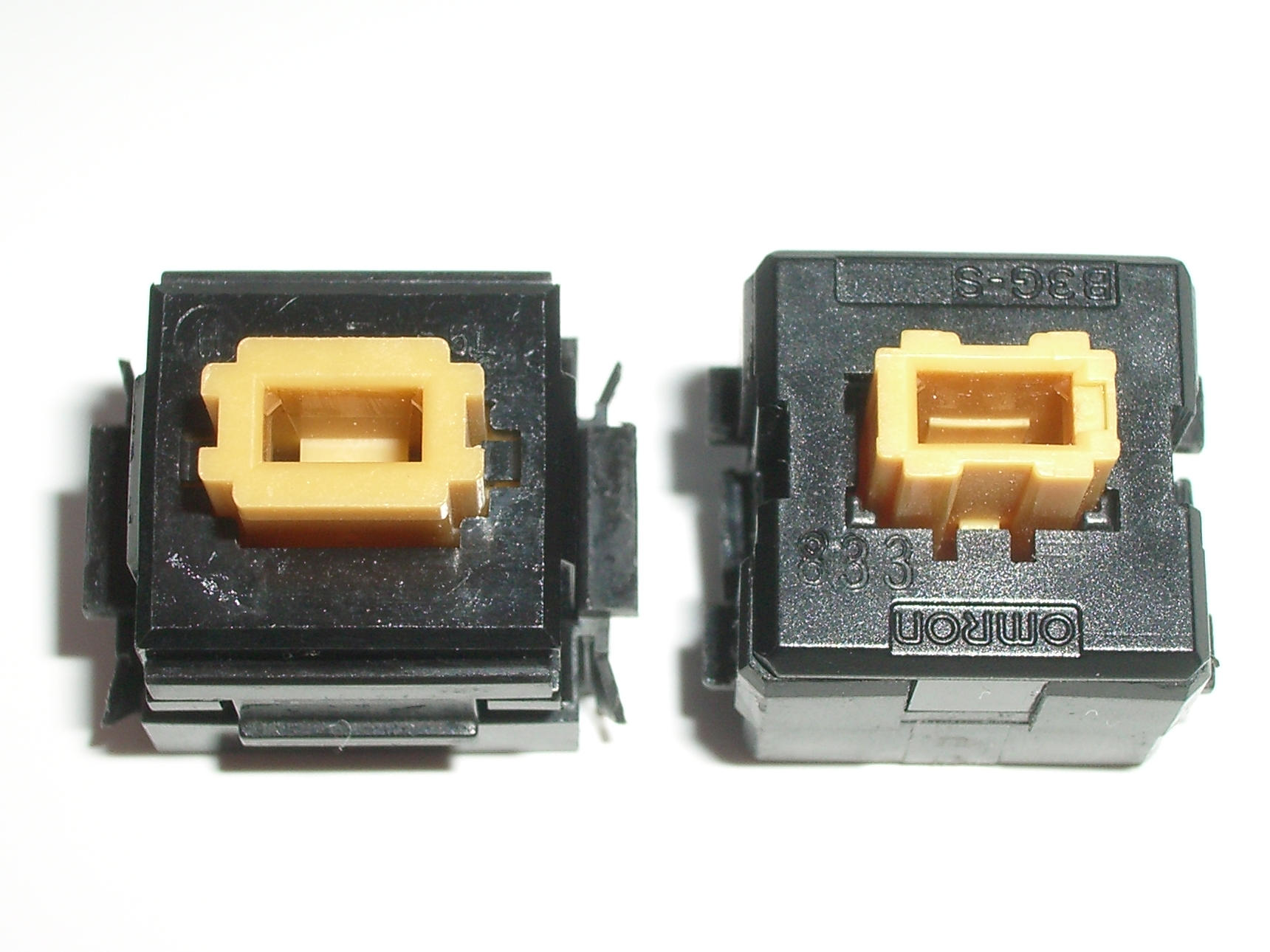

The colour is very similar to amber [wiki]Omron B3G-S series[/wiki] switches:

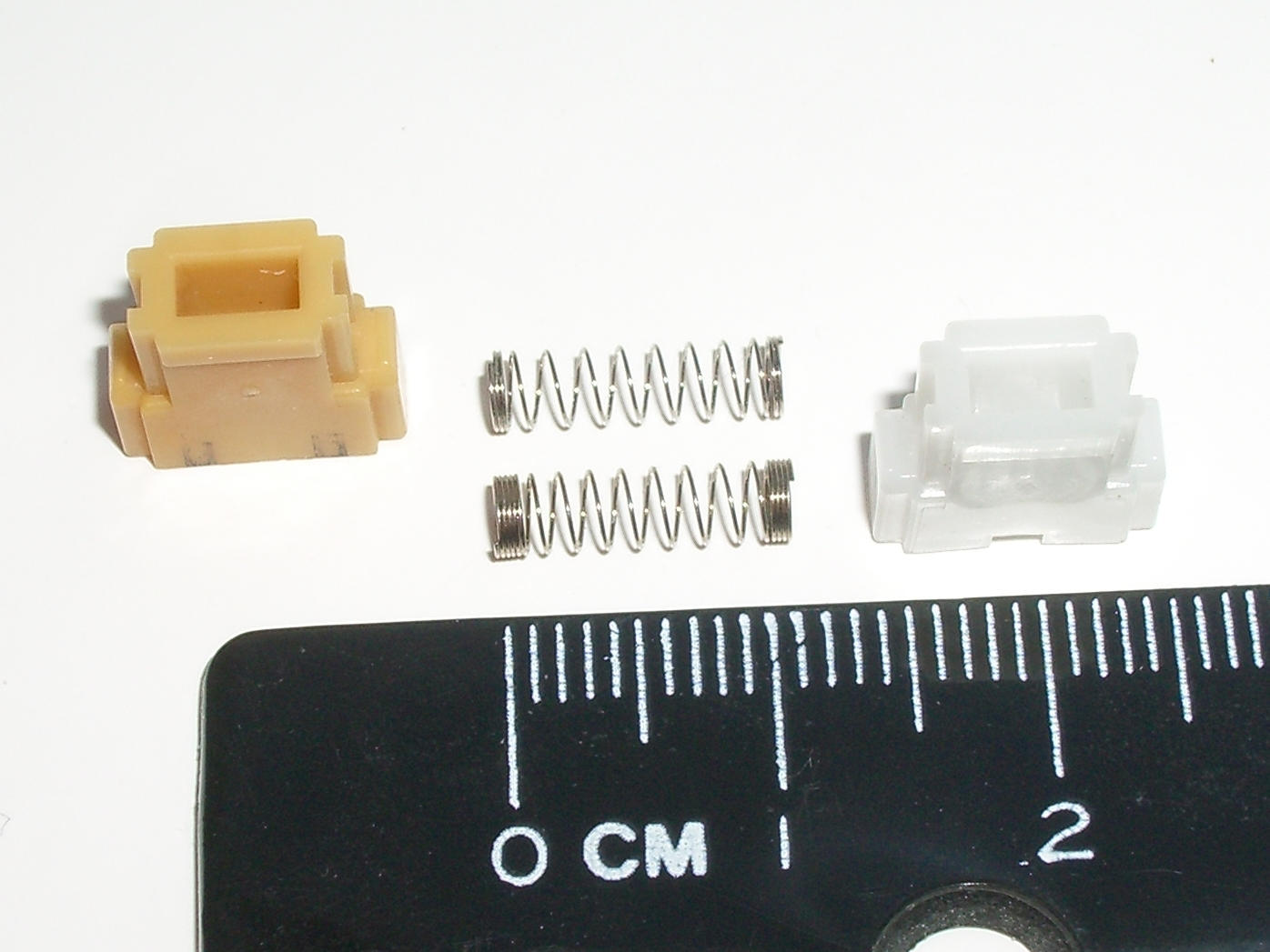

Slider comparison:
Two shades of amber Alps sliders; amber Omron B3G-S; orange Alps. My yellow Alps switches got shipped out today, so I'll have them to use as a colour comparison. (Note that there are also linear amber Alps switches — we don't know if they're the same as linear yellow Alps (i.e. change of pigment) or a different switch.)
What I did notice is that amber Alps is pretty stiff. It feels at least 20% stiffer than white Alps, so that's around 85 gf or more, compared to the nominal 70 gf of most tactile and clicky Alps switches. The springs are the same length, but not the same arrangement:
(Slider is a bit washed out in that photo)
What I could do is buy couple more and have them shipped directly to HaaTa/jacobolus or matt3o for proper measuring, instead of trying to rig some absurd contraption to allow me to stack coins on them and read off actuation using a meter.
Also note the marks on the slider, which are present on both sides. Lubricant?

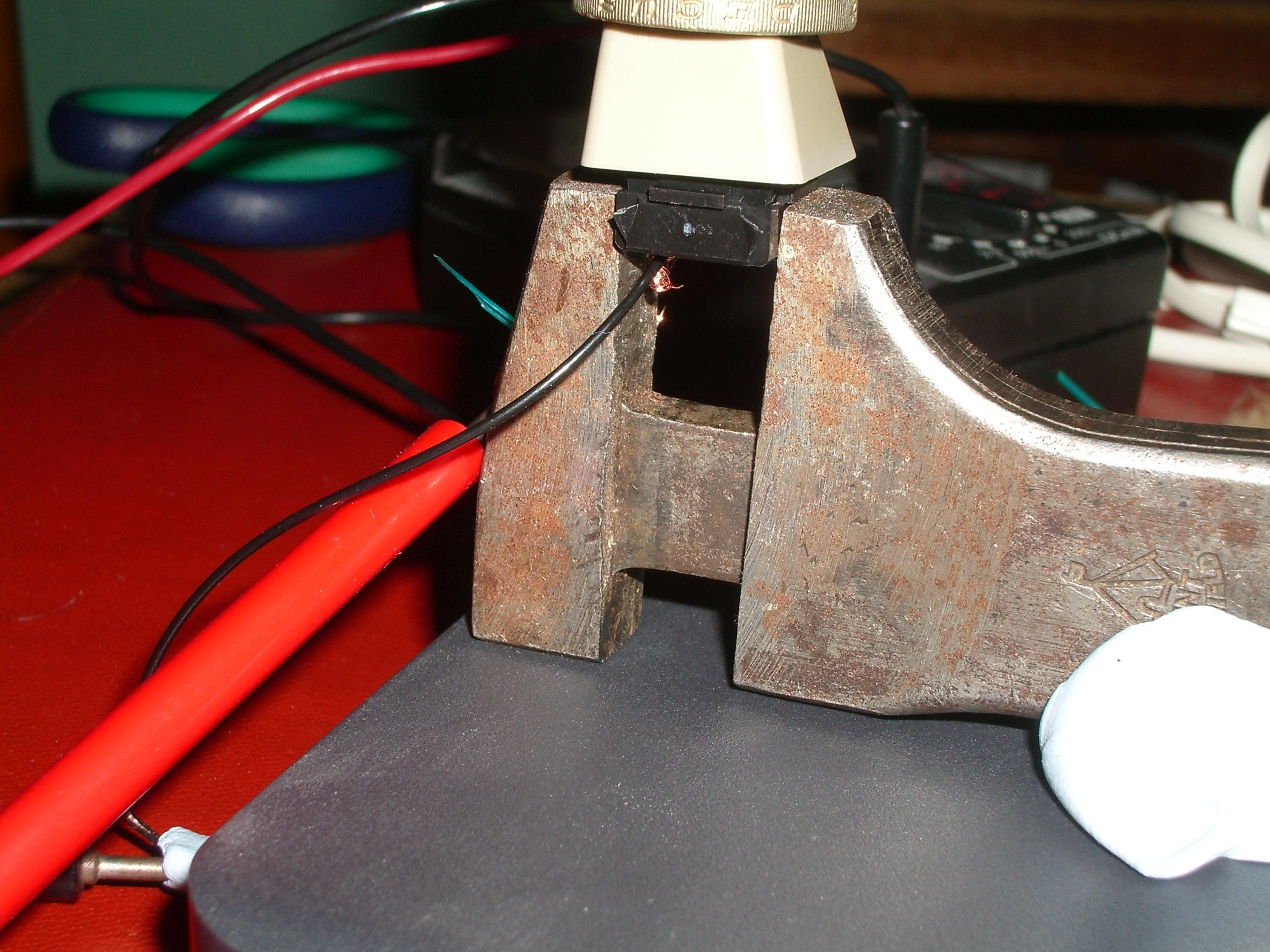

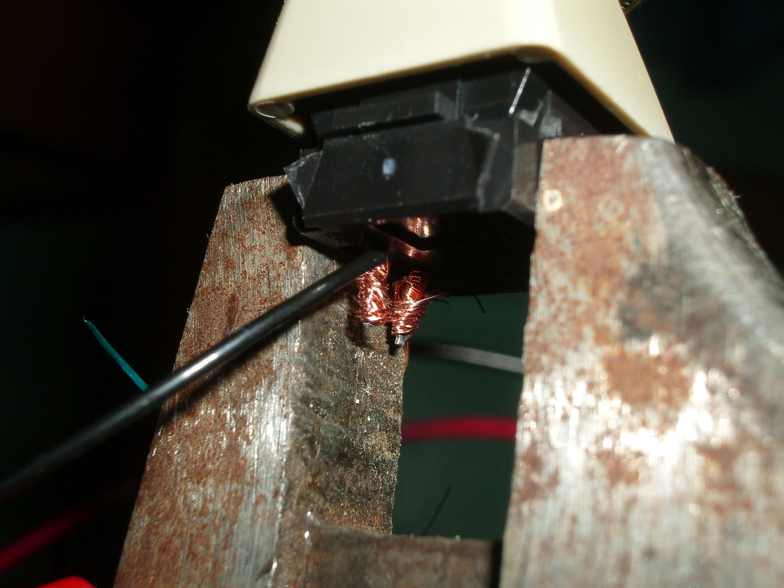

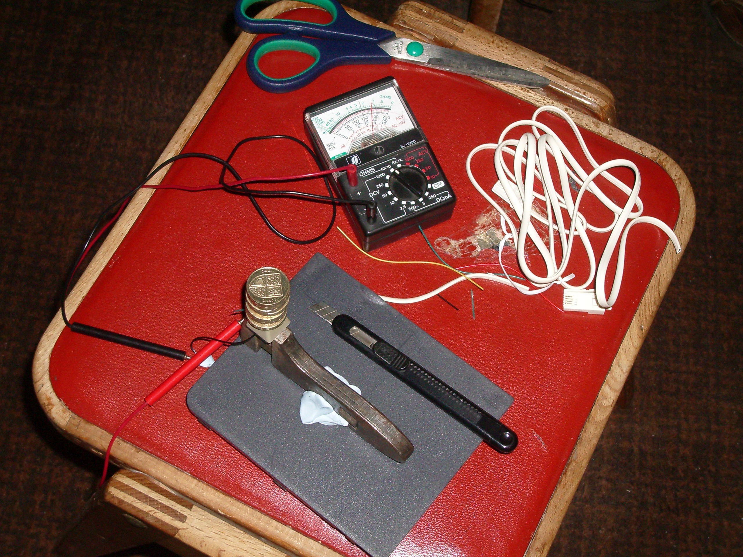

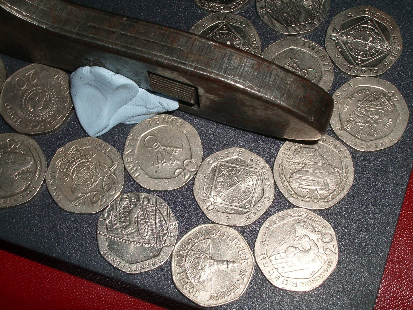

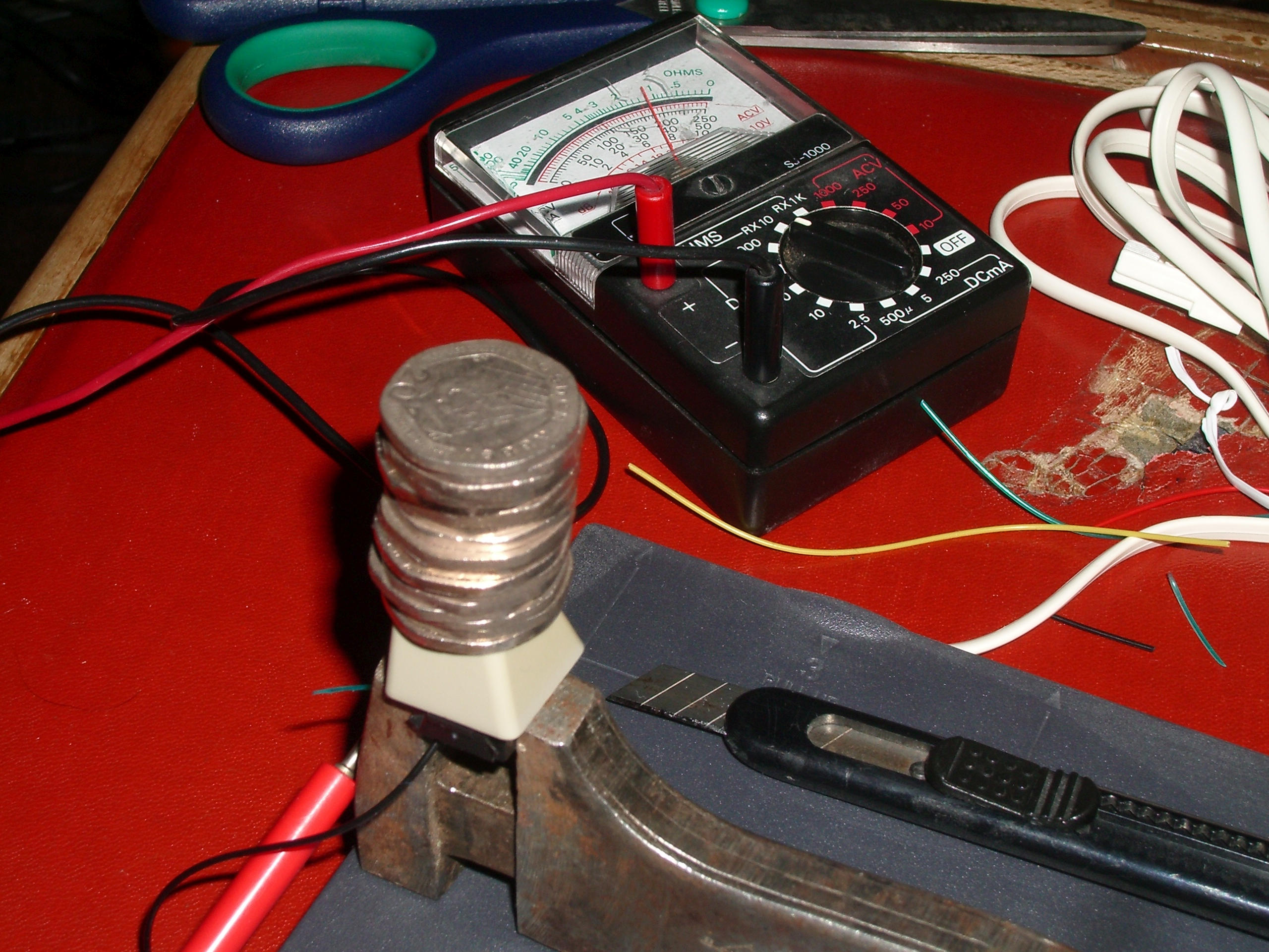

Somewhere between 83 and 97.5 g.

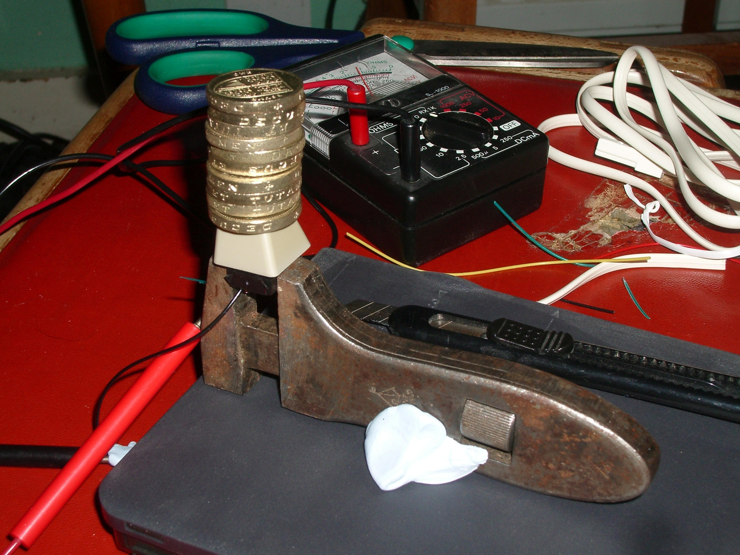

Behold!
The most ghetto attempt to measure force the world has ever seen!
Required (not including "tools"):
Registered: Coins: It works out as follows:
So yeah, somewhere in the 80–100 g range.
I am fairly sure I could have found something better to do with my Saturday night …
I think I just took myself out of the running for the Deskthority Secret Valentine's …
But yes, these switches are distinctly heaver than normal Alps switches. Having a whole keyboard of Alps SKCL Cream is one thing, but a whole keyboard of these? Were Apple mad, or are my switches just completely out of wack? Were these supposed to be space bar switches for blue Alps keyboards?
Behold!
- Analogue multimeter with probes
- Adjustable spanner
- BT telephone cable
- Dead notebook battery
- Blu-Tack
- Every last 20 pence coin I've got, and since most of them are at work, I had to raid my interesting coins box for all my Guernsey, Jersey, Isle of Man and Gibraltar 20 p coins, and that was still only just enough
- 9 × £1 @ 9.5 g = 85.5 g
- 10 × £1 @ 9.5 g = 95 g
- 17 × 20 p @ 5 g = 85 g (this was 100% consistent between tests)
- (5 × £1 + 10 × 20 p) = 97.5 g (higher than expected: one fewer 20 p would have been 92 g!)

Here's another colour comparison:
Clockwise from top left: amber Alps (with its really sharp slider moulding), AK-CN2 reduced travel variant (yellow), AK-CN2 (ivory, very similar shade to cream Alps), and white Alps. I have some actual yellow Alps switches on the way. I just need a loose salmon switch for a full six-way comparison between Alps red-orange-yellow colour range.
Amber Alps has only been found to date in some Apple IIc keyboards.

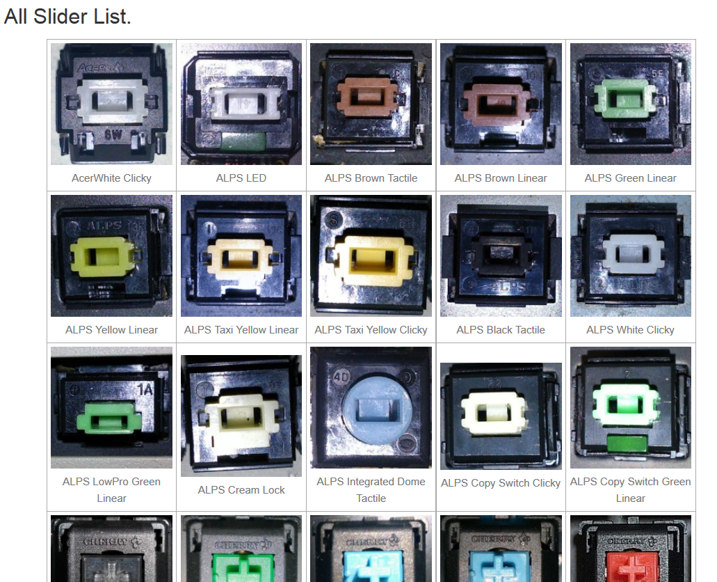

It is a page of an axis.
In practice, it is written in Japanese.
The list is carried for comparison.
Probably ALPS Taxi Yellow Linear is unidentified. Details.Postscript.
