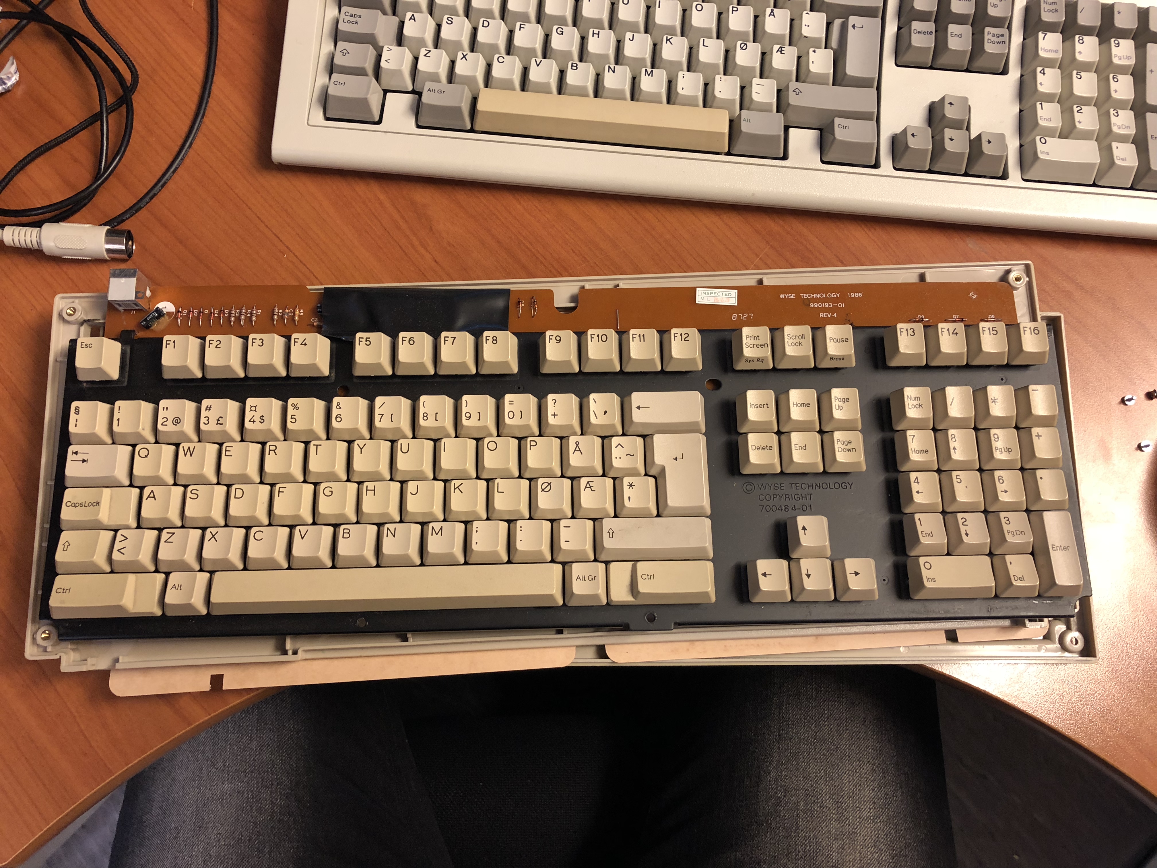

Hi folks,
Sorry in advance for a lot of questions that show signs of me not really knowing what I'm doing.
In short, feel free to explain things to me like I'm 5 years old, I'm not a mechanical engineer and have a very basic understanding of how electronics work, but I'm determined to get this to work. I'm here because I want to learn, so please be gentle. :)
Right, so here's the story:
Some time ago I acquired a Philips board that turned out to be a WYSE-board in disguise. It's got 107 keys.
Here's some pictures:
Photo 05-11-2018, 13 34 57.jpg (5.68 MiB) Viewed 3192 times
Photo 05-11-2018, 13 35 01.jpg (4.81 MiB) Viewed 3192 times
Photo 05-11-2018, 13 35 07.jpg (4.51 MiB) Viewed 3192 times
Photo 05-11-2018, 13 35 19.jpg (6.35 MiB) Viewed 3192 times
Photo 05-11-2018, 13 35 24.jpg (5 MiB) Viewed 3192 times
Photo 10-11-2018, 22 44 28.jpg (6.41 MiB) Viewed 3192 times
Now, I've understood so much that I have to trace the matrix (I've read sixty's tutorial on the topic) and wire everything up to a Teensy, but what halts the process is a few steps:

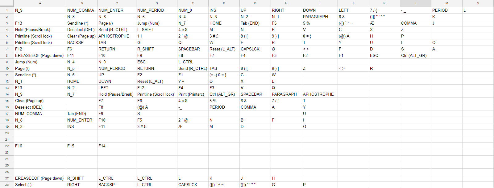

What have I done about the matrix?
I've used a multimeter and checked which solder points on each key are connected to what pin on the internal chip.
I logged the results in this spreadsheet:
The rows correspond to the pin number on the chip
With the following numbering on the pins:
The thing is that I don't know how I "consolidate" the duplicate values in the spreadsheet into a single matrix, a single set of rows and columns.

Ha! Yeah, it would be nice if keyboard matrices were consistent. But they are not! The designers seemed to take great pleasure in doing daft stuff differently every time. You’re on the hook to map it out!
Now, something I didn’t see on your spreadsheet was column names and row names. See, a matrix is only really a matrix when the controller knows where to find them! You’ve got to tell it which pins they’re hooked up to.

Firstly, you will need to draw out the basic switch layout on paper i find it is easier to write on paper then trying on a spreadsheet. Making a layout on KLE and printing that out works well. So for each switch you would mark the chip pin corresponding to the switch pin so each switch should have both a column and row chip pin and the switches are in order of he keyboard itself.
Decide on a controller to use, i normally find a Teensy++ gives enough pins and pair a chip pin on the keyboard with a pin on the controller this is because you will need to specify the rows and columns; you may have say 12 row pins and 7 column ones for example. Again it helps to then go back to your paper switch layout and change the chip pin numbers to match the row/column numbers in the matrix e.g. in your example if the rows start at 28 and go to 22 on the chip then that would be row 0 to row 6 of the matrix.
So now we should have our matrix mapped out for the number of rows and columns needed. It will not be in nice neat order because this is how the boards were designed to avoid ghosting without using diodes. Solder wire connecting the chip pins with the corresponding Teensey controller pins.
Next we will move on to making the hex file used to flash to the controller.
Make the layout on KLE if you have not done so. Open up kbfirmware.com and then paste in the raw data from the KLE.
go to the WIRING tab the layout should match with the switch drawing, if the matrix was planned with the board in reverse then use the flip button to make sure the layout matches what you have drawn and set the number of pins and columns to match the amount in your matrix, the diagram above will get messy but we can sort that next.
Go through each individual switch and set the row and column pins so they match the paper diagram that you have
Go to the PINS tab and choose the correct controller the ? should help you choose the right one.
Set the row and column pins so they correspond with the pin on the controller e.g. Row 0 B1, Row 2 B2, etc You can also specify pins for the lock lights if you want these to also function just wire up the controller pin to the chip pin from the LED.
The Keymap tab should be correct if the KLE was done correctly, if not then the basic key codes are there and should be able to construct it easily enough. There is the potential to do complex layering etc if needed but it is best to stick to 1 layer for the first try.

I came so far that I managed to copy my layout to KLE, print out the layout and cross-check which keys mapped to what pins. I've discovered that I haven't managed to read all two pins on each key, so I'll do that either this evening or tomorrow some time. As far as I can tell there's about 11 keys I'm missing.
But, is this a 5 or 6 row layout? (I'm guessing 6..)
Posted: 14 Nov 2018, 13:59
by Anakey
that is 6 rows looking at physical switches, however there may be 7 or more row pins for the matrix. My most recent board had 12 row pins for a 6 row board. you might end up with say F1 to F4 in Row 0 then also V,B,N,M also in Row 0 so that is why it is helpful to keep the physical switch layout fixed and then specify the column/row pins for each switch. Don't forget that the rows/columns start at 0 so if you have 7 rows it will go from 0-6.

Posted: 14 Nov 2018, 14:37
by Anakey
if you do decide to go with the converter, replace that capacitor by the output, it looks in pretty bad shape, though not surprising for being over 30 years old
Posted: 14 Nov 2018, 17:29
by Hypersphere
Anakey wrote: if you do decide to go with the converter, replace that capacitor by the output, it looks in pretty bad shape, though not surprising for being over 30 years old
Good point. That capacitor seems to be a hallmark of old Wyse keyboards! My Wyse boards show evidence of leaking from that capacitor. I haven't replaced the capacitors yet and the boards are still working okay, but the replacements are on my long "to do" list.
