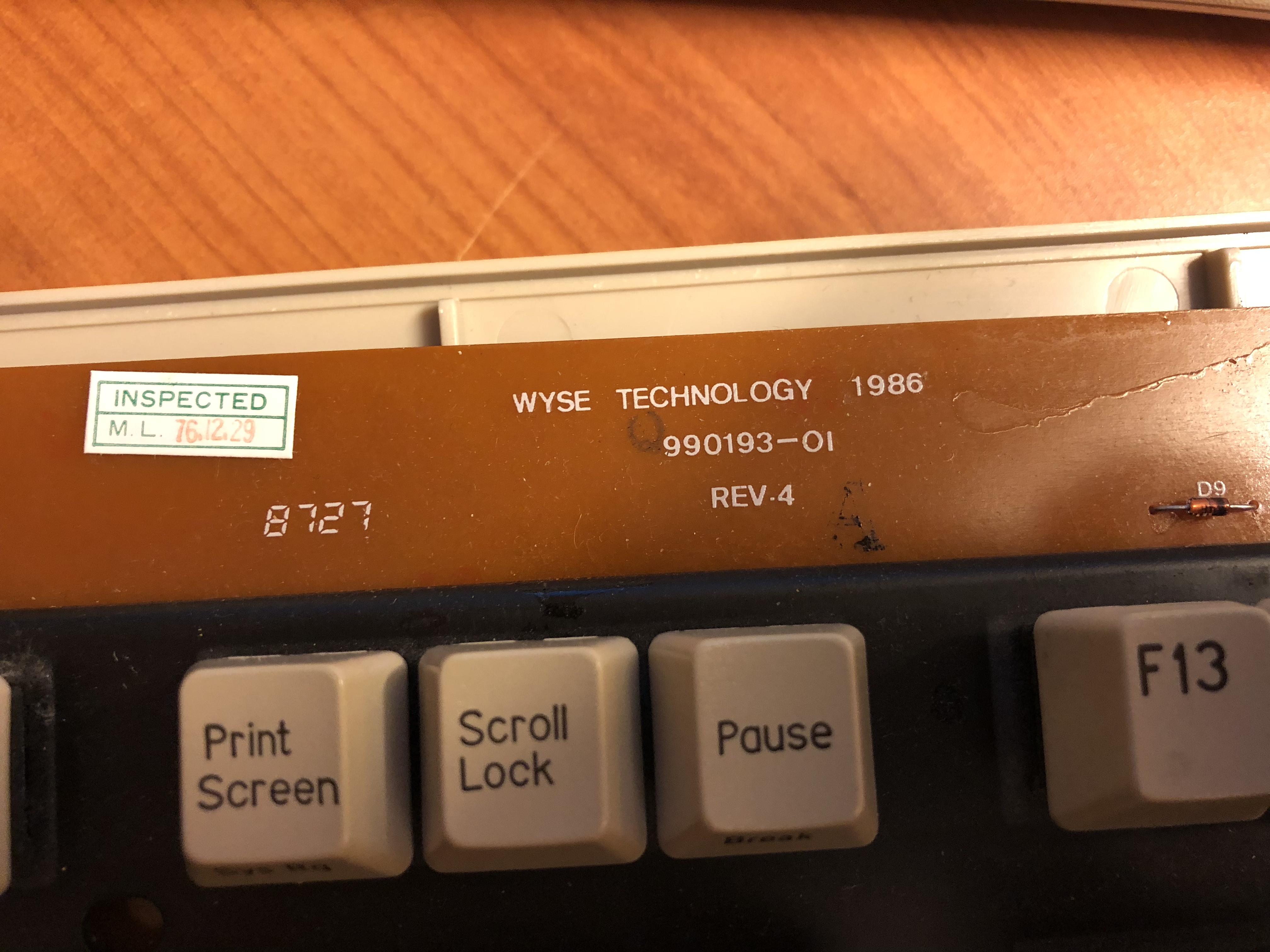

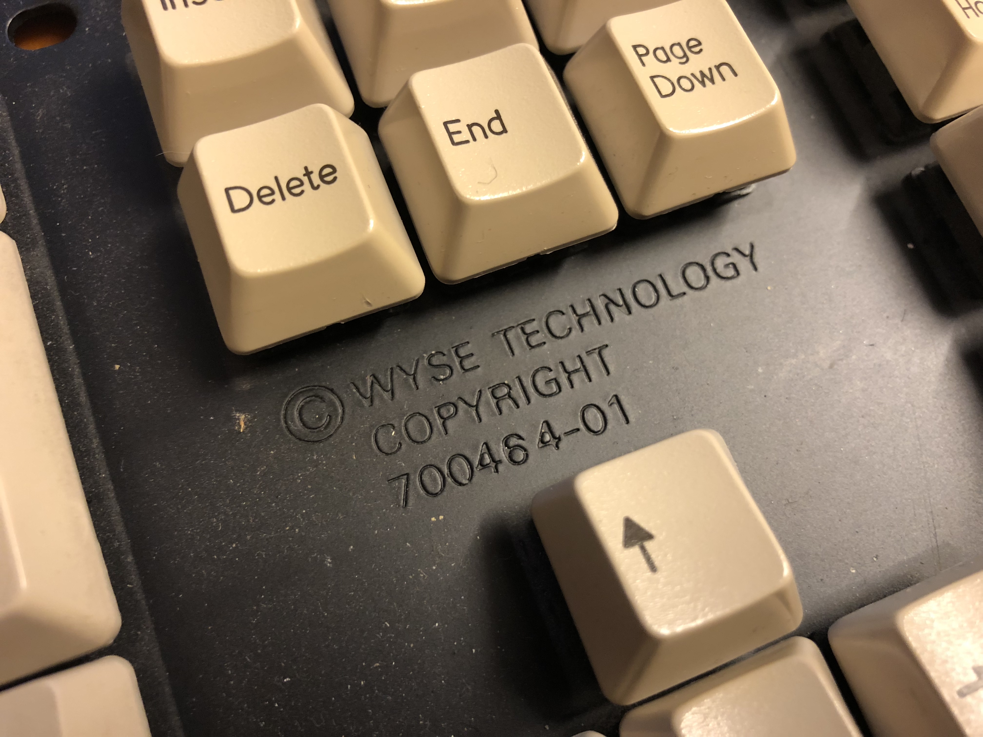

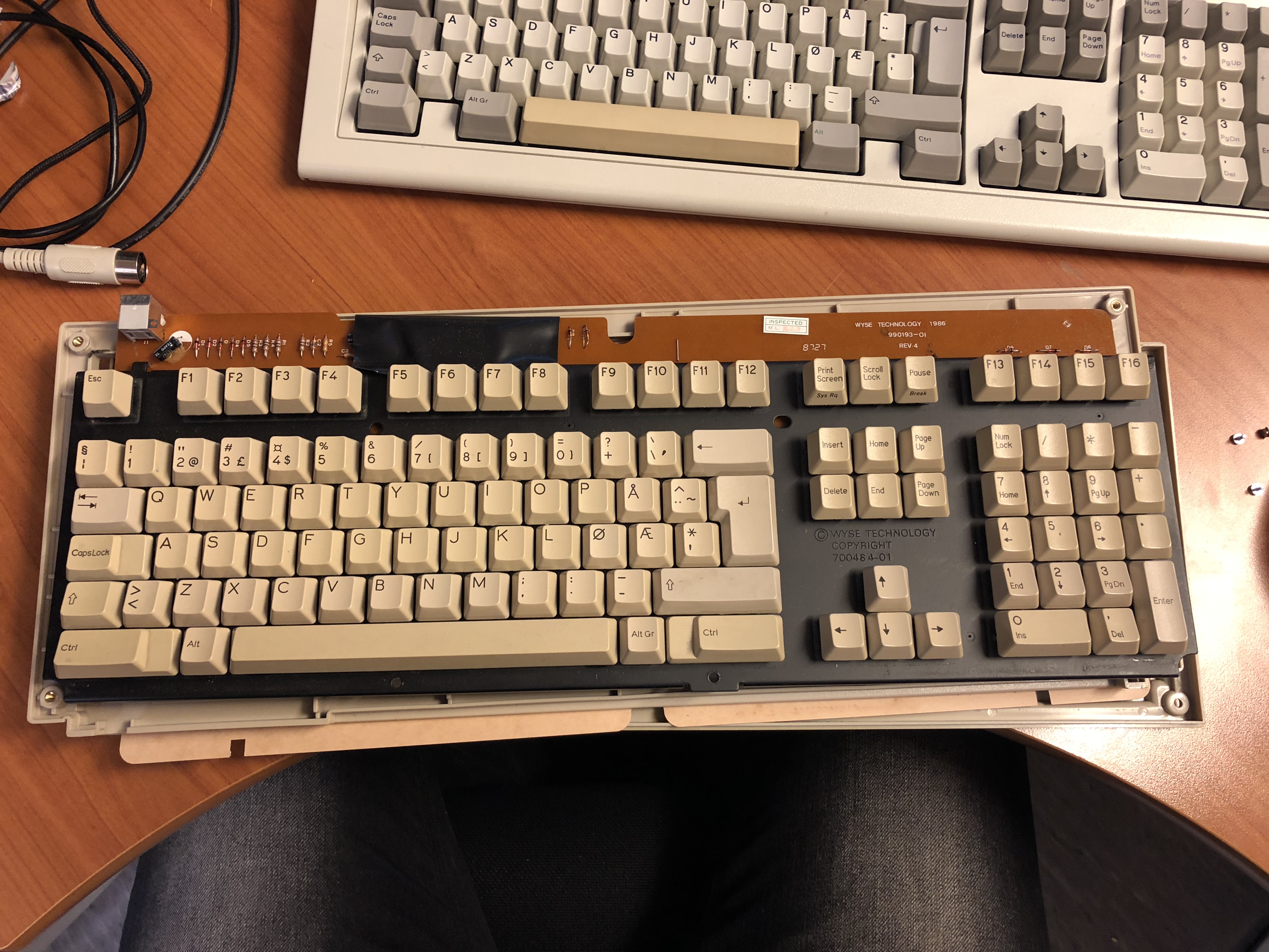

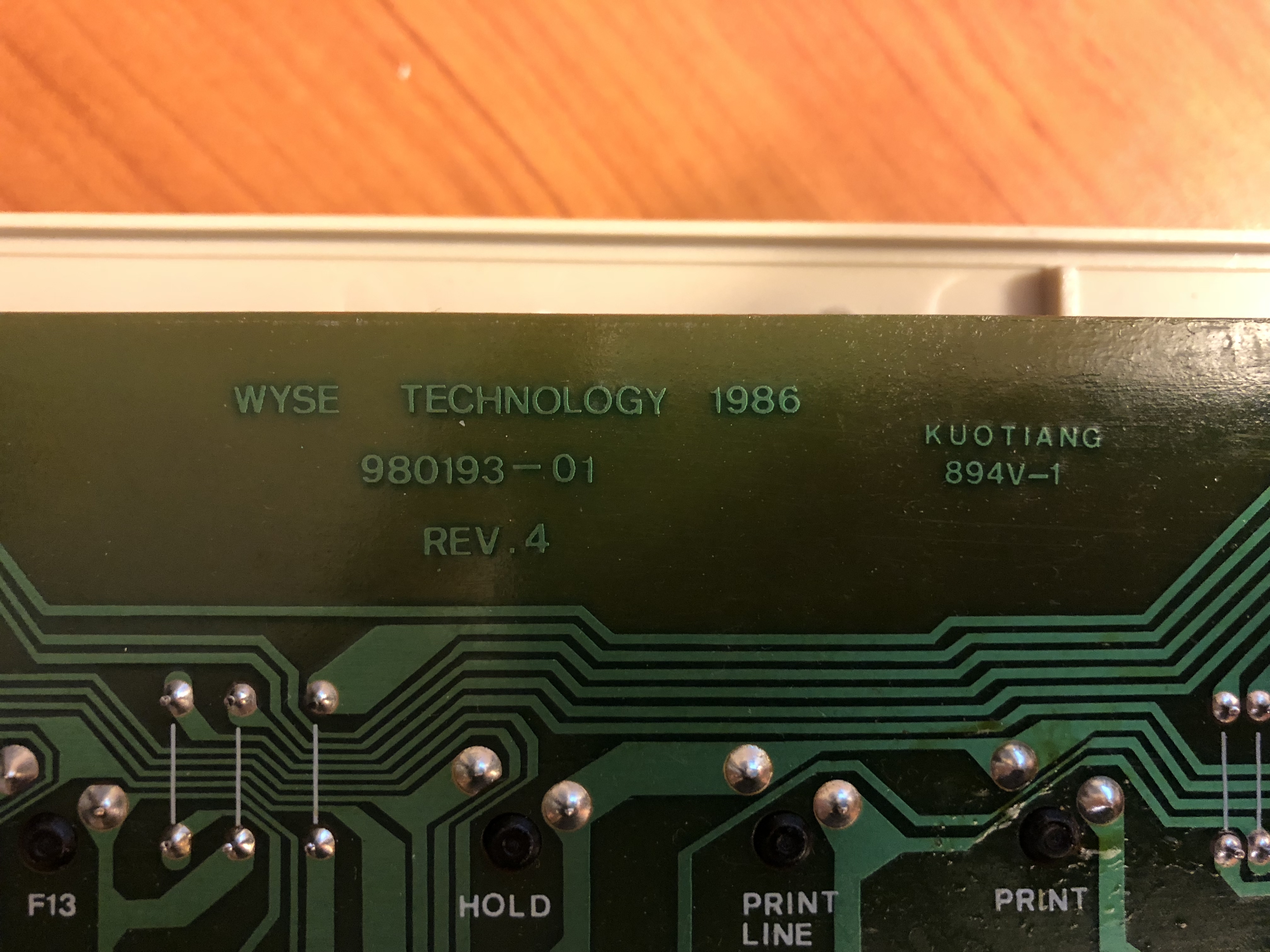

Some time ago I acquired a Philips board that turned out to be a WYSE-board in disguise. It's got 107 keys.
Here's some pictures:

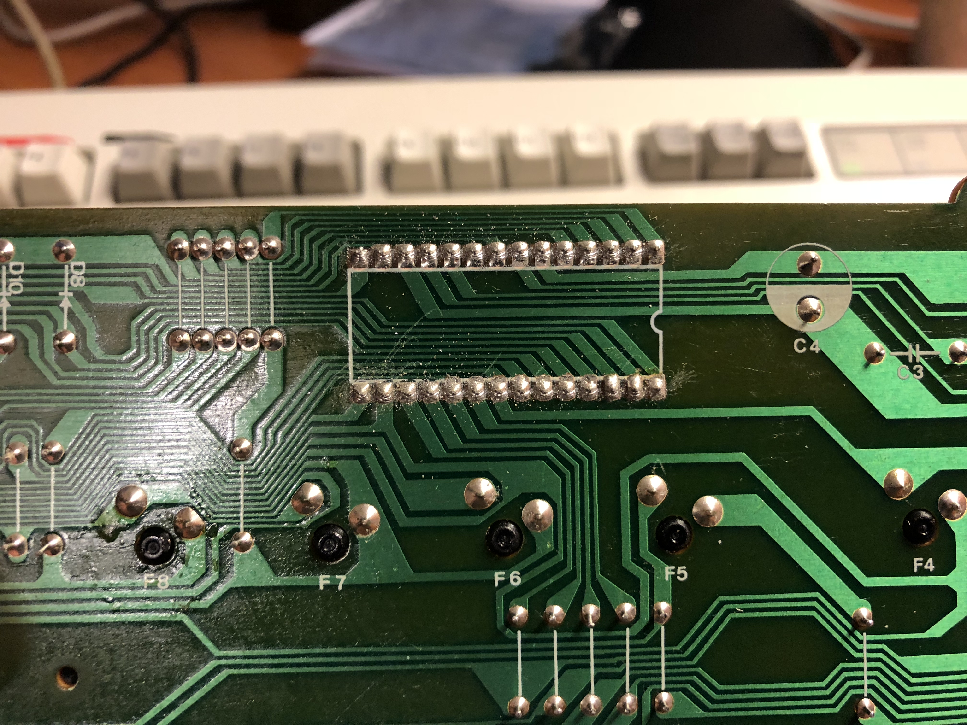

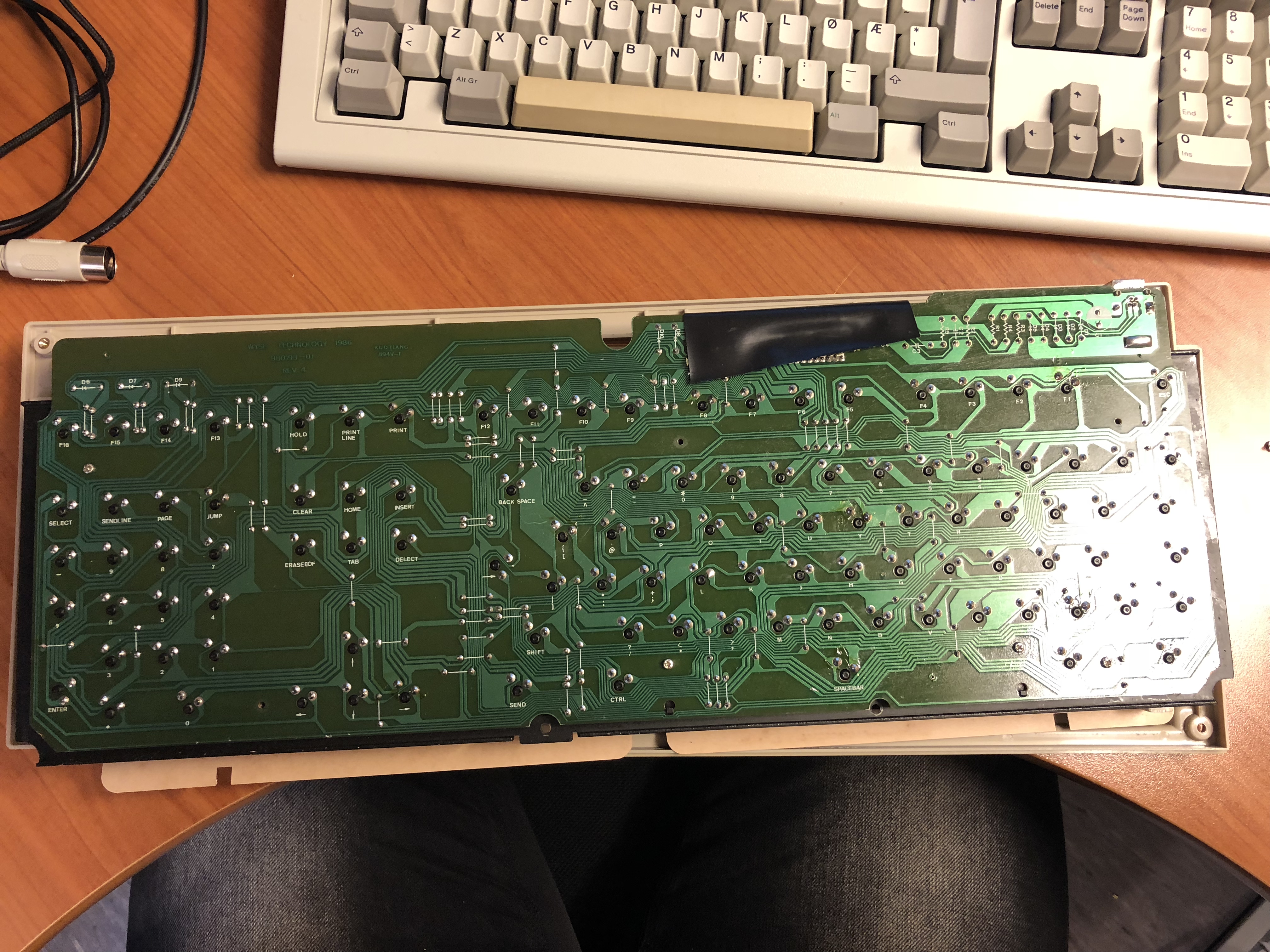

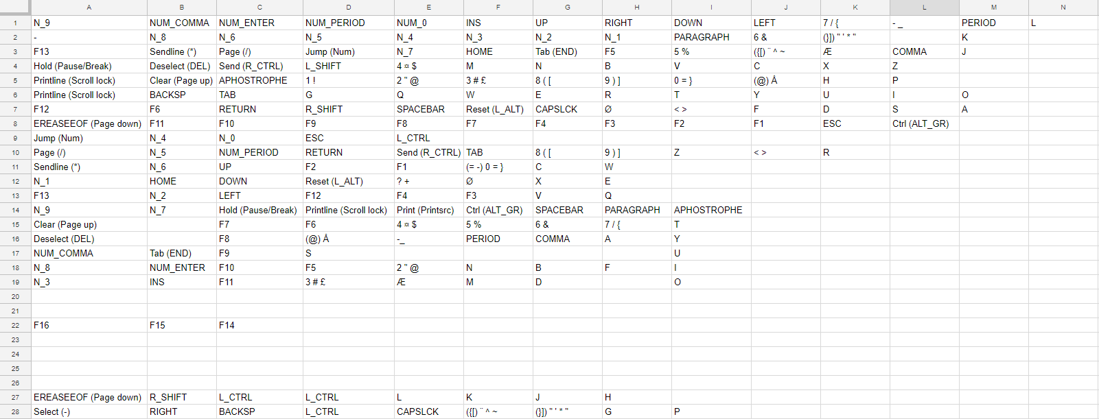

Now, I've understood so much that I have to trace the matrix (I've read sixty's tutorial on the topic) and wire everything up to a Teensy, but what halts the process is a few steps:
- Figure out how what the matrix looks like
- Picking a suitable converter (I have some experience with Hasu's AEK-converter, and have downloaded and poked around in Soarer's stuff)
What have I done about the matrix?

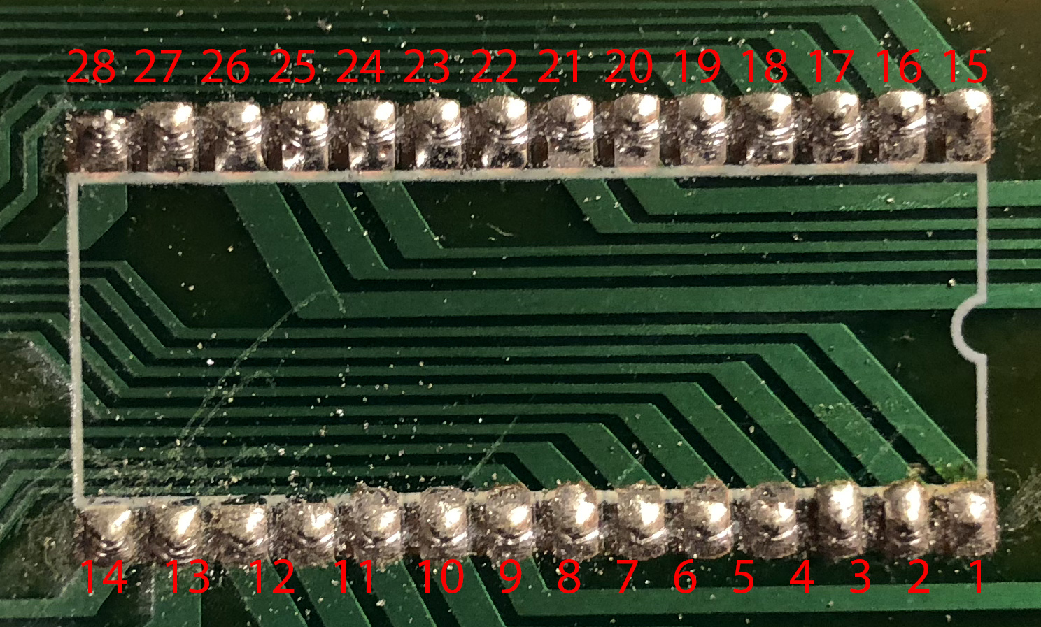

I've used a multimeter and checked which solder points on each key are connected to what pin on the internal chip.
I logged the results in this spreadsheet:
The rows correspond to the pin number on the chip
With the following numbering on the pins:
The thing is that I don't know how I "consolidate" the duplicate values in the spreadsheet into a single matrix, a single set of rows and columns.

Firstly, you will need to draw out the basic switch layout on paper i find it is easier to write on paper then trying on a spreadsheet. Making a layout on KLE and printing that out works well. So for each switch you would mark the chip pin corresponding to the switch pin so each switch should have both a column and row chip pin and the switches are in order of he keyboard itself.
Decide on a controller to use, i normally find a Teensy++ gives enough pins and pair a chip pin on the keyboard with a pin on the controller this is because you will need to specify the rows and columns; you may have say 12 row pins and 7 column ones for example. Again it helps to then go back to your paper switch layout and change the chip pin numbers to match the row/column numbers in the matrix e.g. in your example if the rows start at 28 and go to 22 on the chip then that would be row 0 to row 6 of the matrix.
So now we should have our matrix mapped out for the number of rows and columns needed. It will not be in nice neat order because this is how the boards were designed to avoid ghosting without using diodes. Solder wire connecting the chip pins with the corresponding Teensey controller pins.

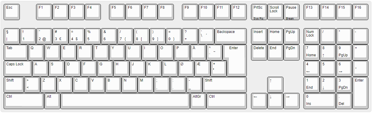

I came so far that I managed to copy my layout to KLE, print out the layout and cross-check which keys mapped to what pins. I've discovered that I haven't managed to read all two pins on each key, so I'll do that either this evening or tomorrow some time. As far as I can tell there's about 11 keys I'm missing.
But, is this a 5 or 6 row layout? (I'm guessing 6..)
Anakey
14 Nov 2018, 13:59
that is 6 rows looking at physical switches, however there may be 7 or more row pins for the matrix. My most recent board had 12 row pins for a 6 row board. you might end up with say F1 to F4 in Row 0 then also V,B,N,M also in Row 0 so that is why it is helpful to keep the physical switch layout fixed and then specify the column/row pins for each switch. Don't forget that the rows/columns start at 0 so if you have 7 rows it will go from 0-6.

if you do decide to go with the converter, replace that capacitor by the output, it looks in pretty bad shape, though not surprising for being over 30 years old
Hypersphere
14 Nov 2018, 17:29
Anakey wrote: if you do decide to go with the converter, replace that capacitor by the output, it looks in pretty bad shape, though not surprising for being over 30 years old
Good point. That capacitor seems to be a hallmark of old Wyse keyboards! My Wyse boards show evidence of leaking from that capacitor. I haven't replaced the capacitors yet and the boards are still working okay, but the replacements are on my long "to do" list.
