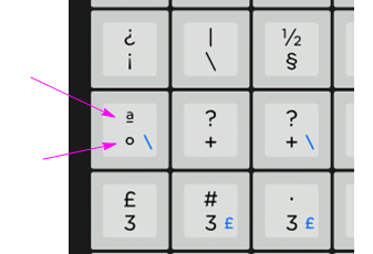

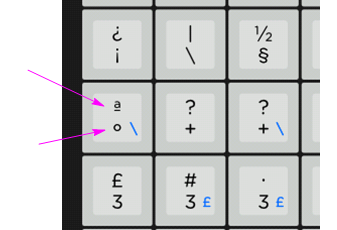

by Kurk
The masculine and feminine ordinal indicators in international set 1 are not consistent. The feminine one is underlined, the masculine one is not.

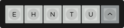

I'm also wondering what the deep-dish, dark grey caret in the homing kit is. Some part of the discussion I've missed, probably.
Posted: 23 Mar 2014, 23:23
by matt3o
Kurk wrote:The masculine and feminine ordinal indicators in international set 1 are not consistent. The feminine one is underlined, the masculine one is not.
that's how Gotham is done, we can discuss that, but I see ° as degree symbol, as such without underline.
Kurk wrote:I'm also wondering what the deep-dish, dark grey caret in the homing kit is. Some part of the discussion I've missed, probably.
homing when the arrow cluster is in one block together with alpha/mods (65/75% layout mostly)
