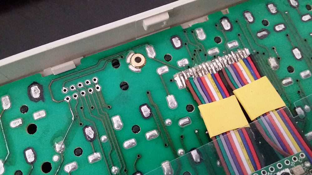

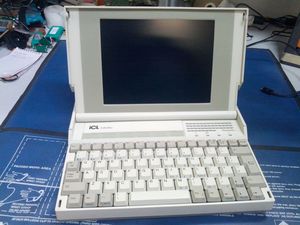

Hi,

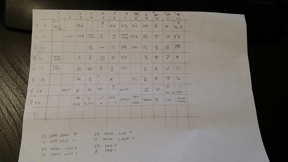

I have a pair of old ICL NB386S laptops circa 1992 and I have managed to cobble together a single working machine from the pair. I wanted to cram a single-board-computer such as a raspberry pi and an lcd into the case of the non-functioning laptop and naturally I want to use the original keyboard.
I'm somewhat of a novice when it comes to software and I have run into a dead-end trying to figure out what I need to do and how to program the keyboard.

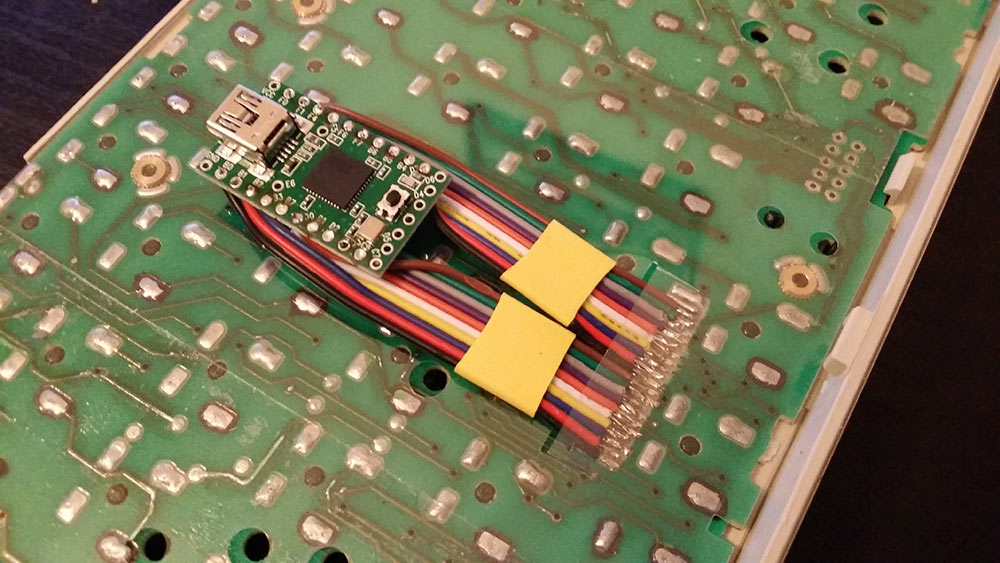

I have used a teensy 2.0 and connected it to the keyboard. I have mapped out the keyboard matrix so I know what all the connections are and how the connect to the teensy.
I have been scratching my head about the software, there is plenty of information about the hardware side of things but when it comes to the software I'm a little lost.
I humbly ask for some assistance, I have a bucket of beer tokens to hand out in return :)

I have read through quite a bit of documentation relating to the mechanical side and the wiring and avoiding the LED was a common point :)
I'm still scratching my head over the software side of things though.....

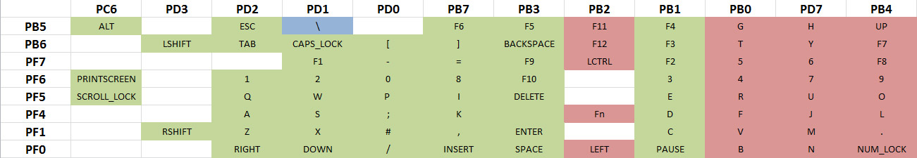

Progress, of sorts..
I have the matrix detection working and everything has flashed to the teensy.
hid_listen seems to only pick up four key presses G, H, T & Y the rest don't seem to do anything.
T = \4E /4E
Y = \06 /06
G = \4D /4D
H = \05 /05
I took out a pair of resistor arrays when I was prepping the keyboard, should they go back in?

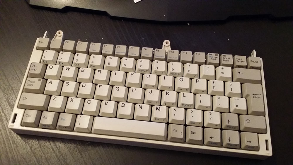

I presume so. I have some photos from when I took it all apart but they are on my workshop pc and I can't get at them until Monday.
ViciousPenguin
29 Jan 2015, 10:15
I've dug out a photo of the keys...

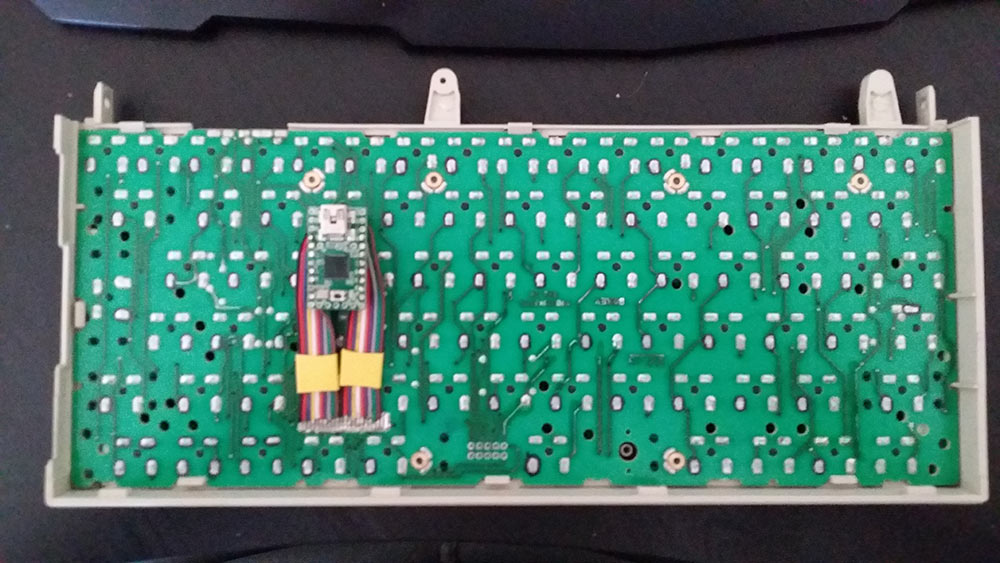

I'm going to undo the wiring I have done and reconnect it a row and column at a time and make sure it works with each new connection....
ViciousPenguin
29 Jan 2015, 16:39
So I have been doing some poking around and it would seem that the teensy is only recognising a few of the inputs even though the key-presses are happening.
Do the pins need to be enabled, or anything similar?

You can test your software configuration with a short piece of wire by connecting two pins directly on the teensy and looking if hid_listen turns out the expected result (row/column).
If you have a multimeter, you can also check your wiring by measuring the resistance between teensy pins when you press a key. It should go down to a few Ohms (from the diode) when a key is pressed.
The resistors are probably not part of the matrix, so I would leave them out.
Halvar
29 Jan 2015, 17:50
Oh, you have to edit the kevex file according to your matrix. You can leave the keys unassigned for first tests, but you have to edit the teensy pin names (PB0, PB1, ..., PB7, PC0, PC1 ... PC7, ...):
The columns are the pins that the current flows to. The diodes should have their cathodes (marked by the printed rings on the diodes) in the logical direction of these pins:
sense         PB0         PB1      PB2         PB3      PB4      PB5         PB6         PB7
Replace PBO PB1 etc. by the pins you're using for that.
These are the pins that the current flows from (rows of the matrix):
strobe   PD7      UNASSIGNED   UNASSIGNED   UNASSIGNED   UNASSIGNED   UNASSIGNED   UNASSIGNED   UNASSIGNED   UNASSIGNED
   strobe   PE0      UNASSIGNED   UNASSIGNED   UNASSIGNED   UNASSIGNED   UNASSIGNED   UNASSIGNED   UNASSIGNED   UNASSIGNED
   strobe   PE1      UNASSIGNED   UNASSIGNED   UNASSIGNED   UNASSIGNED   UNASSIGNED   UNASSIGNED   UNASSIGNED   UNASSIGNED
   strobe   PC0      UNASSIGNED   UNASSIGNED   UNASSIGNED   UNASSIGNED   UNASSIGNED   UNASSIGNED   UNASSIGNED   UNASSIGNED
   strobe   PC1      UNASSIGNED   UNASSIGNED   UNASSIGNED   UNASSIGNED   UNASSIGNED   UNASSIGNED   UNASSIGNED   UNASSIGNED
   strobe   PC2      UNASSIGNED   UNASSIGNED   UNASSIGNED   UNASSIGNED   UNASSIGNED   UNASSIGNED   UNASSIGNED   UNASSIGNED
   strobe   PC3      UNASSIGNED   UNASSIGNED   UNASSIGNED   UNASSIGNED   UNASSIGNED   UNASSIGNED   UNASSIGNED   UNASSIGNED
   strobe   PC4      UNASSIGNED   UNASSIGNED   UNASSIGNED   UNASSIGNED   UNASSIGNED   UNASSIGNED   UNASSIGNED   UNASSIGNED
   strobe   PC5      UNASSIGNED   UNASSIGNED   UNASSIGNED   UNASSIGNED   UNASSIGNED   UNASSIGNED   UNASSIGNED   UNASSIGNED
   strobe   PC6      UNASSIGNED   UNASSIGNED   UNASSIGNED   UNASSIGNED   UNASSIGNED   UNASSIGNED   UNASSIGNED   UNASSIGNED
   strobe   PC7      UNASSIGNED   UNASSIGNED   UNASSIGNED   UNASSIGNED   UNASSIGNED   UNASSIGNED   UNASSIGNED   UNASSIGNED
Replace PD7 PE0 PE1 ... by the pins that you're using.
If you have that, you can test your wiring by pressing keys, and hid_listen gives you the row and column of the key that you pressed.

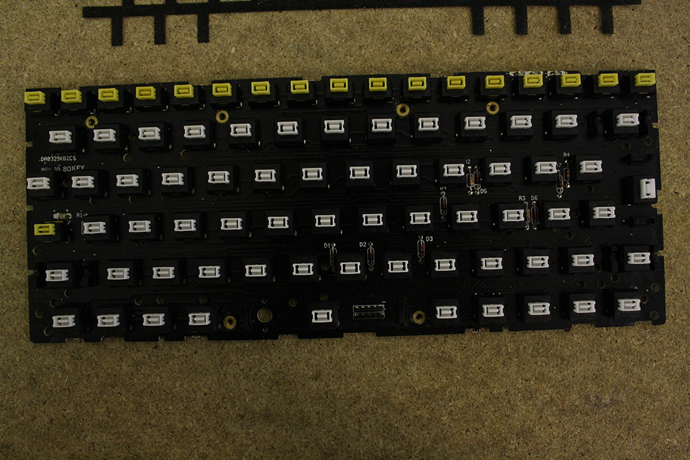

29 Jan 2015, 19:13
Curses. Another SKFS keyboard with a non-Alps PCB.
The white switches are clicky, right? The series name for the yellow ones is unknown — SKFR is offically linear (per the 1994 Alps catalogue) but nobody knows whether the black ones are linear or not, only that the white ones are clicky and possibly also tactile. The yellow ones will be linear though.

I have two of the keyboards if some poking around inside the keys is required.
Can you expand on 'clicky' they all feel pretty much the same to press.
29 Jan 2015, 20:27
You must be new here … indeed! :)
"Clicky" means that if you press a key too slowly to hear any impact sound, it still emits a distinct click. Generally the pressure you feel against your finger disappears at the same time as you hear a click. In yours, there should be a small folded flat spring that is flexed and released, and it impacts on the inside of the switch after release with a sharp sound.
This is the switch series I'm thinking of: [wiki]Alps SKFR/SKFS[/wiki]
They're not widely documented, and your keyboards predate the only confirmed data on them, from 1994.
29 Jan 2015, 20:30
Yup. Tactile switches are similar, but don't make an audible click, you just feel the bump instead. Linear switches, meanwhile, do neither; they just slide smoothly.
ViciousPenguin
29 Jan 2015, 20:40
Ah ok. I shall have a play again tomorrow and report back.....

First off the white keys are clicky and the yellow are linear :)
Secondly I have rewired the keyboard and teensy together, and edited the configfile.
matrix
	scanrate 1
	debounce 5
	sense			PC6			PD3			PD2			PD1			PD0			PB7			PB3			PB2			PB1			PB0			PD7 		PB4
	strobe	PB5		LALT		UNASSIGNED	ESC			BACKSLASH	BACK_QUOTE	F6			F5			F11			F4			G			H			UP
	strobe	PB6		UNASSIGNED	LSHIFT		TAB			CAPS_LOCK	LEFT_BRACE	RIGHT_BRACE	BACKSPACE	F12			F3			T			Y			F7
	strobe	PF7		UNASSIGNED	UNASSIGNED	UNASSIGNED	F1			MINUS		EQUAL		F9			LCTRL		F2			5			6			F8
	strobe	PF6		PRINTSCREEN	UNASSIGNED	1			2			0			8			F10			UNASSIGNED	3			4			7			9
	strobe	PF5		SCROLL_LOCK	UNASSIGNED	Q			W			P			I			DELETE		UNASSIGNED	E			R			U			O
	strobe	PF4		UNASSIGNED	UNASSIGNED	A			S			SEMICOLON	K			UNASSIGNED	FN1			D			F			J			L
	strobe	PF1		UNASSIGNED	RSHIFT		Z			X			BACKSLASH	COMMA		ENTER		UNASSIGNED	C			V			M			PERIOD
	strobe	PF0		UNASSIGNED	UNASSIGNED	RIGHT		DOWN		SLASH		INSERT		SPACE		LEFT		PAUSE		B			N			NUM_LOCK
	unstrobed -PD0	UNASSIGNED
	unstrobed -PD1	UNASSIGNED
	unstrobed -PD2	UNASSIGNED
end
There has been a massive improvement over the number of keys that now work!
It still isn't quite all of them but I have found a pattern to the fails, which I present below.
The green ones work and the reds don't. The blue box is highlighted as the key assignment is set to BACKSLASH but it outputs #~. I need that key for PF1/PD0 for the # key which you will see BACKSLASH used twice in the matrix config file. I guess there is something wrong in the flashed hex file? I couldn't find anything in the docs for the #~ key apart from 3.
Am I right to assume that the errors are due to the polarities? Could it have something to do with the LEDs as the Num lock, Caps lock, Scroll lock and pad LEDs connect to the failing key columns?
Halvar
30 Jan 2015, 15:52
The thing about the LEDs is strange, they should not be connected to the matrix at all. There should be traces that go from the controller to each LED and from the LED through a resistor to GND, and they need their own output pins on the teensy, one for each of them.
Since most of the columns work I don't think there's a diode polarity problem.
