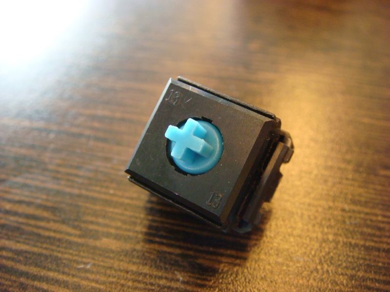

by Daniel Beardsmore
Something like this, you mean?
AKF Cherry MX mount -- top, angled.jpg (70.41 KiB) Viewed 21392 times
[wiki]Hua-Jie AKF Cherry MX mount[/wiki]
Unfortunately these photos came from someone who doesn't speak much English, and all I know is that they were samples from Strong Man from just before Strong Man went out of business. One can only guess as to why they never knowingly went into production.
Posted: 08 Mar 2015, 13:56
by Muirium
Nice one. Looks spot on, doesn't it? How different are the insides from the present Matias? I assume it's a fair bit of work, but definitely doable.
If Matias made switches like that, and appropriate stabilisers, he could make vastly more attractive boards with full compatibility with all the MX caps GBs. And we could get around designing customs with hybrid switch layouts so to make the best use of his nice mechanism while retaining MX when wobble's a problem. Matias alphas and MX mods comes to mind!
Posted: 08 Mar 2015, 14:08
You've got access to the same photos as I have.
My only concern is that the fat ring around the base of the keycap stem would get in the way of the click leaf. I don't possess the switch, so I can't test this; it just looks suspect to me. Also, that sample switch is indeed linear.
Well, you have some Matias switches in your possession, I assume. I also assume you have at least one narrow copper leaf Alps clone switch — the switch above appears to just be a bog standard T1 clone with the slider and upper shell modified.
SKBL/SKBM and Matias switches are not the same design inside as T1-style switches. They're much closer to T8 (which may have a compatible shell with T5 — T5/T8 gets weird).
This is pure speculation, but the key consideration appeared to be finding ways to reduce the switch height. Cherry placed the slider stem on a platform that descends inside the switch, which is what had to be done to the switch above. Alps decided that it would be easier to reverse the polarity of the neutron flow — the keycap was redesigned to have only a small nub, and that meant that the slider could entirely disappear inside the switch. Hi-Tek instead wrapped the keycap around the slider. Normally, the keycap sits above the top of the switch to the tune of the switch travel, and is resting above the switch when fully depressed. Maybe the following hasty and horribly inaccurate diagram will help:

Cherry put the clicker below the slider, while Alps placed it to the side, and that's where you seem to get interference: the platform that the keycap rests on looks like it's going to come down into the gap where the click leaf needs to be pulled forwards.

Posted: 08 Mar 2015, 15:49
by bhtooefr
Actually, MX mount Matias could probably be done by making the switch case larger (as Alps-type switches have a smaller case than MX), without making it taller, although there'll be some restriction on keycap profiles I think. (And, height reduction may even be somewhat possible by taking a trick from the Cherry MX bag, of having the spring extend down through the PCB. It's worth noting that Alps is 3.5 mm travel, not 4.0 mm like Cherry or buckling spring.)

I'm not an engineer. Looking at one of my Cherry MX mount doubleshot keycaps (from EK — guessing they're GMK) the stem within the keycap is marginally wider (something like 0.1 mm) than the Matias slider on either side. I am not sure why the clone switch above needs a large circular platform to support the keycap, but if you could remove that, you should be able to do it. That platform might reduce strain on the slider stem itself by ensuring that tilt pressure on the keycap is met by the platform instead of the stem, otherwise the stem might snap.
The engineering-orientated folk amongst us might have a better idea on this one.
That circular platform will definitely block the click leaf in a Matias, which swings forwards to rest against the slider before being released. The switch would still work, but the click leaf would only move forward half as much, and that would alter the feel — I assume it would force the click to occur higher up in the travel and reduce the amplitude of the click.
One possibility would be a circular cutout at the top of leaf to clear that platform. Interestingly, cutouts at the top of click leaves do occur in several designs, including Omron B3G-S series, so it's a possibility; what effect this has on the switch, I do not know.
