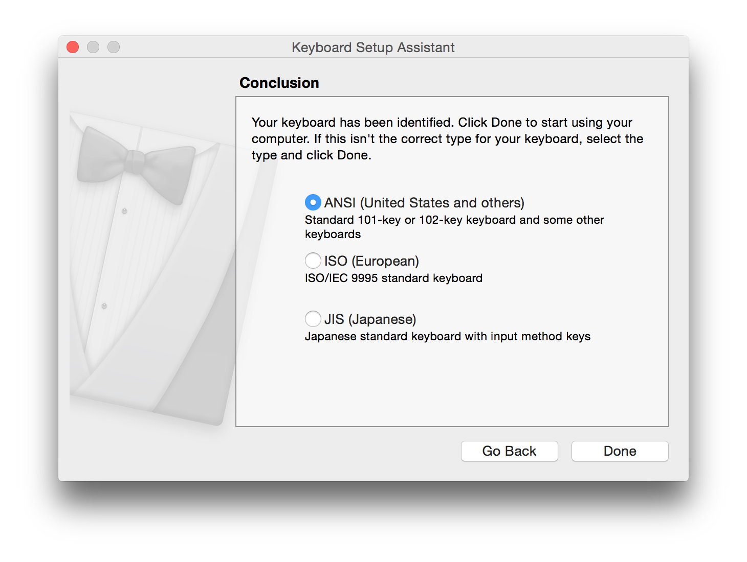

Posted: 09 Jun 2014, 01:48
by Muirium
For what it's worth, JIS isn't just our description for it. This is the dialogue box that shows up when I connect a new keyboard on OS X:
Screen Shot 2014-06-09 at 12.46.07 AM.png (245.09 KiB) Viewed 6000 times

Posted: 09 Jun 2014, 15:23
by Muirium
I should have clarified that the keyboard layout wizard I showed above is only run when connecting a non-Apple keyboard for the first time. I think, as with most of its own stuff, Apple recognizes the exact ID of its own USB keyboards and even renders their specific hardware layout (full size/sub TKL/smooshed together function row etc.) in Keyboard Viewer; while everything else is shown as a Model M style map, even when it's an HHKB or my Kishsaver!
Presumably the USB HID spec just doesn't cover signalling to the host what language layout or physical size you actually are. So operating systems must ask the user, and need to mention these terms, like JIS.
