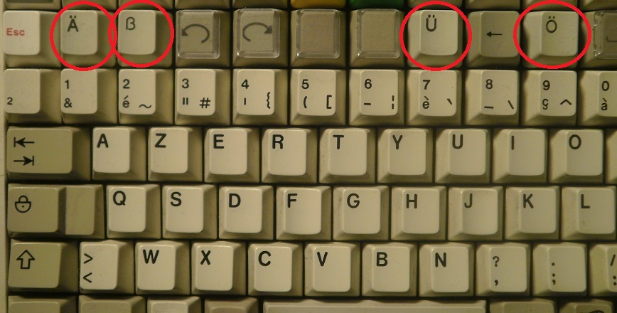

by kbdfr
Acanthophis wrote:US-Intl. Layout. Easy.
Wer brauch schon deutsche Keycaps? ;)
So mancher:
:mrgreen:
