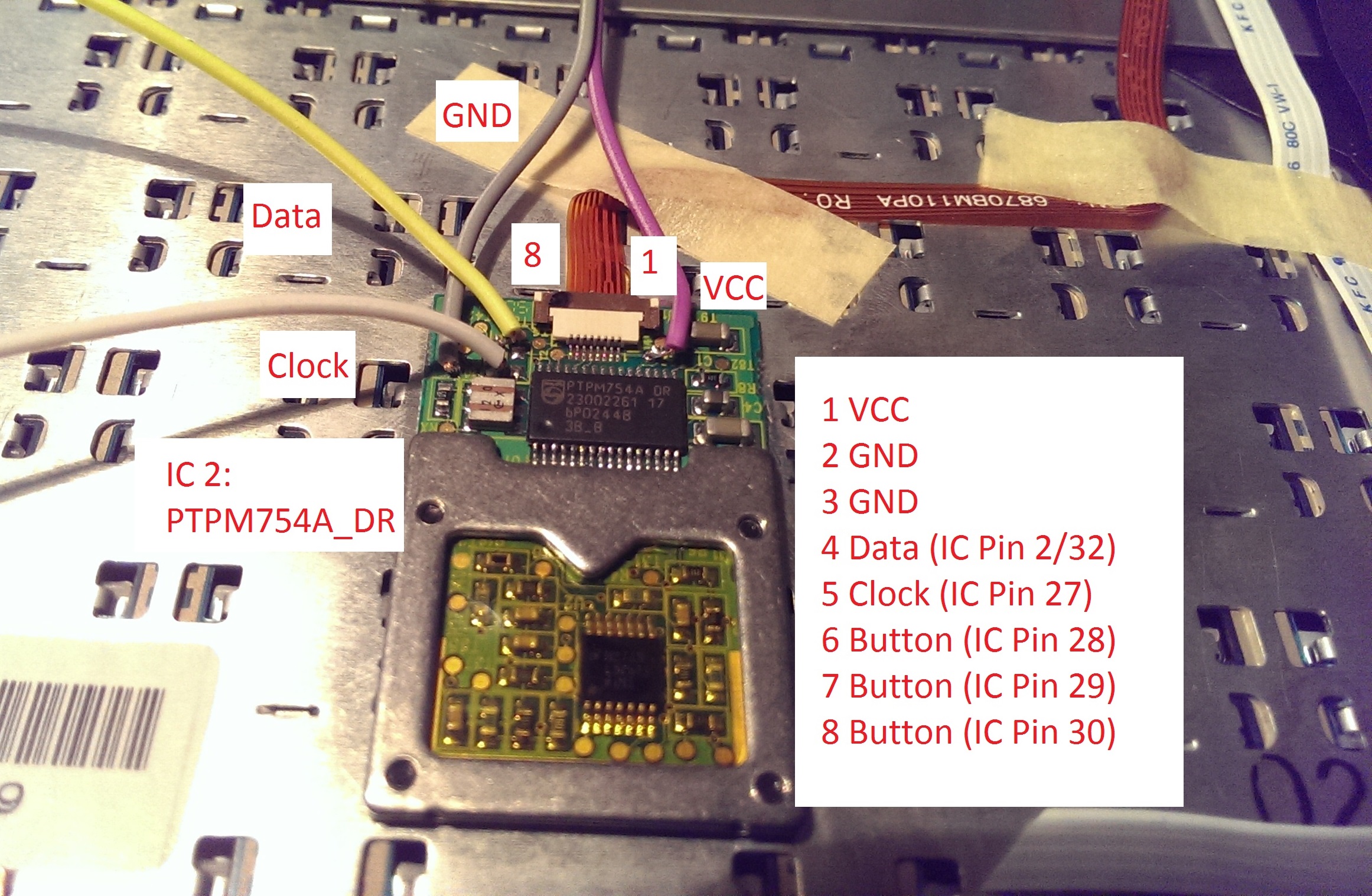

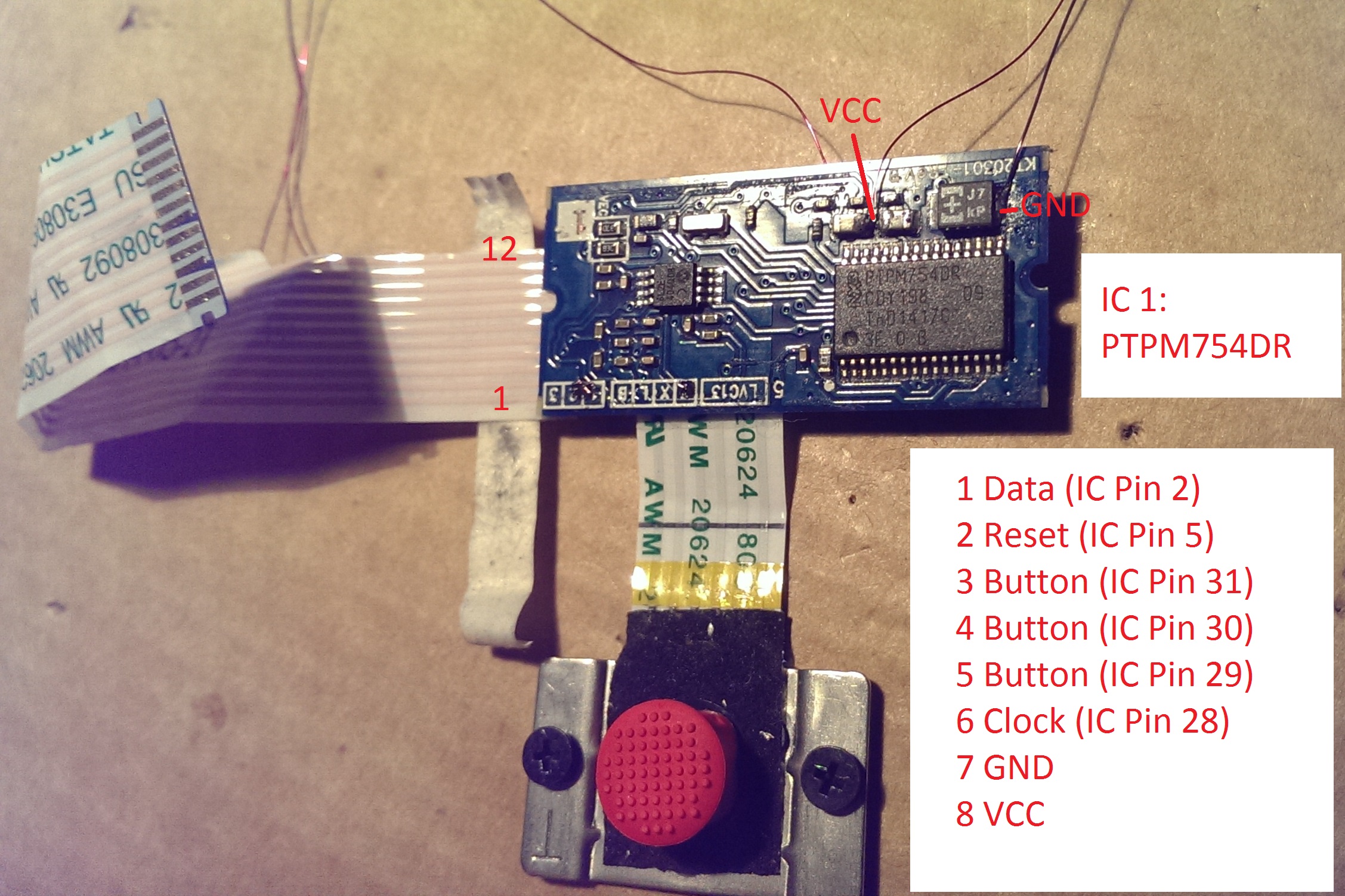

IC 1:
PTPM754DR Pinout like in the datasheet of the old IC TPM754, you have to omit the pins 15, 16, 17 and 18 of the PTPM754DR (they are connected to GND), the other pins are the same as on boh IC versions
(https://www.mikrocontroller.net/attachm ... tpm754.pdf)
IC 2: PTPM754A_DR, not the same pinout as IC 1, Data is on the same pin, Clock not
Pinout details:
IC 1:
Trackpoint Lenovo ... :
Connector PTPM54DR-Pin Function
1 2 Data
2 5 Reset
3 31 Button
4 30 Button
5 29 Button
6 28 Clock
7 GND
8 VCC
9 nc (not connected)
10 nc (not connected)
11 nc (not connected)
12 nc (not connected)
PTPM54DR Pinout:
GND: 8, 13, 15, 16, 17, 18, 32
VCC: 26
IC 2:
Trackpoint HP Compaq TC1100
Connector PTPM54A_DR-Pin Function
1 VCC
2 GND
3 GND
4 2 Data
5 27 Clock
6 28 Button
7 29 Button
8 30 Button
PTPM54A_DR Pinout
GND: 3, 9, 15
VCC: 16, 25
IC 1 PTPM754DR
IC 1 PTPM754DR
IC 2 PTPM754A_DR
IC 2 PTPM754A_DR
For IC 1 I wired the connections corresponding the schematic in this thread (4.7K pullups on Clock and Data, 2.2u and 100k on Reset).
Then I connected the circuit to an arduino uno (atmega328) with the PS/2 test sketch. But it didn't worked (the sketch should print out the mouse-data on UART/RS232)
The sketch works for an ps/2 mouse but not for this trackpoint.
Does anyone know working ps/2 mouse firmware for atmega328 or atmega2560? (or do I need a teensy?)
Does the tmk_keyboard firmware work for such a trackpoint/ ps2/mouse? (https://github.com/tmk/tmk_keyboard)
If yes, which part of this repository should I build and flash?
I think the ps/2_usb converter of the tmk_keyboard repo works only for keyboards. Am I right? (https://github.com/tmk/tmk_keyboard/tre ... er/ps2_usb)
At the moment I don't really need a firmware which works as USB-HID, I would be happy if I see some debug-info over UART/RS232.
Thanks for your help.
