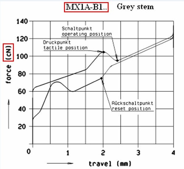

Posted: 17 Oct 2013, 16:30
by yab8433408
http://deskthority.net/wiki/Cherry_MX

Posted: 17 Oct 2013, 16:56
by yab8433408
1CN ≠ 1g
MX1A-B1xx ≠ 150g
Posted: 17 Oct 2013, 17:02
by Muirium
1CN = 1.02 grams of force, according to Wolfram Alpha. (The difference between assuming 10 and 9.81 ms^-2 for gravitational acceleration I assume.) In any case, not enough to explain the difference in these figures.

Posted: 17 Oct 2013, 23:13
by Daniel Beardsmore
I don't remember now — shows how little attention anyone ever pays to anything I put on the wiki, if it takes a Chinaman to spot the mistakes … I'll update the data based on the catalogues I've got.
The one depicted in this topic is not a MX1A-B1xx though, as that's tactile (per the catalogue), and the depicted switch is clicky.

Posted: 18 Oct 2013, 01:32
Dunno, but now this topic now has a photo claiming that click grey is MX1A-B1 :P
Posted: 18 Oct 2013, 02:09
Actually, I think yab8433408 is correct, and Cherry are wrong.
The 1994 "Keymodule MX" brochure has white (A) and grey 36 (B) down as "tactile" with "Movement Differential" (hysteresis). It looks like the only switches that have hysteresis are the clicky switches (with this being generated by the sliding collar), and we understand white to be clicky, not tactile. Therefore, it stands to reason that, just as they missed the word "Click" from the description of A, they missed it from B, too, making yab8433408 correct: MX1A-B1xx is indeed click grey. (They write "Click" in quotes — they seem more concerned with hysteresis than the click in the brochure.)
As such:
  • No evidence to date that "super grey" exists; "super black" is confirmed, but has no known part number
  • MX1A-B1xx is [wiki]Cherry MX Click Grey[/wiki]
  • I've updated [wiki]Cherry MX[/wiki] per my 1994 brochure, except for the actuation forces, which are in dispute (e.g. the alleged 60 cN for MX blue) — all my newer brochures are useless and don't list all the variants
What's interesting is that there is a "cam" (bump) on the stem of the hysteresis switches: Cherry make a point of ensuring you can recognise these (see yabb's images above). This is further evidence that, since B has a cam, it should be clicky like white (A), green (E) and blue (F). I have no idea what this was meant to be about.
