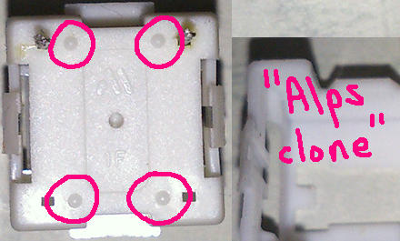

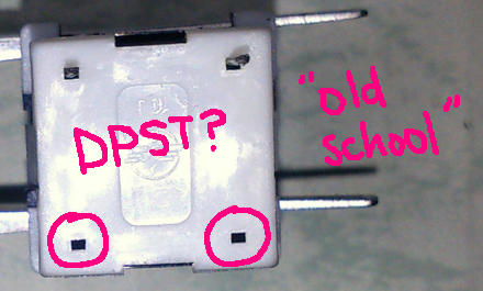

A couple of things I noticed:
1) Holes which appear to support DPST:
- Old school -- possible support for DPST.jpg (24.44 KiB) Viewed 6909 times
Some Tai-Hao APC series switches have "reversible" lower shells, and I thought it was just done to ease manufacturing, by allowing the parts to be placed either way around. Maybe Tai-Hao once sold DPST switches too. DPST isn't all that common, but Cherry made them.
2) The old-school switches didn't have the little bumps that keep the switch away from the PCB (or whatever it is that they do):
- ''Alps clone'' PCB separator bumps.jpg (27.03 KiB) Viewed 6909 times
Does that affect the PCB-to-plate distance, or were the old switches slightly taller?

Switches were actually exchanged.
TDK-T12V→M3501
The switch was expensive and was not fixed to the plate. The leg used as a point of contact has come out.
M3501→TDK-T12V
The switch was low and was fixed to the plate. However, the leg used as a point of contact did not come out.
http://kbd.rzw.jp/mitsumi_/apple_tdk-t1 ... DK-T12V_25
Posted: 03 Apr 2014, 20:03
by Daniel Beardsmore
Ah, so the PCB-to-plate distance is different between the two switches.
