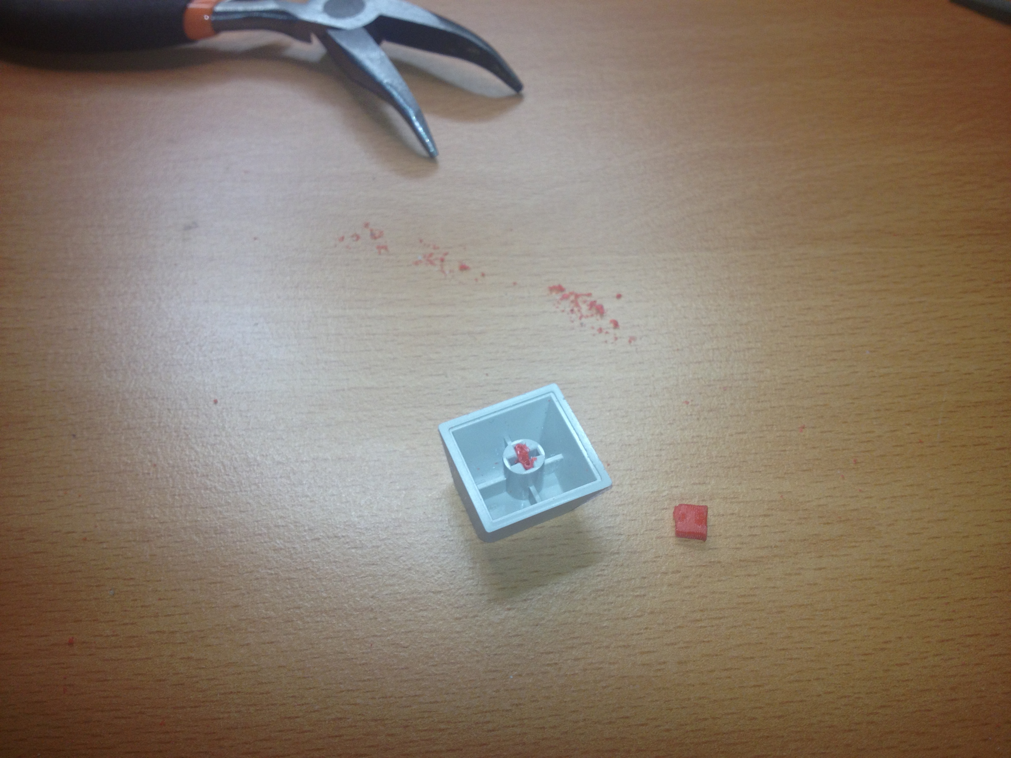

With this thread I'm going to tell you how I made the cherry to alps adapters. With these adapters you can put cherry caps on an alps keyswitch.
The design in FreeCAD :
The printing of the protos
The result after printing
First protos :
Grrrrrrrrrr.....
Grrrrrrrrrr.....
2013-01-22 09.32.45.jpg (2.07 MiB) Viewed 30609 times
New design based on protos :
Cut some corners
Cut some corners
Screen Shot 2013-01-22 at 11.09.02.png (31.07 KiB) Viewed 30562 times

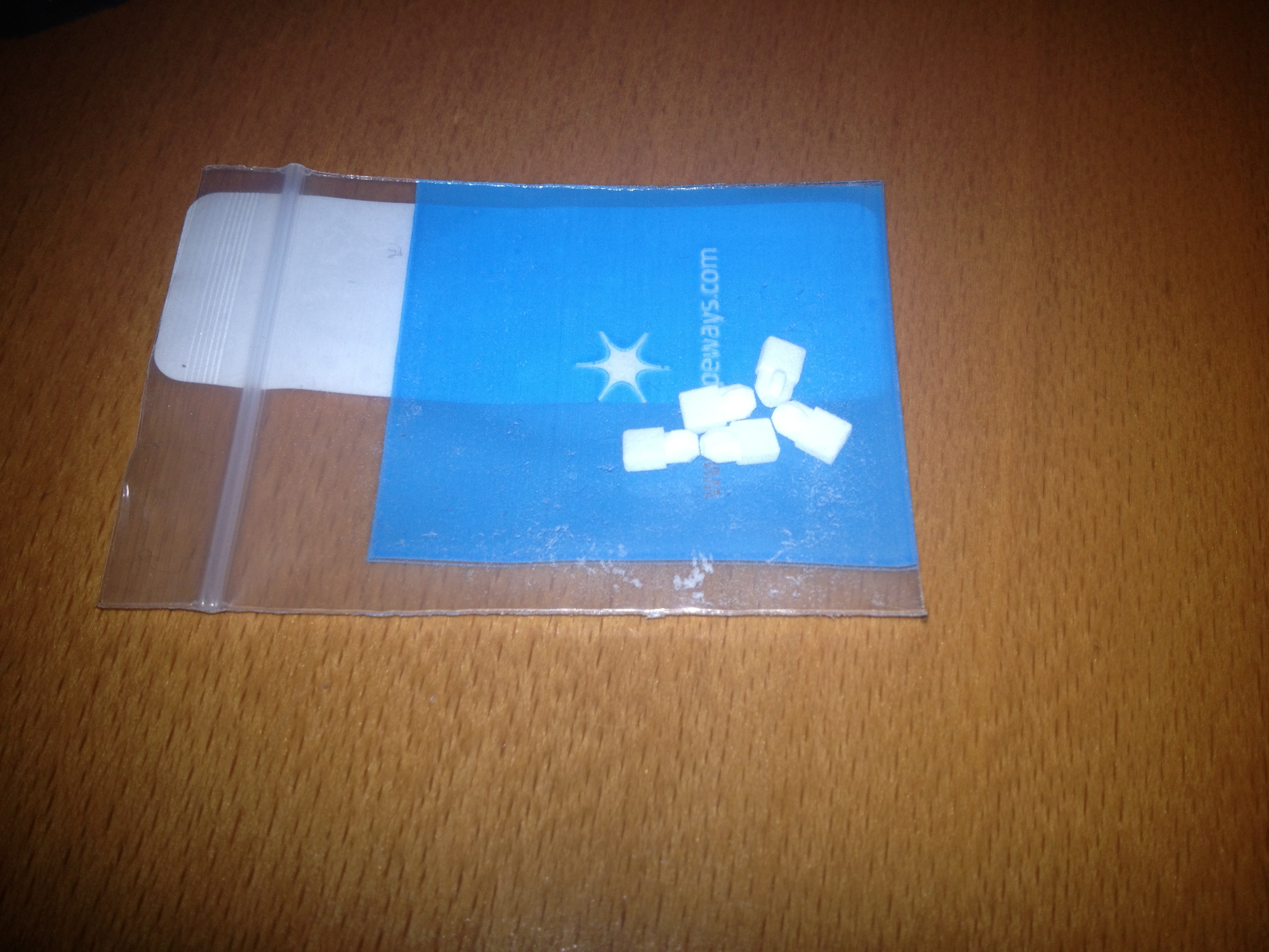

Posted: 01 Feb 2013, 18:20
by Mrinterface
2013-02-01 18.17.52.jpg (1.99 MiB) Viewed 30283 times
Posted: 01 Feb 2013, 18:39
by phetto
Does it work well?
Posted: 01 Feb 2013, 19:03
by Mrinterface
Preliminary results :
Cap is slightly higher ( need to measure the difference with a normal Alps cap ) and the Alps section turned out to be too small so that could be slightly bigger. My approach to the MX side of the adapter seems to work...
More info after I have some time to dive into it.

Posted: 23 Feb 2013, 02:57
by calavera
When you get this into production I will be first in line to buy them!!
I think for the adapter to work you really need them to be durable. As you know it takes a lot of force to pull alps key caps off their switches. I see these snapping off easily like that red prototype there. Good luck, I'm keeping my eye on this thread.
