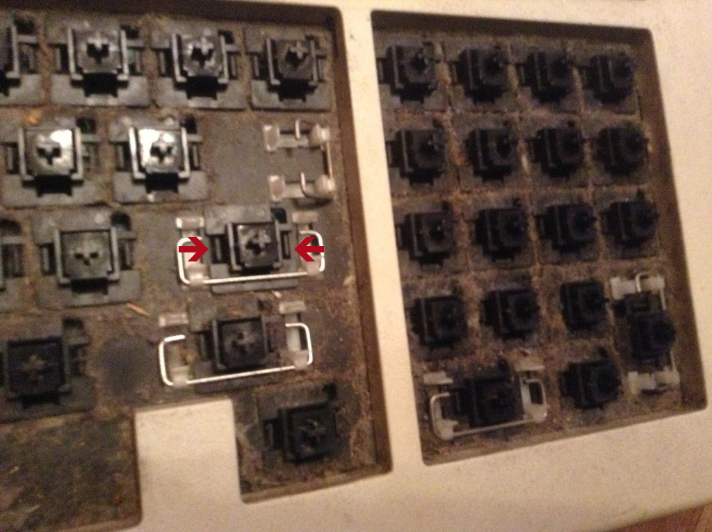

What do you think guys, should I try to clean it, wash it?
It feels pretty nice.
Tell me, do you recognize switches?
Because I don't... It seem that they aren't Cherries?
Also, is there any good tutorial how to wash/clean the mechanical keyboard to the very very small detail?
Thank you, and I hope that someone can tell me more about this one! :D
Also, it got the old 5-pin connector, so ye, might need some modding...

For cleaning, I take off all the keycaps and let them soak in some dish soap, scrub a bit if needed. For the case take the pcb out and wash it in the sink. For the PCB I would use some compressed air to clean off any dust while you have it all apart.
If it's AT you just need a simple AT to PS/2 adapter. If it's XT then you would need to do quite a lot more to get it working with a controller converter or swap.
As far as the switch, if it is what I am thinking it's a capacitive type. Push in those 2 tabs on each side of the stem to pull it out and see what is underneath. I'm sure some others would be interested to see that as well so maybe take another photo to post of the switch internals.

I took some new photos without caps...
http://imgur.com/a/i1YBB#6

They certainly should be. If this is like one I had before, though it looks a bit different maybe a generation older.
Press in the tabs and pull up on the part the keycap attach, to see what is under. Want to verify if it's the kind I think it is.

I popped up a switch, took some photos, and uploaded it to the album :)
http://imgur.com/a/i1YBB#12

Okay ... now what's in the gap where that used to be?

Ye sorry, I took a photo but forgot to upload that one :D
Here it is, and I added it to the album:
http://i.imgur.com/fK5lEgR.jpg
Posted: 22 Jan 2013, 04:32
by IvanIvanovich
Oh, it's a type of hall effect switch. Not what I was expecting at all. Very nice.

You should be able to clean it nicely using a wet cloth for the case and gently applied pressurized air for the inside.
A hall effect sensor measures the presence of a magnetic field through $physics_magic. (The electrons moving through the magnetic field are diverted because of the Lorentz force and this causes a voltage because the electrons are out of place. Don't ask me why there is a Lorentz force, I only remember it from highschool physics.)

Basicly from my understading it's one of the more expensive switch types... It's rather rare I think...

They are quite common in old boards but this particular type I haven't seen before.

very interesting switch - and it's mx cap compatible?
how does it feel, probably linear?

Neat, I was attempting to get a board like this a while ago, but wasn't aggressive enough.
I haven't done enough reading to firmly say it. But I don't think it is correct to call this board Hall Effect, since there is no Hall Effect Sensor used to detect the field. Rather the ferrite is transferring a current from one wire to the other in the presence of a magnetic field of sufficient strength.
I have to run, but there's a patent number on a Xerox keyboard that I have (ITW/RAFI magnetic switches) that explains how the sensing works.

Sounds like the sensing is still based on the hall effect (as in the voltage that is built up to counteract the lorence force) even if there is no dedicated hall effect sensor. But it is definitely an interesting and unconventional design. I assume it must have been created at some point when they were trying to make keyboards cheaper but didn't really know how yet and that it was quickly replaced by other even cheaper technologies.

I can't substantiate this (wasn't exactly alive at the time), but apparently ferrite cores were super cheap at the time, but then the cheap supply disappeared...and costs went up significantly.
Here's the patent I was talking about:
http://www.google.com/patents/US4263582
