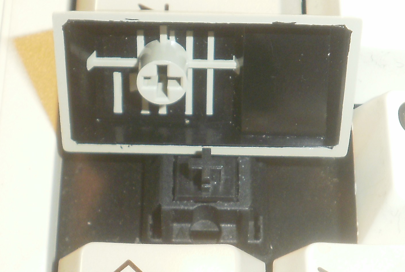

Nope, there is absolutely no room for that because the positions of a centered stem and an off-center differ by only ±5mm while the switch has a width of >10mm.
So the original stem must be removed as it will hit the top of the switch.

Posted: 29 Aug 2012, 12:51
by kbdfr
CapsLock, center vs.jpg (167.26 KiB) Viewed 45177 times
You could could of course leave a bit of the original stem, but that wouldn't be enough to allow such a device to be affixed to it.

This is about as close as they can get while still allowing the stem fitting to enter the switch housing as well as allow the fitting of the cap to not interfere with the bridge. kbdfr is right, they can't be made close enough.
