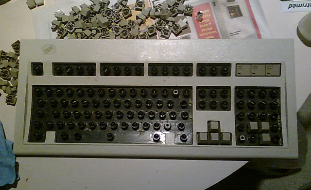

I came across this Model M in a local recycling facility. It is very dirty, and I'm giving it the best of my TLC as we speak.
This is hardcore!
The only problem so far has been that pressing the letter H produces the letter Y. I need some help troubleshooting, where should I start?
Anyway, this thread is worthless without pics, so here we go!

I bet another key is stuck.

Oh crap. Testing this on Aquakeytest showed more similar flaws: numpad 0 and comma produce numpad 5 and 6, both G and H produce different letters, left Alt doesn't seem to work...
I hope this isn't FUBAR!
Posted: 11 Mar 2011, 17:15
by webwit
I'm still betting one of the keys is making contact without you noticing it. Hit them keys, train 'em.
Posted: 11 Mar 2011, 18:26
by Julle
I've now removed the keys (lovely 2-part caps) and 80 percent of what I believe is 20 years of encrusted cum and pizza drippings. I hope messing with the keys will help.
Webwit, I believe you're right about the stuck key. While I removed the keys, I noticed that the up arrow was slightly stuck and out of place. I really hope this helps. I've been looking for an M for such a long time.

Interesting. Now the keys that previously malfunctioned won't function at all. I'd crack this board open in a heartbeat, but I don't have a tool small enough to open the bolts (cue Ripster showing off his).
Posted: 11 Mar 2011, 20:46
by webwit
I've seen lam47 open it with a plastic pan.
You take the cap of the back, and heat the pen with a lighter to a point where the plastic gets soft. You push it down on the bolt and wait till it gets hard again. You turn the pen. You break the pen. (When I tried it) Oh well.

So. the board has had time to rest, it's all cleaned up. I have tried looking for a stuck key. Still I have nonfunctional keys on G, H, Ä, left ALT, numpad 0 and numpad comma.
What could cause something like this? Bad rivets - could a bolt mod save this thing? Could it have a broken membrane? Is the controller faulty? This board is too nice to give up.
Posted: 12 Mar 2011, 16:32
by daedalus
Try cleaning the contacts on the ribbon cable connecting into the controller.
The Model M is such a simple design that unless something has gone wrong with the controller electronics, you can fix just about anything. Even then, you can get your hands on a new controller from somewhere or other.

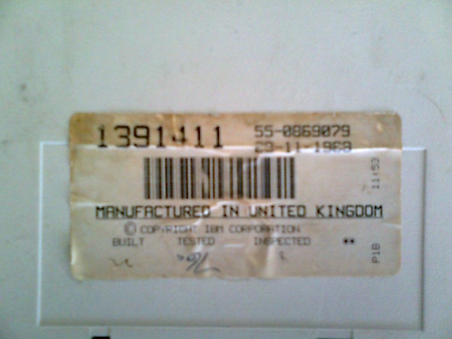

1968? I never could understand the EU date system.
Posted: 12 Mar 2011, 18:57
by keyb_gr
Looking at that label, it wants to be put in its proper place badly. Just curious - are there any proven methods for that? Would sixty's (with hairdryer) apply here?
As for the functional problems, these are odd. Normally I'd say spill damage (the Y/H cross-linking would be an indication, too), but the non-functional keys are spread over the board quite a bit. 'fraid it'll need a bolt mod and membrane cleaning. Obviously sucks if that's your first M...

I think the hairdryer method would work. User "mass" here has reported that he removes labels with a hairdryer for custom case dye jobs too. I just wouldn't know how to best re-apply them, but that should be the easier part.
