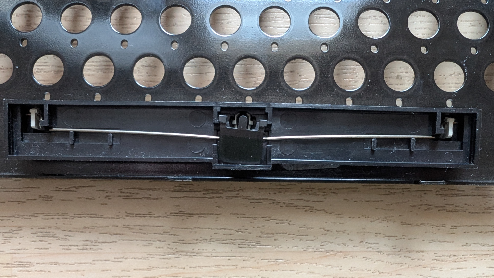

Just another question before I start another try in assembling an F-XT. The flipper of the spacebar goes on top of the metal bar, correct? Like on this photo?
Re: re-assembling Model F
Posted: 11 Apr 2025, 03:49
by DMA
I guess so - no other place to go, really. You should, however, remove all keycaps before attempting reassembly.

DMA wrote: 11 Apr 2025, 03:49 I guess so - no other place to go, really. You should, however, remove all keycaps before attempting reassembly.
Keep the spacebar cap on though. Clipping in the stabilizer is next to impossible when the PCB assembly is closed up.
