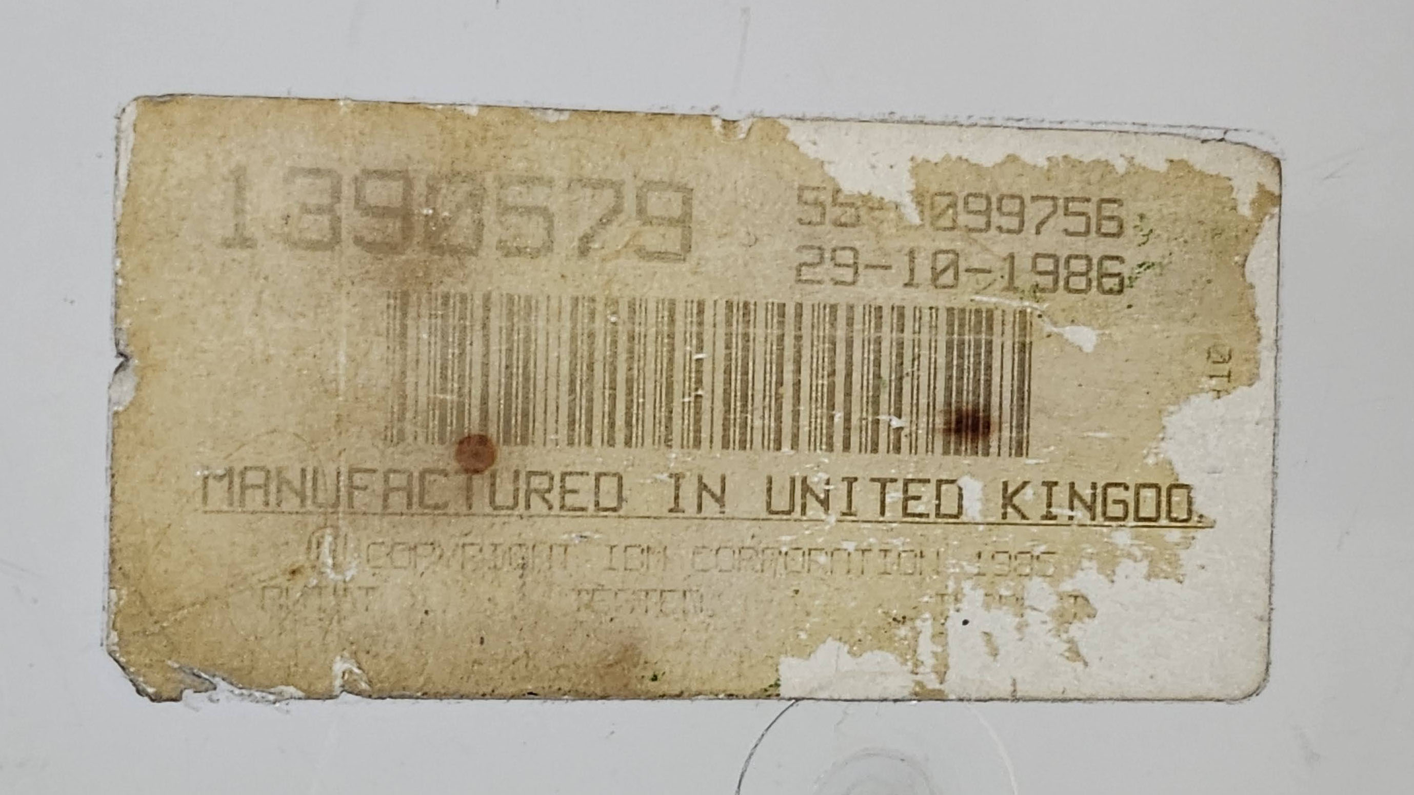

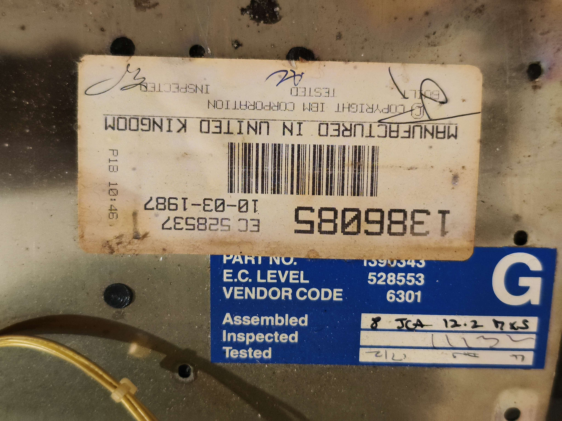

I disagree, I've seen it in quite a few 1985-1987 IBM UK made Model Ms that don't have the simpler dot-matrix style versions. When I was looking for examples during my research, their possible dates all seemed to be uncannily close to the typical rear label's date as well. If the cover set also has a stamped date, the blue sticker's ones make chronological sense of being 'newer' than that but 'older' than the typical rear label's. I've also seen the sticker applied partially under a typical rear label.
Starting with the cover photo's, IMO the numbers you're referring to look like separate days of the same month (so 9th, 9th and 10th). There are other short-form dates above and below them ("9/10" and "13-10") which seem to indicate October, which is just before the typical rear label's 1st November date.
Here's another example where part of the blue sticker is under a typical rear label. There's "12.2" and an (upside-down) "17/2", which both lead up to the typical rear label's 1st March date.

In the "1A" M122 example I have, it has dates "17/10", a singular "12", "20/10" and another (upside-down) "20/10", which are very close to the outer rear label's 29th October.
- bitteneiteGeneric_1387901_IBM-UK.jpg (66.33 KiB) Viewed 11732 times
- 20230603_220232.jpg (356.53 KiB) Viewed 11732 times

The photographs with those stickers under under the dot-matrix versions are certainly interesting!
Still (playing devil's advocate)... why would these keyboards before "general availability" have a sticker with a vendor code on it? Isn't "12 26/10" like 26 december 2010 in American date format? Why does the font strike me as something not used by IBM in the eighties? Why do the stickers not have "IBM" on it which is not typical? Aren't blue labels/seals their historical color for certified reutilized parts?

These are not keyboards before "general availability" (the first new example in my previous reply is a keyboard from 1987). What I meant in the conclusion is that "Keyboard/Model G" as a potential new keyboard
family was scrubbed likely before general availability because even the earliest production Enhanced Keyboards from IBM U.S. (for example) I've seen had "Model M" on the back. "Model G" became a designation for just "Enhanced Keyboard" and was joined by "1A" for 122-keys, which is what these IBM U.K. stickers seem to portray.
webwit wrote: 18 Jun 2024, 17:34
As a singular example, it looks like it (but forgetting one "/"), but on that same sticker there's a "17/10" and "20/10" as aforementioned. Why would they write DD/YY without month or switch to use UK-style MM/YY all of a sudden? Why would they use MM/DD/YY on stickers inside exclusively (to my knowledge) IBM U.K. keyboards with UK date formats nearby?
Not having "IBM" is very typical for
IBM U.K. rear labels until ~1995/1996.
If that was the case, why is the "1A" counterpart red?
IMO, these stickers are not "suspect". The sudden change in font and style is interesting, but ultimately it's not like it's something outside of IBM's capability. Whilst not as contrasting as these, IBM U.S. keyboards could have one of several variants of rear label after all.
