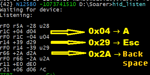

Scratch that.
I ran hid_listen here. I pressed the keys A, Esc and Caps Lock Backspace.

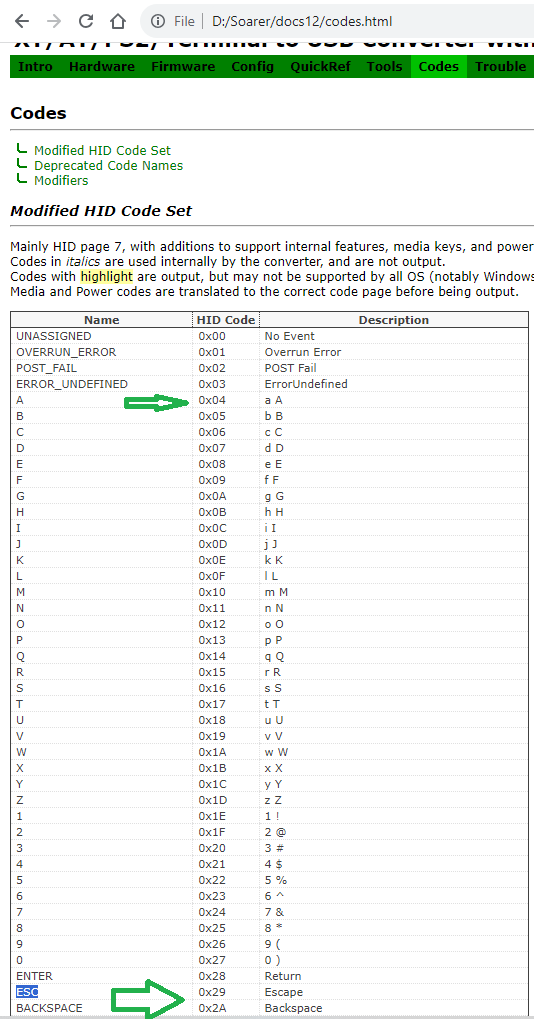

The codes with that 'd' and 'u' are what you want. In this case: 0x04, 0x29, 0x2A.
Go to the Soared docs page codes.html and see the HID codes.
Burn the empty .sc file into the converter, then run hid_listen. Look at the "dnn" code produced by the SysRq key.

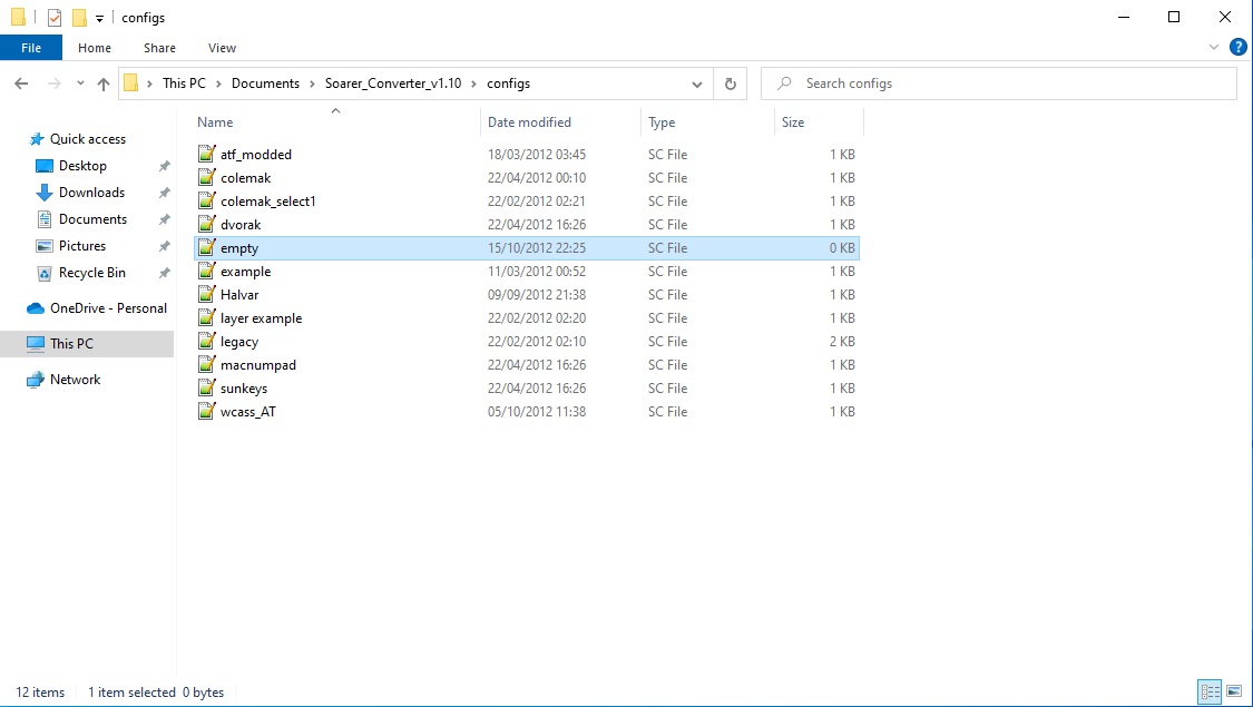

Once you've downloaded and unpacked the zip file, open the "configs" folder. There you'll find sample sc files with examples of scripts that you can make for soarer's converter.
Configs Directory.jpg (100.25 KiB) Viewed 20601 times

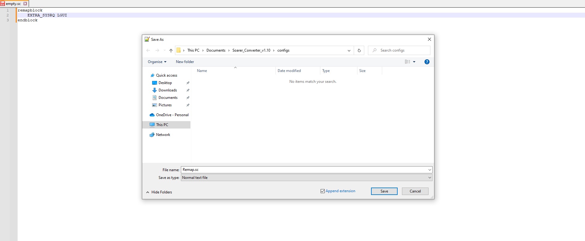

Open the Empty.sc file with either notepad or notepad++. It has no code in it whatsoever so just copy over the code provided from the other forum.
Making SC File.jpg (103.58 KiB) Viewed 20601 times
You can save it with a different name if you want. Just make sure to have ".sc" extension and save as normal text file.

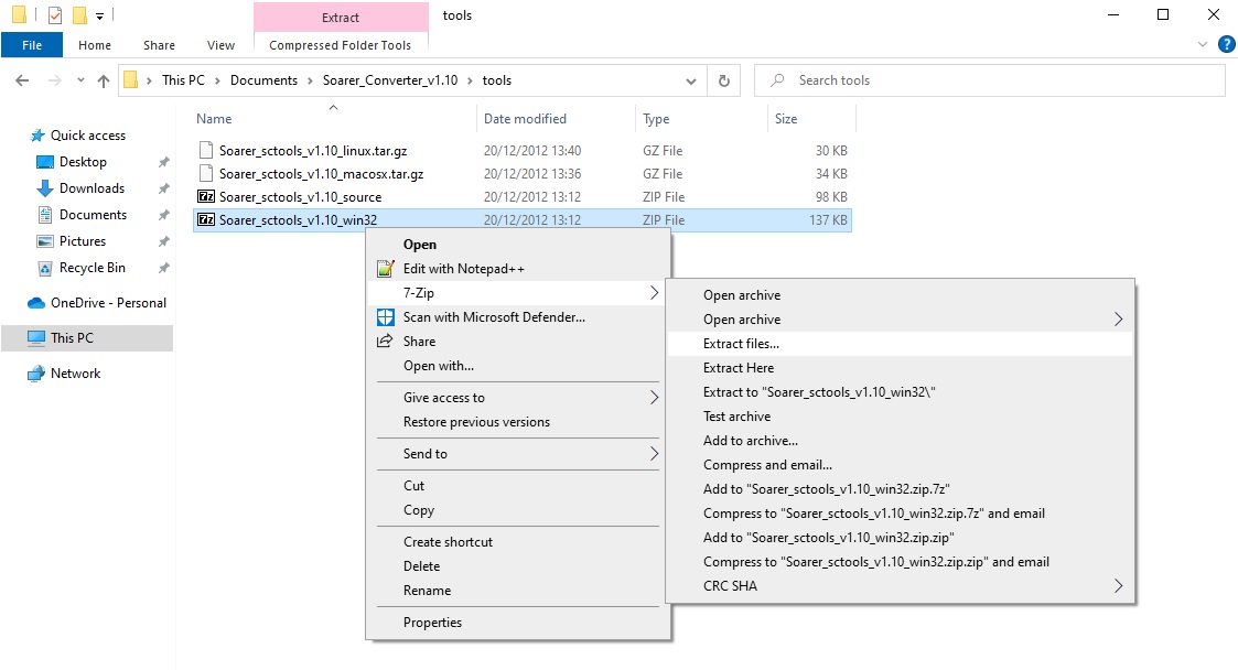

Now head over to the "tools" folder. Inside you'll see some compressed files.
Since you're using windows you need to unpack "Soarer_sctools_v1.1X_win32.zip" (X Denotes final digit of firmware version, 1.10, 1.11 etc).
Extract Tools.jpg (119.13 KiB) Viewed 20601 times

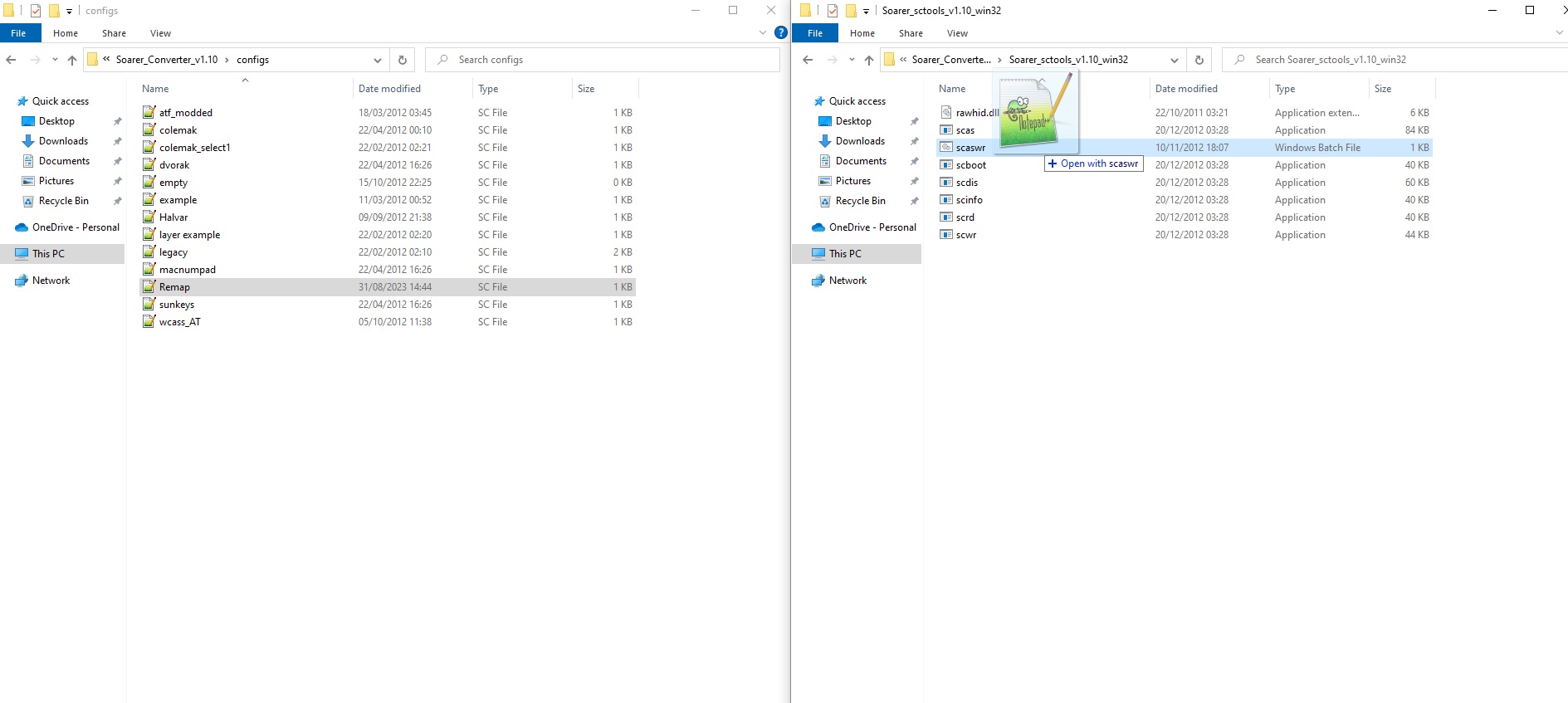

Inside the unpacked folder from tools, you'll see among the contents of the folder "scaswr.bat".
Applying Remap Onto Soarer's Converter.jpg (171.05 KiB) Viewed 20601 times
Just drag and drop the .sc file you created on scaswr.bat and a window will pop up, showing the progress as the bat file "burns" the .sc file into the converter.
And that should be it, hope this helps!

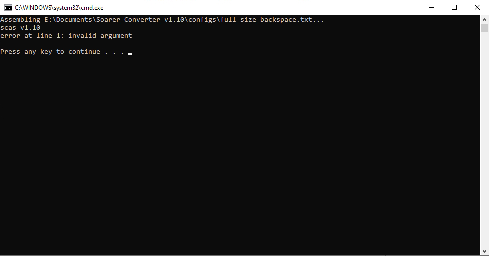

As for getting it on the converter: Wolfi's instructions are good. I'd advise instead of dropping your config file on scaswr.bat—which won't explain your errors?—try running scas yourself if you're at all comfortable with the command line. It'll tell you where you went wrong (we all do, sometimes) and what line number.

Muirium wrote: 31 Aug 2023, 12:03 I'd advise instead of dropping your config file on scaswr.bat—which won't explain your errors?—try running scas yourself if you're at all comfortable with the command line. It'll tell you where you went wrong (we all do, sometimes) and what line number.
My experience with soarer's has only been firmware v1.10 and with this version, dropping .sc file with mistakes on scaswr.bat does mention the line that has the error, though it doesn't explain what the error is. So the issue where it doesn't give any indications of any errors might be limited to older firmwares.
