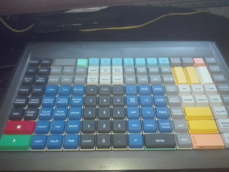

The keyboard has 10 "double size" keys.but my keycaps have only 3,so there are 14 single keys missing.

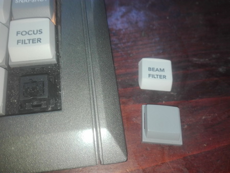

I`don`t know how the different parts are called.Actually I use the original "base" with my lids,so it`s a bit colourfull,wich is ok but not nice.

The "open place" on the picture in my last posting is the switch,right?
The grey button on this pic is the keycap?
And the white button is the lid?
Exactly.
There are so-called "relegendable" keycaps, consisting of 2 parts, the base and the lid. Here a few examples:
In your keyboard, the lids are not transparent, but are opaque and have been pre-printed by Tipro for their customer. In usual relegendables, you can insert a piece of paper between the base and the lid. As the lids are interchangeable, you could replace yours with transparent ones.
