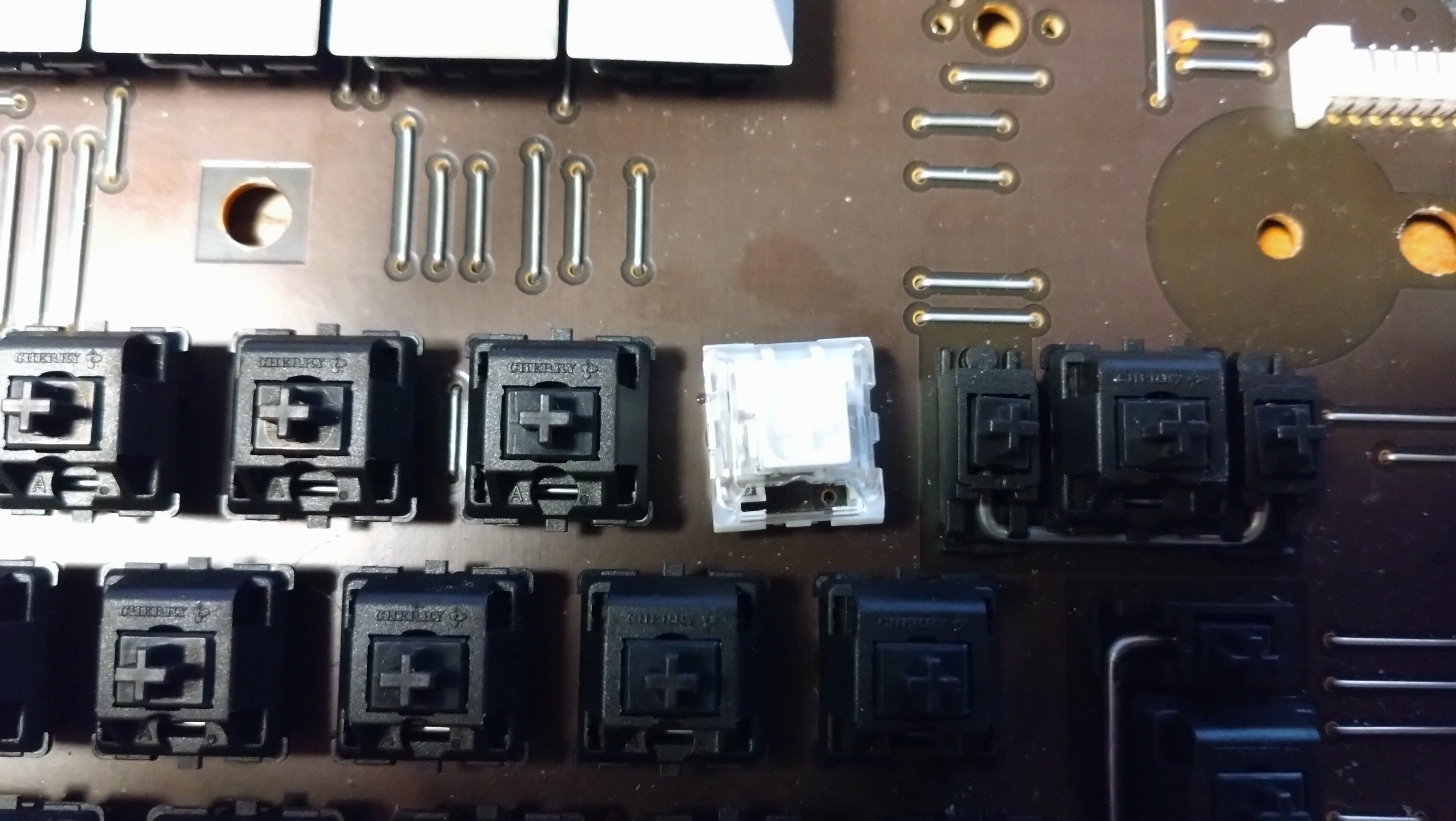

While waiting for the electronic components to get shipped, i was looking for replacement switches because i'm not a big fan of cherry blacks. I found a good deal on kailh box white (i would prefer jades but these were at a good price locally so i went for it.) First time testing click-bar switches and i have to say i am pleased :D However, there are two problems. First one is fairly simple to solve. the original cherry switches have jumpers in them that this board seems to use as part of the matrix. Kailhua doesn't have those. So i will just have to solder some jumpers separately. Other problem is more severe:

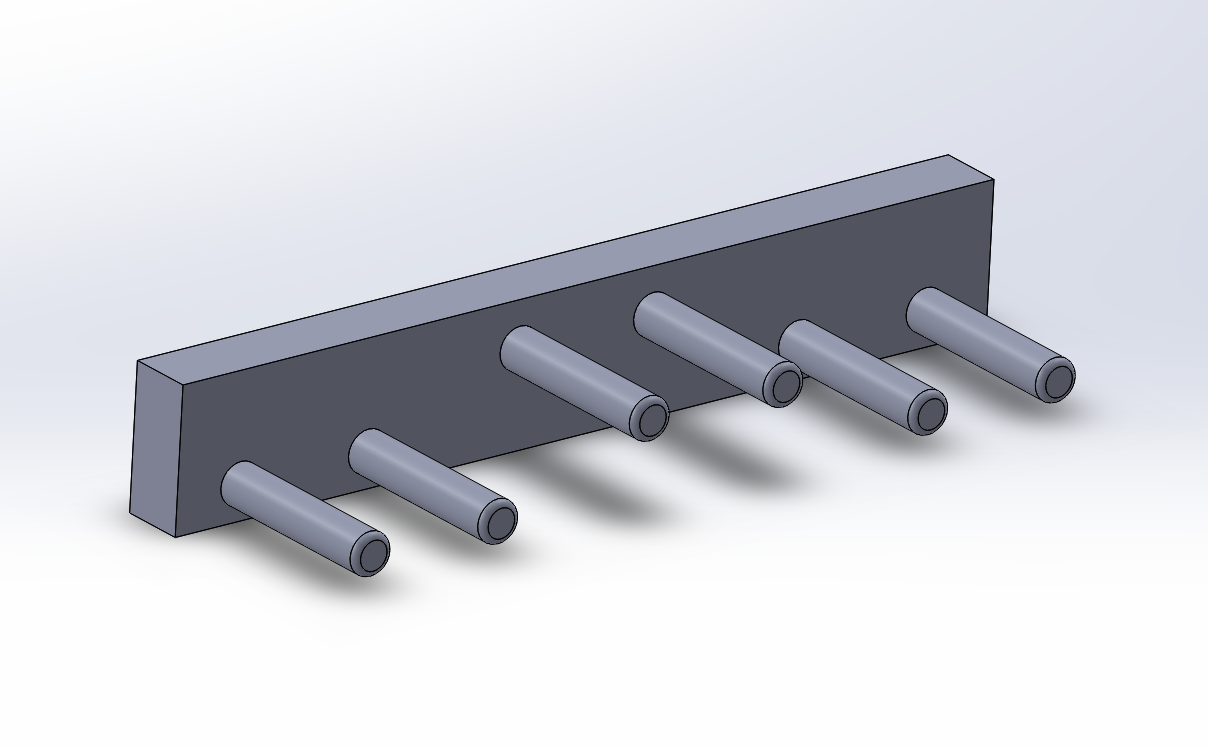

Kailh switches do not have the two plastic pegs which align the switch in the pcb. To add on that, the switch legs are so small that you can twist it like that and it's really hard to set it straight for soldering. This would make the process super tedious...
So i started to sketch out a solution to the switch alignment problem. :D
I will report soon how that went about. 1,5mm steel is my choice of material.

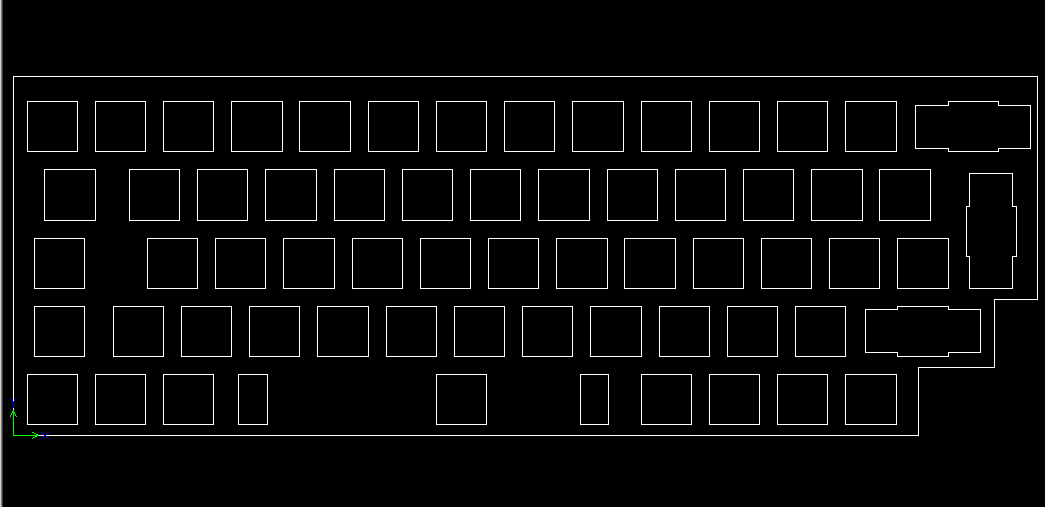

Progress so far:

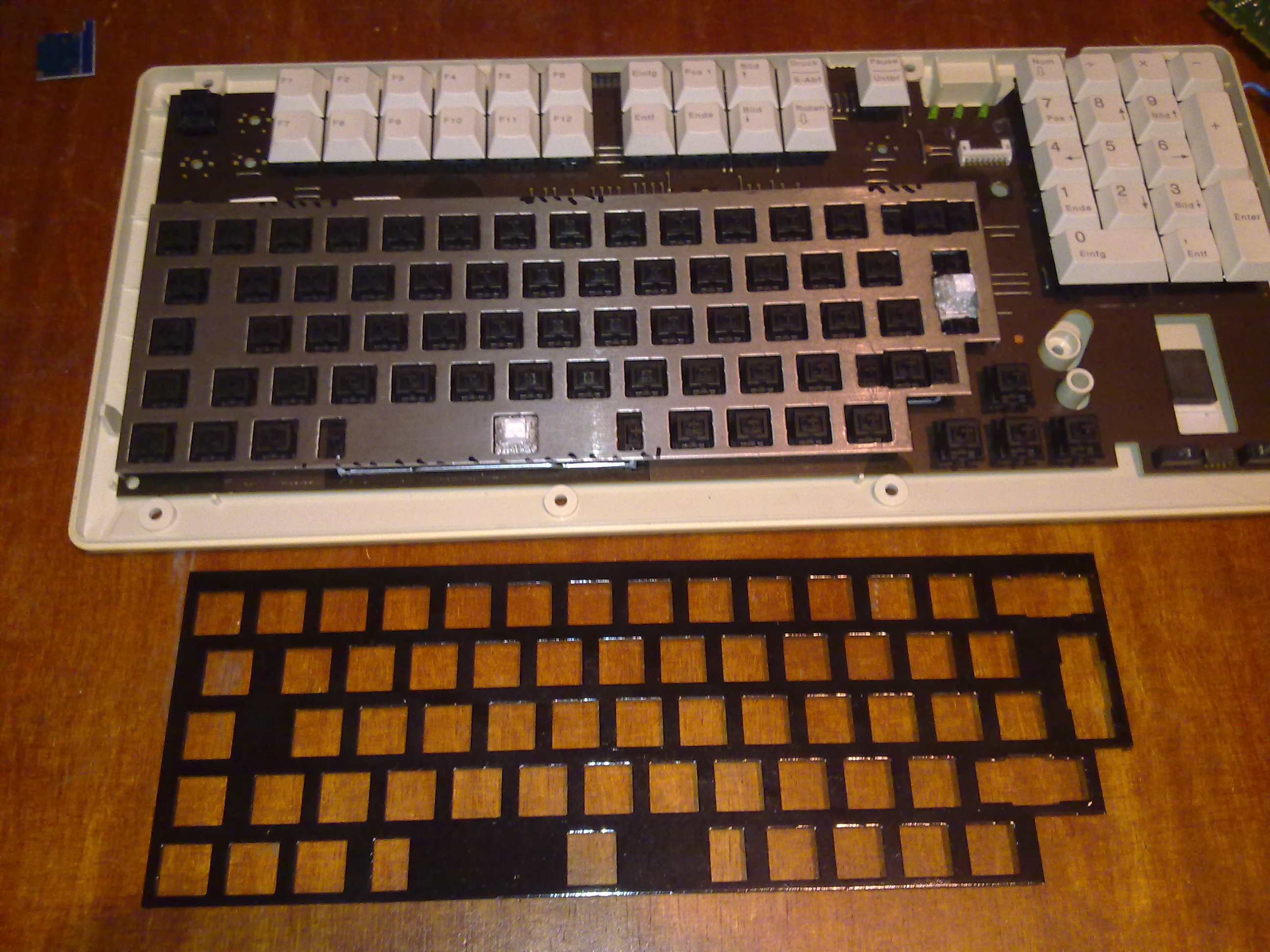

I've managed to cut (and weld because i didn't have a way to bend it at the time and i didn't exactly trust my calculations to be right in such tight space) the plate, got it right second time.
plate prototype.jpg (726.18 KiB) Viewed 73322 times
Top: first plate i cut in free time at work. Enter key and holes for spacebar stabs are a bit too much to the left side. i Had to fix that in the second try that's on the bottom. I work on a cnc turret punch machine, these have few advantages over the lasers actually!

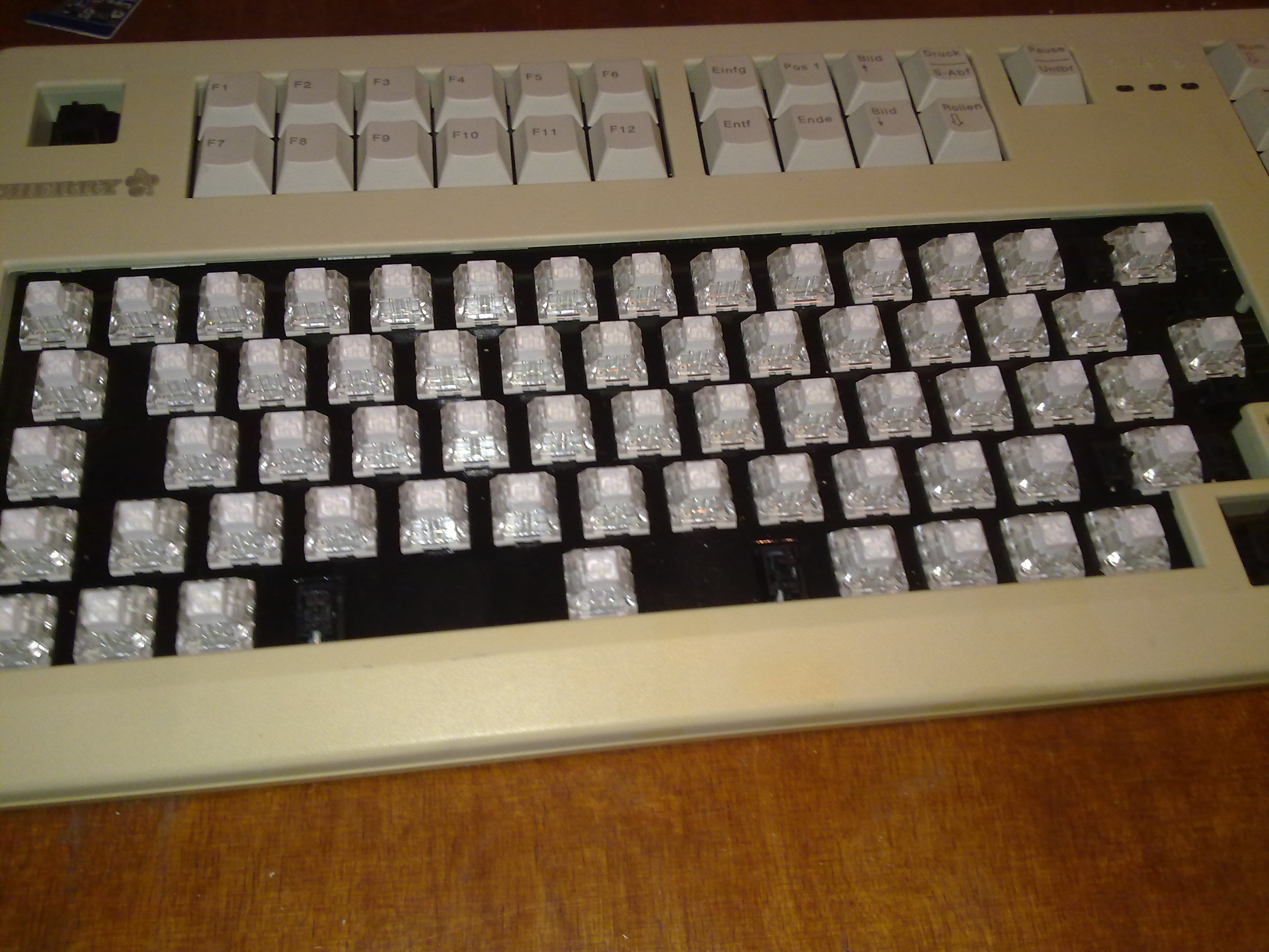

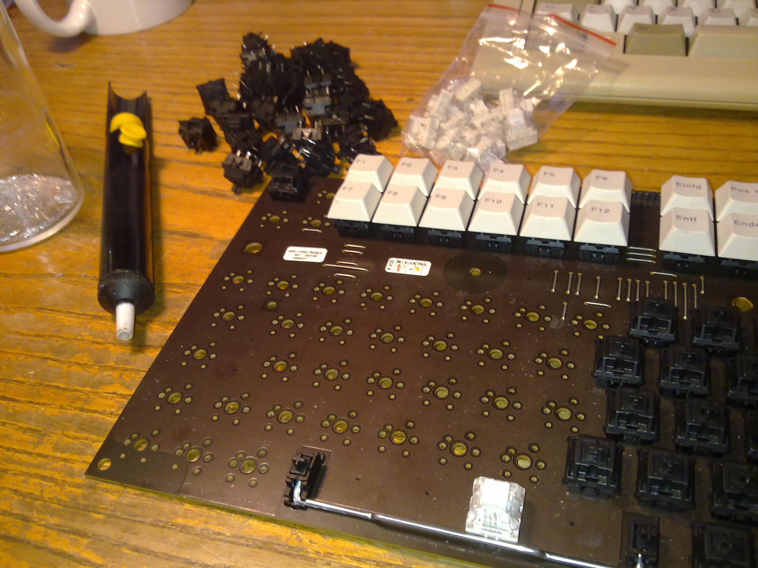

Desoldered all the cherries for the alphanumeric cluster. I decide to leave them on the arrow keys (for playing oldschool racing games on my TV i prefer linear switches.) :lol:
fitting plate with switches.jpg (629.58 KiB) Viewed 73322 times

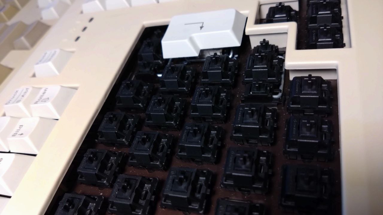

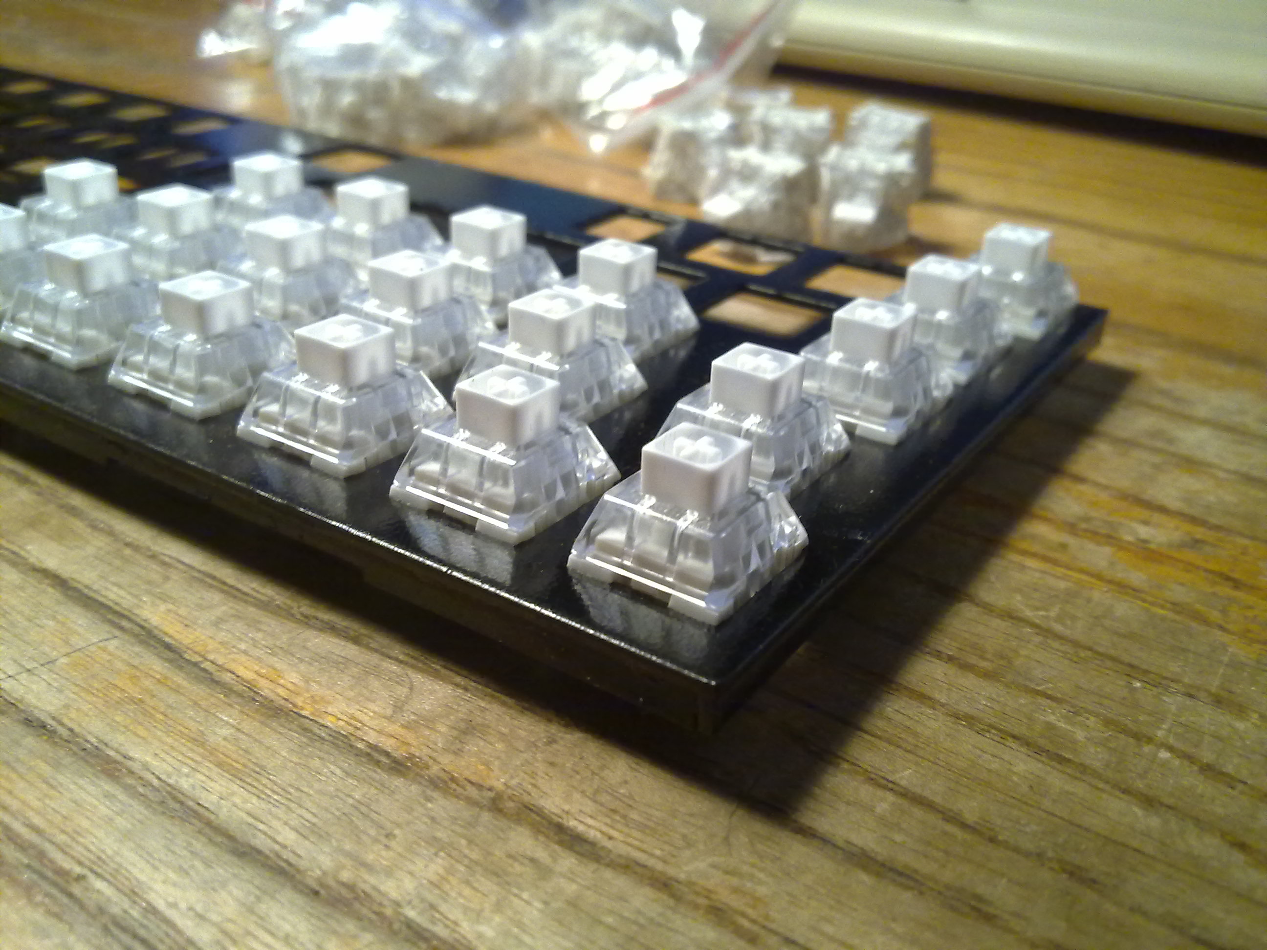

Switches fit into the plate neatly. In my infinite wisdom though, i assumed Cherry's spacing between keys is 19,00mm. However, it turned out to be something about 19,10mm, which made it a very tight fit later on :cry: i will have to fix that if i want to make the plate again. it was such a small misalignment i've managed to make it fit though.
plate and switches in case.jpg (633.76 KiB) Viewed 73322 times
All the switches and plate in place, test fitting before soldering.

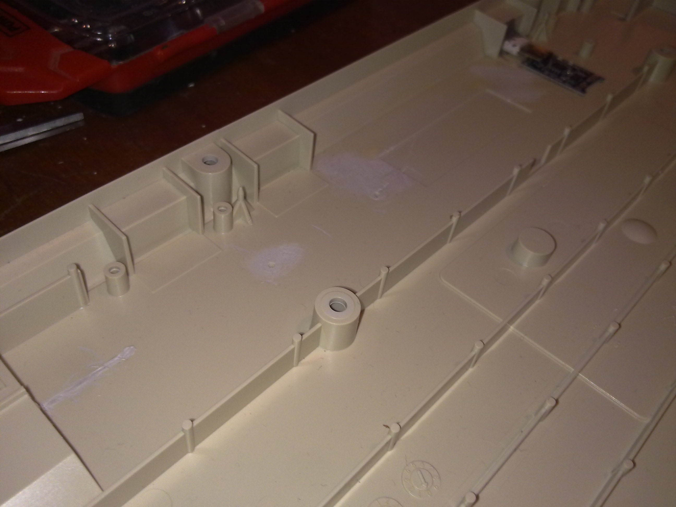

case .jpg (383.35 KiB) Viewed 73322 times
I cut out few of plastic bits in the case that were taking up the space for the new stuff. Few standoffs that didnt do anything, and four that provided support for the original controller. Also i've accidently ordered a USB type C battery charger. Turned out, a type C to micro usb adapter, served as a perfect charging port for the board, it will be much harder to break it accidentally and i can easily replace the battery charger pcb if i need to.

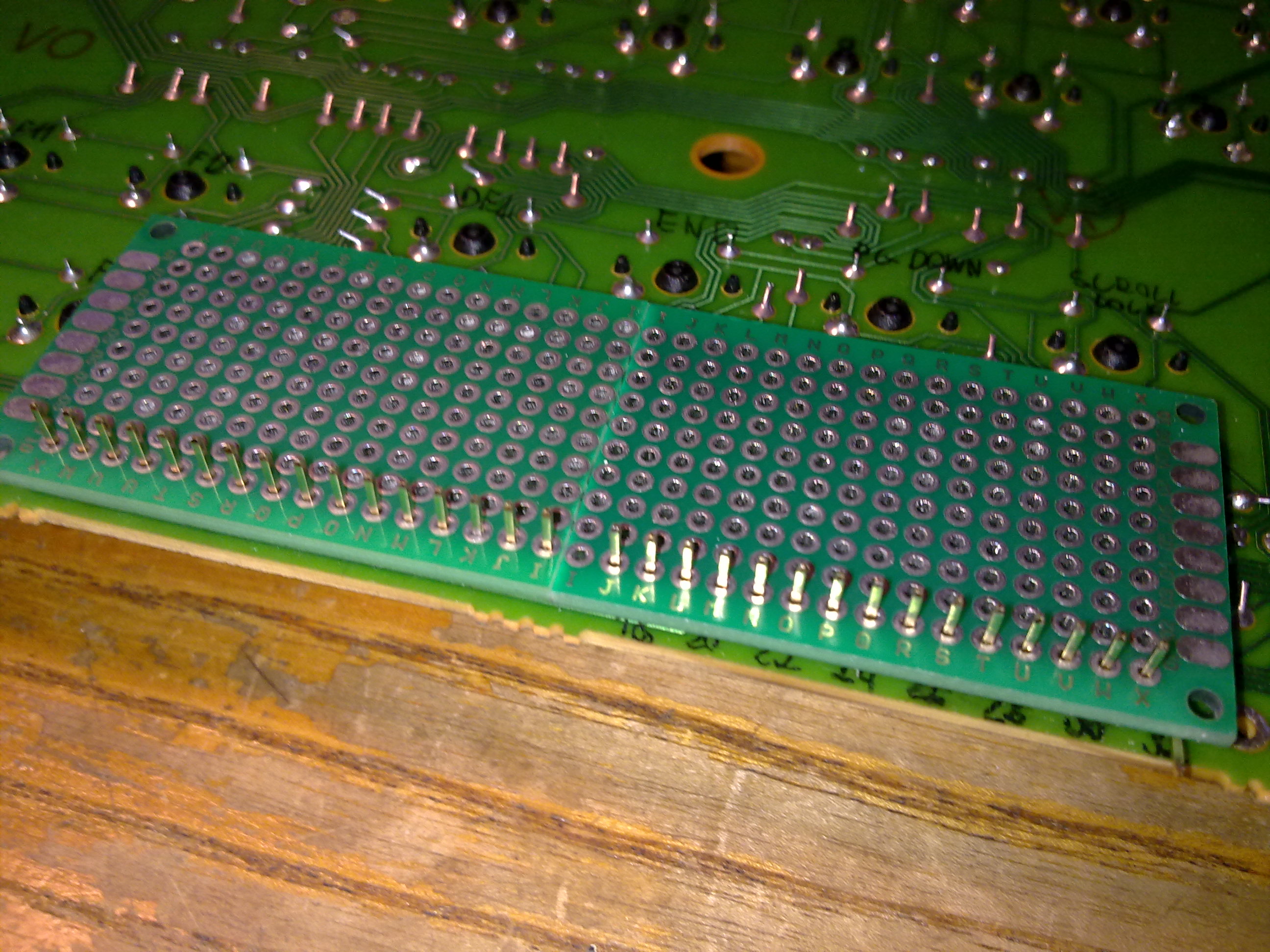

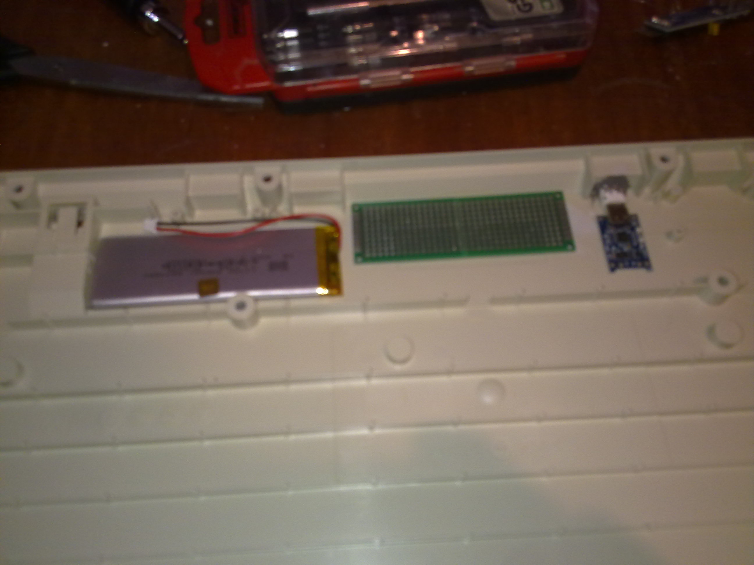

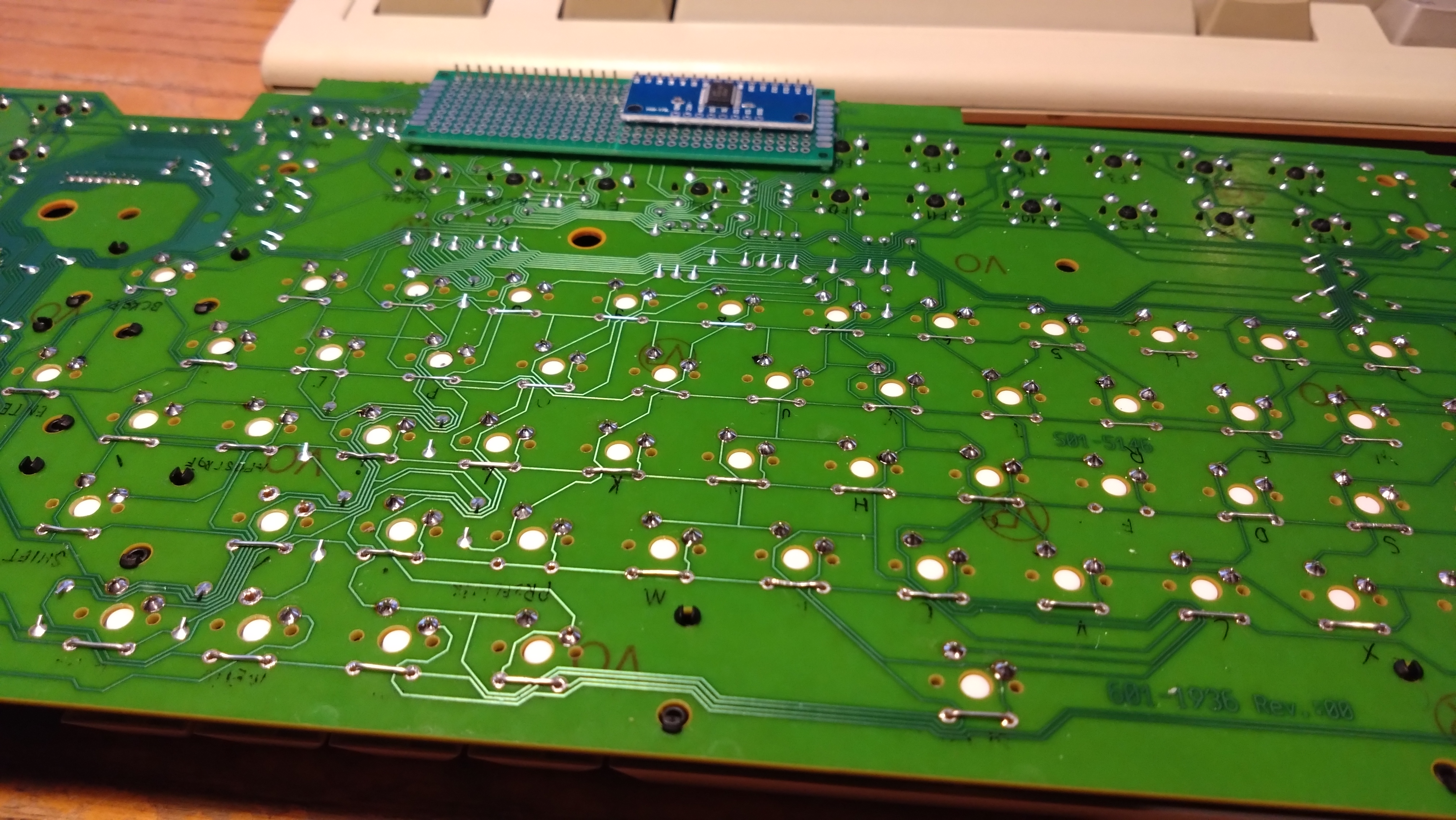

Layout of the electronics, pro micro and the multiplexer will be on the green proto boards, soldered to the keyboard pcb.
proto board.jpg (864.96 KiB) Viewed 73322 times
I couldn't order a correct length proto board for my use (it can't be larger because it will interfere with the case) so i've cut two smaller ones and joined them together with super glue. Should be good enough to hold the controller and multiplexer.

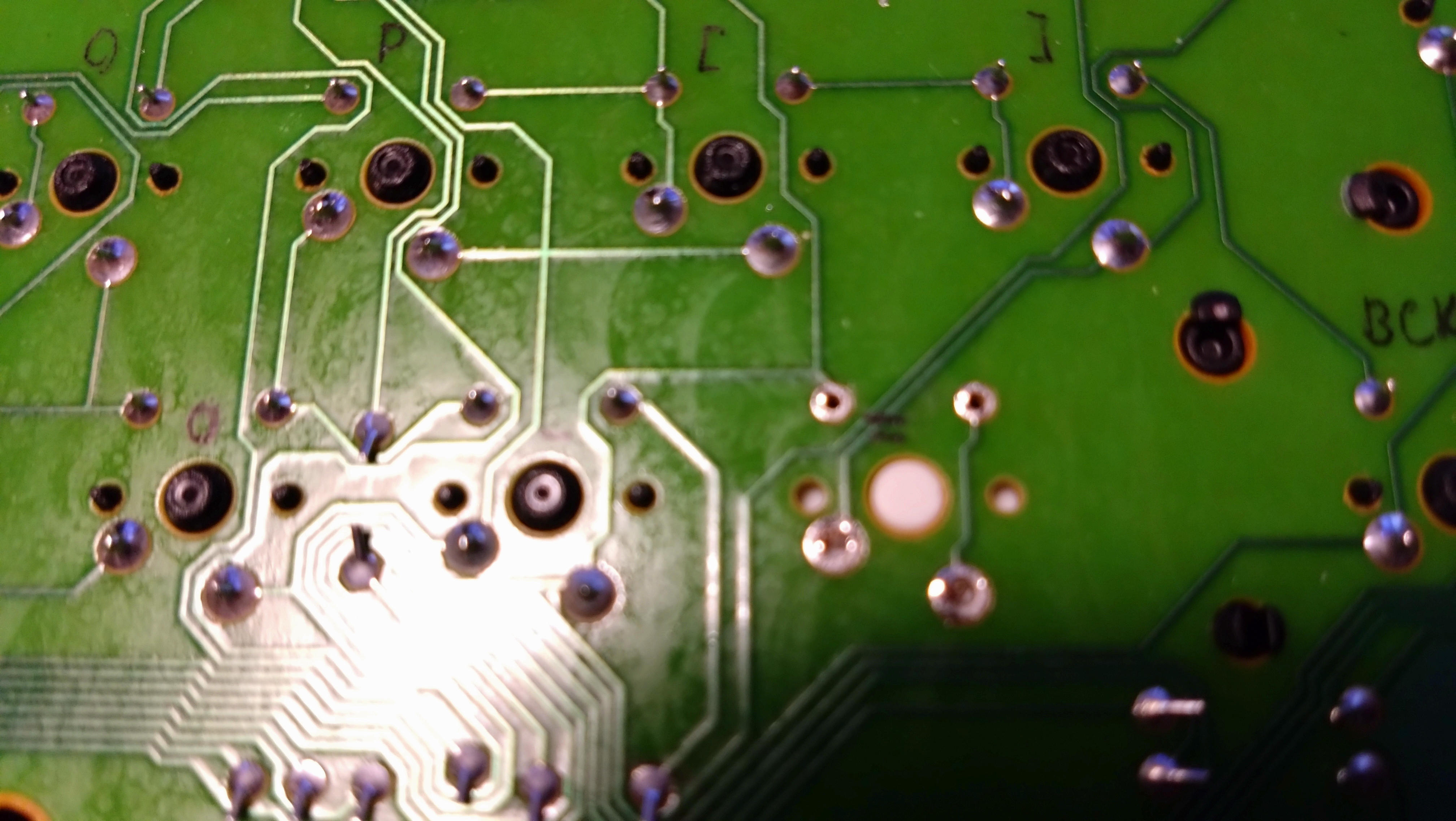

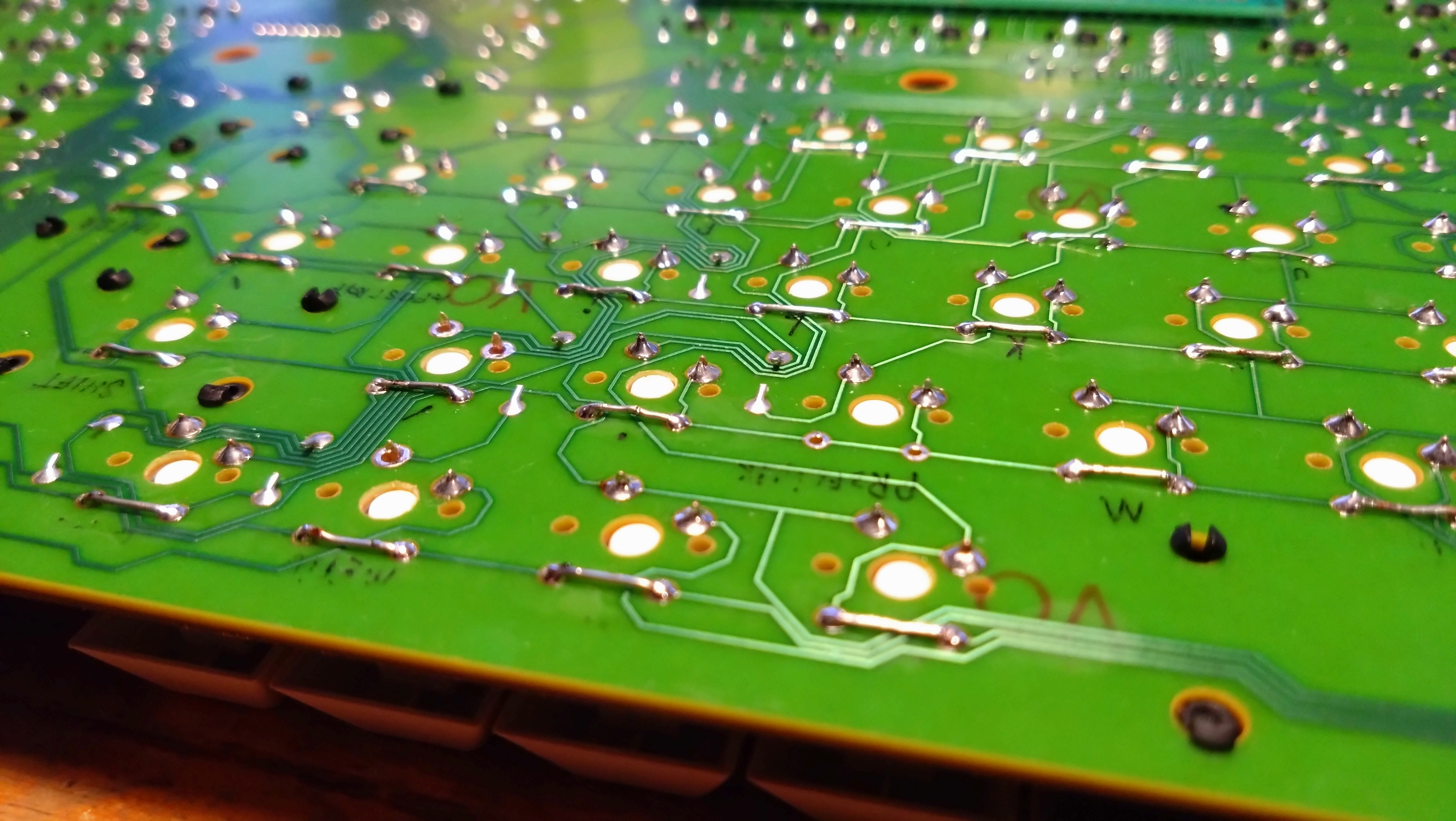

JUMPERS 1.JPG (3.62 MiB) Viewed 73269 times

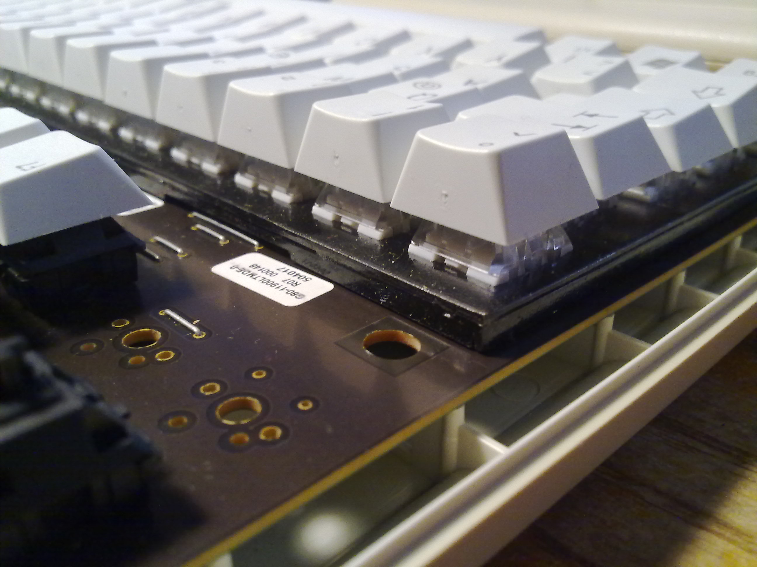

Kailhua box switches do not have the integrated jumpers Cherries have, so i had to replicate that with some bent wire.
JUMPERS 2.JPG (3.35 MiB) Viewed 73322 times
All the replacement jumpers soldered. Not every holes needed to have them as there are redundant traces in the pcb.

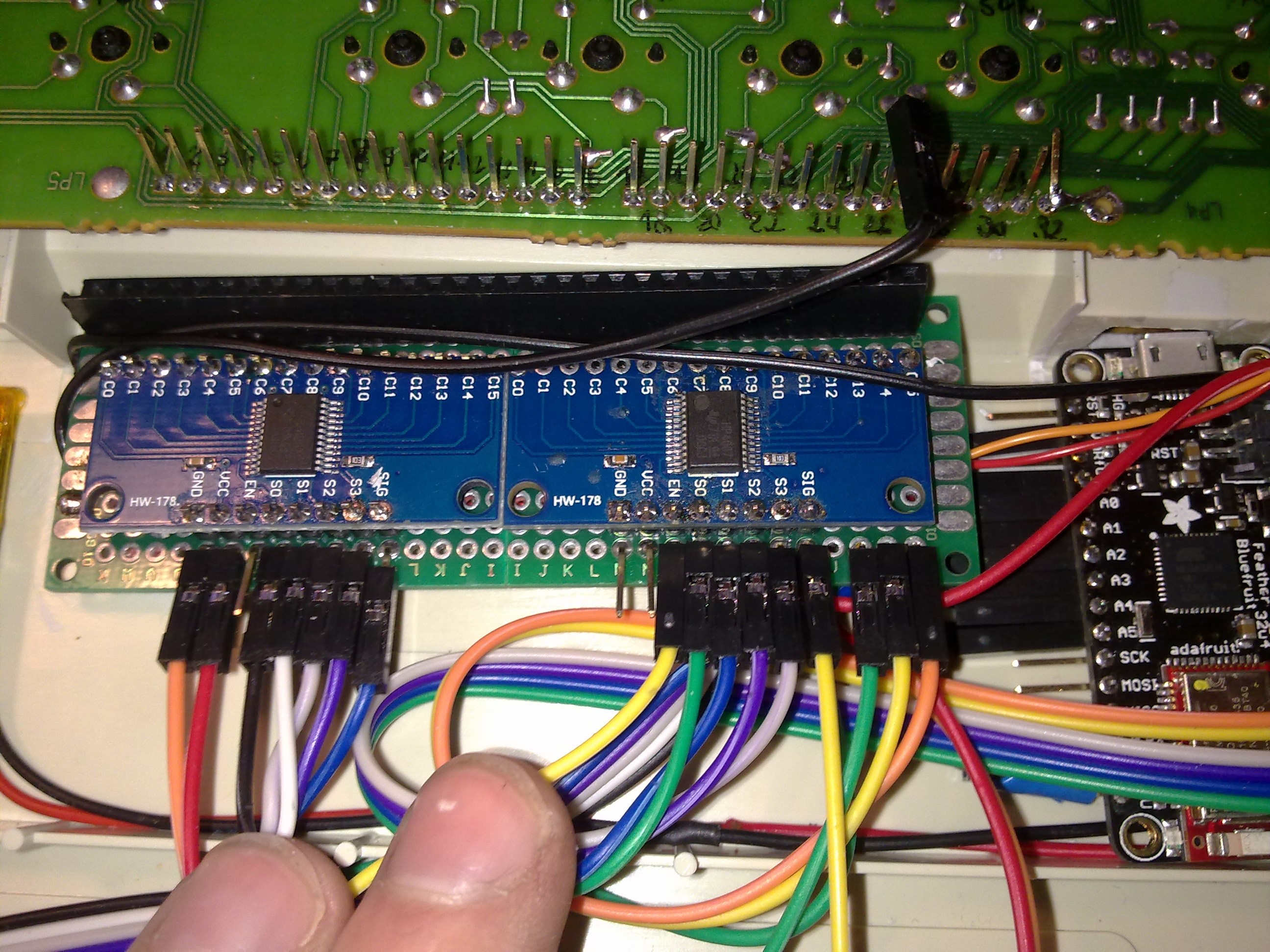

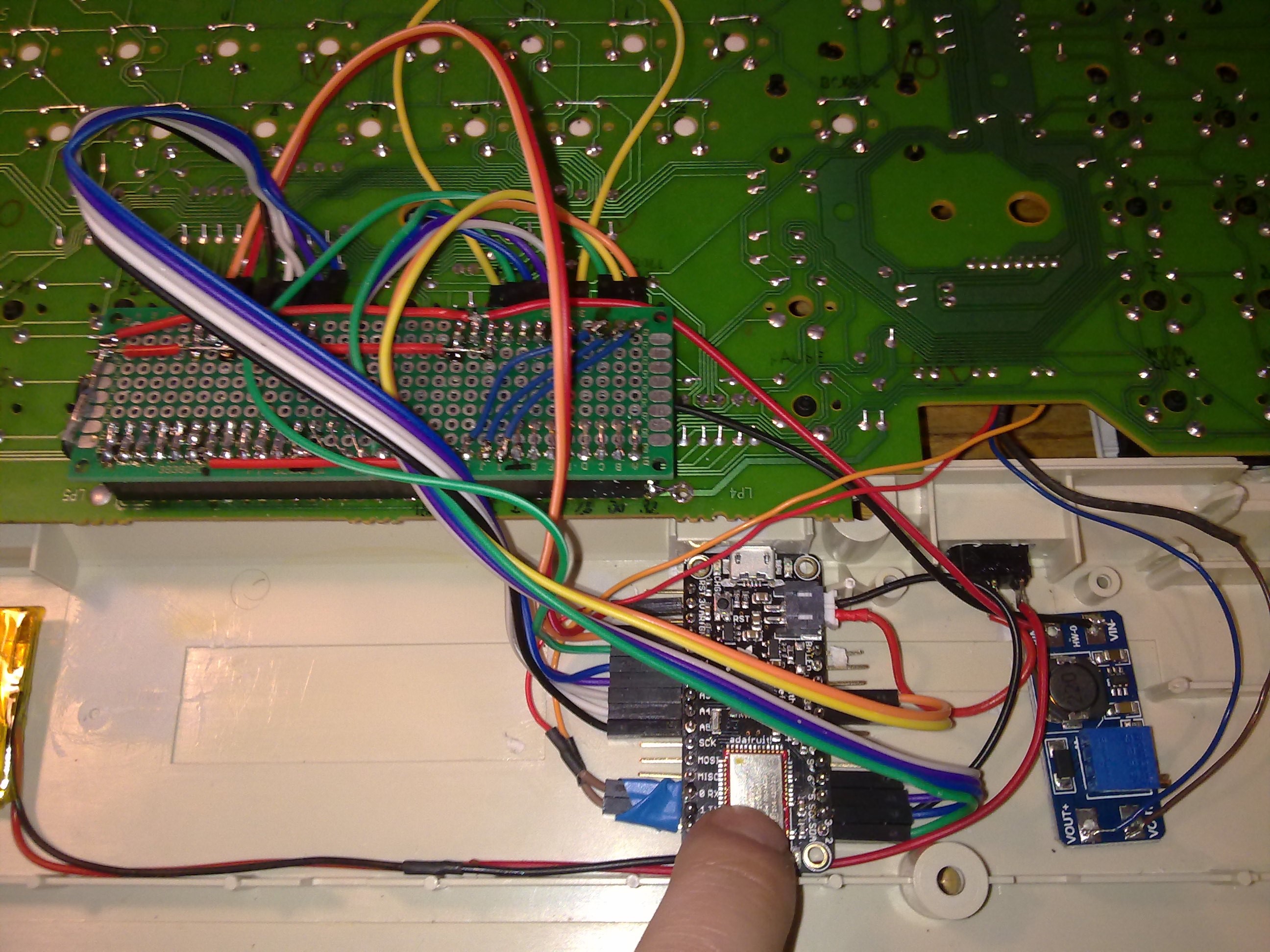

The proto board with two multiplexers is using female goldpin connectors for ease of removal. I figured i will have to do that many times during testing. On the right side there is a step up buck converter for powering the ps/2 OEM touchpad controller with 5V.

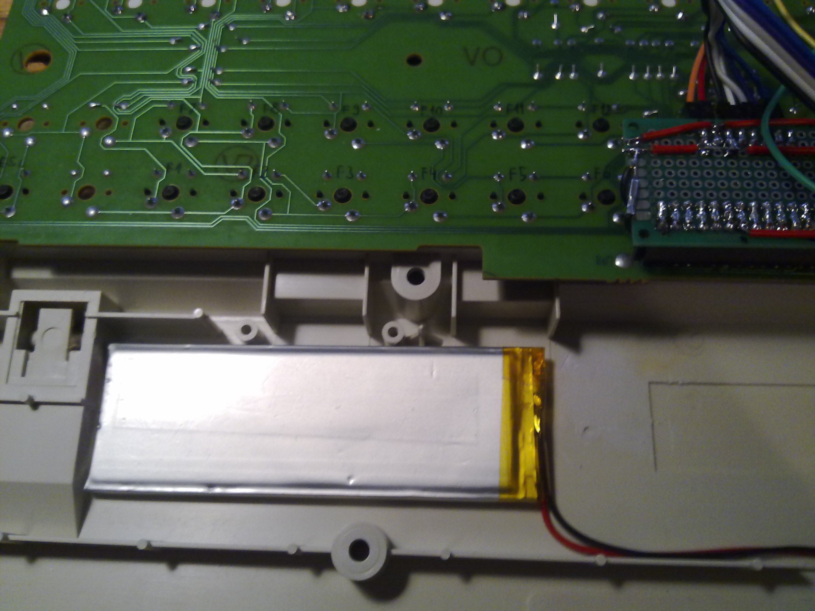

Plenty of space left for a big battery. I ended up using the same adafruit feather board as jsheradin (thanks for tips) because after buying HC05 bluetooth modules and trying to flash them with firmware i got fed up with them as they really didn't want to get flashed :roll:
Other side of the multiplexer board. Everything barley fits, but it does fit. :lol:

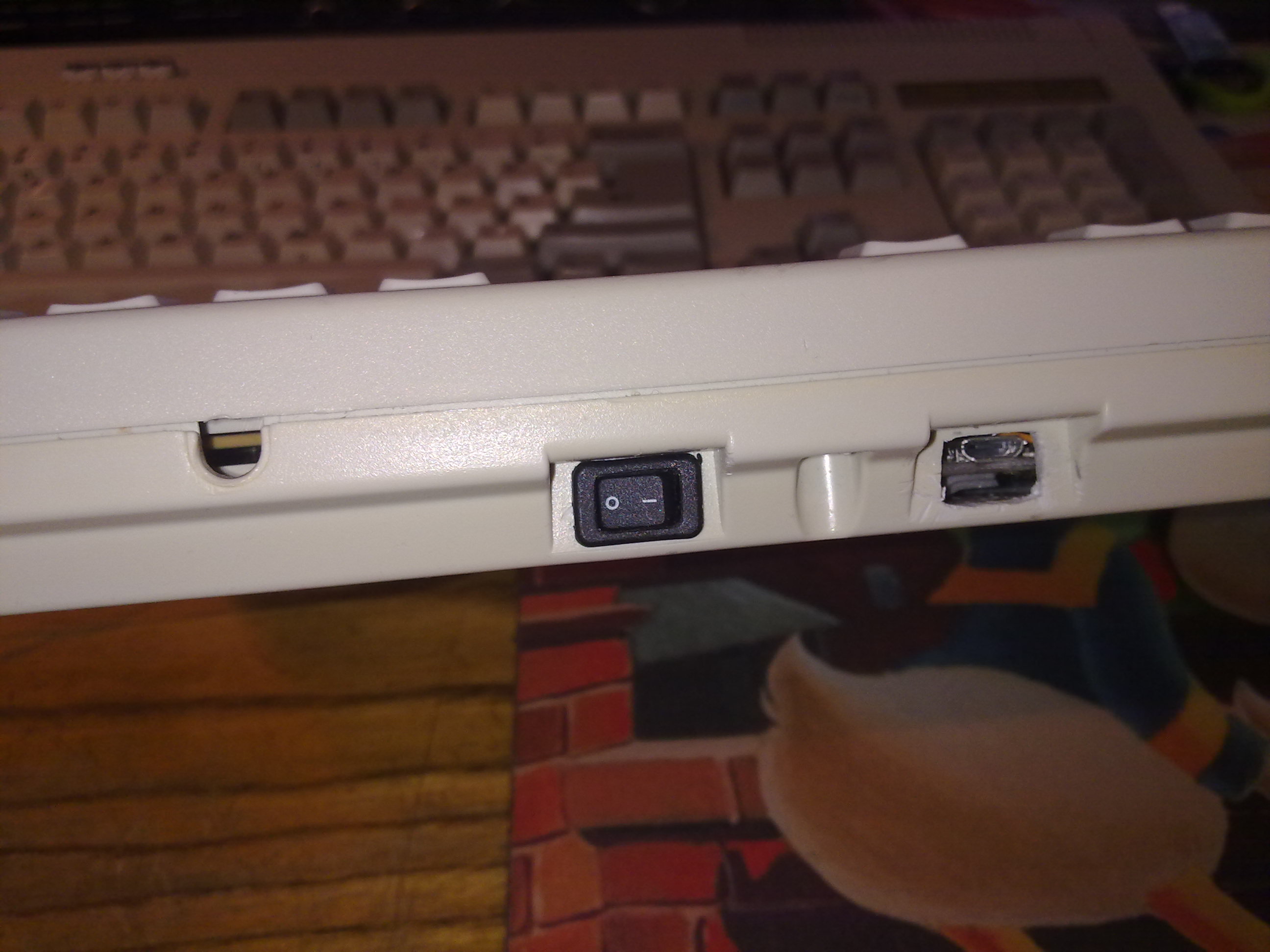

Battery lives on the left. Another advantage of the adafruit feather (Albeit pricey) it comes with a LiPo charger circuit built in.
From the back it looks rather obvious, i have to cover up the way too big hole for the usb connector with something, because at some point i swapped the switch and controller around. (didn't fit that way because of some plastic bits inside the case.)
So Far: Keyboard works, except the lock lights. Probably something is connected wrongly, i must have just messed it up during assembly. Trackpad works, and it's rather snappy and smooth, key to that was to use the BUSYWAIT (least reccomended :lol: ) mode in the QMK settings. It only gets a bit laggy when i move a bit further from the reciever, but i think that's just a crappy bluetooth usb dongle i got.
To Do:
-Mount the feather board more reasonably. Cover the hole i chewed out with something less horrible looking.

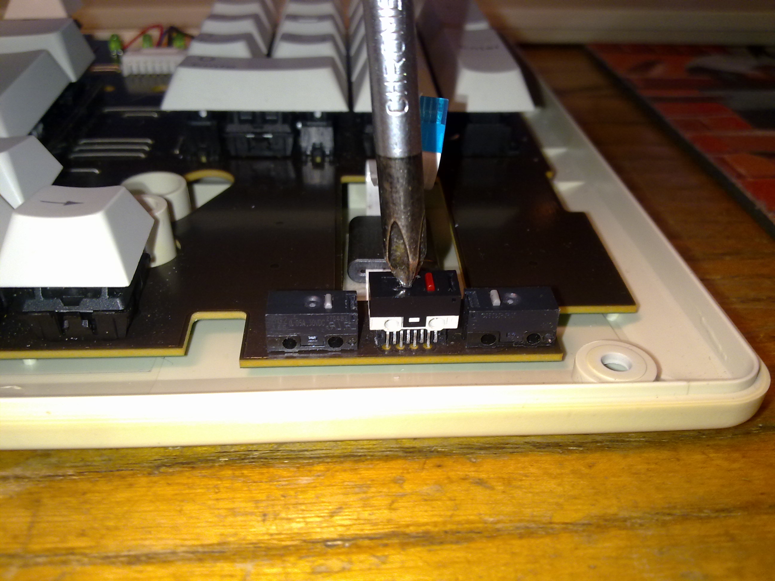

-Add 3rd mouse button for scrolling. (this is something i really wanted to do!)

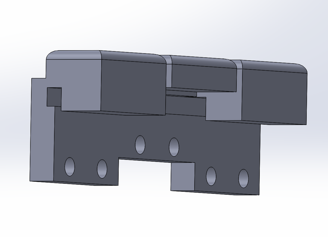

Sourced a mouse switch from some crappy mouse. So far so good, but how the heck would i mount it? i don't want to remove the two switches that are already there, and in the middle between them, there is that connector for the touchpad ribbon cable:
Only reasonable way to do this i think is to have the 3rd switch above it. So i got to drawing a mount i could have my friend 3D print for me. It utilises the holes that are already in the switches. Very convenient that those are here :D
first piece would go through the holes with those pegs.
and second piece, also doubling as the keys themselves. Then the 3rd switch will just be added as another key in the matrix outputting the 3RD mouse button scancode. Thanks for sticking around if you did and all the help! ^^
