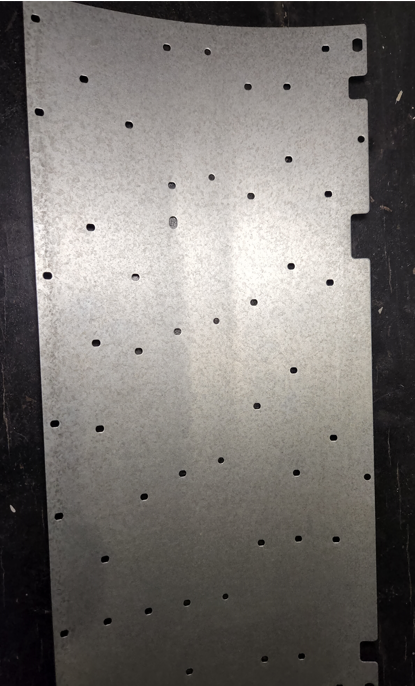

Anyway I saw this image of Unicomp model m ssk plate. It had this indent in the middle, from possibly bending. I have tried asking unicomp about it but no response yet.

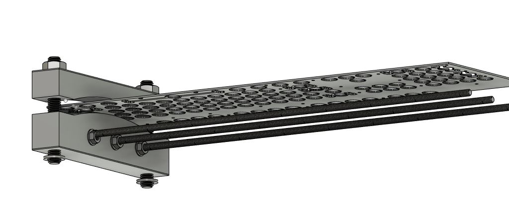

Previous model m/f top plates could be made but required slip rollers or other method to curve. I wonder some simple home shop method can be done. Perhaps some hardware store leadscrew/bolt/nut combo. Something like this.
pieces of bend.JPG (56.67 KiB) Viewed 5045 times
Then a simple 3d printed fixture in conjunction with hardware store screws could be used to bend this plate. This would allow any metal top plate to be used. Maybe this could be used to make entire modules for model f or m keyboards.

If the bending tool is narrow like that, the plate outside the bent part would be bent sideways near the tool. I believe you would have to either form the entire plate at once, or go back and forth across the plate bending it only a little at a time so as to each time compensate for the error in the previous pass.

Findecanor wrote: 19 Jun 2022, 00:25 If the bending tool is narrow like that, the plate outside the bent part would be bent sideways near the tool. I believe you would have to either form the entire plate at once, or go back and forth across the plate bending it only a little at a time so as to each time compensate for the error in the previous pass.
Hi good point, I imagined more like 3-6 of those modules down the length
As well there could be some alignment holes drilled into the plate to assist with the bending
