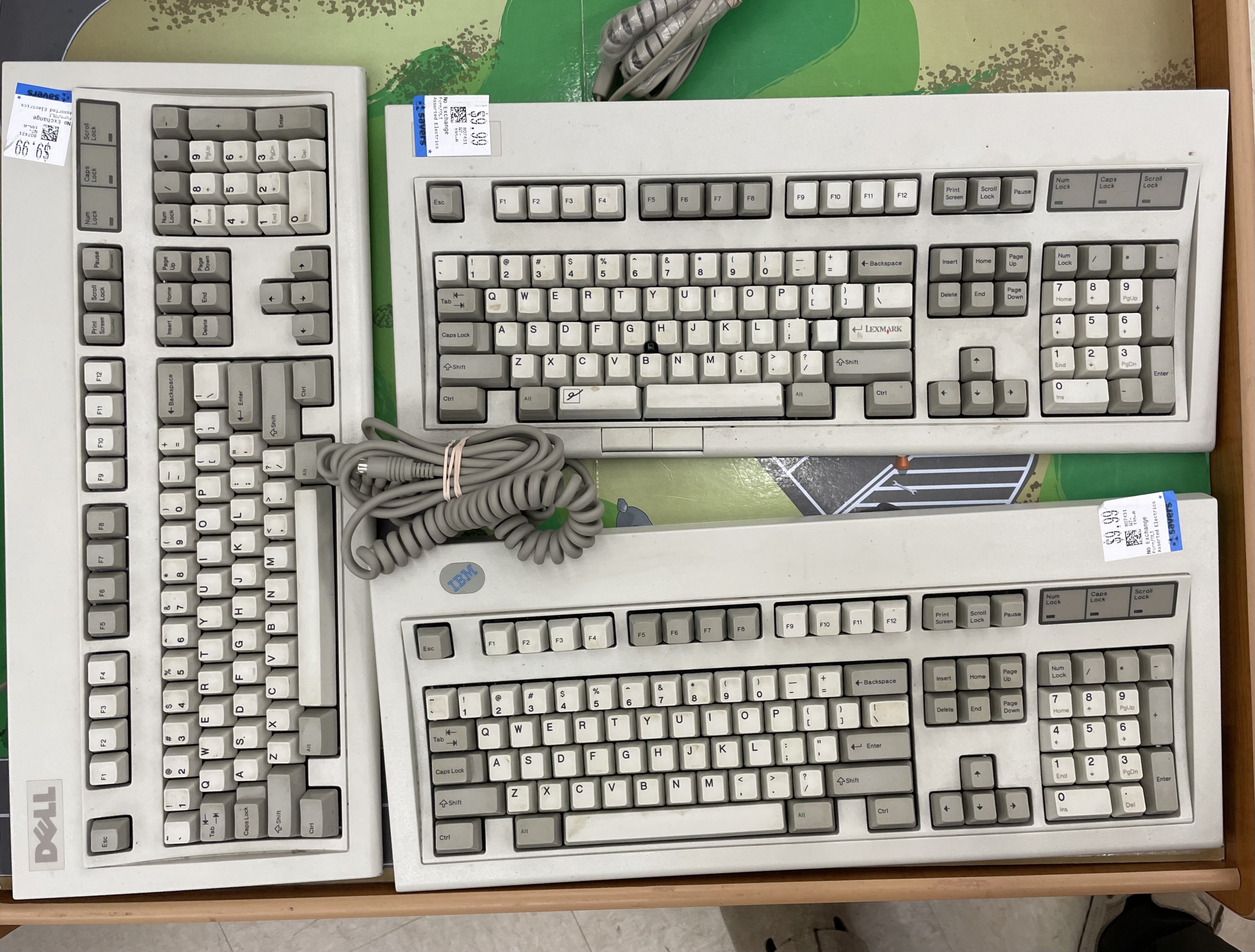

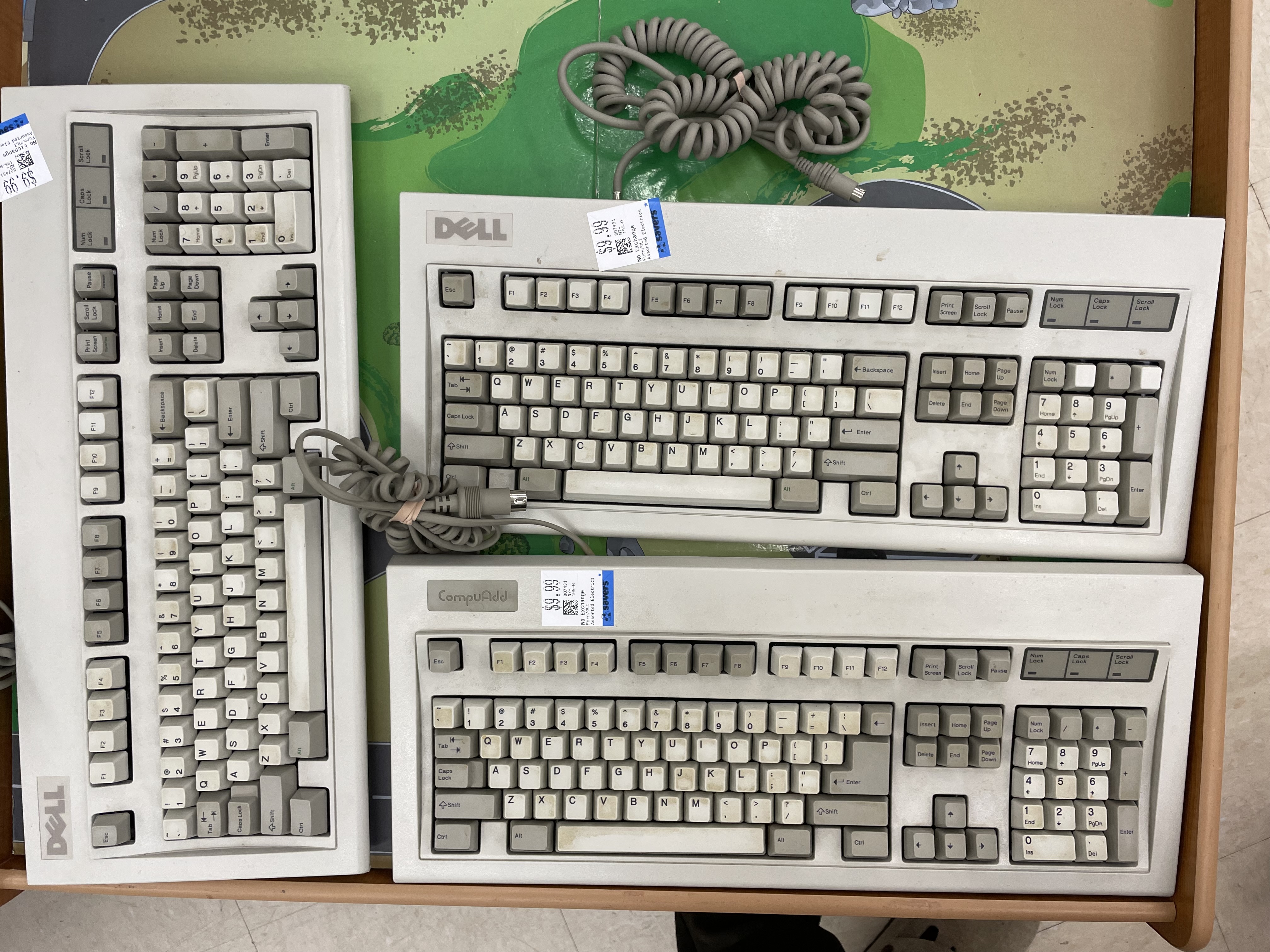

Hey there, everyone. New here to Deskthority and the world of Model M keyboards. While at a thrift store last week, I stumbled upon 6 keyboards. 5 of them Model M's, and 1 M13 with Erase-Eaze. I asked some questions on the r/MechanicalKeyboards Discord server, and was told by quite a few M enthusiasts to buy ALL of them. So I did!
Pics of the total haul:

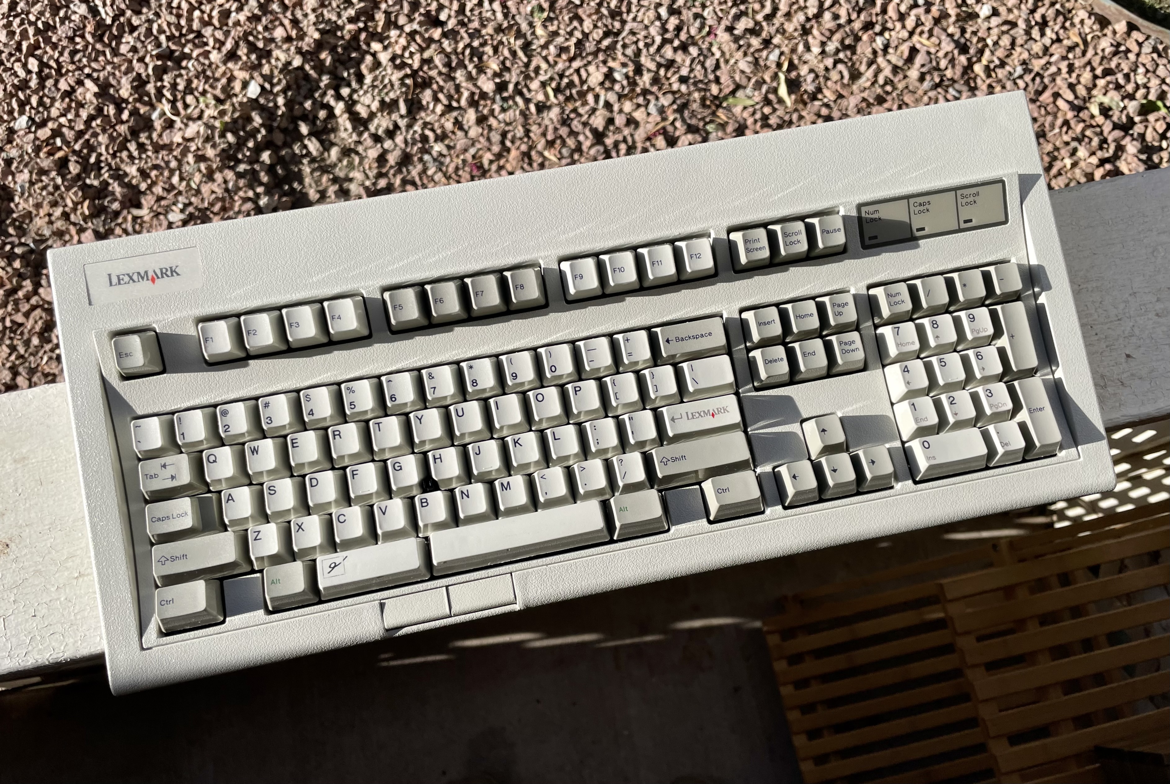

I got around to testing the boards yesterday, and luckily the M13 works, except for the trackpoint and the two buttons for the mouse clicks. How can I go about fixing these issues? Is it even possible to fix these issues?
Any help would be greatly appreciated.
Here's a pic of the M13 after a nice little cleaning

That's not just a trackpoint M but an Erase-Eaze, well worth the $9.99!
I think the whole trackpoint module is on its own ribbon cable going into the controller board. I'd say give it a good wiggle and double check that your converter is compatible with mice.

I went ahead and made sure all the ribbon cables were plugged in properly on the board, and I've tried using the direct PS2 port, and an adapter. I also tried using the board on Windows, a couple different Linux distros, and on Mac. None of it worked. Looks like I'll have to replace the entire module.

Congratulations on the haul!
Woah, a "CompuAdd" branded computer. It's the... second one I've seen so far during these years.
Can we ask you to take pictures of each keyboards on its back side, too? (mostly to document the part numbers)

I think unicomp sell complete trackpoint assembly replacements if it's completely dead
