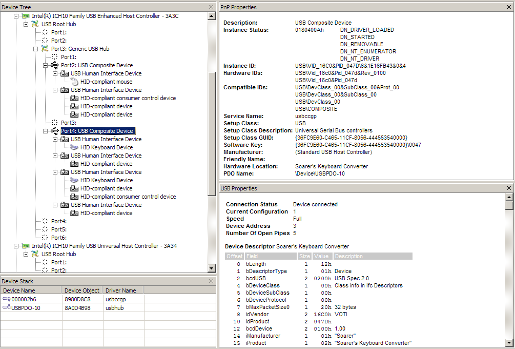

tobo - any chance you could
dump the descriptors so we can see how it's doing the 21KRO?

Here you go, I will add it to the GH thread as well. I have no idea what it says so please let me know what you find.

Thanks! That's a standard 6KRO report descriptor
Was it the only device showing under that port? If you select the Port entry in the tree USBlyzer puts all the descriptors for that port into the Properties window, that will give us some more info

Crap, It showed 2 keyboards, probably did something wrong. I'll try again.
Posted: 05 Jun 2012, 16:24
by JaccoW
Alright, here we go, take 2.
I think my mouse was interfering (Roccat Kone [+]) since that one can be programmed to be pretty much any key or combination as well.

by Soarer
CeeSA wrote:how did you get the sum of KRO keys? where is the information?
First I should say that this is the KRO for the USB communication, so we are assuming that the keyboard itself is NKRO (has diodes etc). In that case the limiting factor is the USB comms.
Commented version...

Err... that's the same single report

In that case I am at a loss. In aquakey it shows a lot more, but for some reason it doesn't register F2, F3 or F6 :S
It does work everywhere else though.
EDIT: Doesn't this board send two seperate packages to enable higher than 6kro?
Posted: 05 Jun 2012, 16:50
by Soarer
Yes, most likely it uses multiple devices.
You need to highlight the Port in the tree, not the HID device. The USB Properties view will then begin with Connection Status etc. Like this...
- usblyzer_snapshot.png (74.02 KiB) Viewed 16696 times
Then the export from the USB Properties window gives a much longer dump, which includes all the reports from all the (virtual) devices attached to that port...
