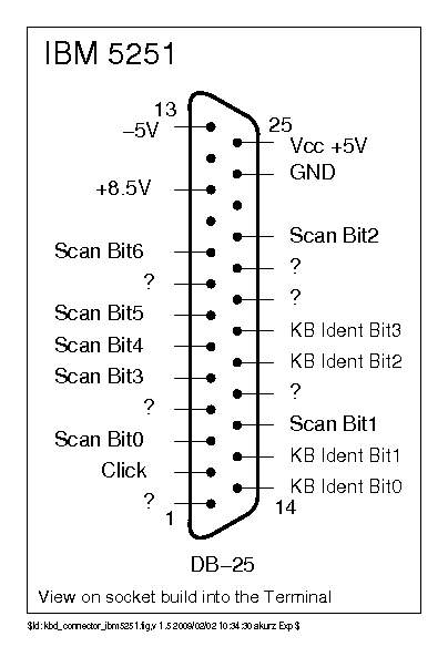

Based on my current understanding the converter would have 2 roles. First it provides keyboard input which is converted to 5251 protocol and attached using a DB25 connector. Second it would recieve the 8.5V out and solenoid trigger from the 5251 terminal to activate an onboard beeper to replace the solenoid of the 5251 keyboard.
XT to 5251 converter diagram.png (6.98 KiB) Viewed 5709 times
I've been able to get most of the pinout for the DB25 connector (by crossreferencing kbdbabel and a couple of the documents on bitsavers) and the IBM manuals describe the scan codes as well. The layout/version of the 5251 keyboard is set with jumpers and that the terminal can read, but I believe that can be achomplished in software.
  1. Cable Check A
  2. Click (Solenoid Trigger)
  3. Scan Code Bit 1
  4. Data Strobe
  5. Scan Code Bit 4
  6. Scan Code Bit 5
  7. Scan Code Bit 6
  8. Break Code Bit 0
  9. Scan Code Bit 7
  10. Unknown
  11. +8.5V (Solenoid power)
  12. Unknown
  13. -5V DC
  14. KB Ident Bit 0
  15. KB Ident Bit 1
  16. Scan Code Bit 2
  17. Power-On Reset
  18. KB Ident Bit 2
  19. KB Ident Bit 3
  20. + Delay Strobe
  21. Cable Check B
  22. Scan Code Bit 3
  23. Ground
  24. Ground
  25. Vcc +5V
