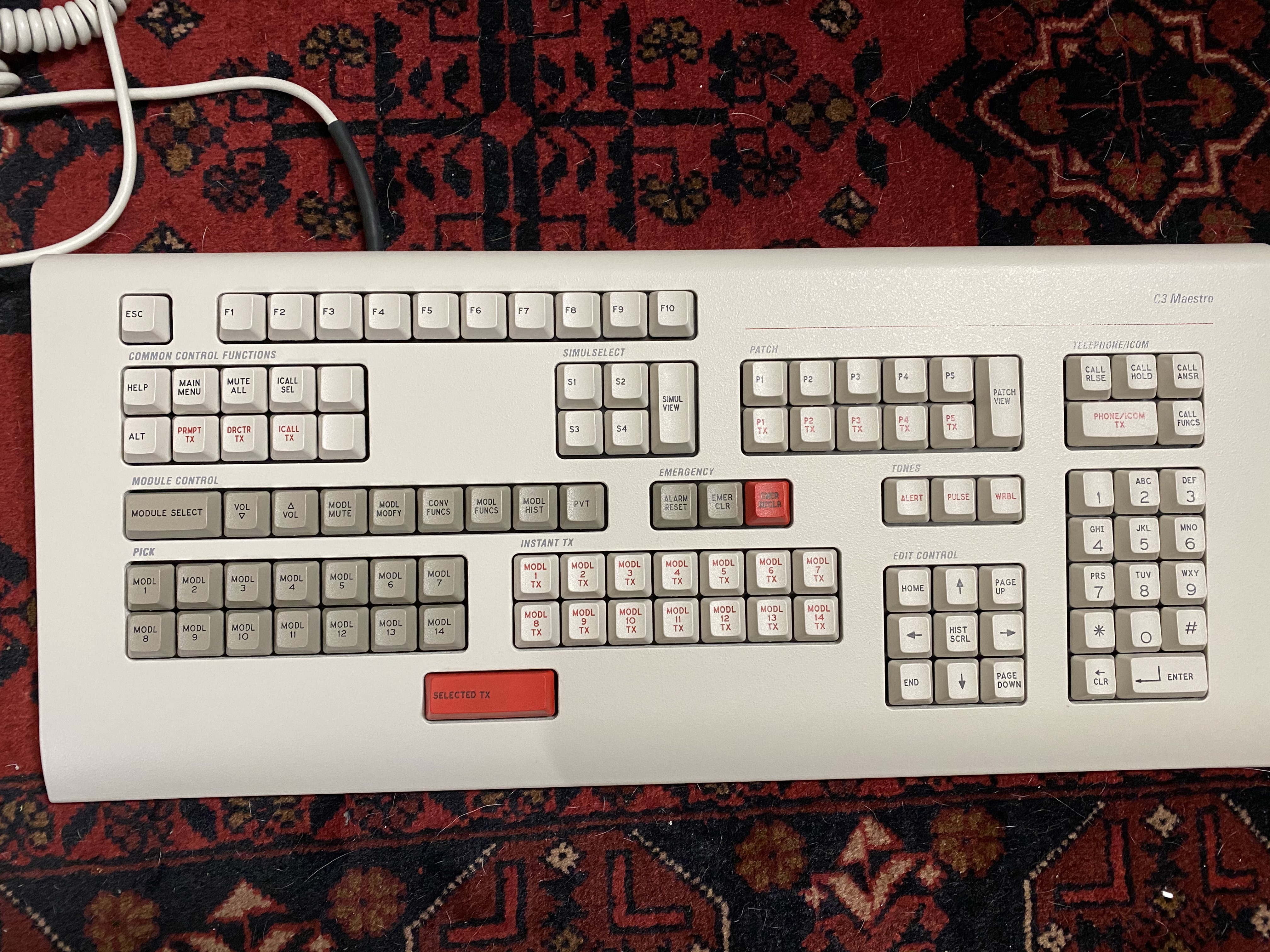

So I picked up one of those C3 Maestro 911 Operator keyboards from eBay and have taken to calling it the MACRO Macro Pad because it's freakin' HUGE. F&F switches, thick plastic top, metal bottom, double-shot caps... It's quite the looker.
The board itself complete with Tetris layout
The problem is, I have no idea how to go about making firmware for a converter. I'm not exactly a noob- I've made converters for a bunch of other boards thanks to TMK and QMK, made some hand-wired boards, etc. but I'm also not super proficient in the underlying theory so I'm stumped on an atypical board like this.

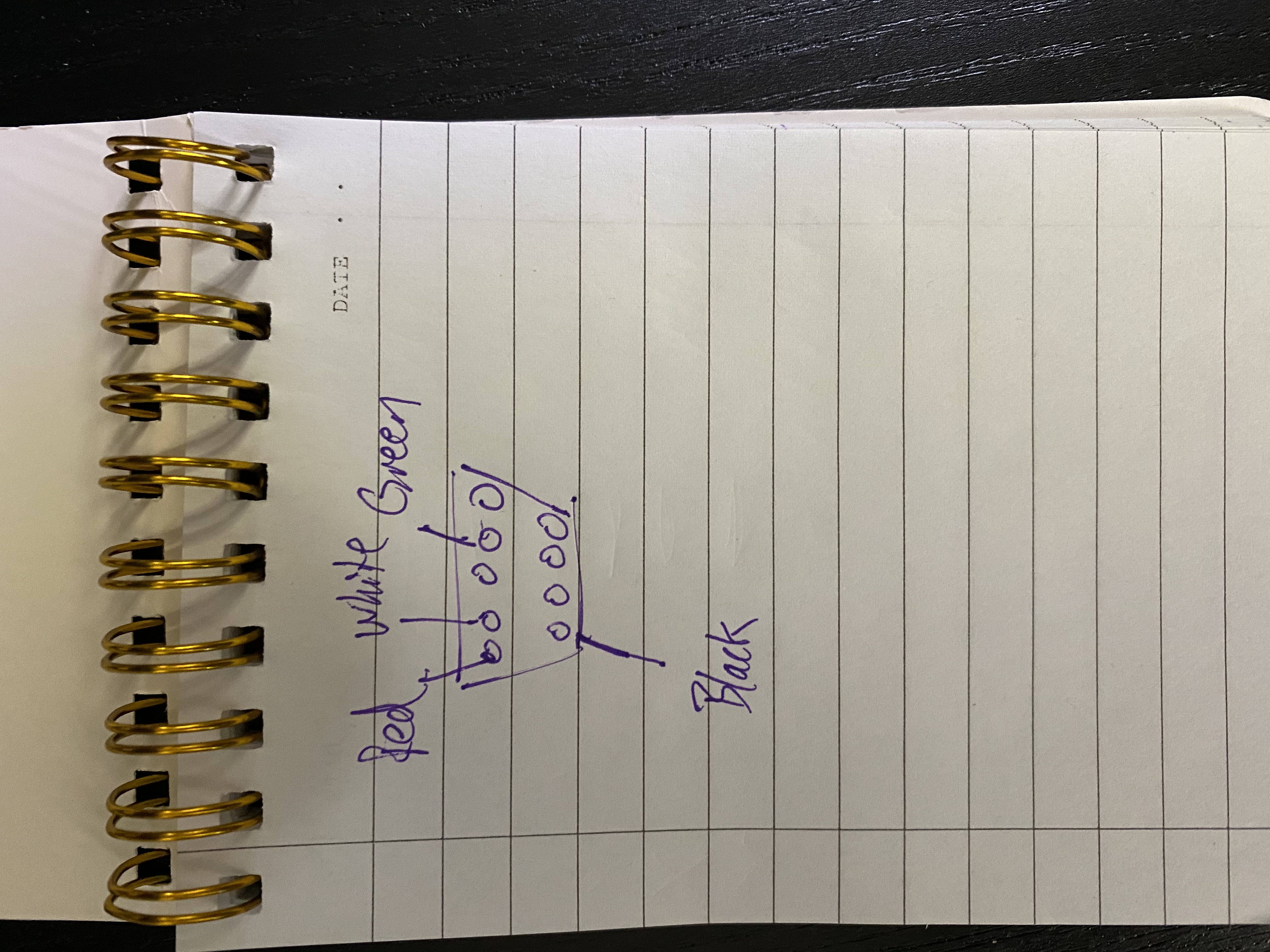

It's some kind of serial protocol, but only with a TX from the keyboard, which connected to an "Enhanced Audio Enclosure" which interfaced with a computer rather than to a computer directly. Its job seemed to be switching between audio sources and radio channels, so it appears it would be some kind of unique protocol. There's no clock and no RX.
As for the cable, red is VCC, white is data, green is ground, and black is shield. In order, these are pins 1, 2, 4, and 6 on the DB9.
Screenshot of the pinout.
Good pinout.png (133.07 KiB) Viewed 8120 times
Male DB9 pinout
Male DB9 pinout
Male DB9 reverse
Male DB9 reverse

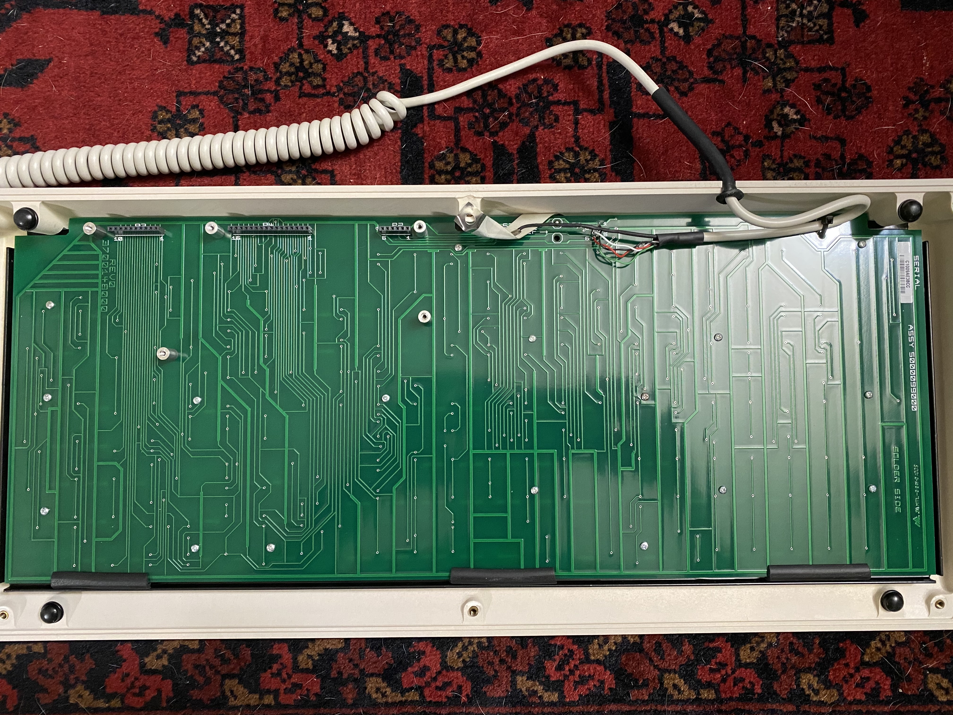

Some photos included of the PCB and controller. It would appear the keyboard uses 10 rows and 16 columns and the controller parses this into serial and sends over the cable.
PCB with controller in place
IMG_0410 copy.jpg (3.05 MiB) Viewed 8120 times
PCB with controller removed
Controller
Controller
IMG_0408 copy.jpg (3.64 MiB) Viewed 8120 times
I've tried a simple Pro Micro with several of the TMK serial converter builds just in case they might work, but no joy. However, when powered the piezo works when keys are pressed and delivers a delightful clicking sound.
Any suggestions for how to get the MACRO Macro Pad working? Is there anything in the photos that might suggest a starting point for firmware? Should I rip out the controller, get a Teensy++, and try to implement a matrix directly from the PCB pins even though it's capacitive? I don't expect to be spoon fed and am happy to read things- I just don't know where to begin. I'm also happy to add anything that would be useful about this board to the wiki!

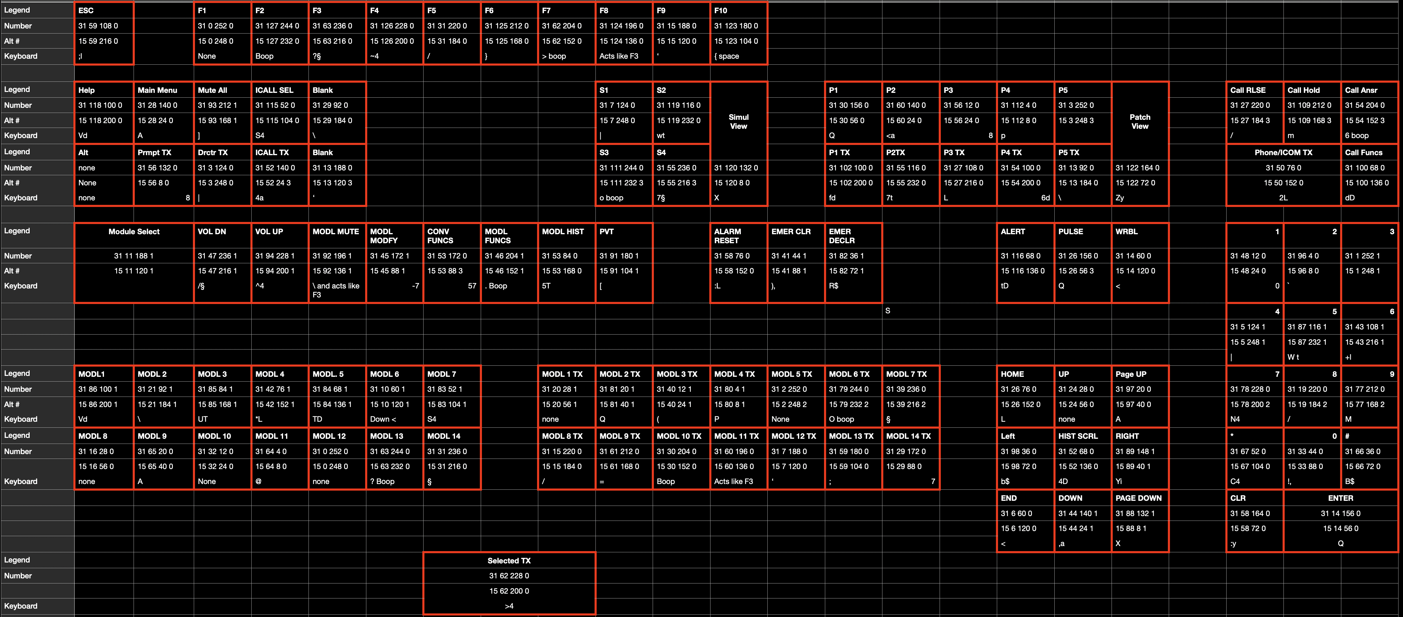

MMcM's idea yielded some great results. I found a couple of sketches having to do with reading serial from the Pro Micro's serial ports and loaded them up.
This sketch below was used to generate the "Number" section of the image below. Each key, with the exception of Alt, yields 4 numbers: two when pressed and two when released.

This sketch below was used to generate the "Keyboard" section of the image below and causes the Pro Micro to translate the serial input into keyboard output and type it wherever the cursor currently is. Each key, with the exception of Alt, yields one or two characters. Some yield a "boop" in that they cause my Mac to go boop.
What it do.png (1.14 MiB) Viewed 8008 times
It's clear that the keyboard is sending two ASCII values when pressed and two when released. For example, ESC when pressed generates 31 59, which an ASCII table says is "Unit Separator" and "Semicolon", then 108 and 0 when released, which is "Small l" and "Null". When the keyboard sketch is running, ESC yields ; upon press and l on release. Some of the keys end with 1 "Start of Header" instead of 0 when released.
So now that we know that we know the keyboard is sending ASCII, what's the next step to get from here toward a functioning QMK converter? I'm open to suggestions, links, similar projects I might be able to bastardize, etc.

I tried a few different baud rates, mainly with the ESC key- here's what they did:
1200: all keys 0 down 0 up unless pushing multiple keys at a time which might yield a 56 or 128
2400: single digit, inconsistent up and down codes e.g. 1 1 or 0 3 or 0 2 depending on how fast the key is pressed
4800: double digit, inconsistent up and down codes e.g. 21 down 29 up or 23 29 depending on how fast the key is pressed
9600: consistent regardless of speed; e.g. 31 59 down 108 0 up
19200: consistent 254 224 158 0 down 224 158 0 up

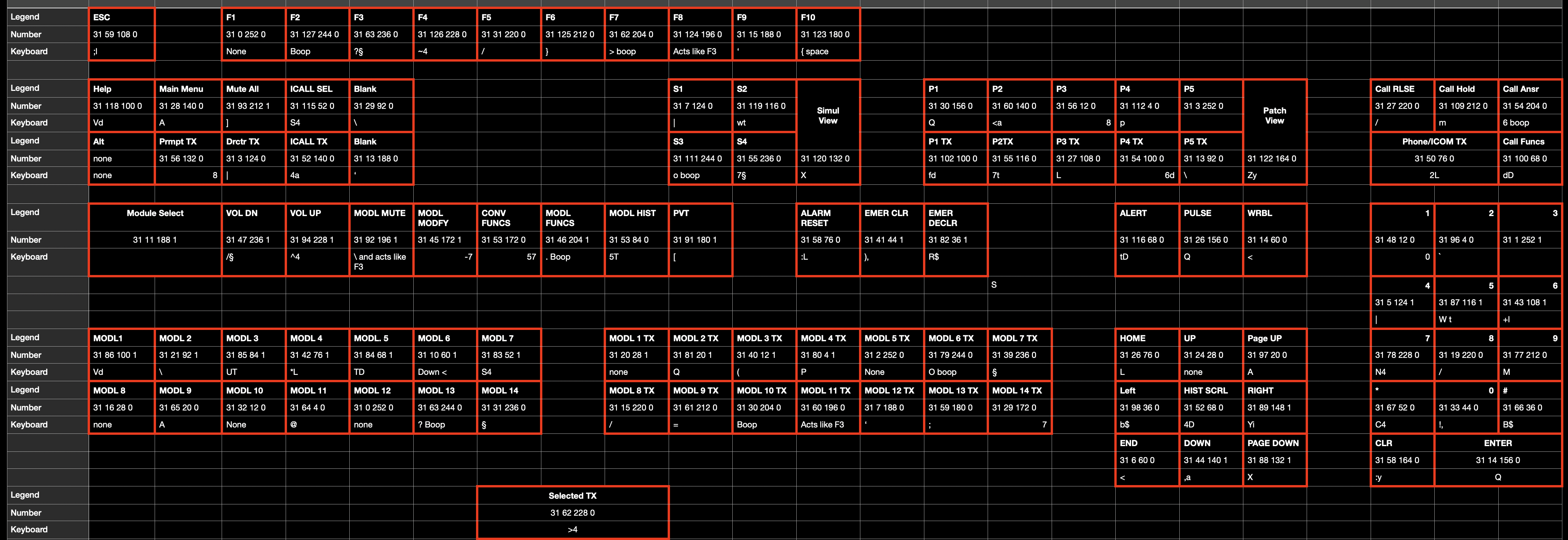

Curiouser and curiouser...
What it do with Alt.png (1.5 MiB) Viewed 7819 times
Added codes for each key when holding Alt. The start code is 15 for all keys and the down code is the same as it is without Alt for all keys. Stop code 0 or 1 stayed the same for many keys, but some saw it change to 2 or 3. In some places Alt seems almost like a halving or doubling operation, except when it doesn't. I'm wondering if either the folks who built this just did it willy-nilly or if we're missing something that would make more sense.
First, there's MODL12 and F1, which have identical codes for default and Alt operation. Then there's the fact that the start code for Alt keys is 15, which is not quite half of 31. The Alt up code is a double of the default up code like on ESC (108, 216) and ICALL SEL (52, 104) except when it isn't, like on F2 (244, 232) or F6 (212, 168). Numpad 9 has default stop code 0 and Alt stop code 2.
Scratching my head...

Greetings Comrades! SO close yet so far! Need some smart eyes on this.
Found a great firmware guide from our own Matt3o and reviewed MMcM's repo for a long time and finally got a rough framework together for what I think the firmware might need to be. It's not at a point where I can compile yet due to errors having to do with obsolete config files. Documentation on how to implement QMK with Chibios is even more sparse than for how to develop firmware for a random Serial board.
I'm working on this HERE and I'm really hoping some smart firmware folks can take a look and make some suggestions. There are some brilliant minds on here; please help get this thing over the hump!

raoulduke-esq wrote: 25 Apr 2021, 02:22 I'm working on this HERE and I'm really hoping some smart firmware folks can take a look and make some suggestions. There are some brilliant minds on here; please help get this thing over the hump!
I don't see a matrix.c file or equivalent that does the actual serial I/O. Is it missing from the checkin?
Re: MACRO Macro Pad (C3 Maestro)
Posted: 25 Apr 2021, 21:01
by raoulduke-esq
MMcM wrote: 25 Apr 2021, 20:58 I don't see a matrix.c file or equivalent that does the actual serial I/O. Is it missing from the checkin?
No- I honestly just don't know what to do with that.
I was hoping that what's in c3_maestro.h would actually work and so it would just need to be a serial receiver basically, but then I don't know how to implement ALT with that or to do any of it within the scope of chibios. I'm in way over my head.
Posted: 25 Apr 2021, 21:28
by MMcM
raoulduke-esq wrote: 25 Apr 2021, 21:01 I was hoping that what's in c3_maestro.h would actually work and so it would just need to be a serial receiver basically, but then I don't know how to implement ALT with that or to do any of it within the scope of chibios. I'm in way over my head.
Yeah, it sucks that there isn't a single QMK serial abstraction that actually works for AVR and chibios. But the basic idea is the same using the serial HAL: do sdStart to open the serial point in matrix_init and do sdGetTimeout with TIME_IMMEDIATE for a non-blocking read in matrix_scan.
There is no serial output to worry about. All serial input is two bytes, with four possible prefix bytes. You could have a state machine, but it's so simple that just remembering the prefix byte (with some special value like 0 or FF meaning don't have yet) between invocations is probably simpler. When you get the second byte, shift and mask it into a row and column. Turn on or off the column's bit in the row based on whether it's a key press or key release prefix. If it's one of the ALT prefixes, also update the bit chosen for the ALT key.
