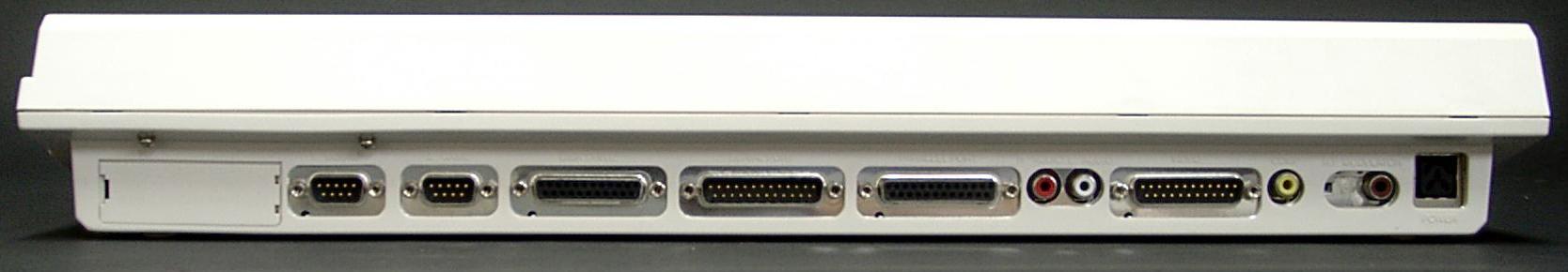

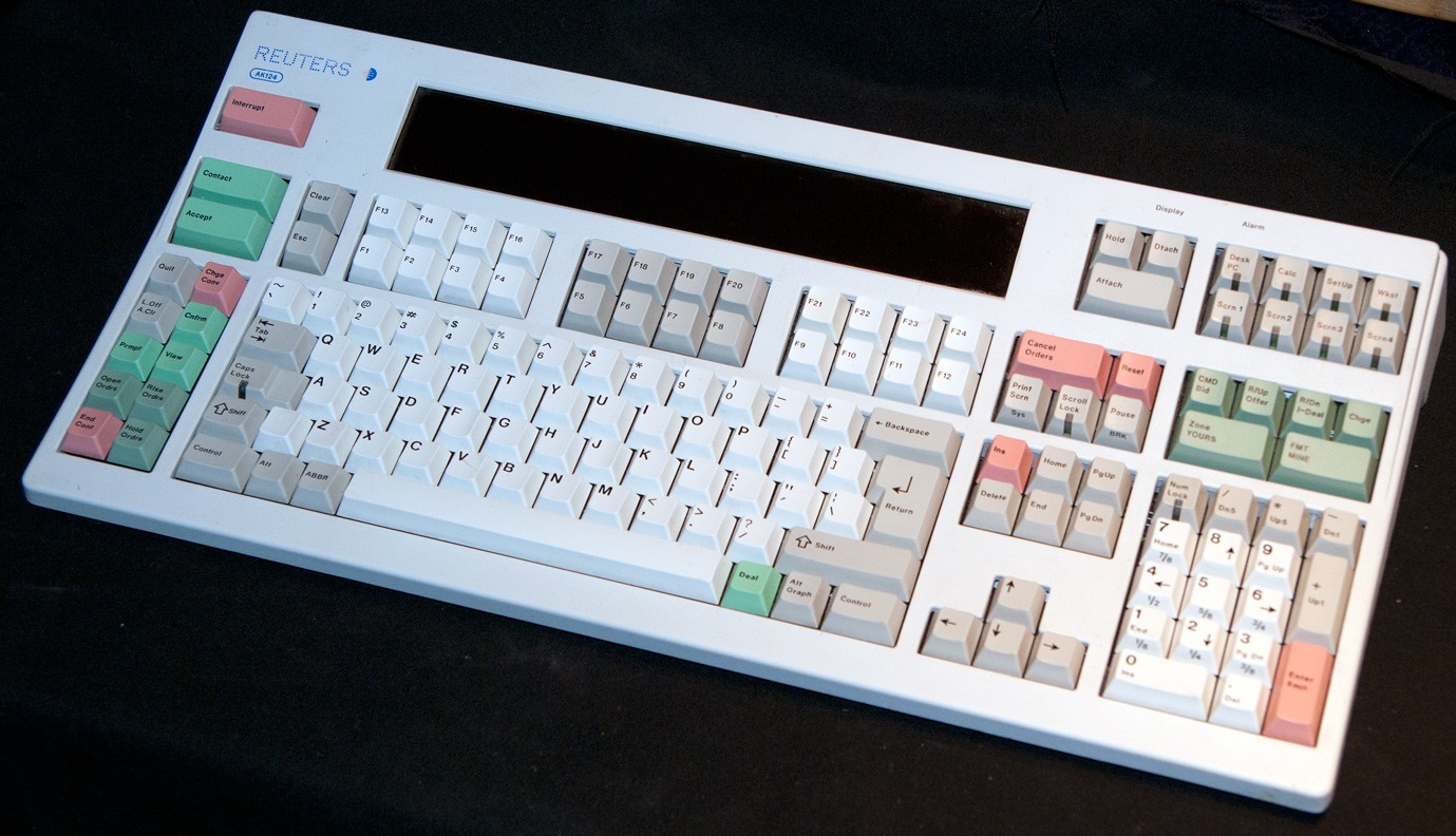

So I think there could be several levels of this.
21. Full keyboard with extra keys, display, and a multitude of ports on the back. Essentially imagine something like a Cherry / Reuters G80-9009, but it's running a C64 style prompt inside it, anything it displays on the LCD is actually a program, and it has a bunch of ports on the back like an Amiga 1200. Not those exact ports, the port names are just examples. Probably has Ethernet and the likes too. And obviously, much better keyboard switches, and almost certainly not MX clones. I imagine if this were to become a project, and it were to become popular, producing a relatively simple lo-fi key switch like a beam spring switch wouldn't be out of the question (those switches specifically are actually not that complex, so I'm surprised no one has made a 1:1 copy of them yet).
Cherry G80-9009
Cherry G80-9009

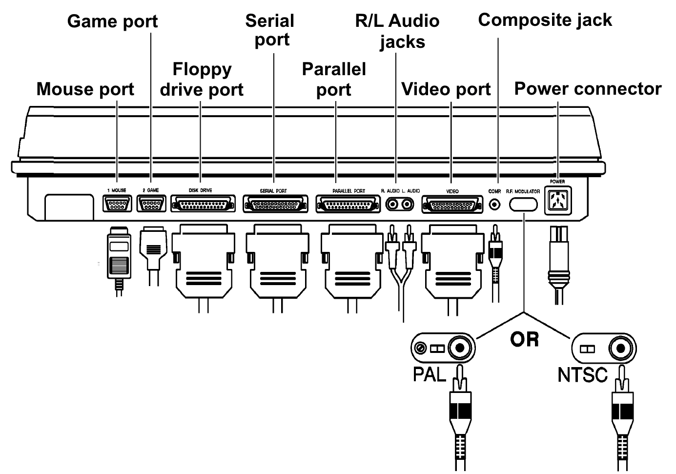

Amiga 1200 rear ports
Amiga 1200 rear ports explained

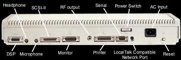

Comparison sheet:
Beautiful, amazing, limitless:
Atari Falcon 030 rear ports

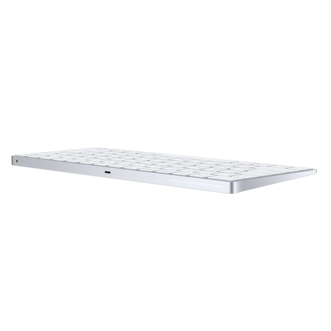

Sad, constraining, no future:
Apple magic keyboard rear (sad)
apple magic keyboard rear sad.jpg (34.7 KiB) Viewed 11335 times

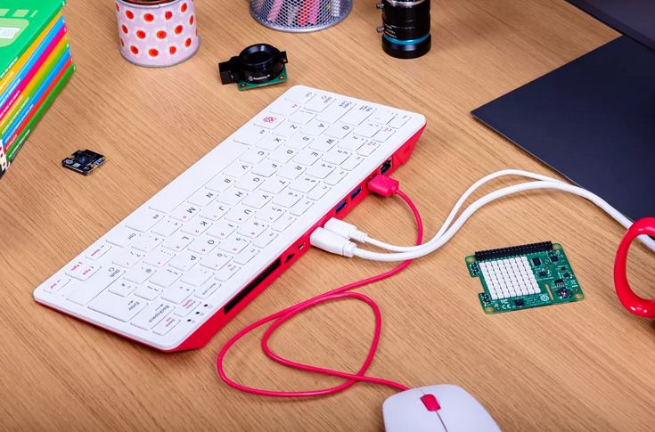

dcopellino
22 Dec 2020, 16:36
matt3o wrote: 22 Dec 2020, 08:44 Here
The keyboard is just a USB HID, remove it and build your own enclosure with cherrymx or whatever and a screen if you want. Added bonus GPIO..
Yours is a brilliant suggestion. At the same time, It would be nice to insert the raspberry pi 400 into a mechanical keeb of our choice, maybe our most liked one, without being forced to build a new one starting from the scratch. The dimensions of the raspberry pi 400 PCB should be 286mm × 122mm × 23mm. (Ask Chryros for an imperial conversion, LOL) I have already tried to get the measurements of the void space inside an IBM m122 type II, but despite my most optimistic expectations, it seems not to fit. Should I turn my gaze toward chubbier beamsprings?
iljitsch
22 Dec 2020, 16:52
Well, obviously the Raspberry Pi 400 already has a keyboard. So it makes more sense to use a regular Raspberry Pi without an enclosure or peripherals.
I await the first Cherry Pi. :mrgreen:
-[°_°]-
22 Dec 2020, 18:38
iljitsch wrote: 22 Dec 2020, 16:52 Well, obviously the Raspberry Pi 400 already has a keyboard. So it makes more sense to use a regular Raspberry Pi without an enclosure or peripherals.
rpi400 is easier to fit into a keyboard due to the form factor

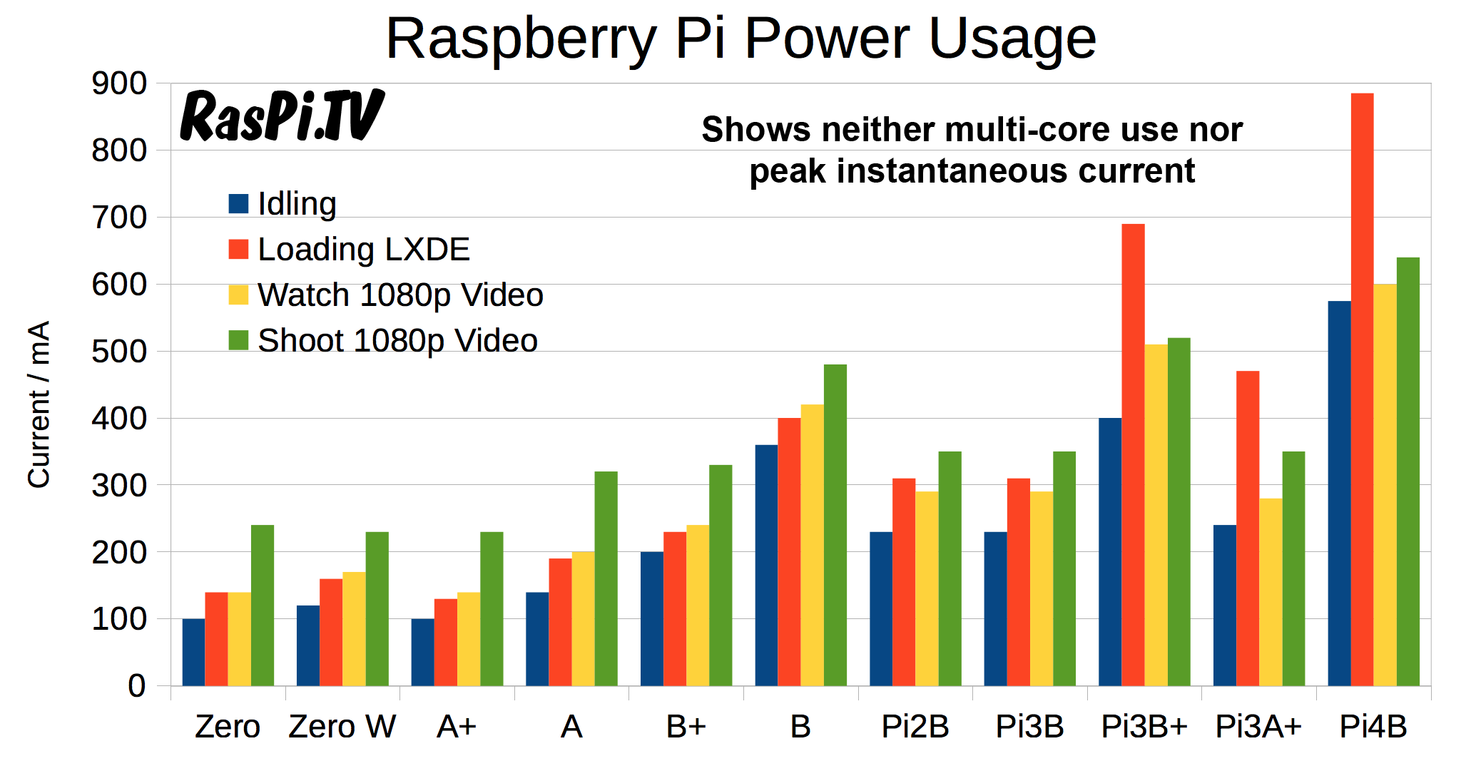

49. honestly I'd really like a keyboard to be wireless, which kind of precludes using the raspberry pi, as it uses between 100 and 600 mA when merely idling depending on the model used. However that's with their standard OS and not custom firmware which I would use anyways if I wanted to.
raspberry pi power draw comparison under various scenarios

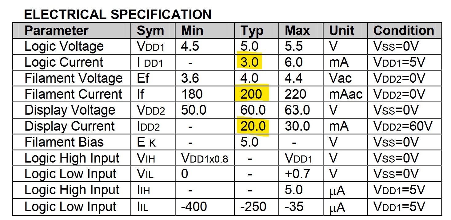

I think the best idea is to have the keyboard's core functionality in an ultra-low-power device like msp430, and have higher functions (configurability, interactivity with its UI, basic/forth/some scripting language interpreter, more involved external peripheral control) inside a more powerful microcontroller. Finally, the most powerful stuff (display control, hdmi or vga output, compiling configured code down into efficient msp430 code) could be done on an SoC. The msp430 is essentially running all the time, most of the time in ultra low power state, and the more power hungry chips get booted every time you're doing something involved. msp430 is the kind of thing used in places like bluetooth earbuds etc where every microamp matters. it's probably a good idea to not use an involved configurable code base on it, and instead recompile a binary image for it every time you want to change the behavior of the code running on it, to maximize efficiency and minimize power draw. once you're done compiling, shut down the power hungry parts.
50. on the other hand i'd love for my keyboard (as opposed to a build someone else would do for themselves) to also have a solenoid or a vfd, which may take more power than a raspberry pi... so having a hefty battery pack might be written in the stars anyways. a 128x32 vfd from Noritake Itron uses ~ 223mA typical input power, which isn't that much, and 200 of it is the filament current. So maybe it's not as much as a raspberry pi. And you can turn it off when not using it. No idea about the solenoid though. Probably a lot. But then it's more of a fun gimmick and maybe I won't be using it all the time. Maybe on AC power only.
Noritake Itron MN12832JC 128x32 pixel VFD typical input current
MN12832JC typical input current.jpg (287.82 KiB) Viewed 10963 times
MN12832JC.pdf
Noritake Itron MN12832JC datasheet
(128.75 KiB) Downloaded 280 times
