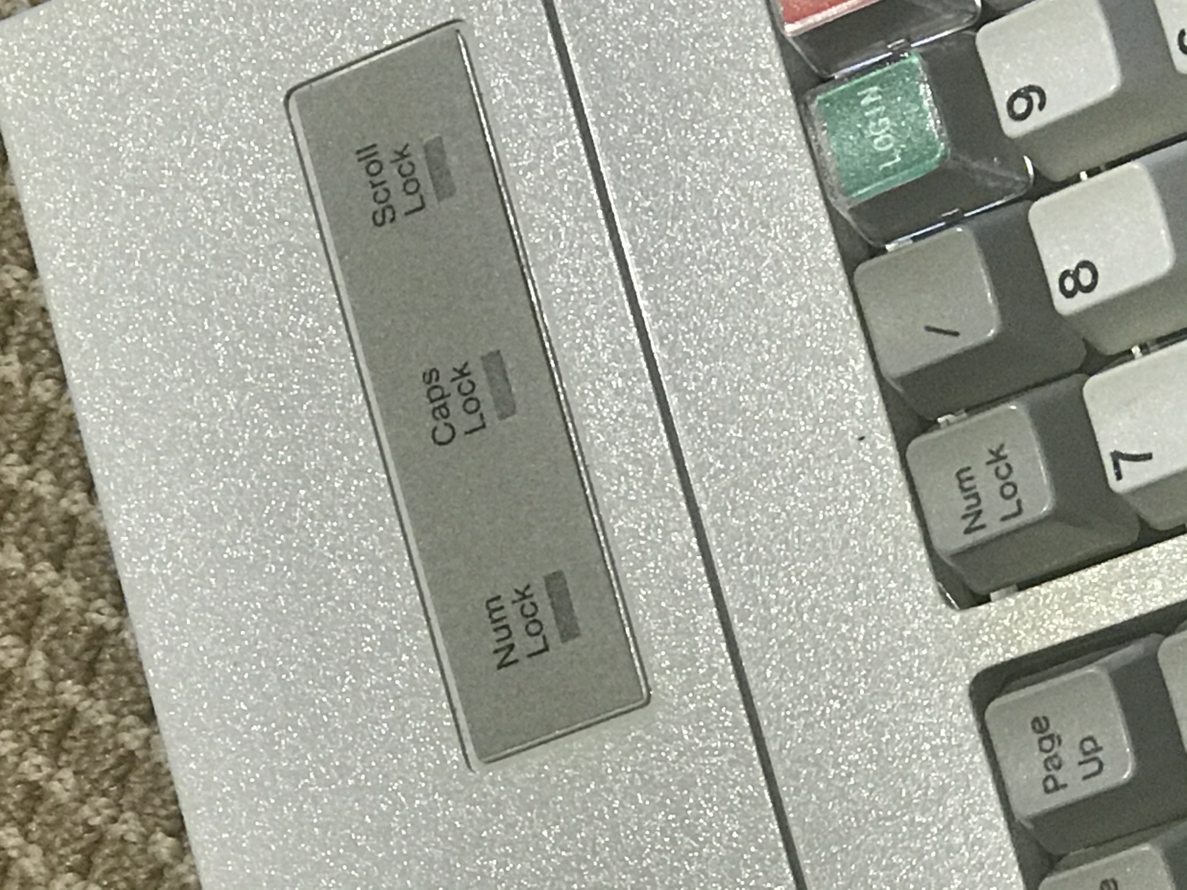

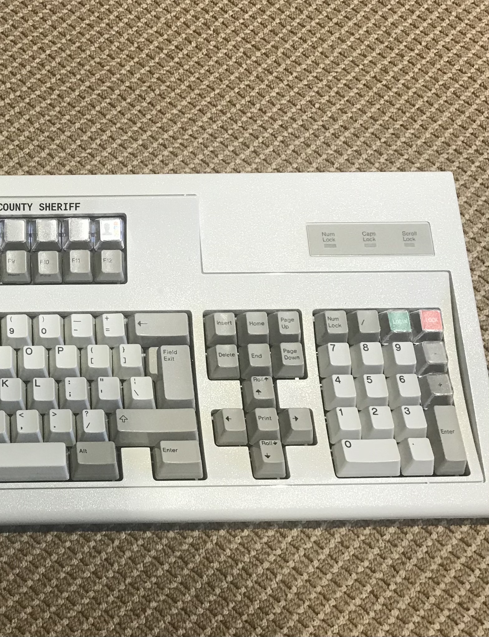

I recently modified a M122 but wanted to add the lock LEDs and make it look as original as possible. Rather than trash a model M to get the lock LEDs bezel I put hats number of IBM Point of Sale (POS) keyboards and used the bezel and LEDs from those.
- Photo 1
- 318C0106-F413-421E-836C-DBE3BDA8E0A4.jpeg (1.95 MiB) Viewed 6077 times
- Photo 2
- 85B3C69A-5FB9-42BF-B2A5-3CAB7D0D7E61.jpeg (1.18 MiB) Viewed 6077 times

Oh man such a smooth job on this. I may have to attempt copying you. I think I'd be ok with a unicomp overlay. They are cheap enough. Wait so what was there before you did this? Just pure smooth case?

Misread you, thought you said "good luck with that LED problem!" Like sarcastic. You like modern, nothing wrong with liking modern. I don't like it. Everybody got their own thing.
The part I am confused about is the depression groove around the lock lights... was that already there or added on?

You are right, I have an earlier 122 without the depression. I was looking at mine and thought he grafted that onto his. Or milled it out...

Yes with the very slight indentationYasu0 wrote: 20 Sep 2020, 00:26 Oh man such a smooth job on this. I may have to attempt copying you. I think I'd be ok with a unicomp overlay. They are cheap enough. Wait so what was there before you did this? Just pure smooth case?

Just to be clear the etching/indentation was there already. Underneath was smooth plastic. I drilled out holes for the LEDs and using a glue gun secured them so they were flush with the surface (the LEDs are rectangular). The overlay/label and LEDs were off a NOS 4683 POS keyboard. For those of you who like the classic IBM look I just figured I’d show what you can do with an otherwise useless RS485 based POS keyboard. Now if only I could figure out how to add a solenoid to a model M. Wish Soarer would reappear to add one little feature to his firmware. Take care.
