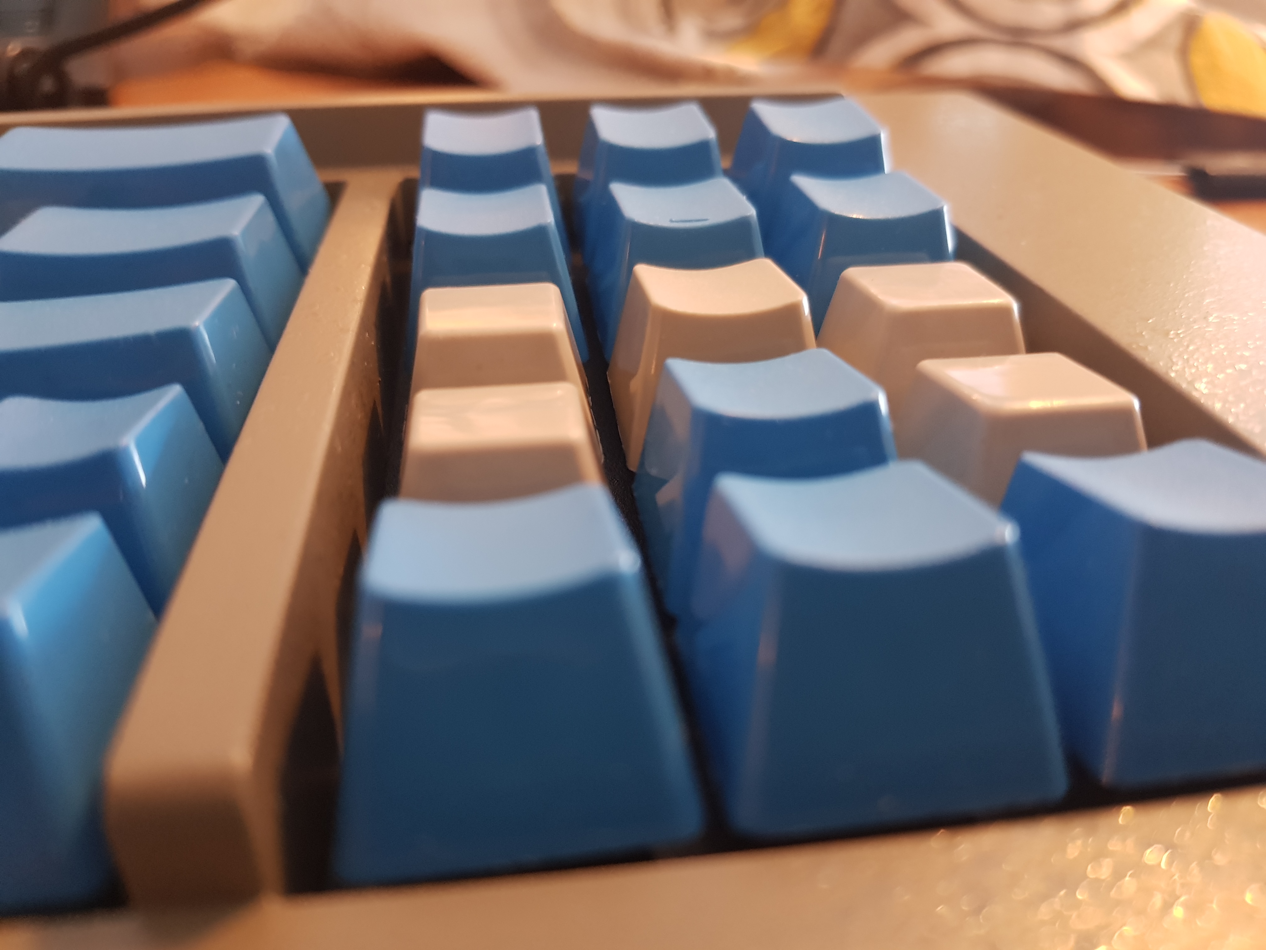

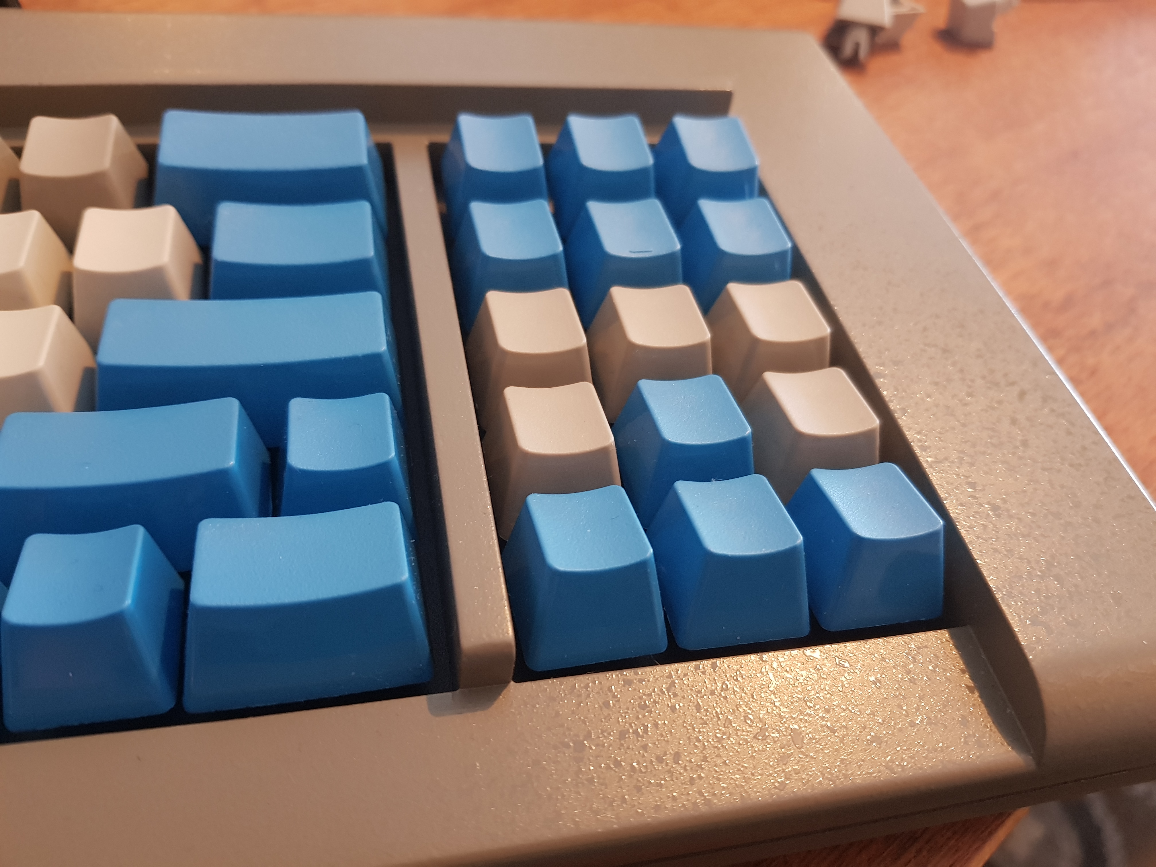

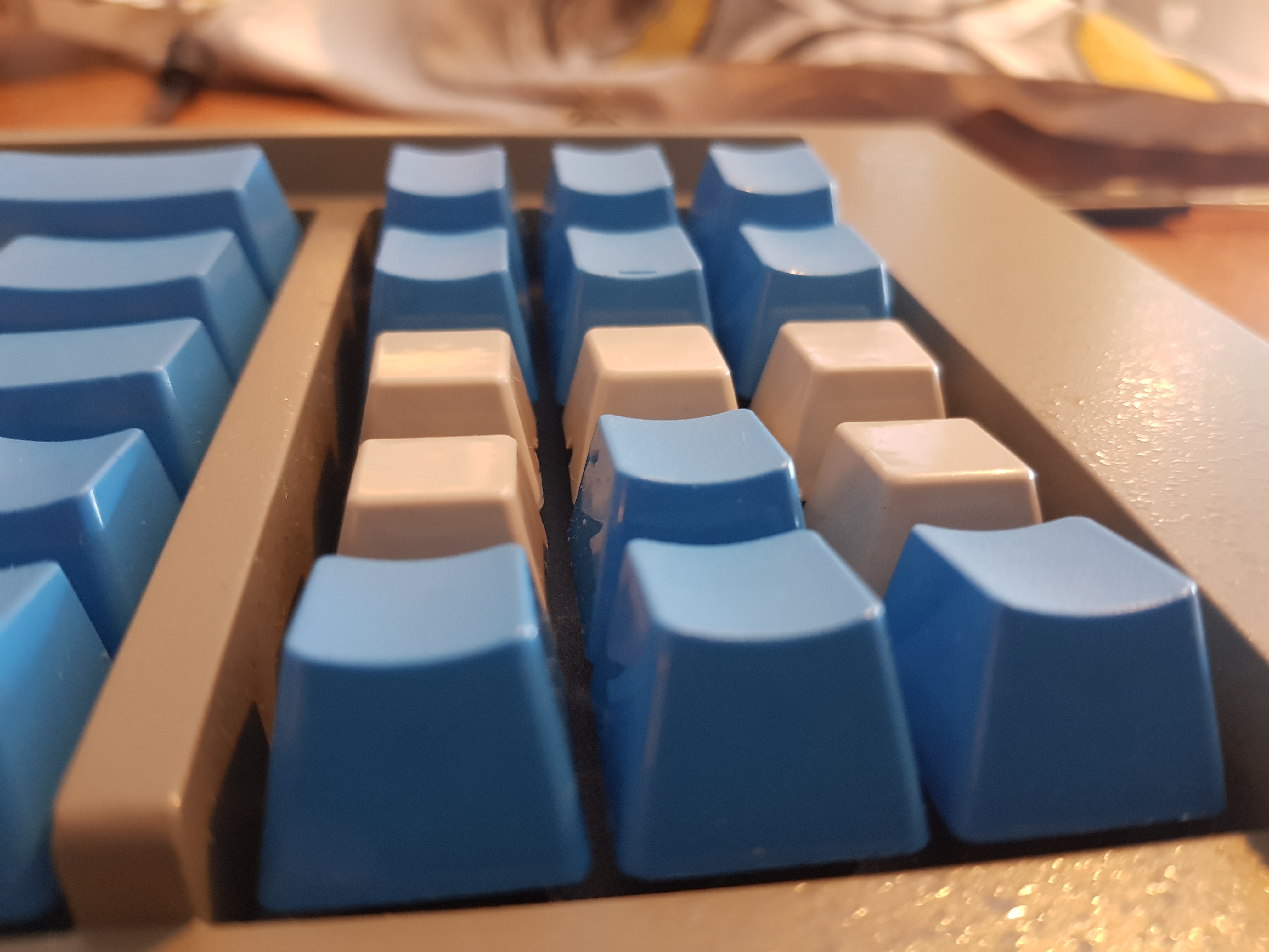

If you don't need the extra keys, you could always remove the keys and barrels in these positions giving you the clearence you want.
Other than that, the flattest and most low profile bs caps must be the model m two piece caps running with the hat off.
Took out some caps to give you an example
On a Model F it will look like this:
"Flatness" is seen here:
Normal as reference;

Twst wrote: 03 Apr 2020, 18:40 If you don't need the extra keys, you could always remove the keys and barrels in these positions giving you the clearence you want.
Hi agree. On BS keycaps the plastic is basically connected all at the "top," there basically is no room to reduce the height aside from the model m overcap reduction.
