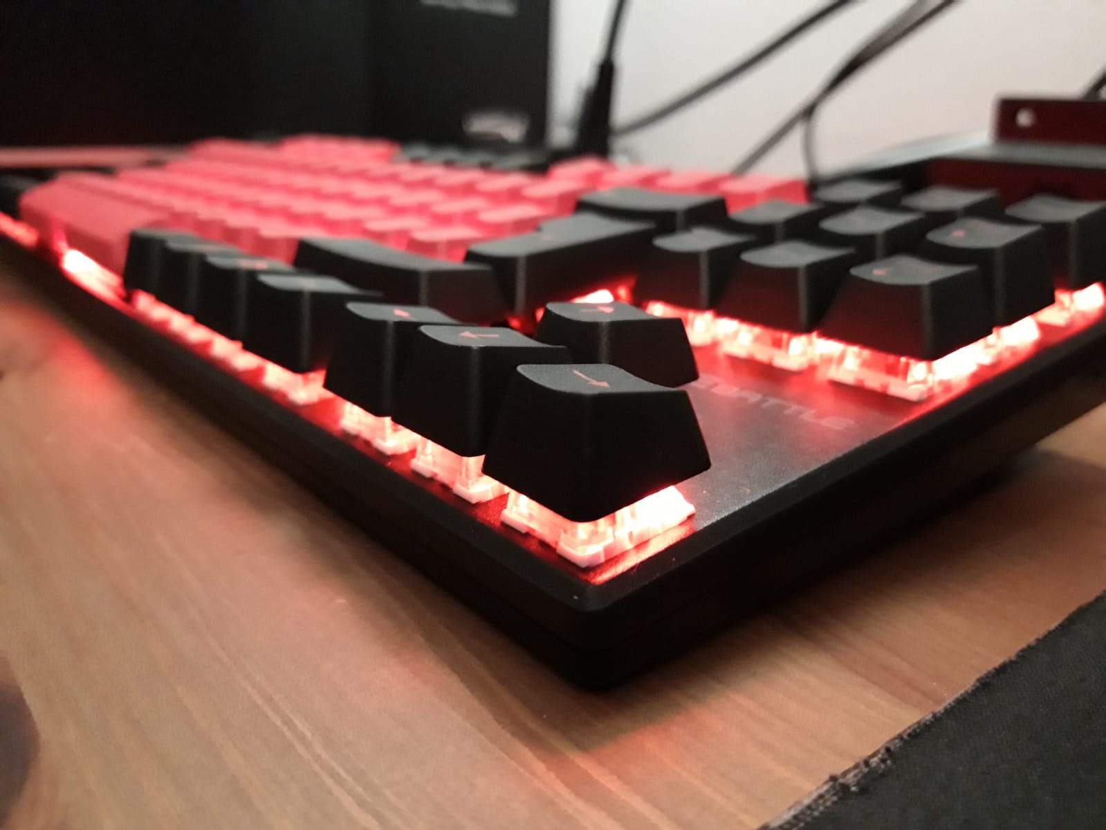

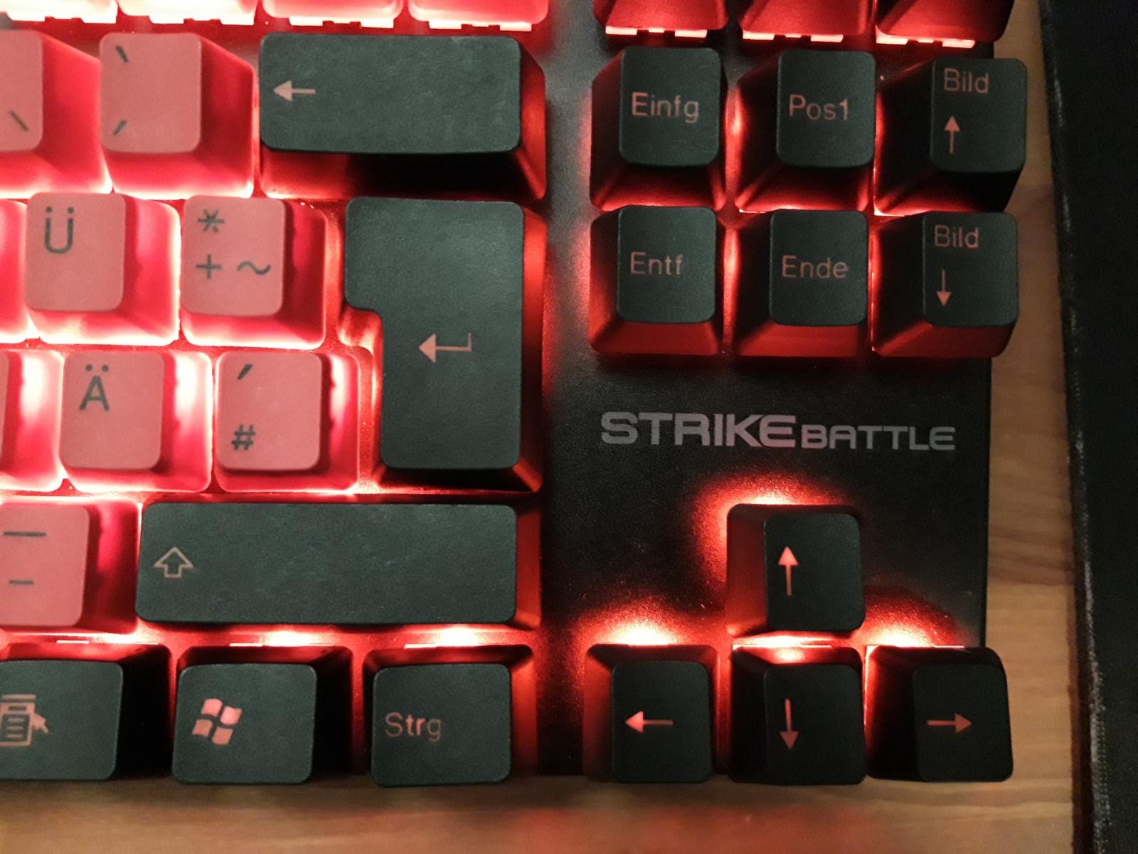

recently I have started a budget project.
Instead of buying expensive Kits I decided to buy old gaming keyboards from eBay Classified and pimp them.
I started off my project with an Ozone Strikebattle. Cherry MX Browns were desoldered and shiny thin ABS keycaps were removed.
I soldered in some Kailh Speed Bronze switches and put some Tai Hao Red and Black Keycaps on. Stabilizers were lubed with Superlube.
This keyboard is now a joy to use in CS:GO.
Next up is a banged up Lioncast LK20.
EDIT: LEDs are soldered in as well. The light bleed because of the clear tops is much nicer than with the MX Browns that were initially built into the board (which had black tops).
