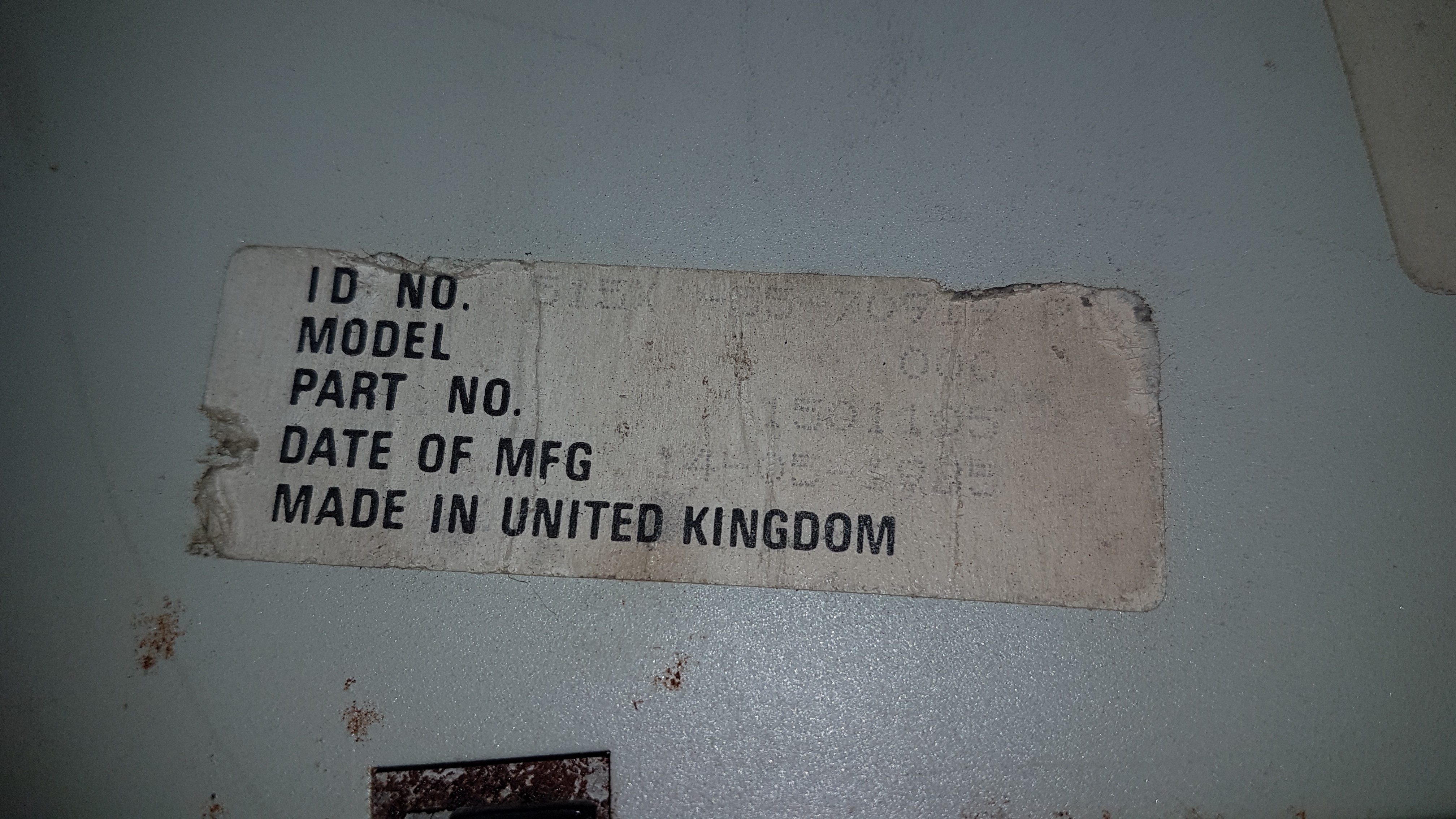

On the weekend, I finally popped my Model F cherry - I grabbed it on ebay after the seller kindly opened the auction to offers. The pictures didn't show much other than some rust spots on the back plate and two cracks in the top plate. The only thing missing so far is a single spring.
The rear sticker indicates it's a 515x with the model number 1501105 and assembled in 1985. The original cable appears to have been replaced.
rear sticker.jpg (1.73 MiB) Viewed 9785 times

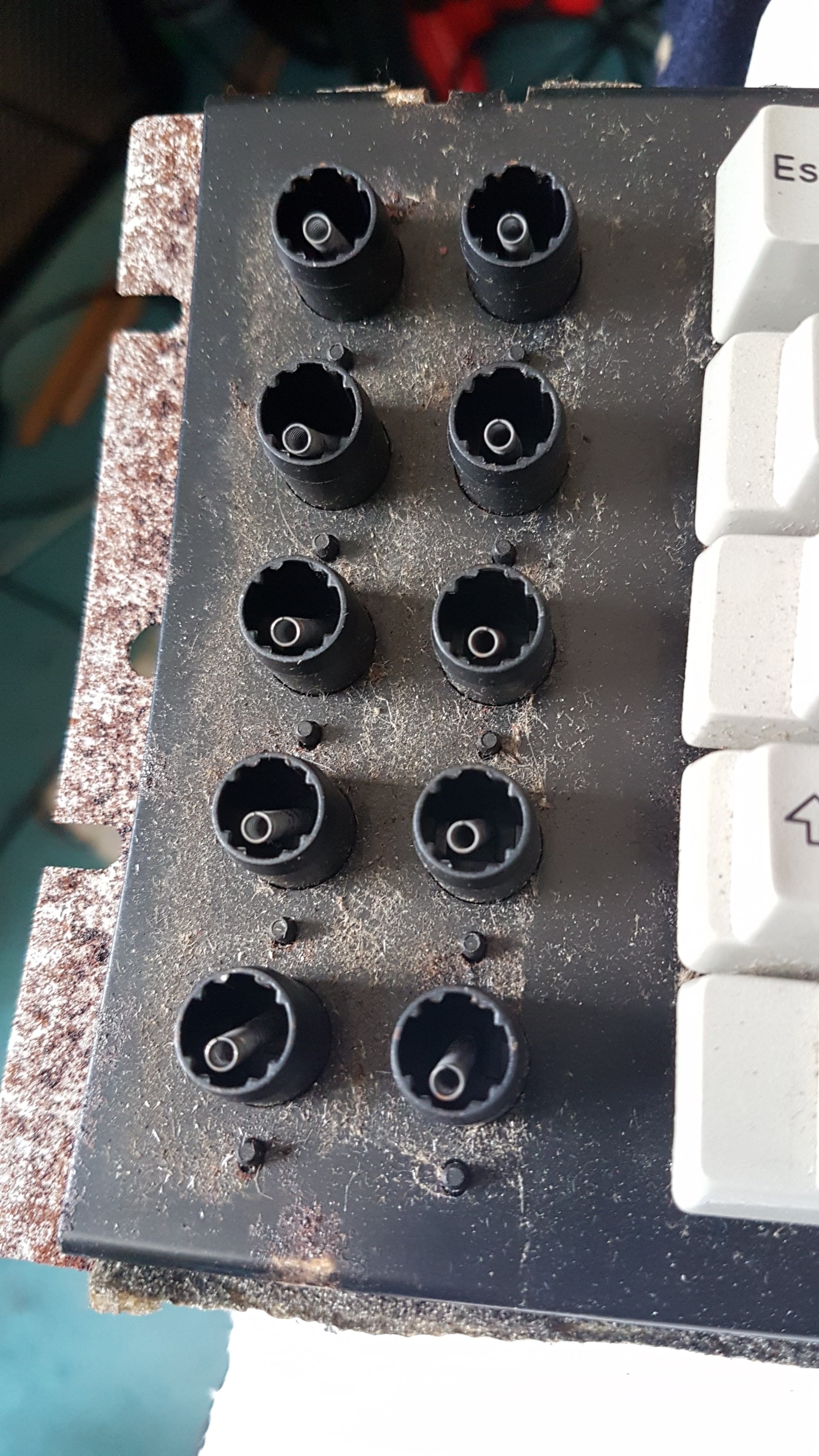

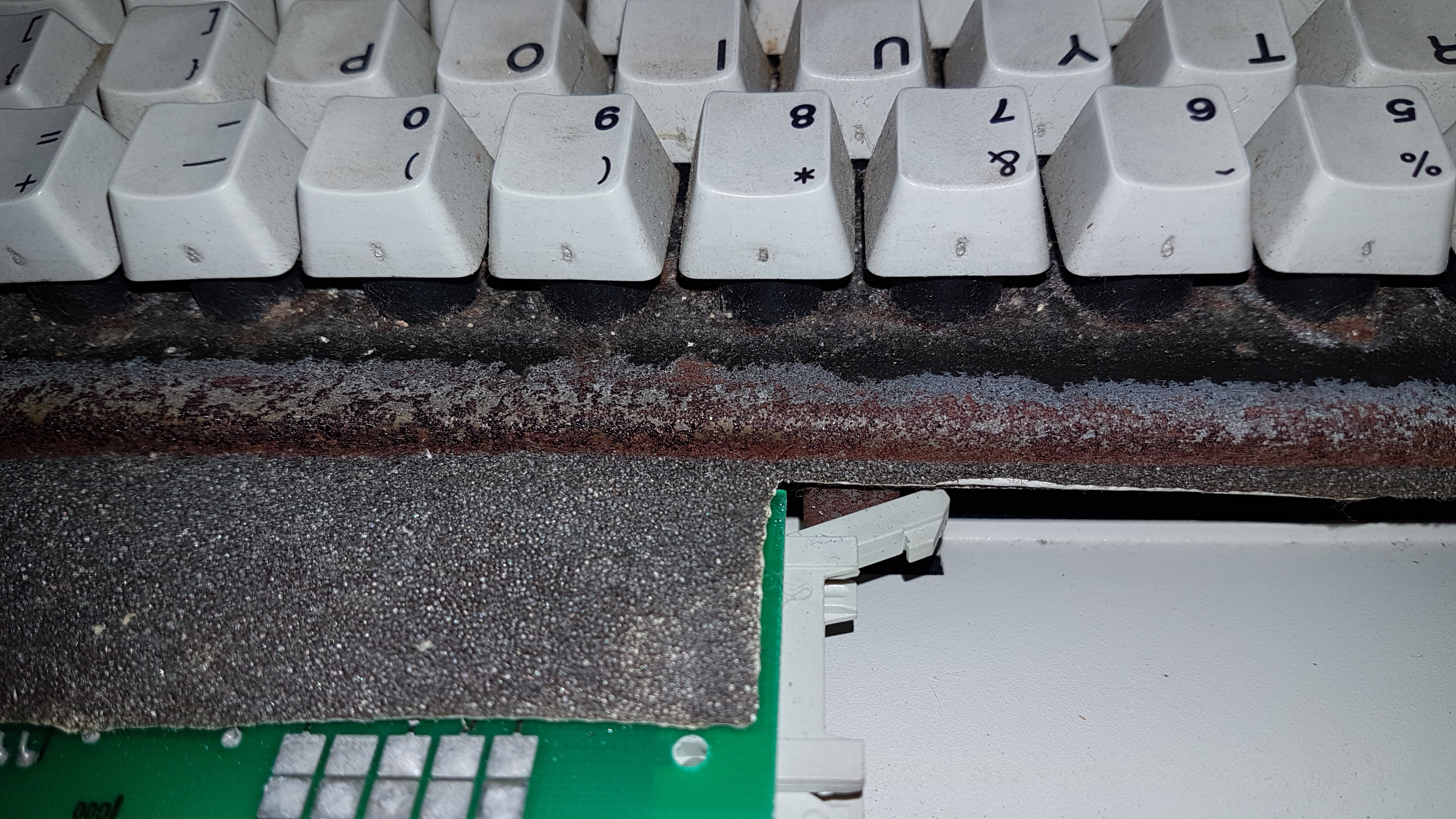

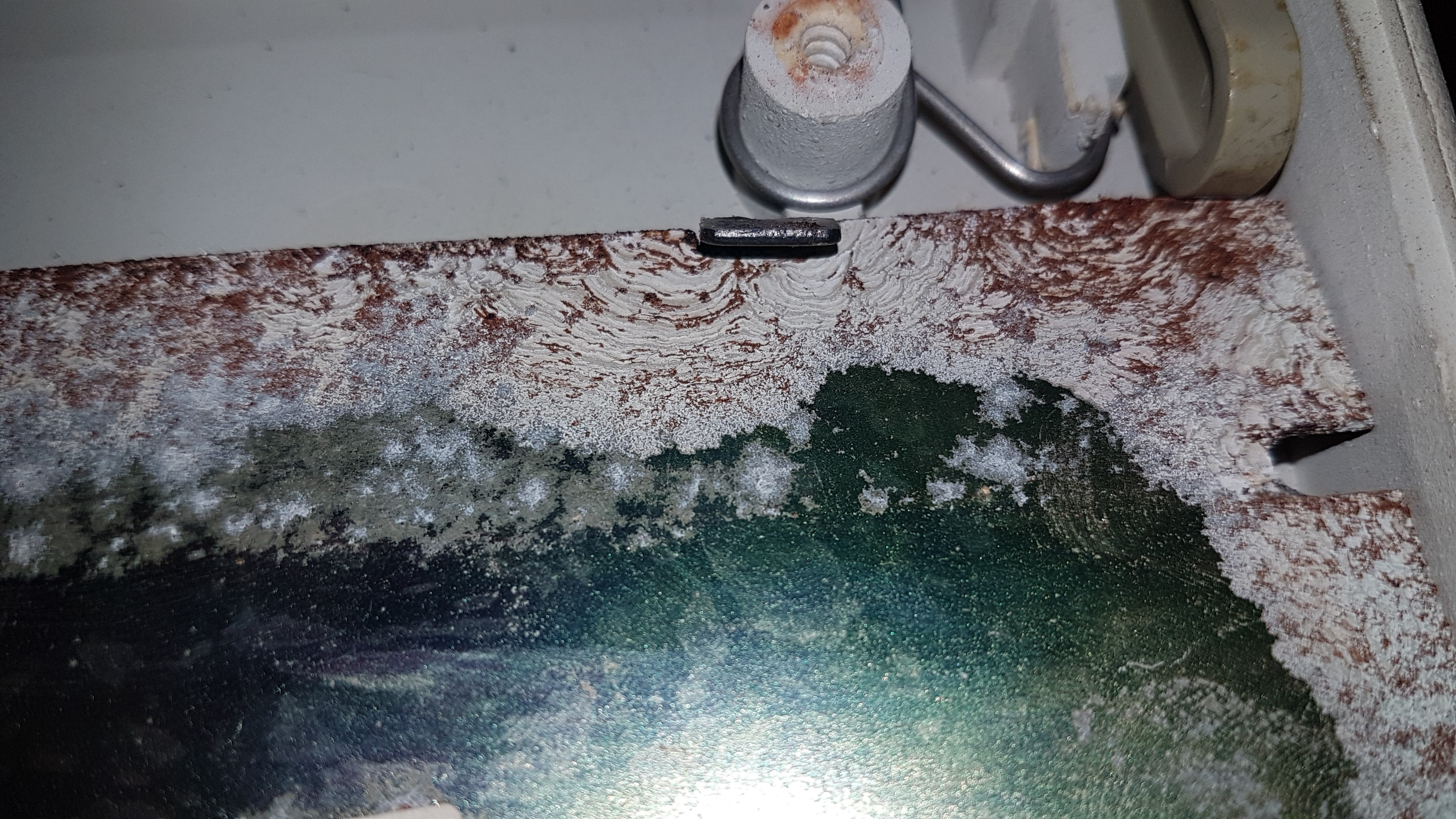

Once I was finished typing on it, I opened it up to be greeted with a lot of powder (from the foam) and LOTS of rust - nice
This is possibly the worst rust I've seen in a keyboard, and I've had a lot of bad ones. I'm confident that this was, at some point in it's life, partially submerged in water. I began by taking the keycaps off so I could see the damage - the barrel plate is also rusted but not as bad (on the top, that is)
dust under caps.jpg (1.93 MiB) Viewed 9785 times

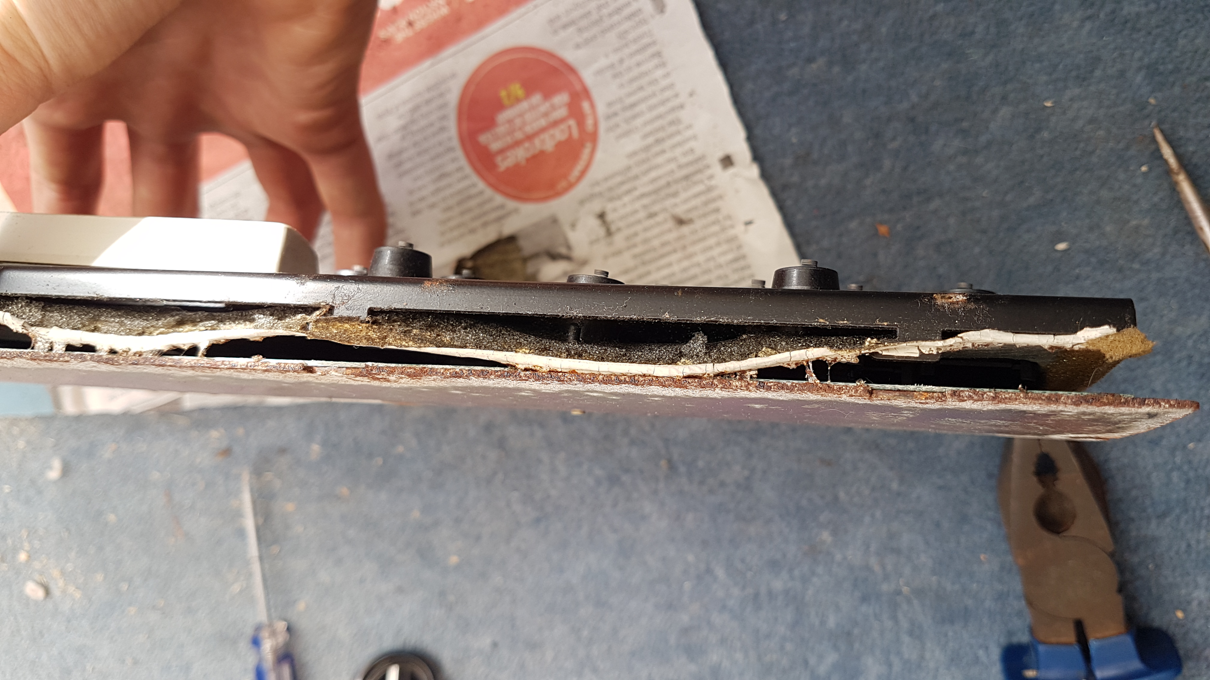

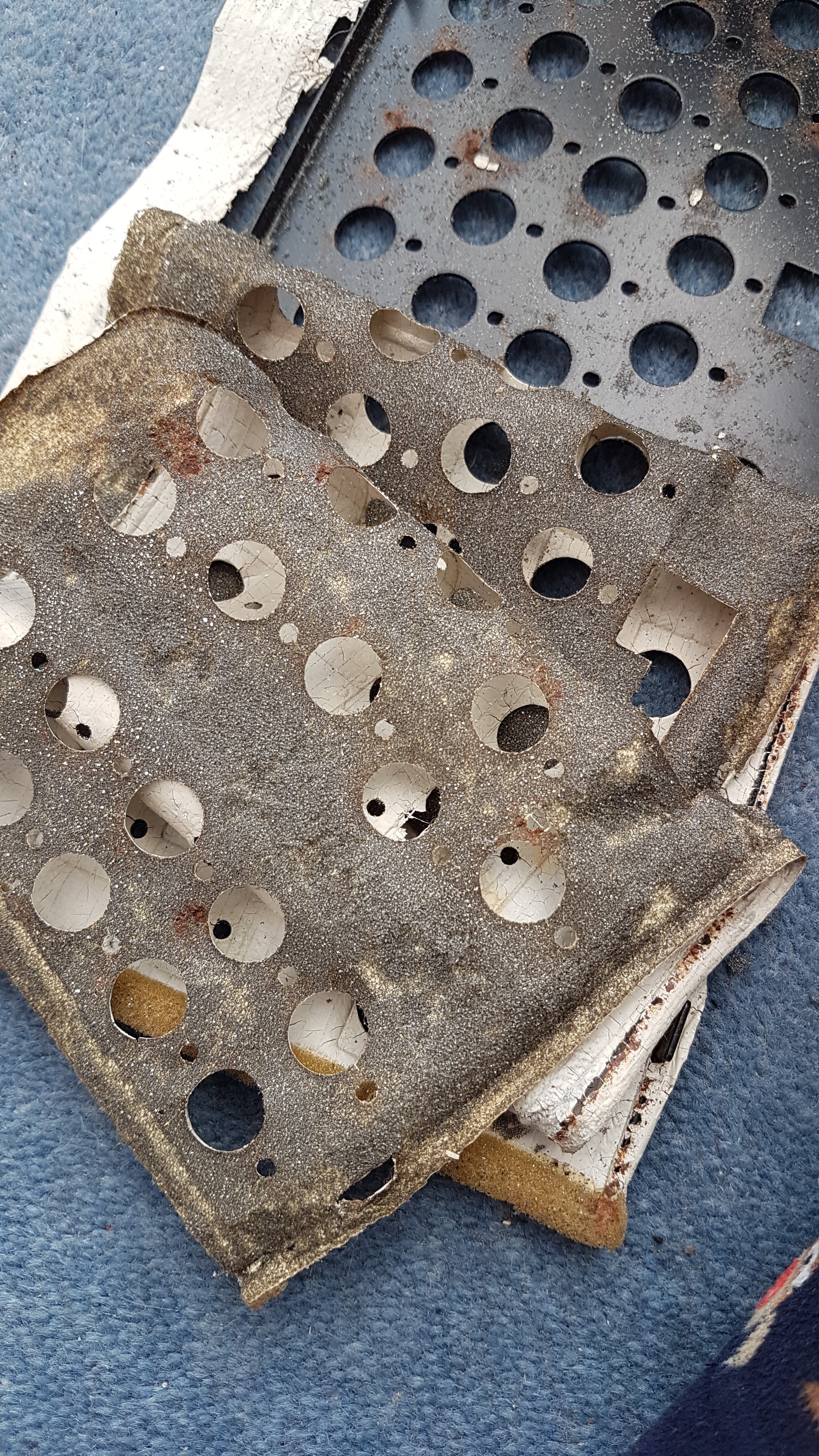

Once all the caps were off, I separated the assembly with the help of some pliers. The goo from the foam and the rust made this difficult.
The foam was completely powder and goo meaning I need to make a new foam mat at some point
foam 2.jpg (3.37 MiB) Viewed 9785 times

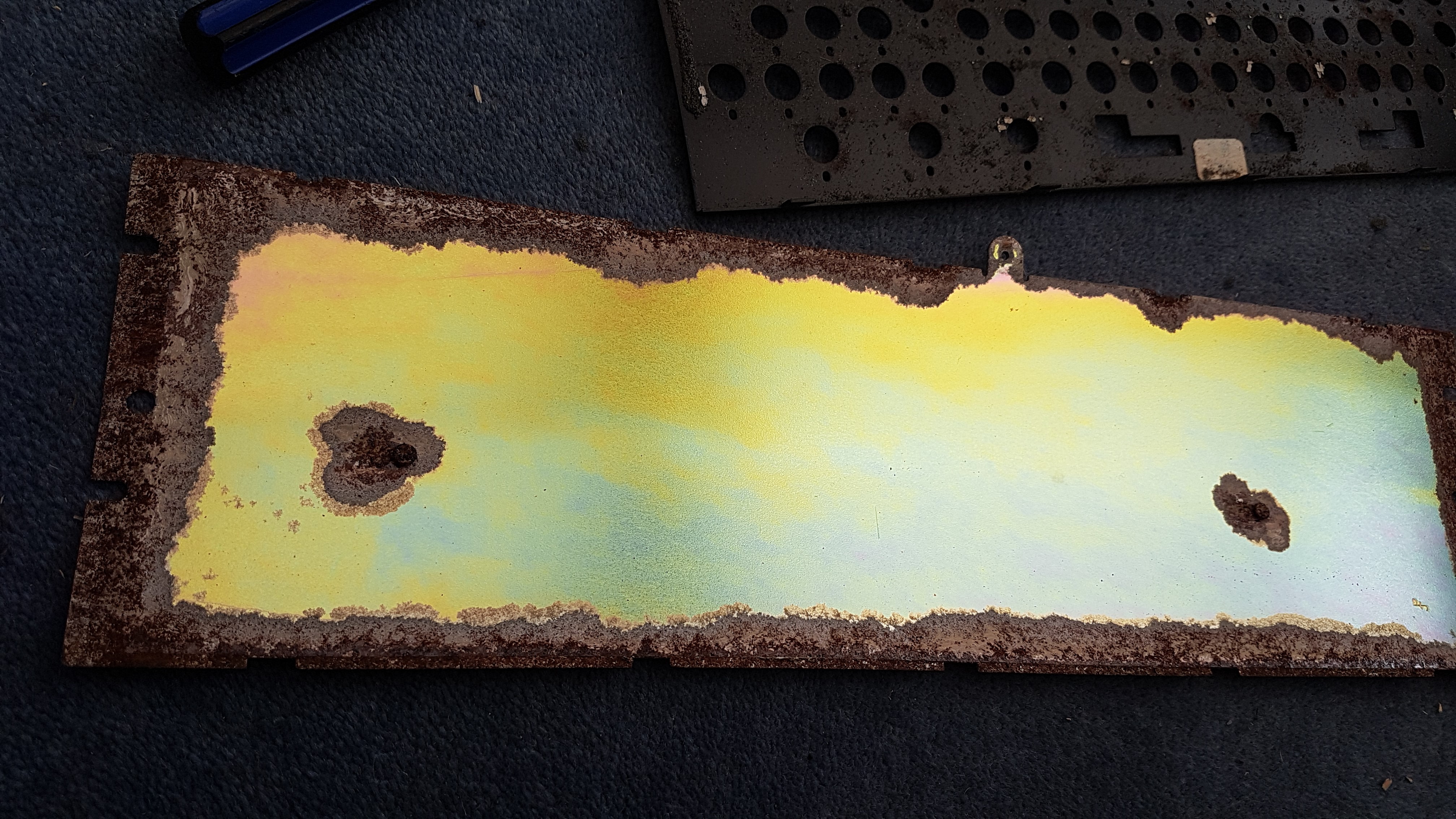

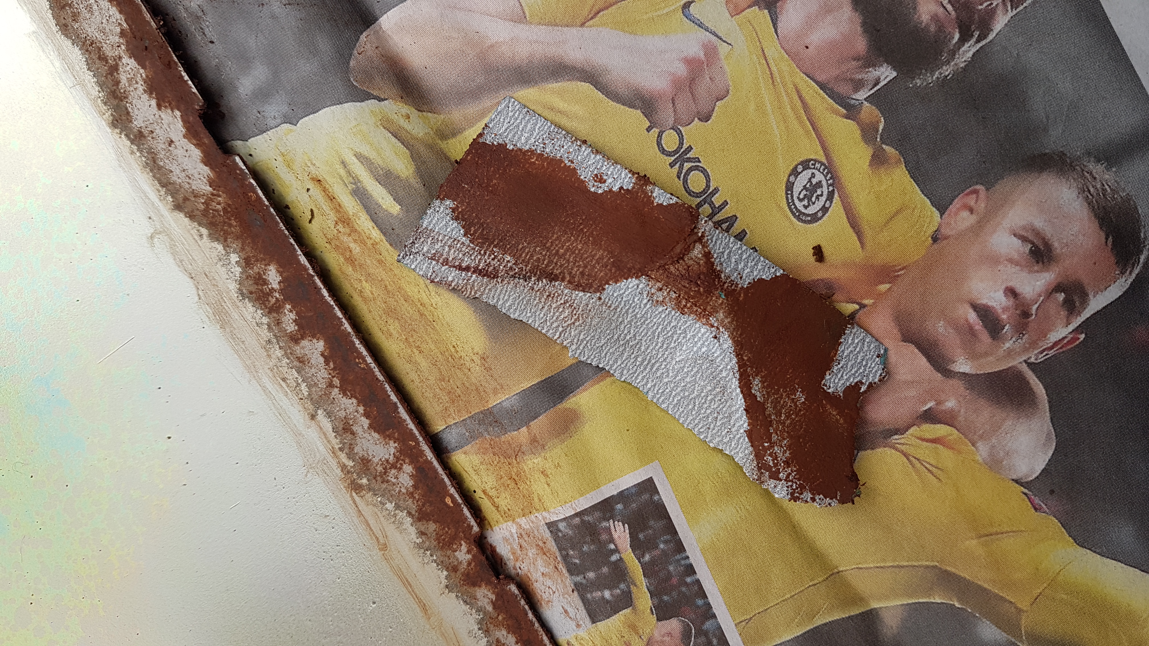

The rust is incredibly bad on the inside as well. I've started sanding it down but it will take a while before I'm finished. My goal is to spray everything with Polyurethane but I'm not sure how effective that would be.
rust on inside.jpg (2.24 MiB) Viewed 9785 times
rust sanding.jpg (4.97 MiB) Viewed 9785 times

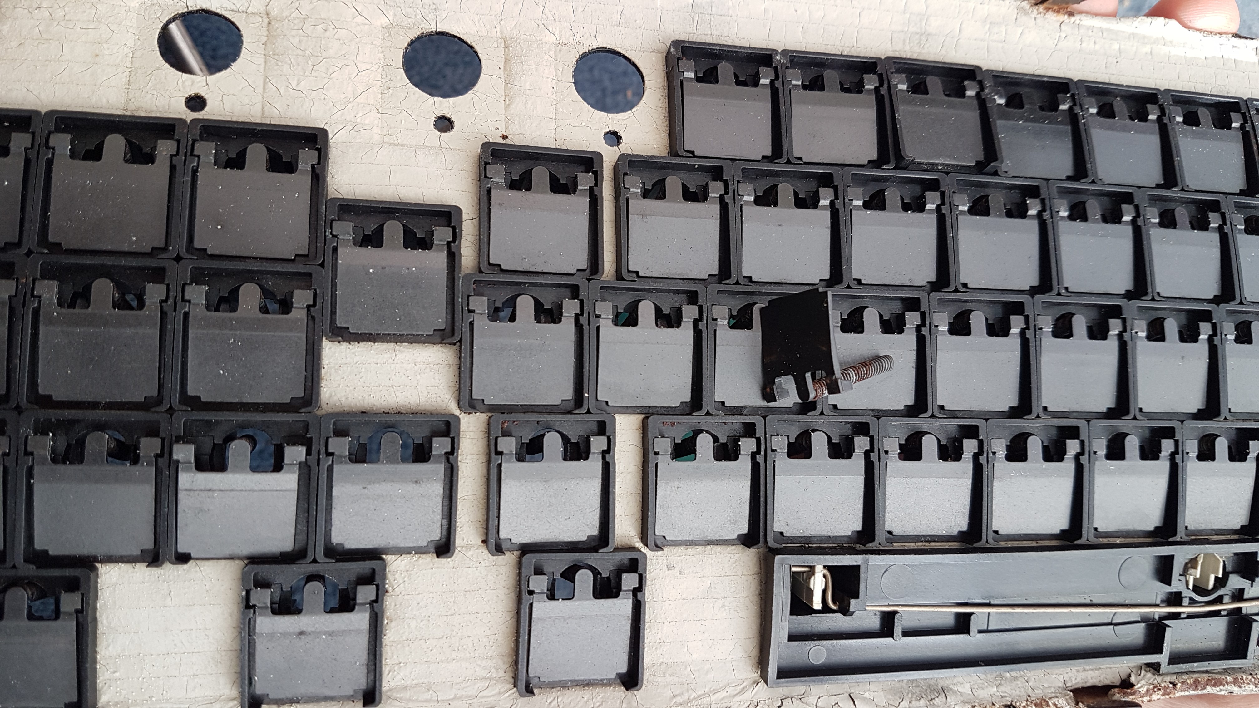

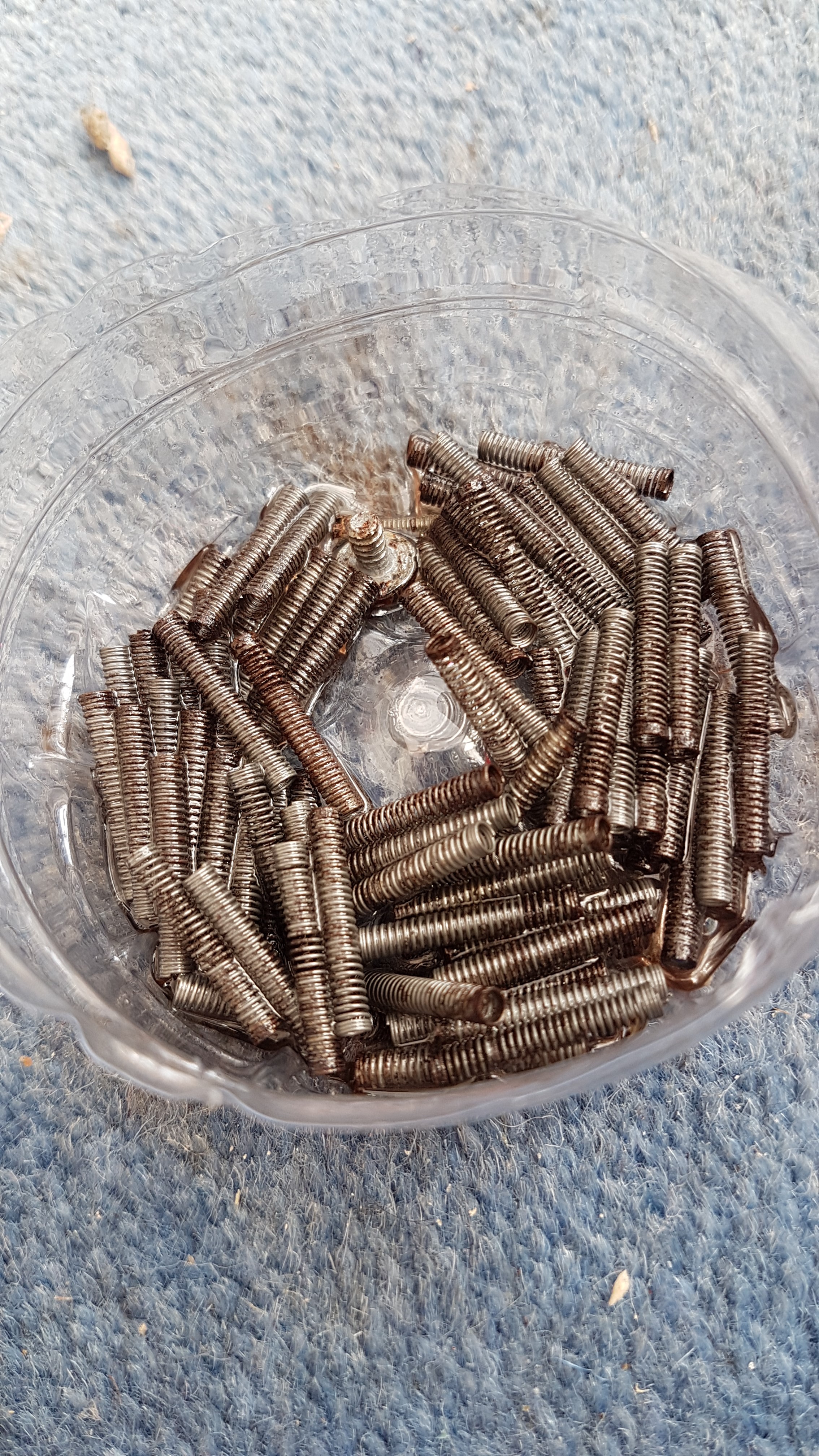

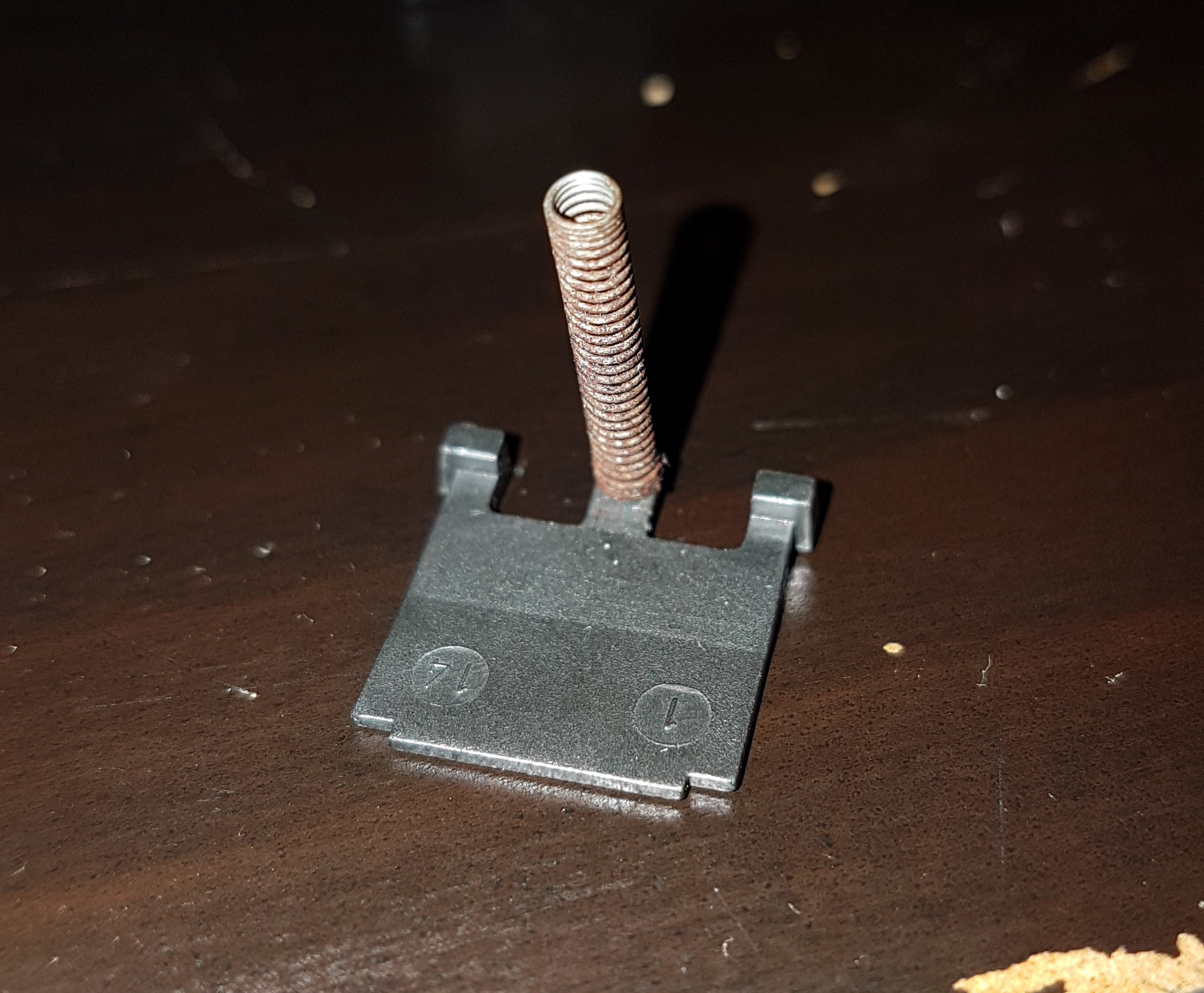

Regarding the other hardware, I've currently got the barrels and keycaps soaking in soapy water and springs and bolts soaking in WD40. So far the springs are looking much better as they were coated in rust.
springs in wd40.jpg (2.51 MiB) Viewed 9785 times

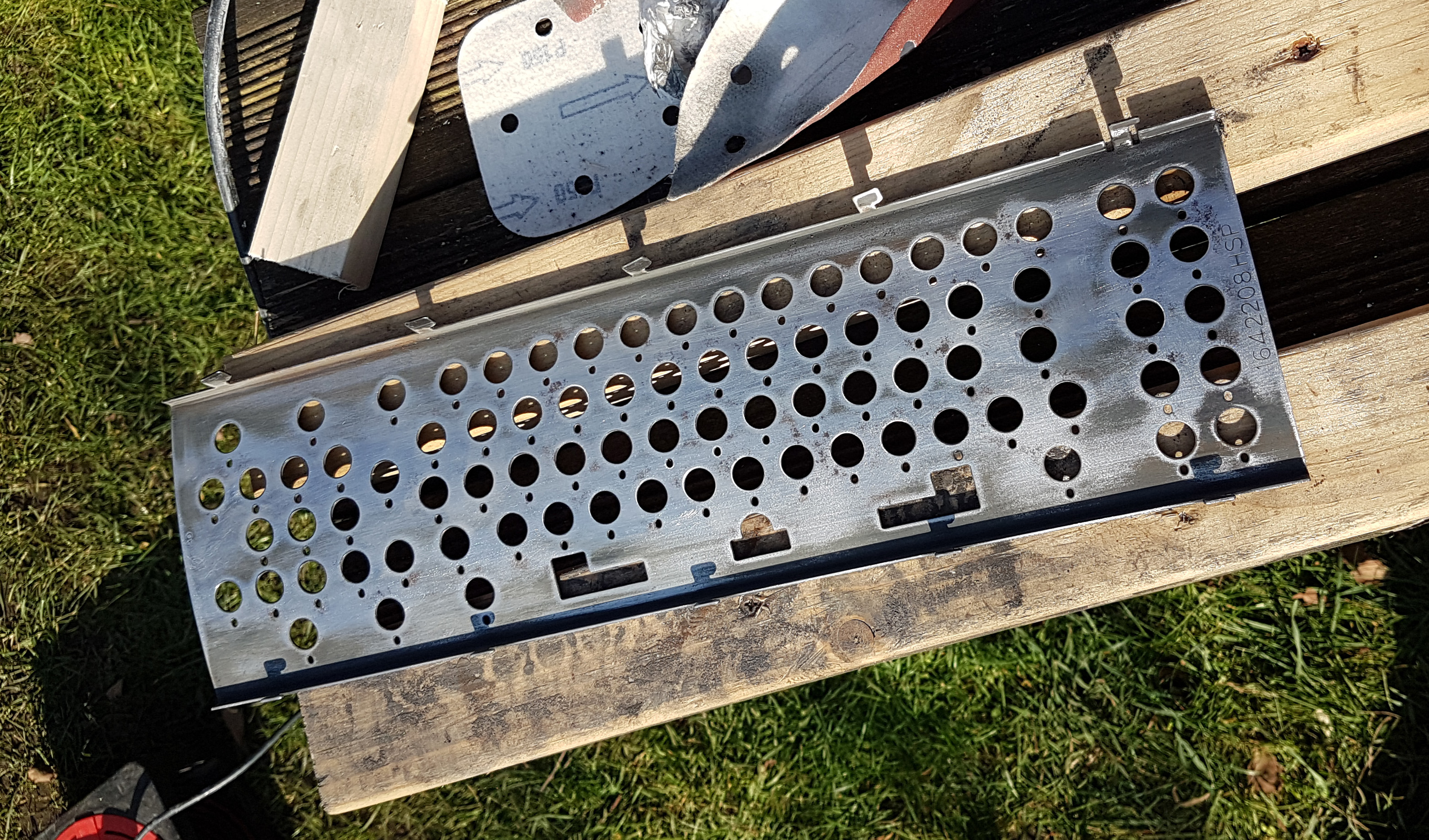

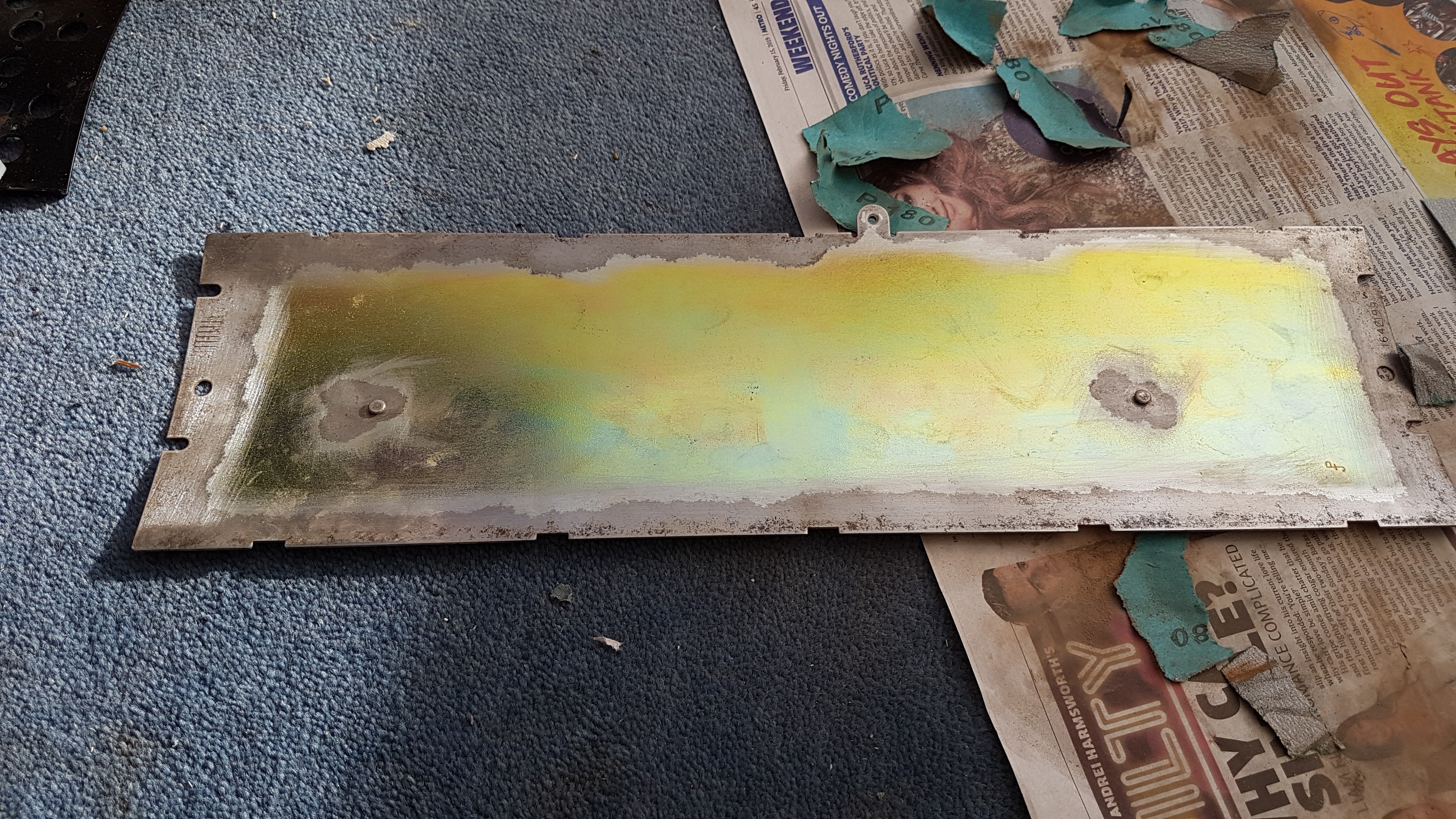

While the keycaps and barrels were drying off, I finished sanding the rust off the bottom plate. Unfortunately, I had to leave one spot because I would've had to destroy a sticker otherwise.
rust removed.jpg (2.91 MiB) Viewed 9675 times

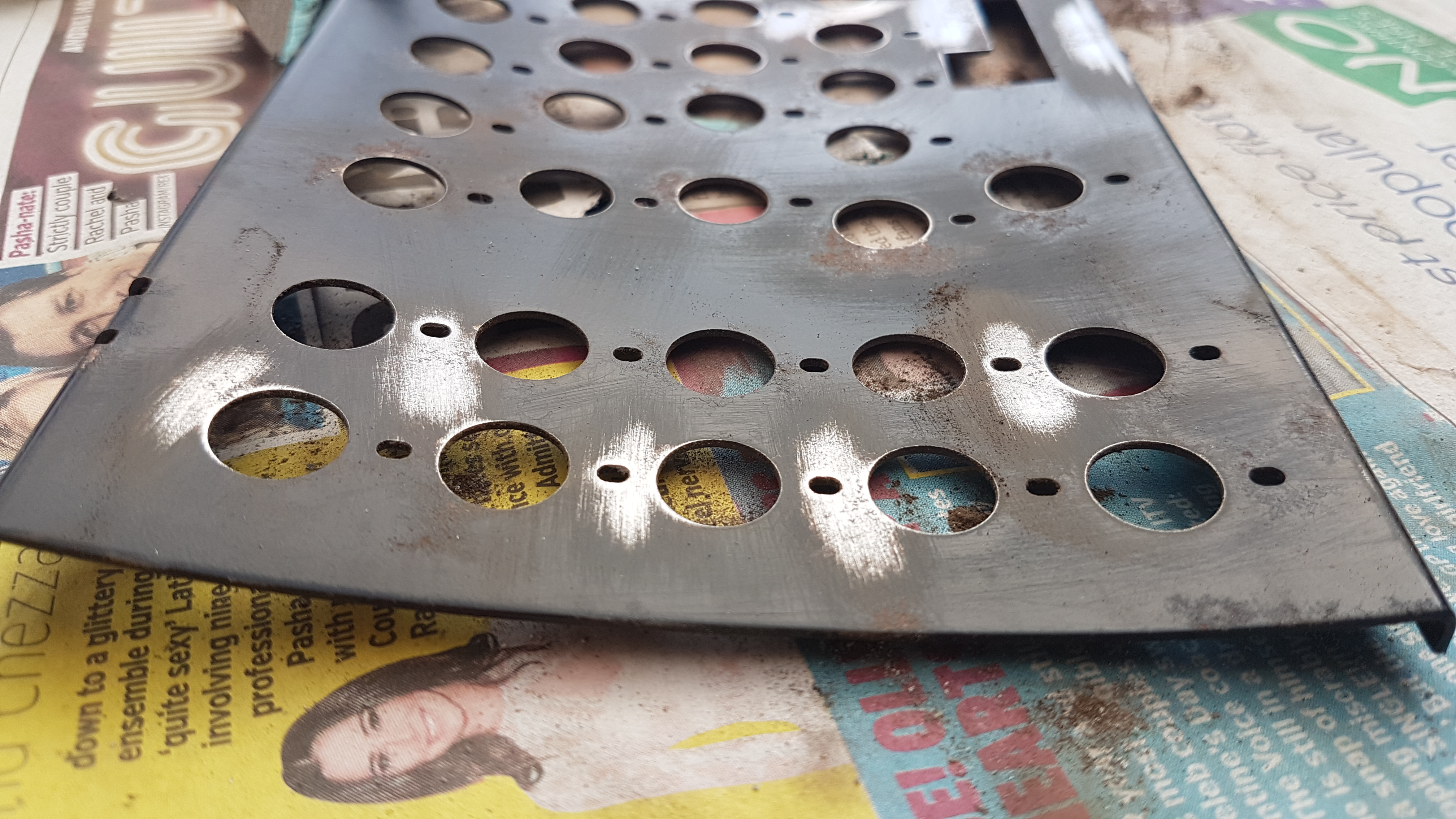

The barrel plate is frustrating as it's hard to sand. I'm also going to have to paint this part once I'm done sanding.
removing rust.jpg (2.79 MiB) Viewed 9675 times

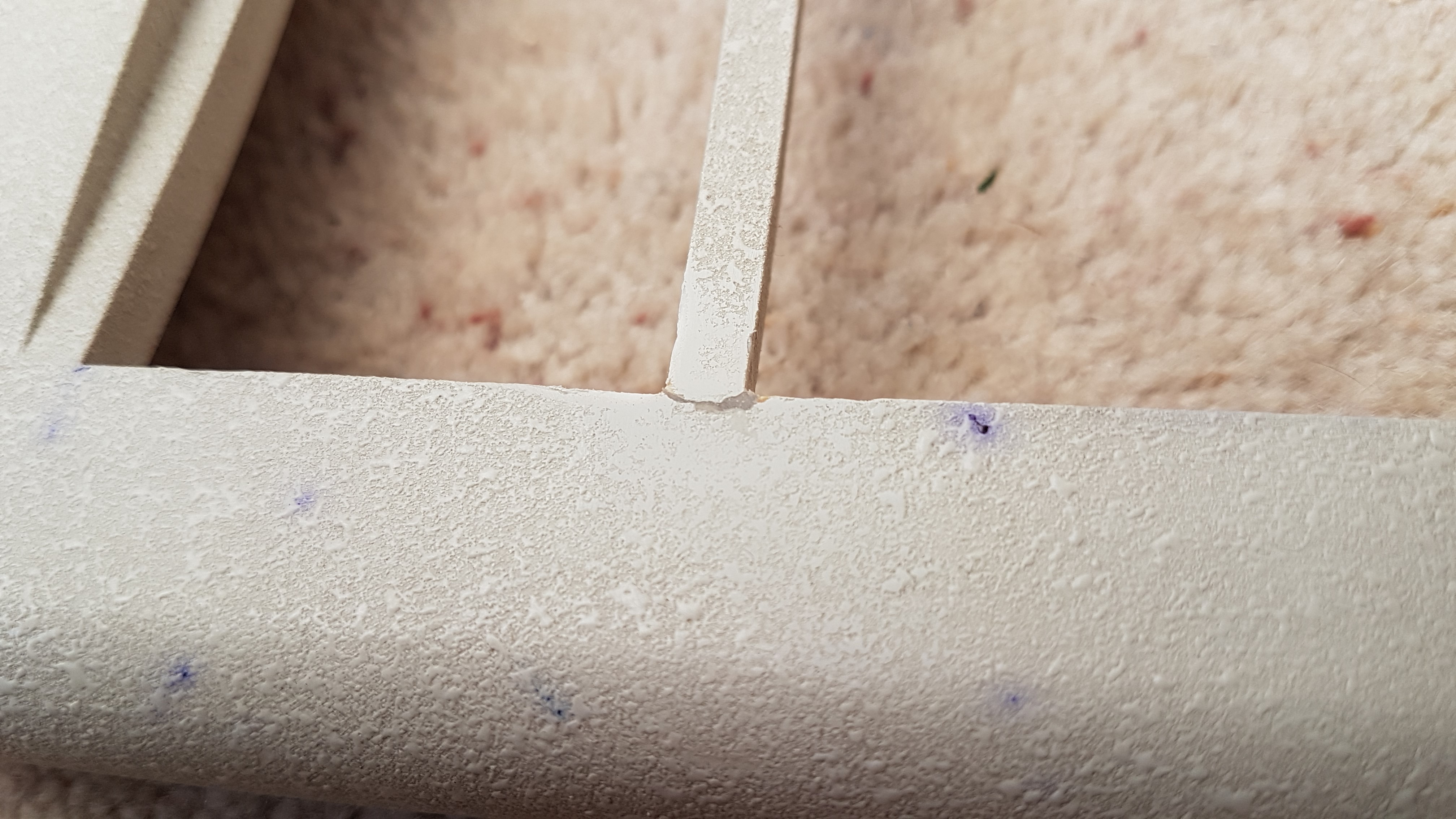

I also began removing excess epoxy from the case. It doesn't look pretty but at least it's functioning.
epoxy cured.jpg (1.39 MiB) Viewed 9675 times
As it turns out, the WD40 didn't help the springs at all. Some of them are very rusty but still function.

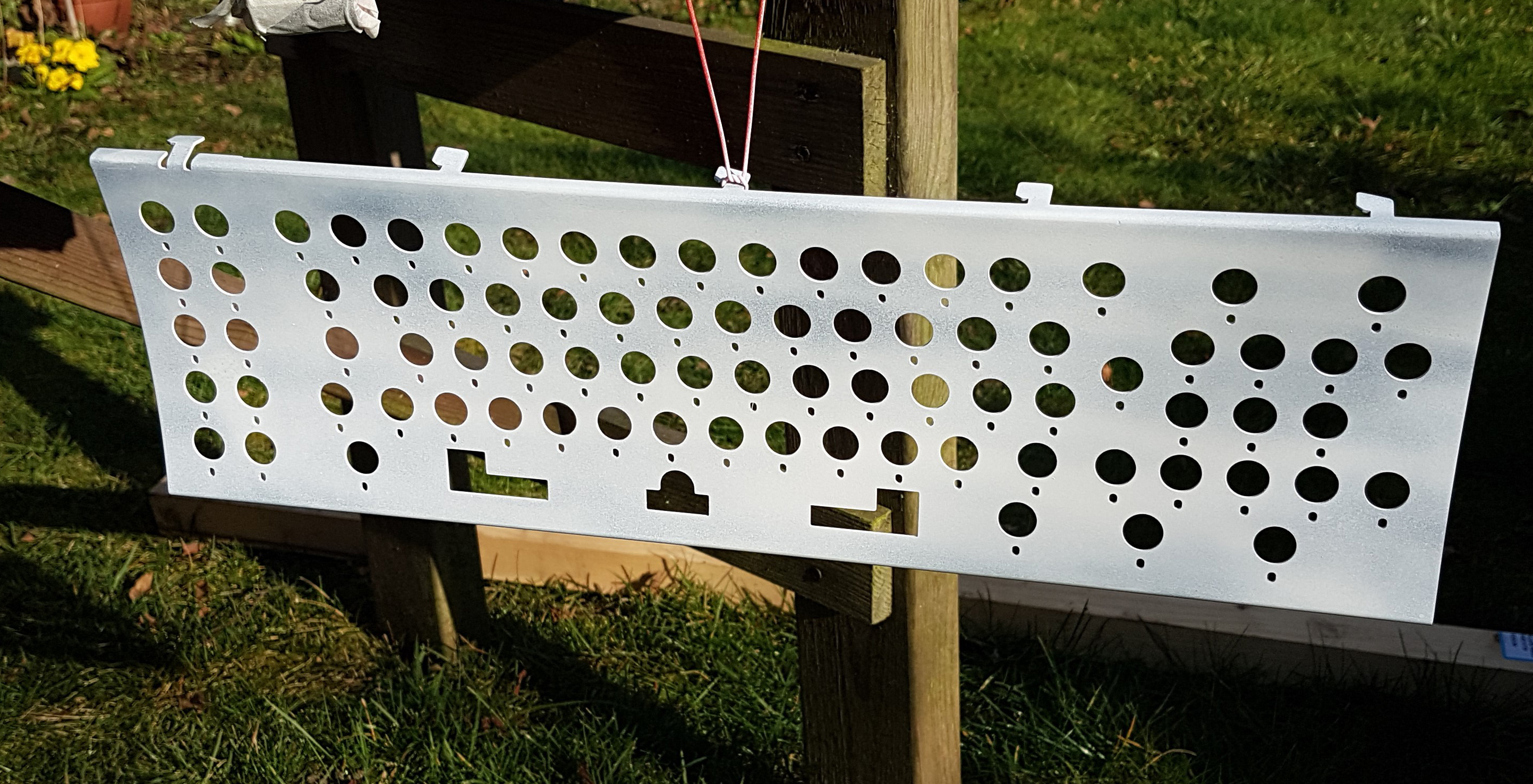

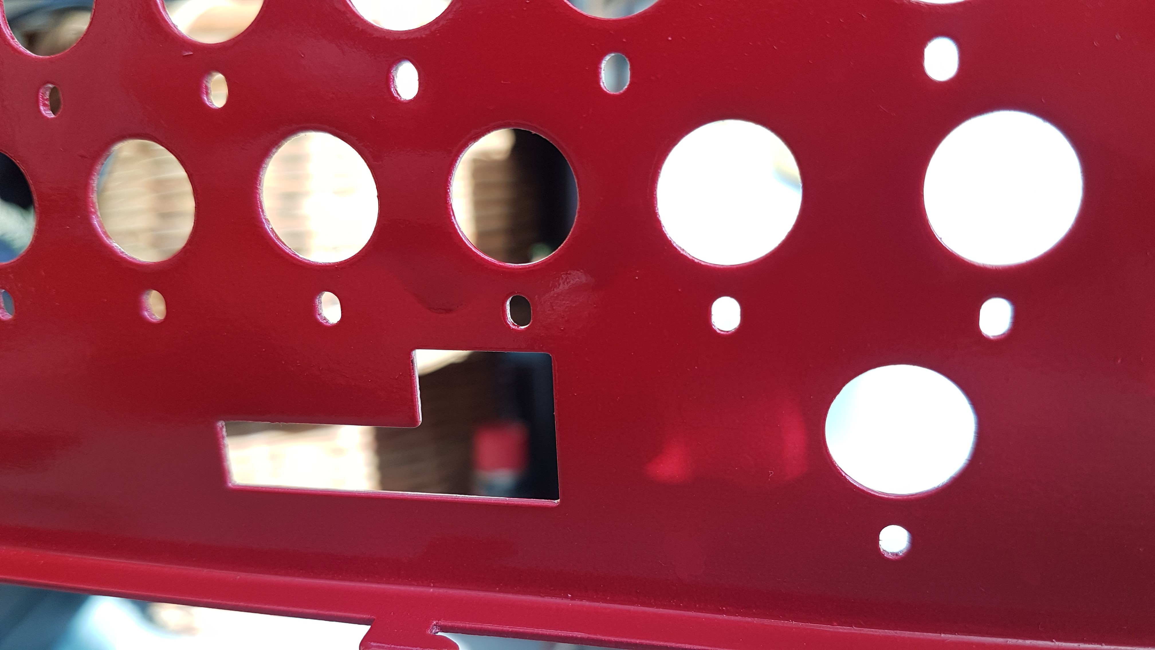

Decided it was time to begin painting the top plate so I started by sanding more of the paint off. The mouse sander I used didn't really help so I did more by hand.
sanding top plate.jpg (2.2 MiB) Viewed 9656 times
Sadly nowhere had any enamel gloss type paint so I settled for some red rust-oleum stuff. I had a little bit of crappy cheap primer left so I used that to prime the plate.
Priming plate.jpg (1.62 MiB) Viewed 9656 times
This morning, I decided to start painting it. It turned out alright but there are some drips visible which I will need to sand down once dried.
Paint dripping.jpg (1.13 MiB) Viewed 9559 times

I also face the intractable problem of the rusty springs, no helpful solution after searching whole forum.
Tried vinegar and WD40 also, still like shit.
If you have good idea finally, really really appreciate it. :D :D :D

Holy shit those are some of the worst springs I've seen! I considered trying a contact cleaner but it's very similar to WD40 so I doubt it would work. The corrosion seems really stubborn on the springs and other metals which is strange because vinegar normally works fine for me.
Re: IBM Model F XT restoration (Work in Progress; lots of images)
Posted: 23 Feb 2019, 18:23
by JP!
Shit man. This is a project here. I would say try and find a product called Evapo-Rust. I use it all the time on springs, screws, etc. It works like magic (chelation) and isn't harmful to metal like acids and you won't have an issue with flash rust after derusting. Acids tend to take good metal along with the rust. Krud Kutter or Naval Jelly (phosphoric acid) are good products as well but cost more per ounce than Evapo-Rust. Once derusted you can apply some gun oil to prevent future rust. Your other options are to find another Model F or use some springs from a Model M.

JP! wrote: 23 Feb 2019, 18:23 Shit man. This is a project here. I would say try and find a product called Evapo-Rust. I use it all the time on springs, screws, etc. It works like magic (chelation) and isn't harmful to metal like acids and you won't have an issue with flash rust after derusting. Acids tend to take good metal along with the rust. Krud Kutter or Naval Jelly (phosphoric acid) are good products as well but cost more per ounce than Evapo-Rust. Once derusted you can apply some gun oil to prevent future rust. Your other options are to find another Model F or use some springs from a Model M.
Thanks, JP!
I will try your method and reply when get any result.

So today I've spent a bit (a lot) of time in Photoshop recreating the rear sticker. It isn't perfect and since I don't own an IBM dot matrix printer, the numbers aren't spot on but I'm pretty happy with it.

John Doe wrote: 23 Feb 2019, 16:42 I also face the intractable problem of the rusty springs, no helpful solution after searching whole forum.
Try Evapo-Rust

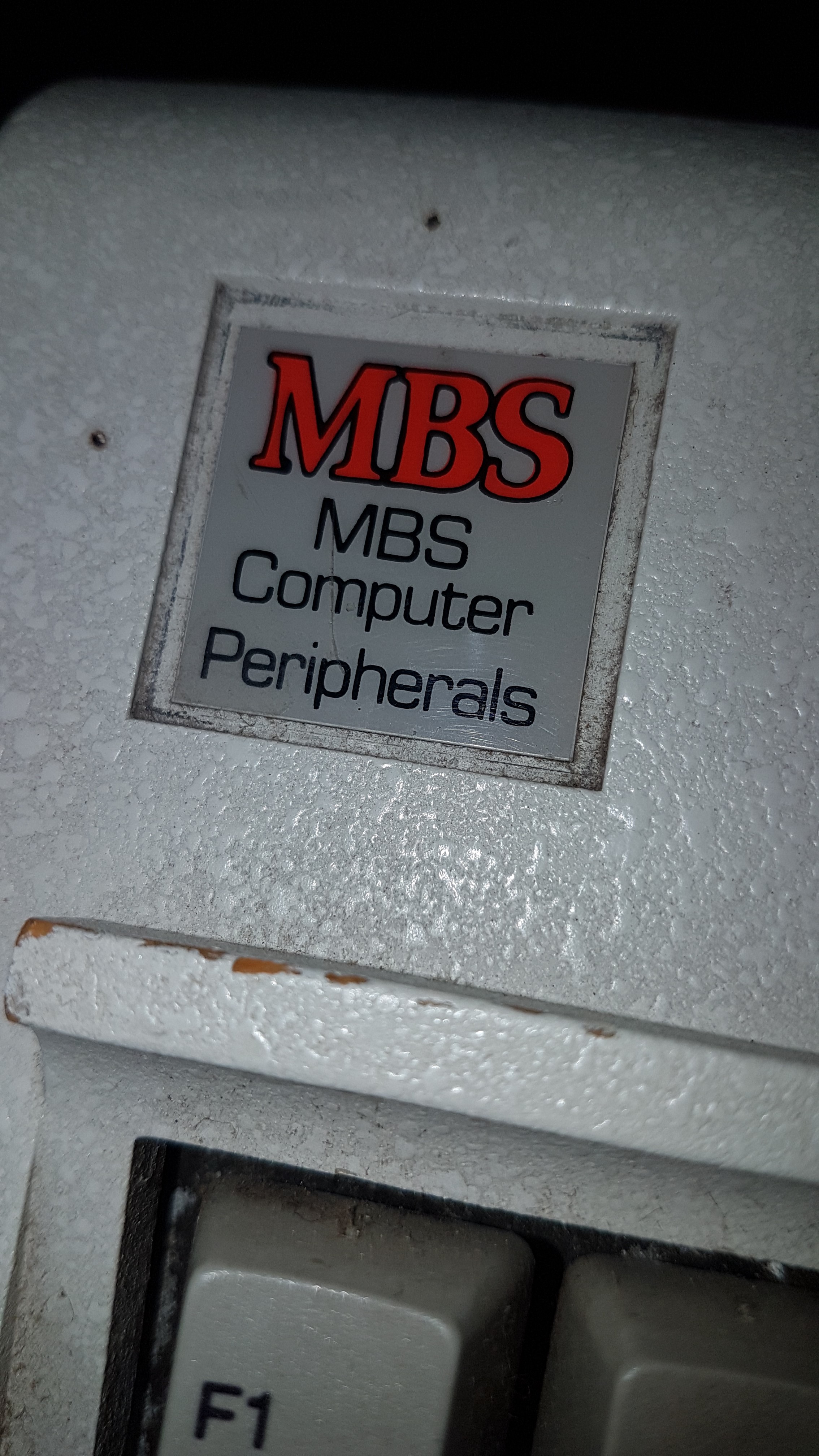

Managed to get another F XT from the same seller. Jesus. Fucking. Christ. It might be even more rustier than the first. The top of the barrel plate has thick corrosion and the back plate is bent. If he gets any more I'm definitely asking for a lower price...

Surprisingly the springs (from what I saw) are really clean and the bottom pan looks clean but the internals look like they've been submerged in the ocean since 1986...
I mean how does this even happen to a keyboard?
MBS whoever they are (presumably the company that ripped out the IBM badge to replace it with their own)

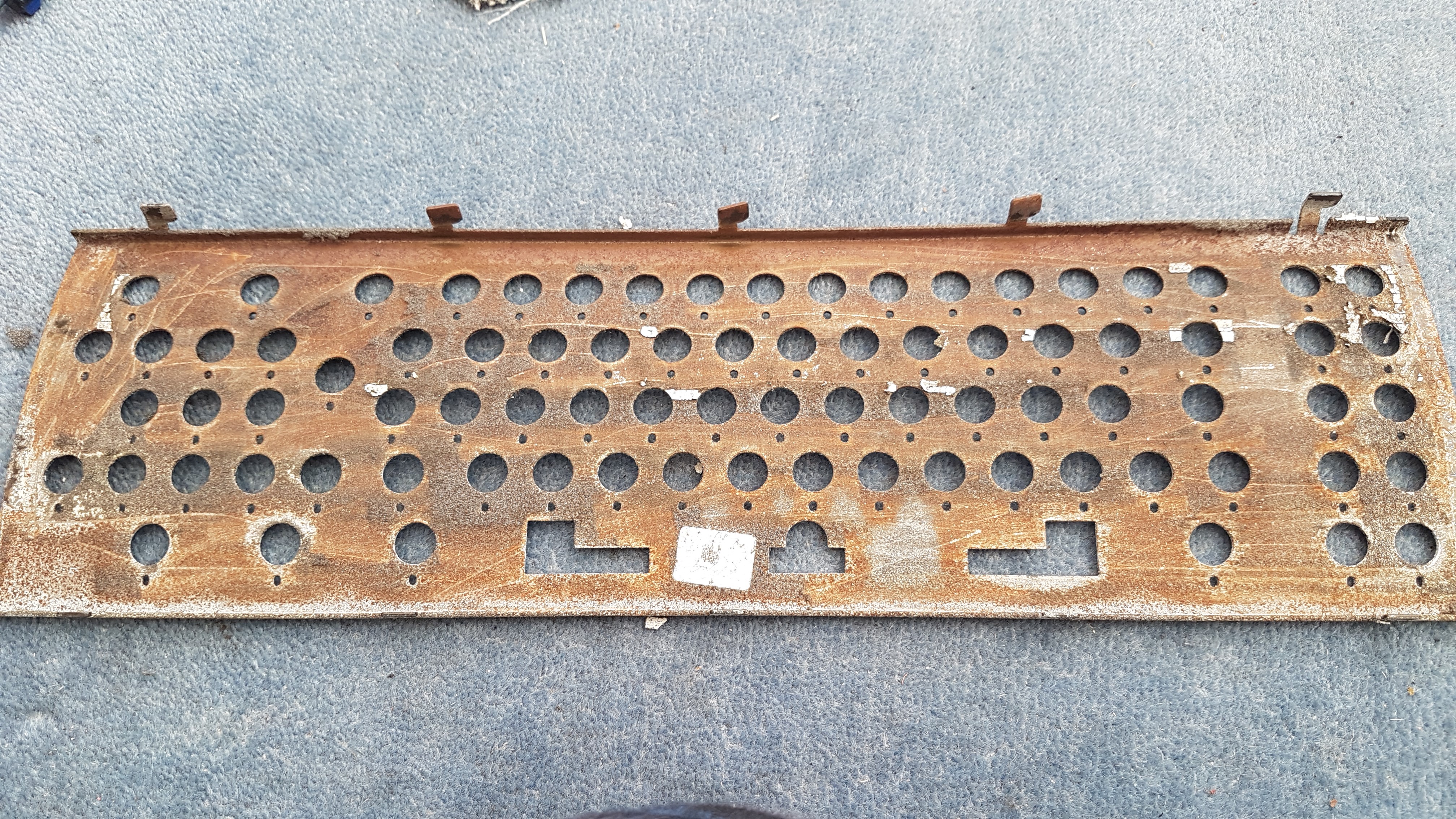

Update on keyboard 2: definitely more rusted.......
rust plate.jpg (3.29 MiB) Viewed 9362 times

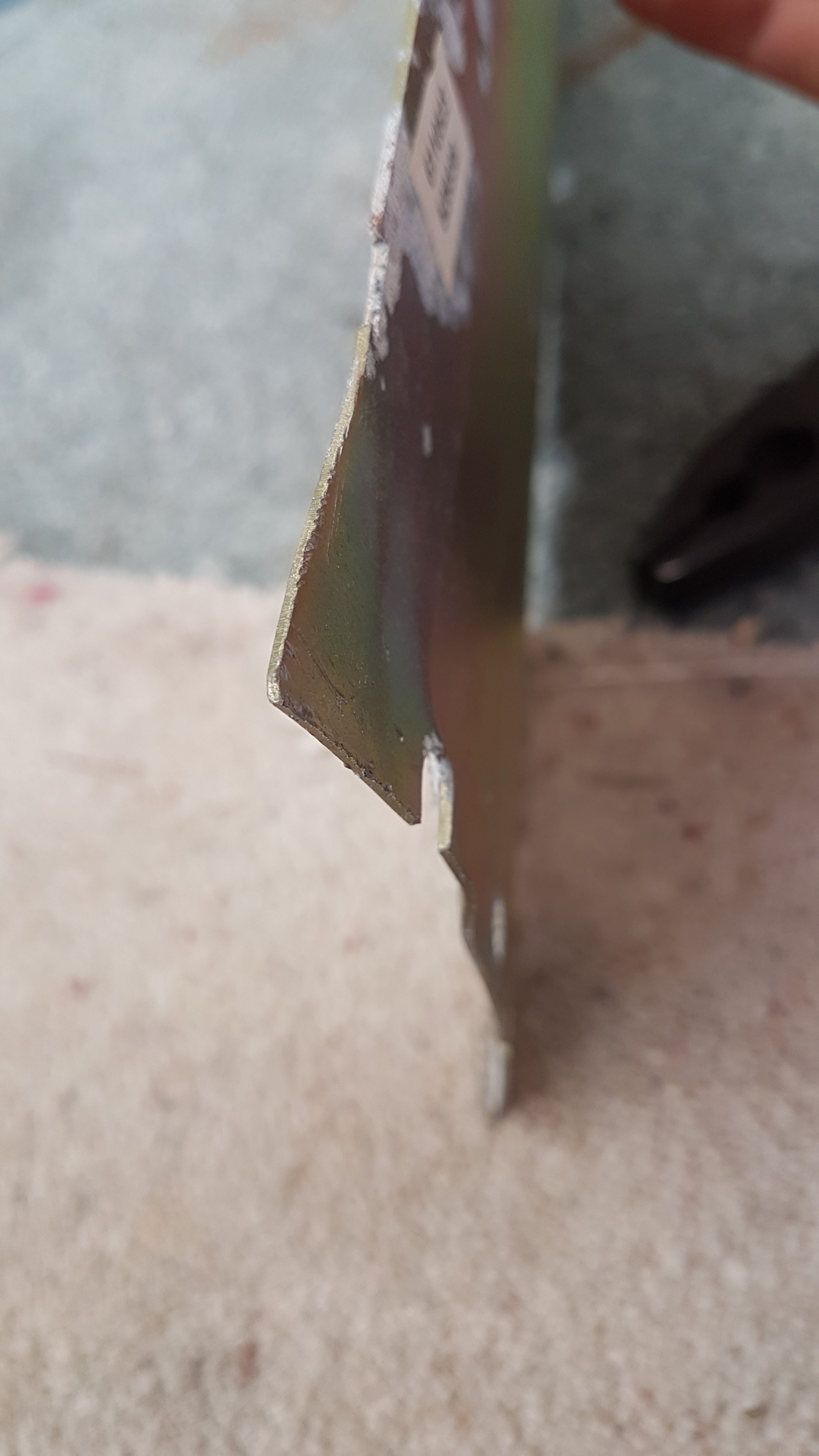

The bottom plate is also bent in the corner (if anyone knows a good fix, please let me know!)
bent plate.jpg (956.06 KiB) Viewed 9362 times

What I got after Vapor-Rust using, its really like magic, thanks guys.

John Doe wrote: 04 Mar 2019, 06:34 C0BBB33D-7AB3-4839-AA18-C9E723D21AC4.jpeg
Looking good, might try it myself at some point (when I can afford the stuff!)
Posted: 04 Mar 2019, 16:46
by John Doe
Aran.E99 wrote: 04 Mar 2019, 16:42
This is what left after the rust removed. :lol: :lol: :lol:
