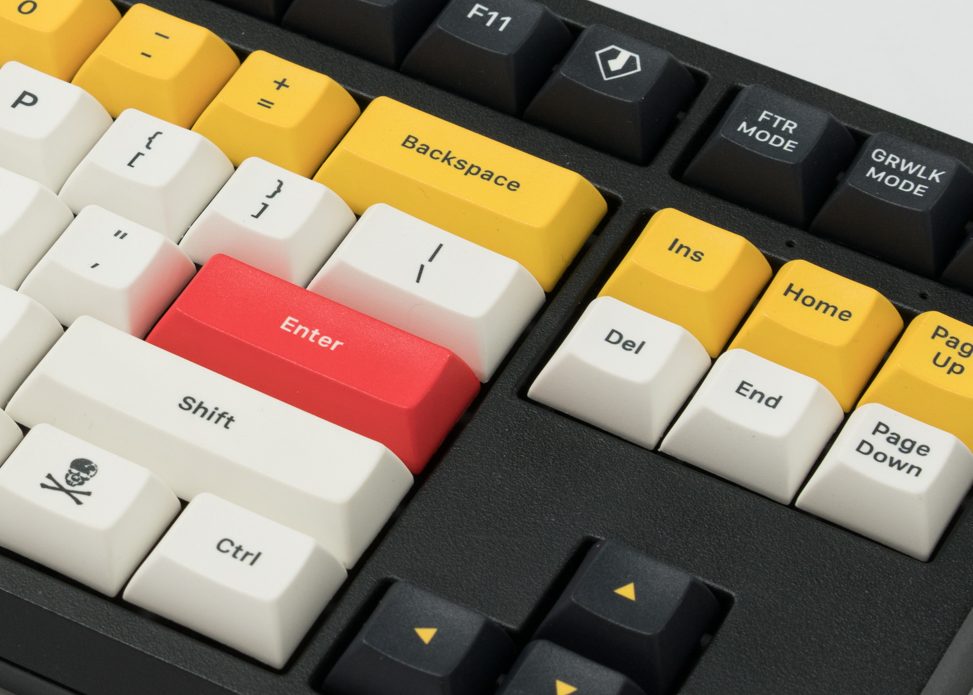

I'm experimenting with 360° dye-sub. Just got the first sample which is very promising. If you don't get it... look closer, some legends are lighter than the background.

Damn this is very cool, Matt3o. From that image the legends look very good.
Were you just testing with Skull Squadron or if this works out are you looking at a potential "Skull Squadron Inverse Dyesub Remaster"? Can't wait to see what comes from this.

yeah the first set we release should be Skull Squadron, glad you like it :)

Kuddos for you Matt. They look just impecable, with no warping at all. Congratulations. Are you planning to support an International kit?

Can you elaborate a little bit how this is done technically? Are there new machines needed or can this be done with the usual machines?
Posted: 06 Jun 2018, 21:42
by Blaise170
As far as I know inverse dye-sublimation uses essentially the same method of transfer, but instead dyes the rest of the cap instead of the legend. They've been used on keycap sets before, though it eludes me which ones at the moment.

I am very curios regarding the technicalities behind the manufacturing process of this "reverse" dye-sub process.
The keycaps I have seen until now printed with this process did not have the best results:
But, I understand if you cannot give us details due to contracts and trade secrets
Posted: 07 Jun 2018, 12:39
by matt3o
it's a known technology. 3D dye-sub. You basically wrap the whole keycap not just the top. Then it's vacuumed and heated. It's not easy to do it right just because it requires more time and attention than standard dyesub. I was reluctant when they suggested it to me, but I saw the result and I'm impressed!
