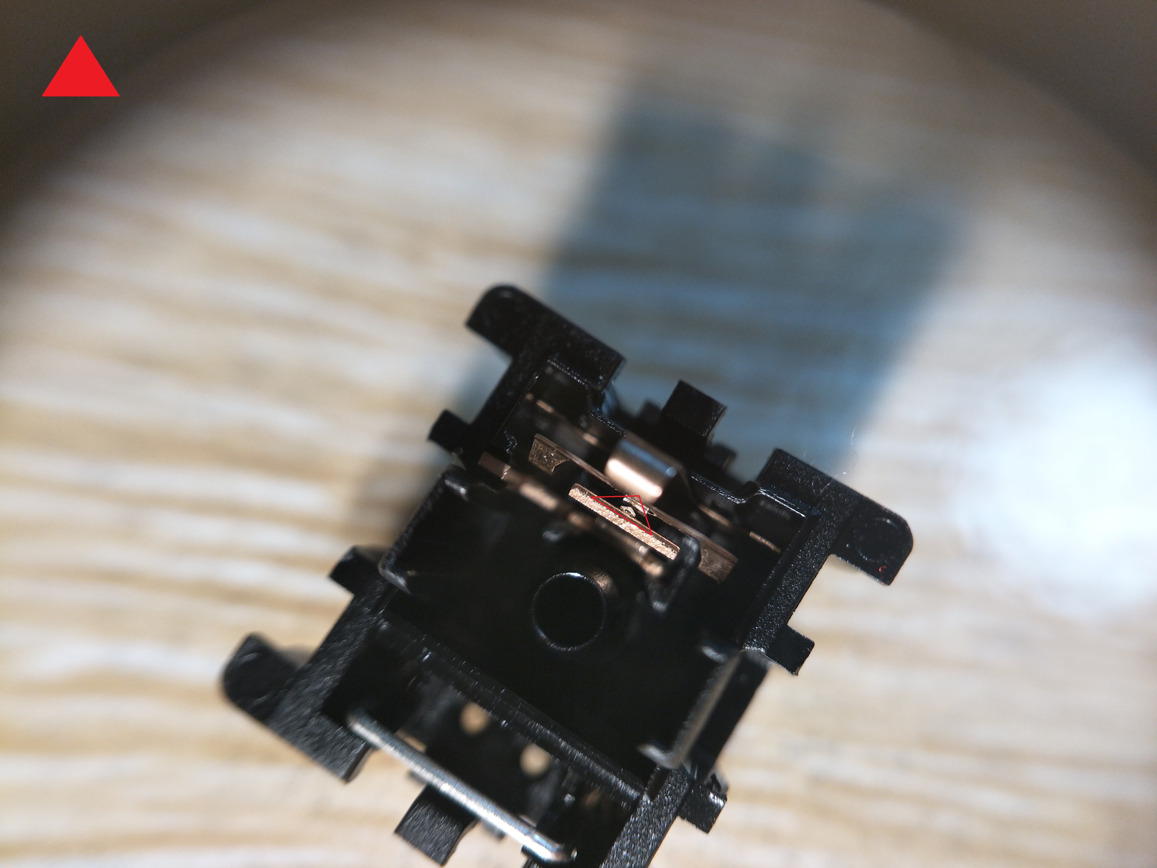

Are you certain that your M84 switches are really M84? M81, M82 and M84 refer to the material used in the crosspoint prisms, and I'm not aware that there is any known way to visually differentiate them. We can say "M8 Green" but not "M84 Green" at the moment.

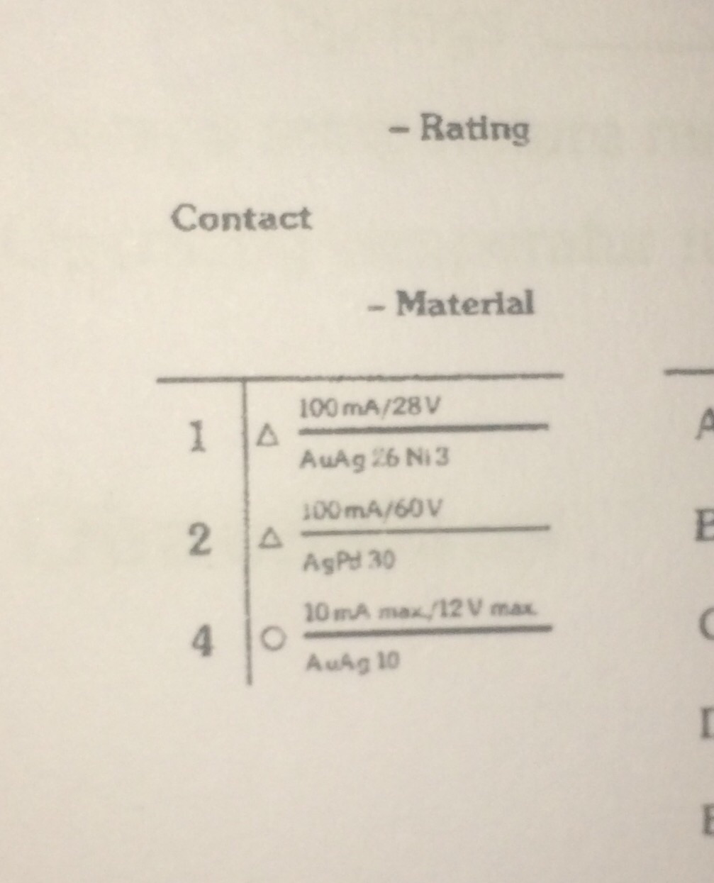

Yes. I'm sure it's M84. Because that file "Keymodule M8" had record how to differentiate "M84" and "M81,2" .their crosspoint shape is different.Daniel Beardsmore wrote: That's a lot of Cherry switches!

So that is what you're taking the triangles and the circle to mean?

That's really interesting, because I have M84 switches (M84-0100, from Cherry), and the contacts are circular cross section exactly as you're suggesting! Also shown on the wiki is an M8 switch with clearly triangular section contacts.
So maybe we can't tell M81 and M82 apart, but we can recognise M84.
I need to check my other M8 switches to see what those are.

For me, the 4th letter (M8X?-XXXX)is hard to know.Daniel Beardsmore wrote: That's really interesting, because I have M84 switches (M84-0100, from Cherry), and the contacts are circular cross section exactly as you're suggesting! Also shown on the wiki is an M8 switch with clearly triangular section contacts.

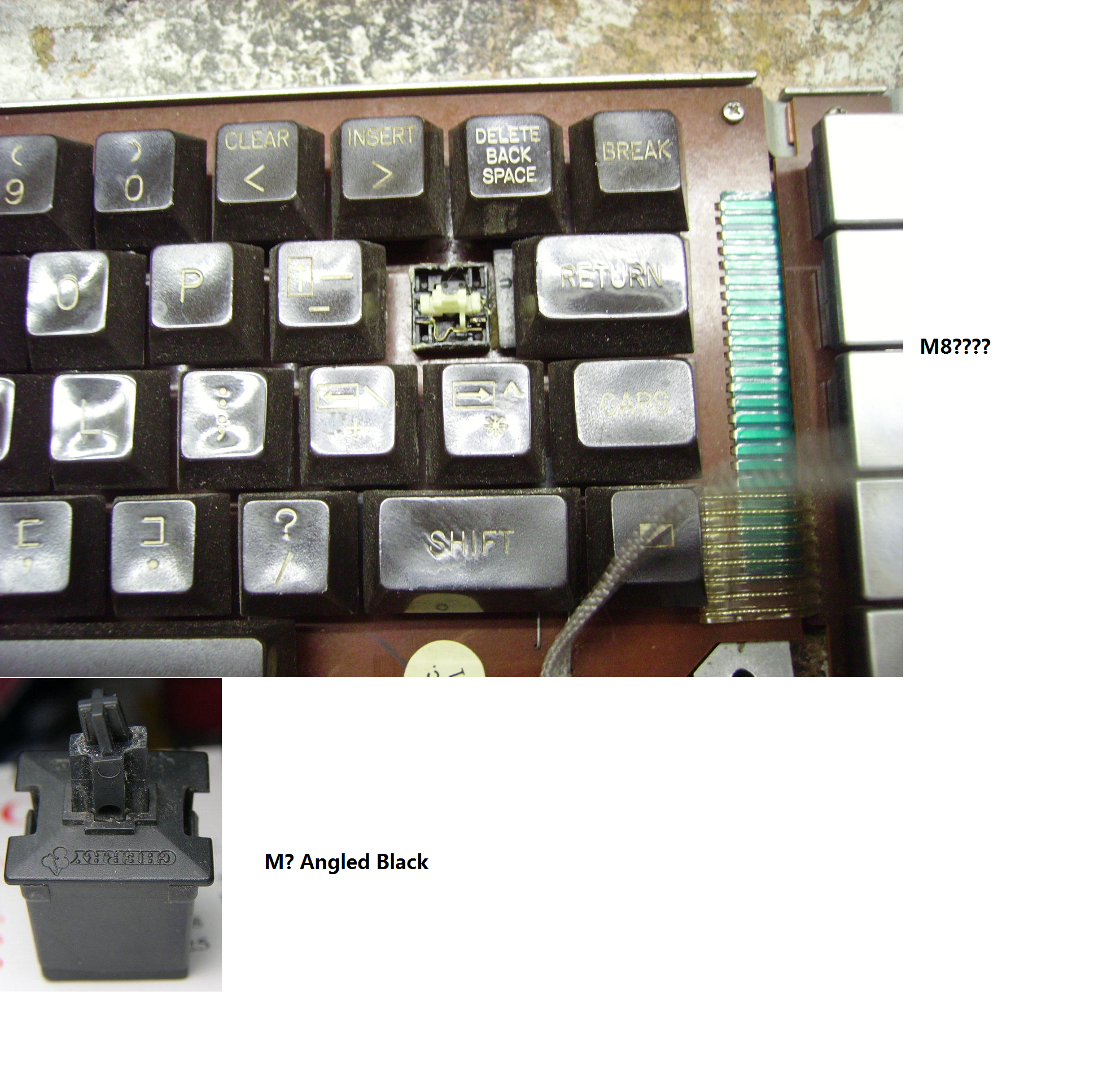

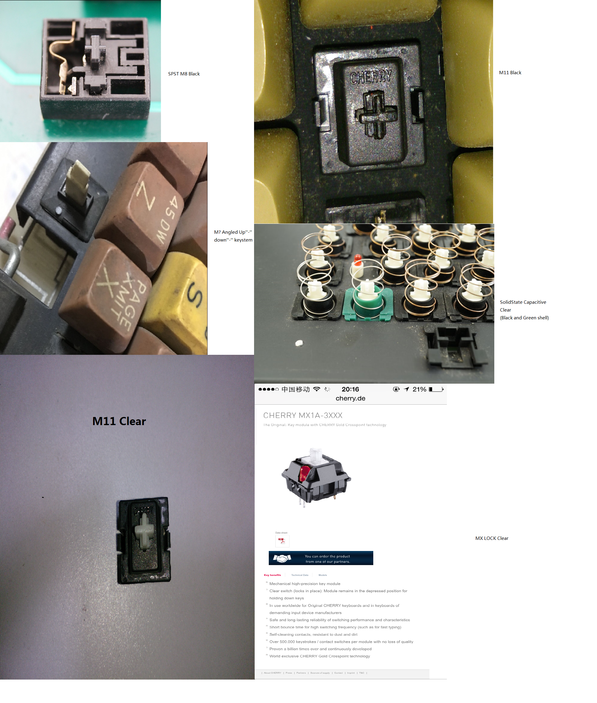

By the way. There is a "support MX" that I don't have. And I heard there is a "Heavy Clear" in G80-9009 and "Soft Black" in G80- 1890 HAURF. Really?

What is a "support MX"?

I guess he is talking about a springless MX Black switch that is used as an additional stabilizer for Cherry G80 OEM boards with Big-Ass-Enter keys

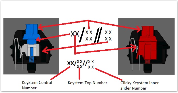

I think (M4/5/6/7)'s keystem is an important info. That's the reason of I record up"-","T","+" down "-","T","+". But I did not find its rules.
