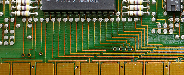

The case and caps cleaned out nicely. The finish on the metal case is extremely durable. Here are some pcb shots:
Is there any hope of adapting this board with a replacement controller?

kuato wrote: Is there any hope of adapting this board with a replacement controller?
I've asked about this too, since I have a 3277 as well. I don't think there is any easy way to do it, since the controller is integrated into the pad card.
Designing a brand-new xwhatsit/CommonSense-compatible PCB would probably be the most straightforward solution.

by andrewjoy
Love that oldschool solder mask, looks way nicer than modern stuff , and you can even see the traces .
As long as the capacitive matrix is the same( it should be ) There is no reason you cannot use this PCB.
It looks as if many of the connection to the cols are here
If you trace it out you can simple connect jumper wires between the connections on the PCB and a xwhatsit controller.
You would have to de solder most of the chips and passives so they dont interfere

by daedalus
As far as I can tell, the 3277s were the first design of beam spring keyboard. As bizarre as it sounds, that PCB is beautiful!

The tag on the connector says 'JUN 1 1979'. I really rather not hack into the PCB.. hoping we can get enough interest to create a replacement to use with a modern controller.

Honestly, PCB replacement is probably the quickest (and safest) route to ground.
I have a "test" beamspring PCB due back to be in a week or so. If it works as expected I could conceivably put one together for this layout too.
