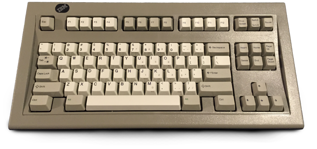

Hi guys,
is it possible to modify a standard Model M keyboard to use a shorter space bar, and put the Alt keys closer to the middle? The new Alt keys would be now under X/C and M/, in the attached image.
I would appreciate any ideas! Thanks!
IBM Model M Space Saving Keyboard
y11971alex
03 Feb 2017, 17:25
That's not feasible short of making new circuitry to accommodate the new keys under those positions.
cheater
03 Feb 2017, 19:01
That's the point of it - I know I would need to add circuitry - the question is what is involved and whether I would be able to do it at home.
codemonkeymike
03 Feb 2017, 19:27
You could make a small PCB for some cherry switches that goes were your spacebar is. Then you can PCB mount your Cherry greens or whatever to the PCB and route a teensie to it. It's a hefty task unless you have designed PCBs before.

cheater wrote: Hi guys,
There are Japanese Model Ms (the standard 101s in the slimmer chassis and trackpoint that Unicomp later used for their "space savers"). You'd have to buy one of those and franken the guts into a US one. Or just use it as-is. But they're kind of pesky to find since I imagine many Japanese are fond of them ;)
