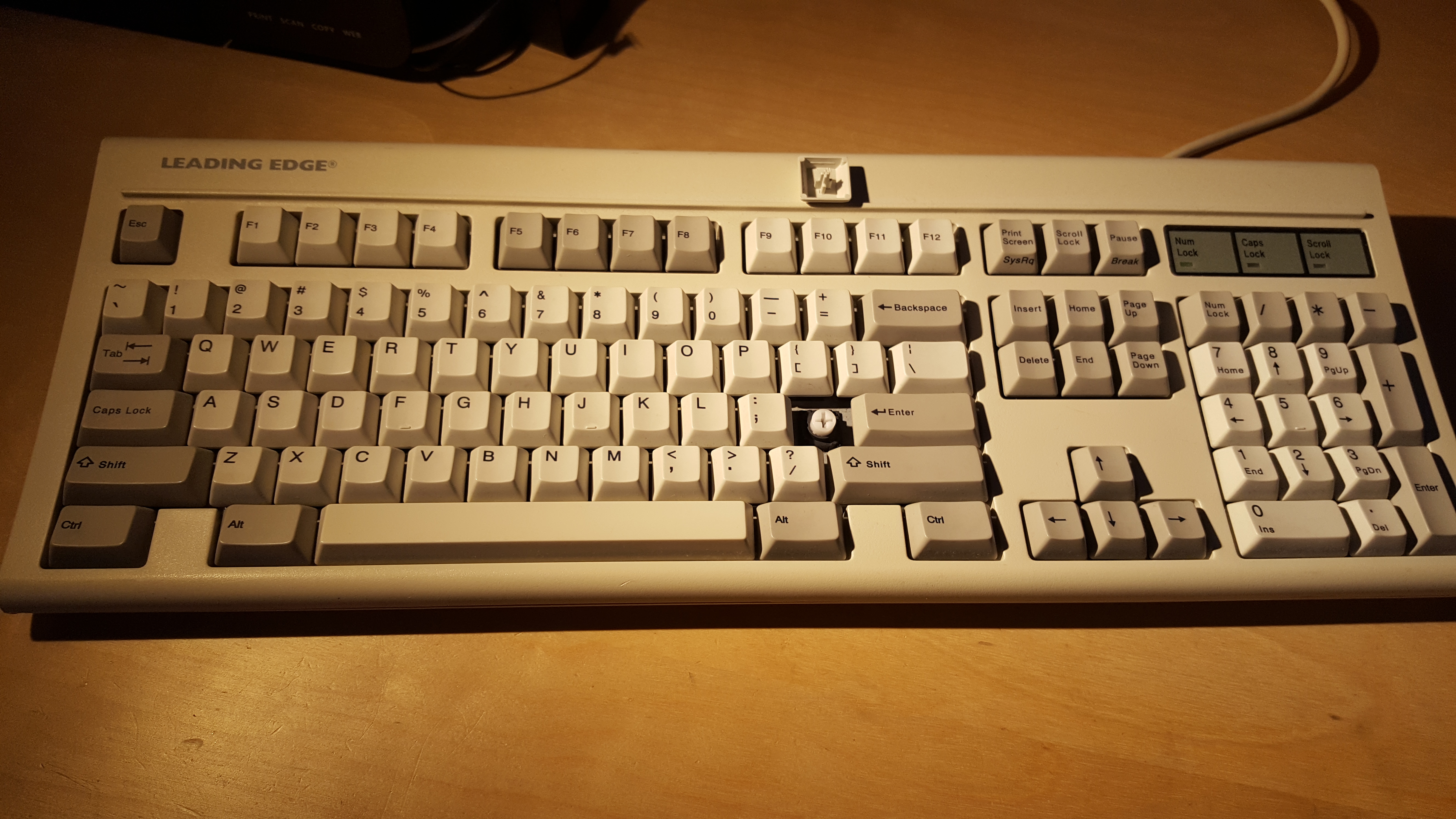

Well, when there is a consensus it tends to be negative. Cherry MY for example. Keyfeel is always subjective but there are some aspects of a switch no-one could like (e.g. rough travel or excessive binding)
Leading Edge SKM-1030
2016-11-03 10.15.53.jpg (3.84 MiB) Viewed 11950 times

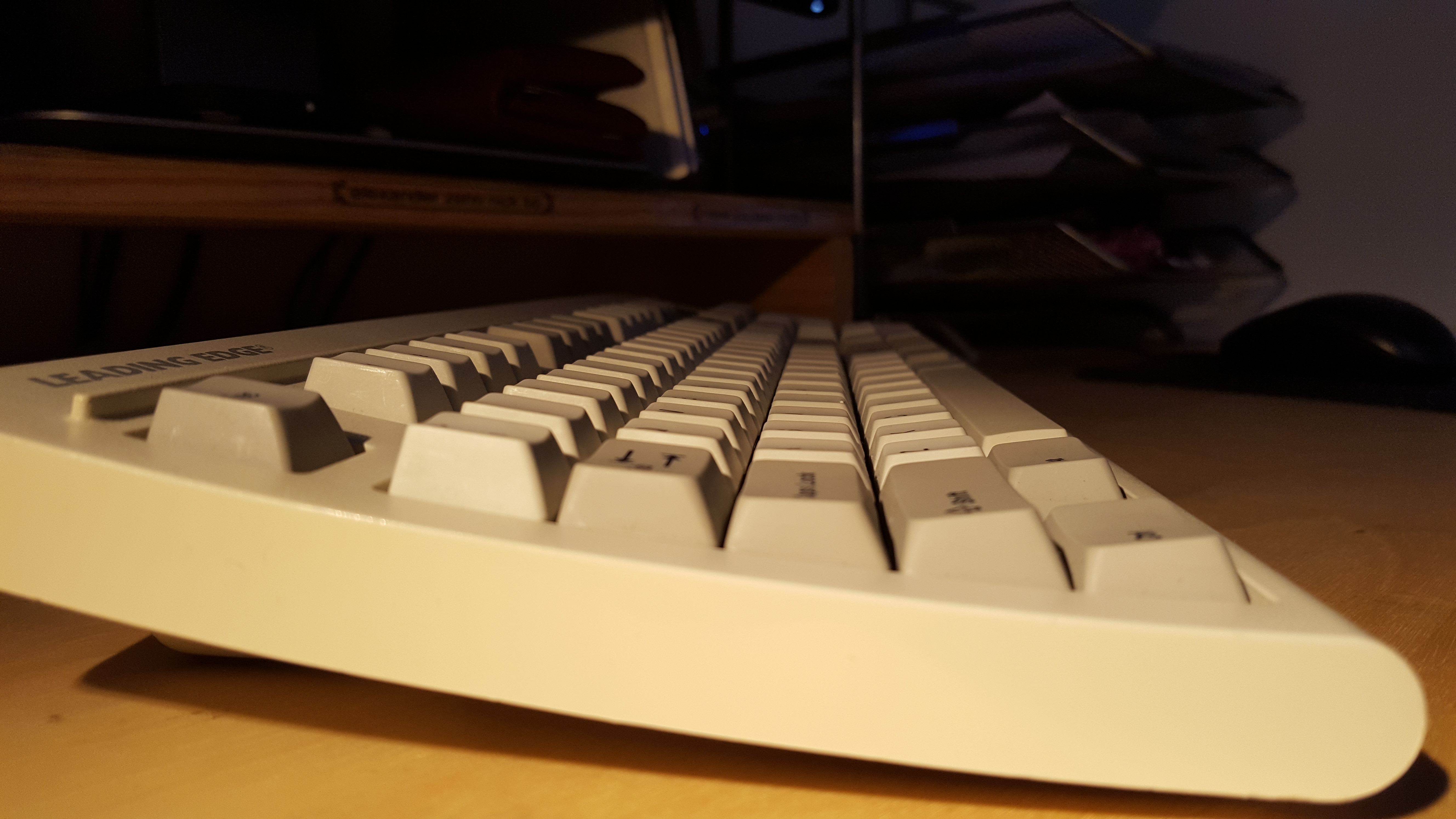

I'm using this board at the moment, a Leading Edge (Sejin) SKM-1030, with inverse cross mount keycaps.

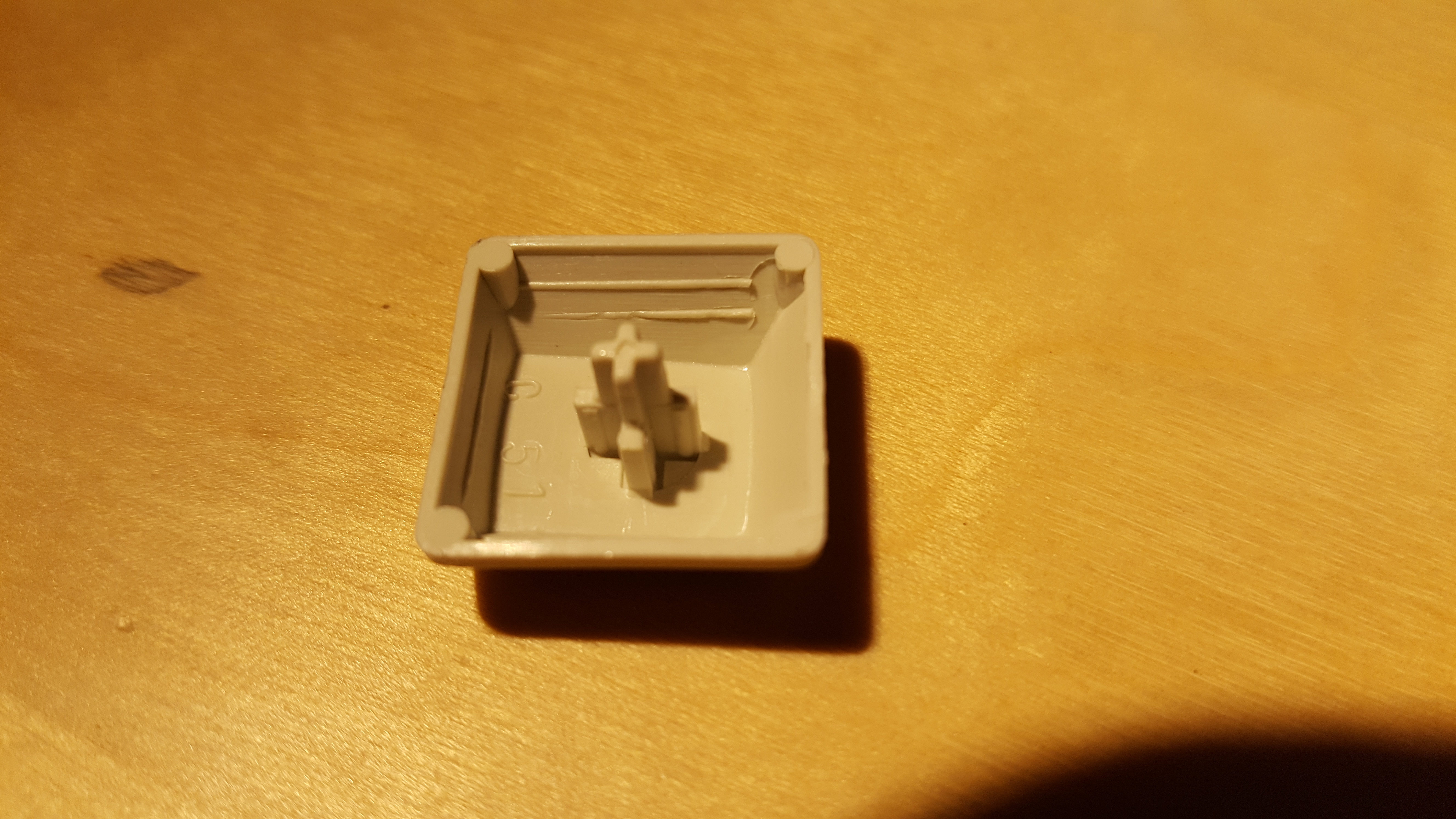

Keycap
Keycap
2016-11-03 10.16.31.jpg (3.8 MiB) Viewed 11950 times
The keycaps are unusual - the tops are non-textured, and quite slippery by default. I'm unsure of the material - they are not ABS as they don't yellow, so perhaps PBT. They are neither pad printed nor doubleshot.
Profile
Profile
2016-11-03 10.17.17.jpg (3.26 MiB) Viewed 11950 times
The profile is also unusual - the case is curved, but the bottom row of keys sits very low relative to the rest.

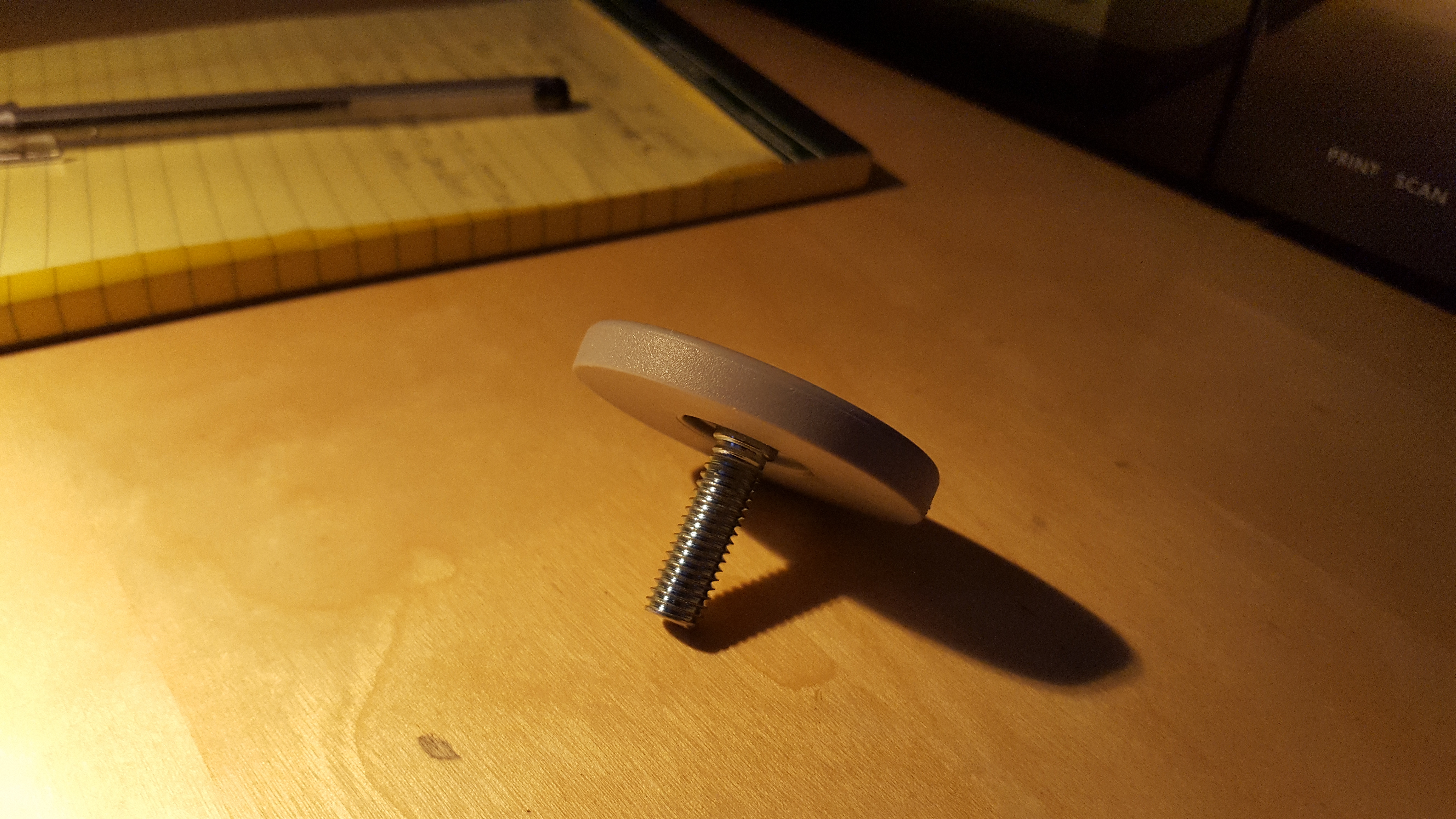

I think at manufacture the switches were designed to have high tactility. I've managed to restore the tactility on the weak switches on my board by removing a keycap then pushing down very hard on the slider with a narrow implement, and holding for about 10 seconds. I used something like this:
Implement
Implement
2016-11-03 13.17.58.jpg (4.59 MiB) Viewed 11920 times
The switches use a flat spring which inverts to actuate, and I think this procedure works to restore the spring to its original shape. As the switches are sealed I haven't confirmed this, but it works and after its done the switches are far more clicky and tactile.
That might be a modification, but do we have any indication that these switches were like that out of the factory? I mean I've never heard anyone say Futabas are highly tactile Oo .
There's no way to be sure, but when I received this board, many of the switches were completely fine - very tactile / clicky. I also have a NIB Sejin EAT-1010, but around 80% of those switches have very weak tactility, and only a few have a nice click.
It's likely that Futaba cheaped out on manufacturing in later years, so perhaps newer versions of the switches degraded more quickly.
Even with this procedure, some of the original (unmodified) switches are clickier than the 'fixed' ones. I might sacrifice a few switches on a broken board to find out what's going on inside.

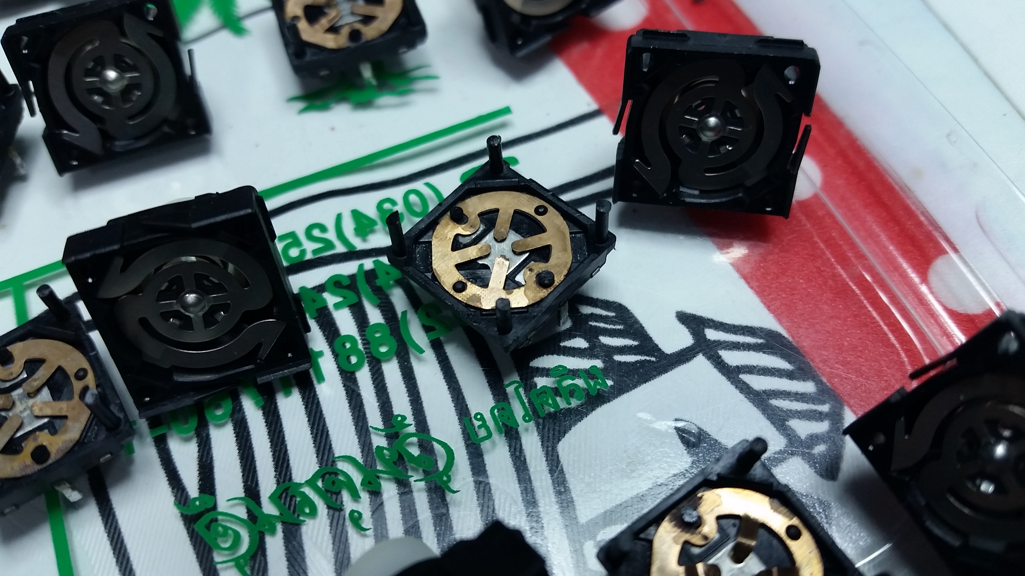

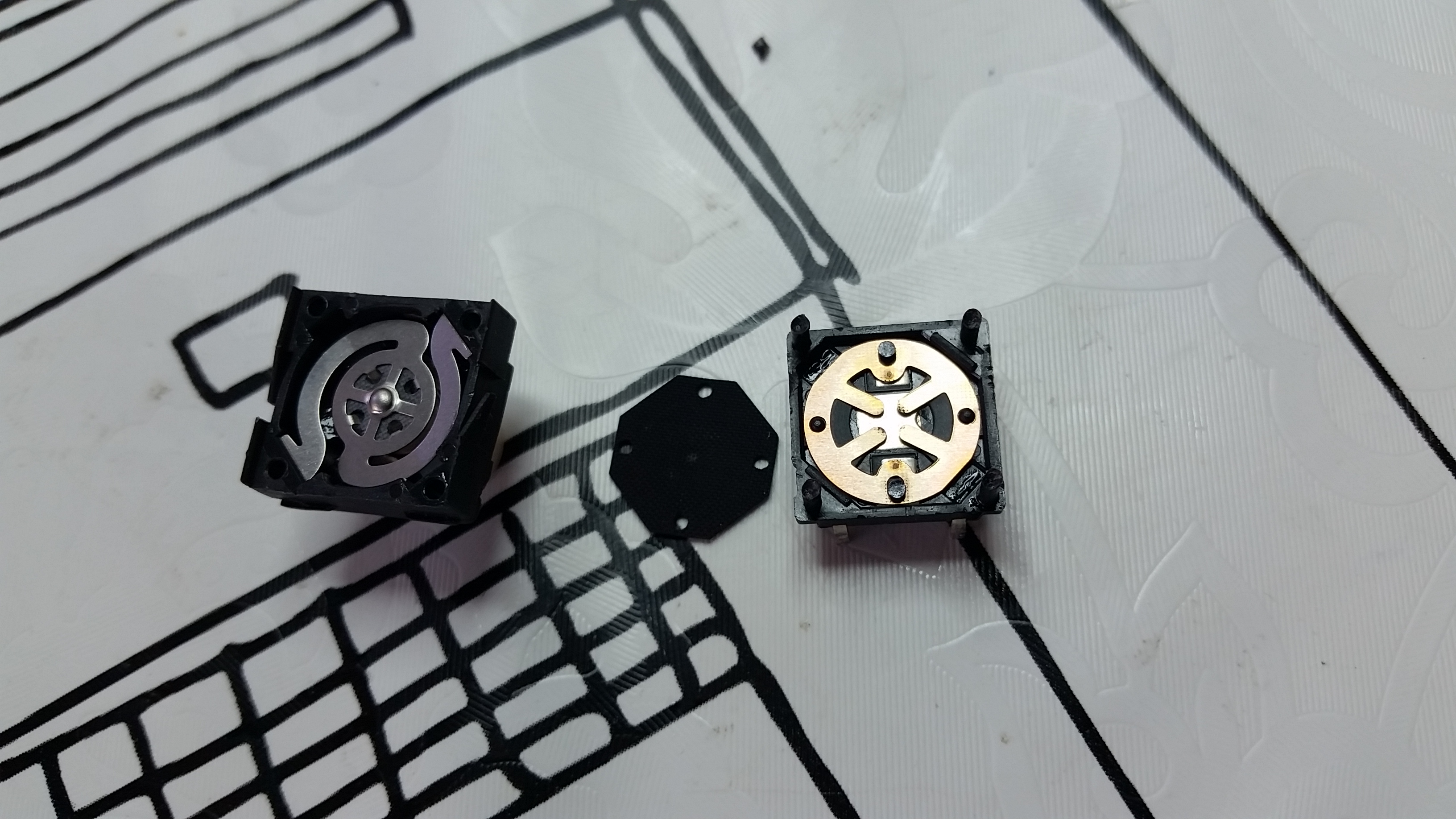

Futaba clicky switch is one of my favourite. So, I'd like to share some thoughts and findings here.
There is a rubber mat on top of 4 contact points at the bottom of the switch. The main reason why the switch does not click is because when it is old, the rubber sheet warped upward and prevented the plate spring to reach its full travel. Therefore, it cannot snap, cannot click.
Due to the above problem, many mistakenly believe that there is a linear version of the Futaba switch. I do not think so.
My methods of returning the clickiness is to cut open the switch, flatten the rubber mat (with clothes iron), bend the plate spring a little bit, assemble them back and tape the top and bottom shell with high strength fiber tape. I have met with some success. It clicks very nicely both downward and upward strokes, and highly tactile too.

That's interesting - is it possible pressing the slider down very hard also flattens the rubber mat? I'm sure these switches were very tactile when new and it's a shame most people haven't experienced the switch properly.
Posted: 16 Nov 2016, 13:43
by khirin
balotz wrote: That's interesting - is it possible pressing the slider down very hard also flattens the rubber mat? I'm sure these switches were very tactile when new and it's a shame most people haven't experienced the switch properly.
I guess so, but it depends on how old and badly shape the rubber mat is. Your method is simple and worths a try. I did not think of it first back then. Anyway, I'm surprised how nice the restored Futaba clickiness is. We can also control how loud or quiet of the clickiness by bending the two legs of the plate springs. The flatter the legs (less angles) = louder, but the switch may get stuck down. On the other hand, the more bent (a bit more angles) = quieter and the plate spring will have enough force to pull itself upward.
Here are a few pictures that might be useful.
From left to right, the plate spring, rubber mat and contact plate.
The close-up of the contact plate, with 4 contact points.
The fiber tape here is to secure the switch housing. I use this instead of super glue.

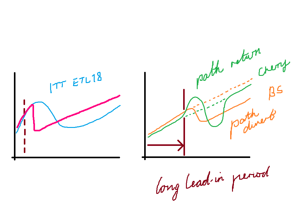

by Daniel Beardsmore
Matias are keen to let people know that Cherry tactile switches are basically a linear switch with a bump. Something I may look into more once I go through Jacob's graphs:
The ITT ETL18 curve is a complete uneducated guess (requires more than just a pinch of salt) and the rest of the lines are all wrong too — they're just very vague examples!
Force curve concepts.png (28.31 KiB) Viewed 11433 times
Futaba MA is a very smooth switch indeed, and it's one that does strike me as feeling linear at the same time as tactile. Seeing the graph would be interesting.
The graphs above aren't remotely correct, but they just serve as a very faint suggestion of what I was thinking.
Another way to look at it is analogous to an ADSR envelope.
There must be certain fundamental characteristics of a force curve that can be used to classify a switch. Maybe LRFBO:
L: lead-in phase, which can be linear (for a linear switch or Cherry MX) or null (Alps SKCMAT)
R: rise phase: null (for any linear switch), and long or short and round or straight depending on the switch
F: fall phase: null (for any linear switch), null for anything with a vertical drop, or curved
B: rebound: null (for "path divert") or linear, or present for "path return"
O: overtravel: the last part after the rise+dip; linear for a linear switch
Cherry MX red is only LO. Alps SKCMAT is a very strange one: RFO (curve rise, curve fall, linear overtravel). I need to double-check where actuation occurs in SKCMAT as the F–O boundary doesn't occur where you think it should be.
So maybe: MX red = L(l)O(l), SKCMAT = R(c)F(c)O(l)
Just trying to spread some more brain cancer to the forum.

Chyros wrote: Futaba clickies are a rather polarising switch; some really love them and others don't really like them, but I'm getting the impression no-one really seems to think it's "just a switch", interestingly enough. One thing everyone seems to be in agreement about is that they're super smooth, though.
The switches which have lost their click feel pretty bad - almost linear, but like pressing on a sponge. It bears comparison to judging an ALPS switch based on a dirty rather than clean example
Having restored the futabas on my board, I'm certain they were originally designed to be very clicky.
