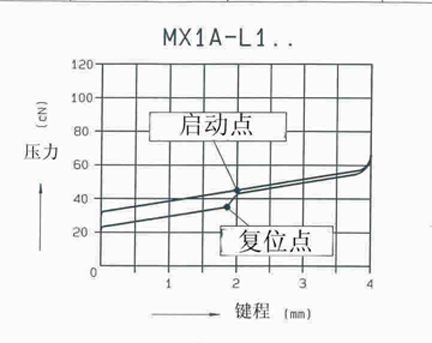

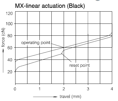

In case you're ESL here's a graph.
cherry black force diagram.jpg (56.13 KiB) Viewed 3618 times
In case you're Asian ESL here's a graph.
Cherry Red Force Diagram.jpg (63.71 KiB) Viewed 3618 times
I thought all Germans took Physics?
