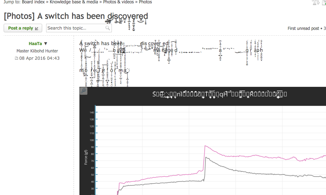

Screen Shot 2016-04-08 at 10.53.44.png (151.36 KiB) Viewed 9436 times
Same, its a bit broken

Posted: 18 Apr 2016, 12:00
by jacobolus
So from the force curve: you can press easily to about 2mm down whereupon you hit a solid barrier, but if you press hard enough something flips and you can keep pressing further for another 2.5 mm.
Doesn’t really seem like the best tactile response if the goal is to make typing easy.

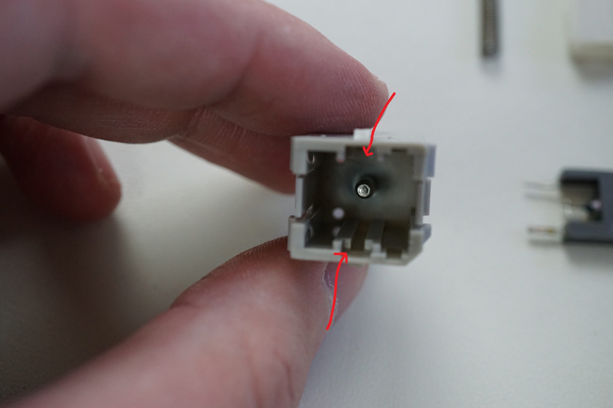

Posted: 18 Apr 2016, 21:23
by chzel
So, here's my take:
You press the slider, and the spring compresses until the horizontal metal peg reaches the "pockets" here:
peg stops.jpg (210.22 KiB) Viewed 8915 times
As you press further, you work against the magnetic attraction between said peg and the black magnet until you overpower it, which allows the slider to continue downwards activating the reed switch. The vertical peg is just a guide for the spring.

by chzel
The flaw with my explanation is that the force curve is not that of a spring....
