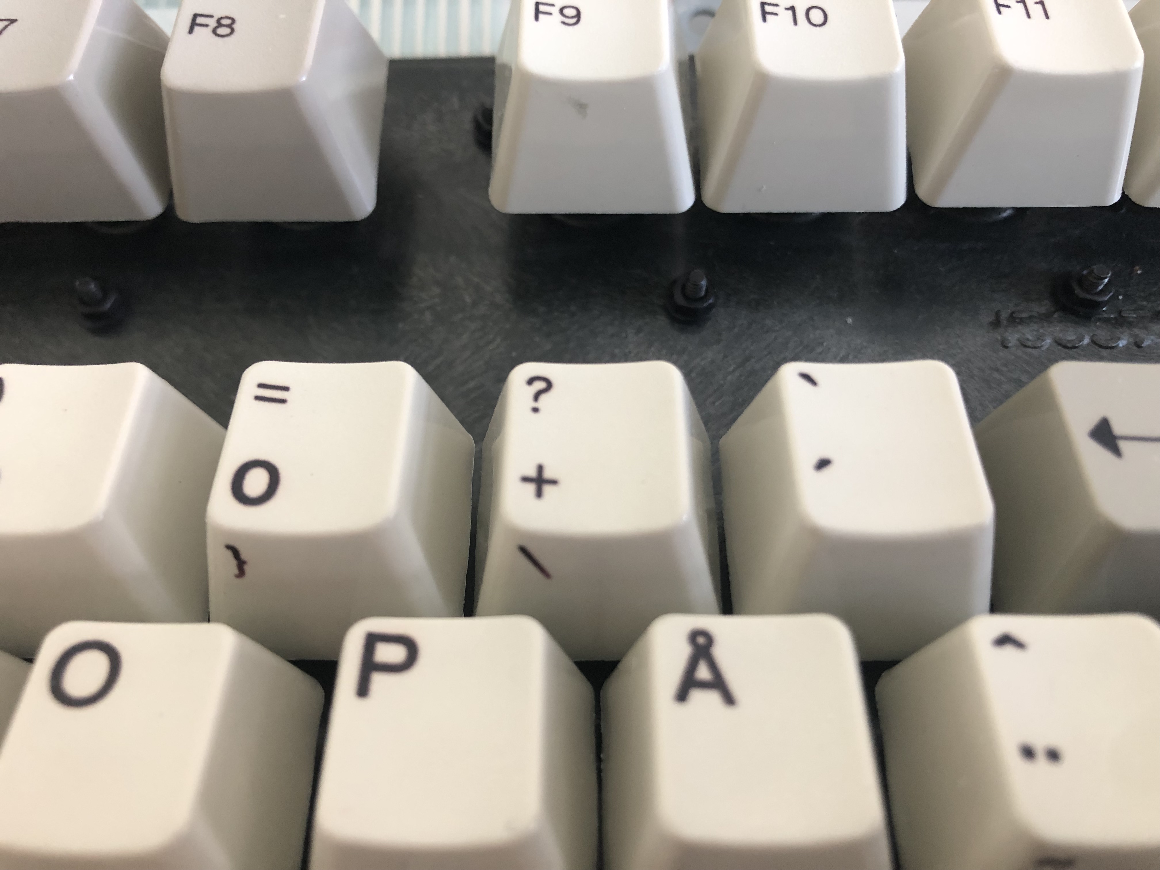

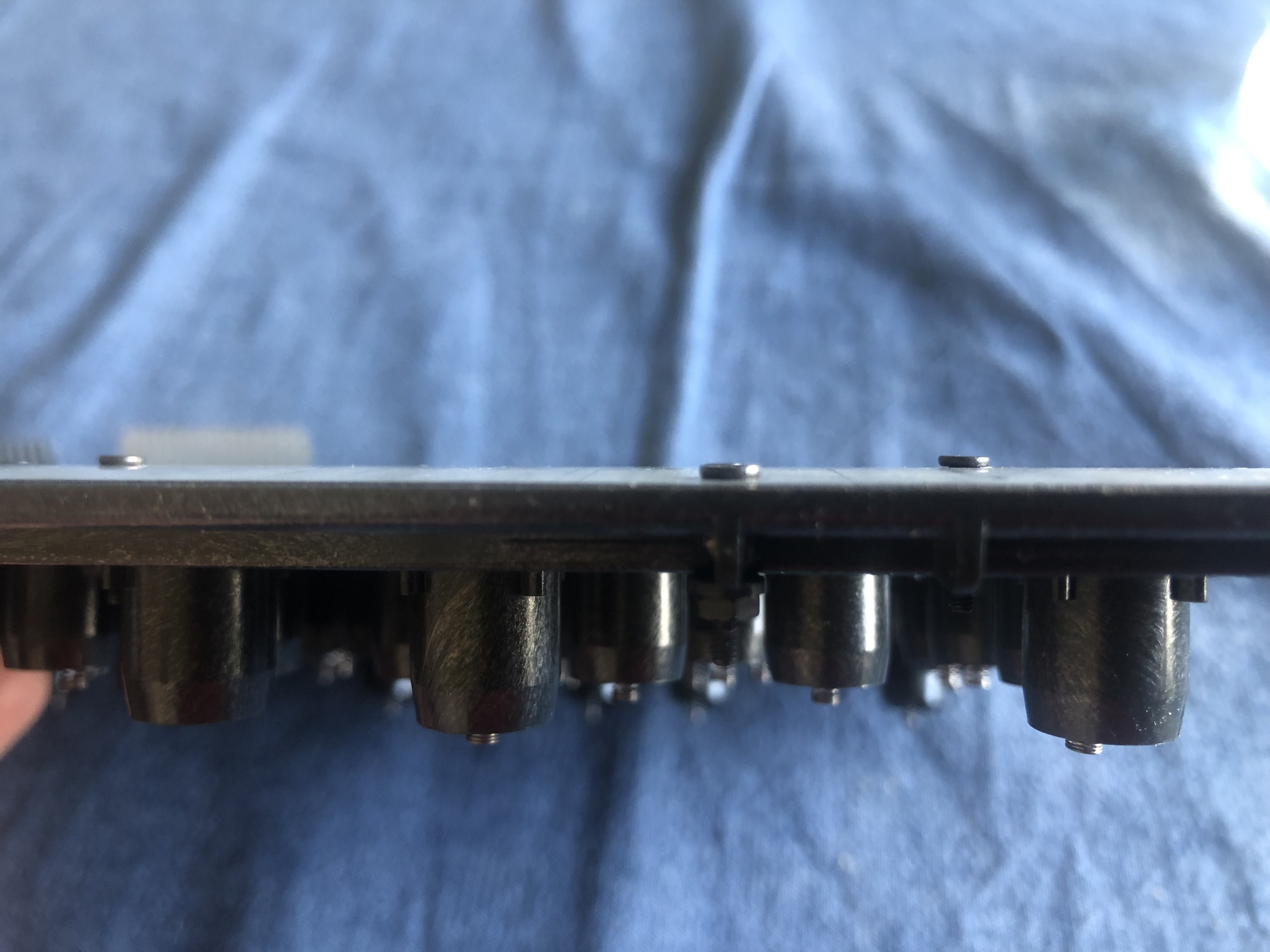

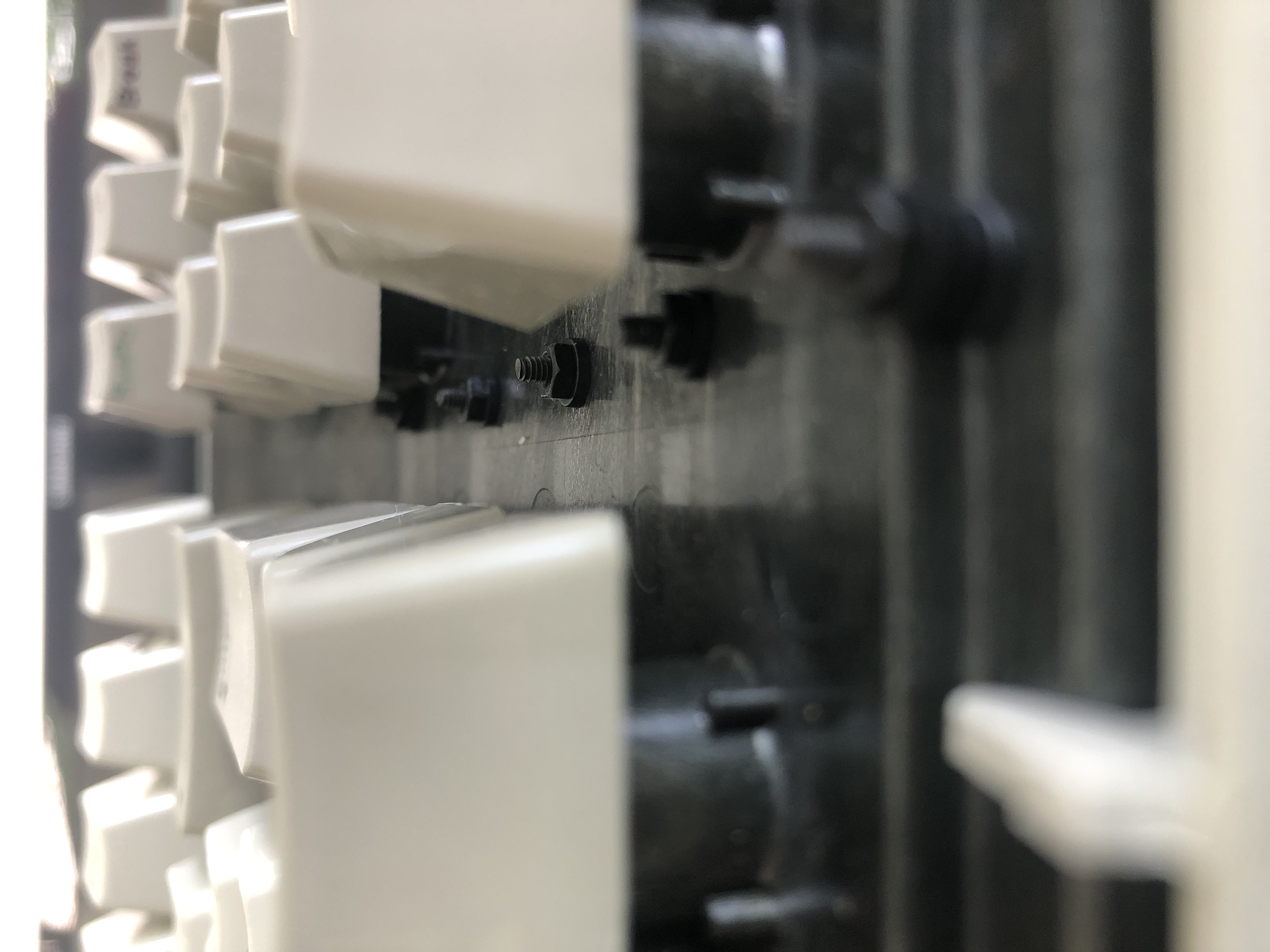

Finally, I'm done. It took a little while to get the hardware, but now it is completed.
As those who had the washer and nut on the metal side used 8 mm screws, I thought that 12 mm would be good. And for a while it looked good. However, I realised that some keys could not be pressed all the way down, because the bottom of the keycap hit the top of the screw. At first I tried to shorten the screws, but that took some time with the Dremel and it felt as the screws might get too hot and melt the plastic (?). Therefore I decided to put a washer on the metal side as well. This meant that the order became screw, washer, metal plate, rubber mat, plastic circuit x 3, barrel frame, washer and nut. With this solution the screw got seated better, since the predrilled holes were a bit big for the head of av 2 mm screw.
At least it looked good, and I reached the golden ratio (almost at least) that the visible part of the screw should be equal to the height of the washer and the nut.

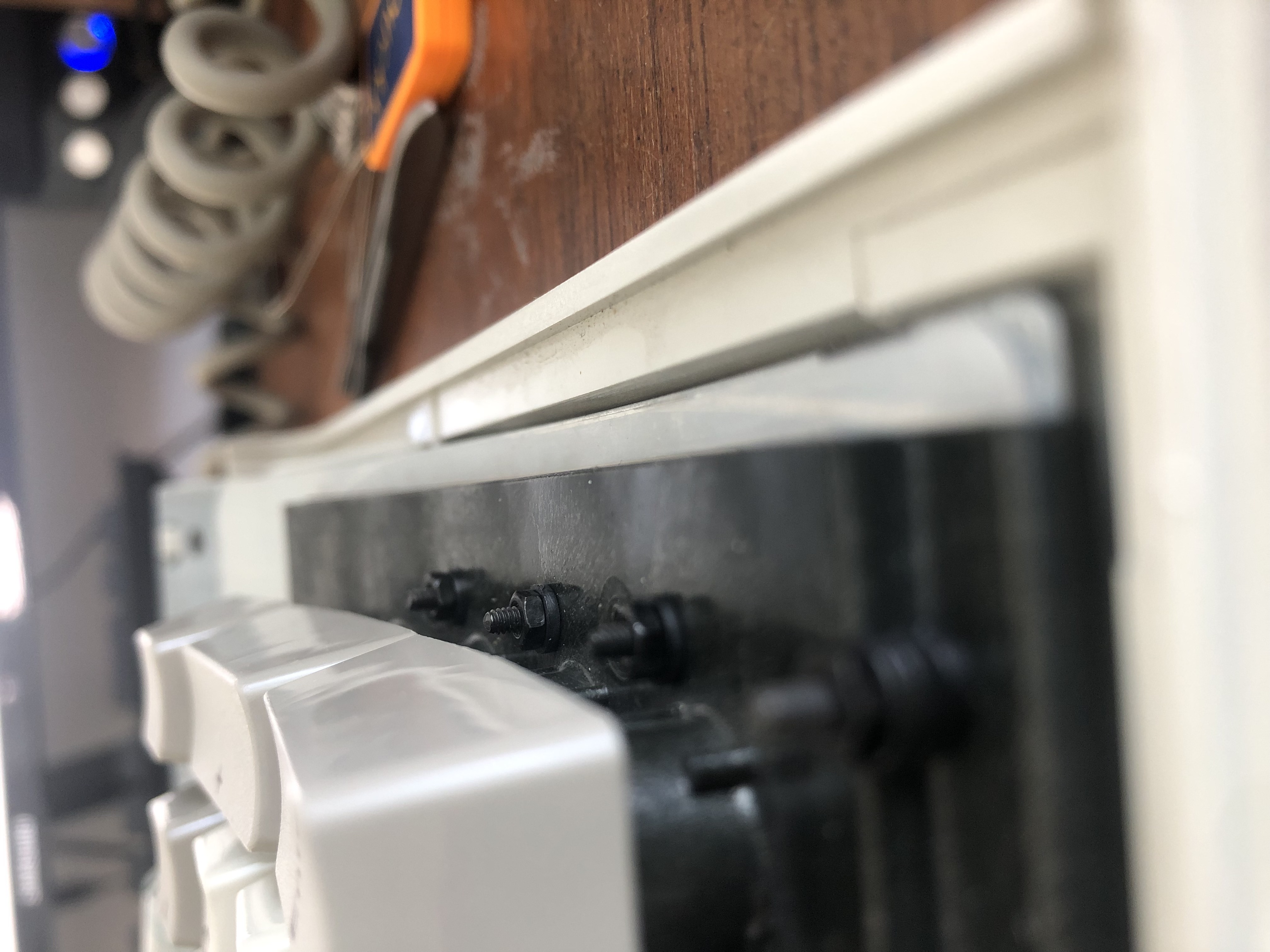

For the lowest row I had some problems too, because the drilled holes came up some millimeter on the wrong side. So in order to make it a decent connection, I took some washers and cut them in half and used that as a support. Not the best soultion, but good enough. For this row I did not use washers on the metal side, since the space was minimal.
See pictures for some examples (this post typed on the board itself).
The lowest row.
The lowest row.
