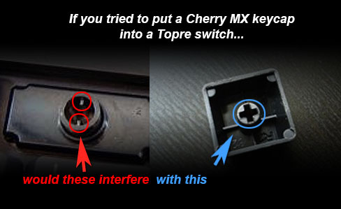

I don't have a Realforce board to experiment with, so I have to ask the gurus here:
If you try to stick an MX keycap onto a standard Topre stem, the vertical groove guides inside the plunger form an obstacle to the little cylindrical stem mount with the female cross inside the keycap, preventing it from resting fully inside the Topre slider, correct?

Okay, I'm gonna try asking this with a picture...
002
Topre Enthusiast
04 Sep 2015, 00:08
Yes...that's why people are making their own custom MX sliders for Topre switch housings.
zslane
04 Sep 2015, 00:21
That's what I figured; I just wanted to be sure.
