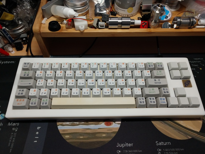

raoulduke-esq wrote: 09 Aug 2021, 14:07 A complicated Alps clone? That would be a dream come true.
I am a bit afraid of the complexity of the contact plate. I am not sure if it can be reproduced on a semi-industrial scale. On the other hand, it would probably be easy to reproduce the skcm top/bottom housings and the slider. Maybe it is worth to start there and see how far we can get.

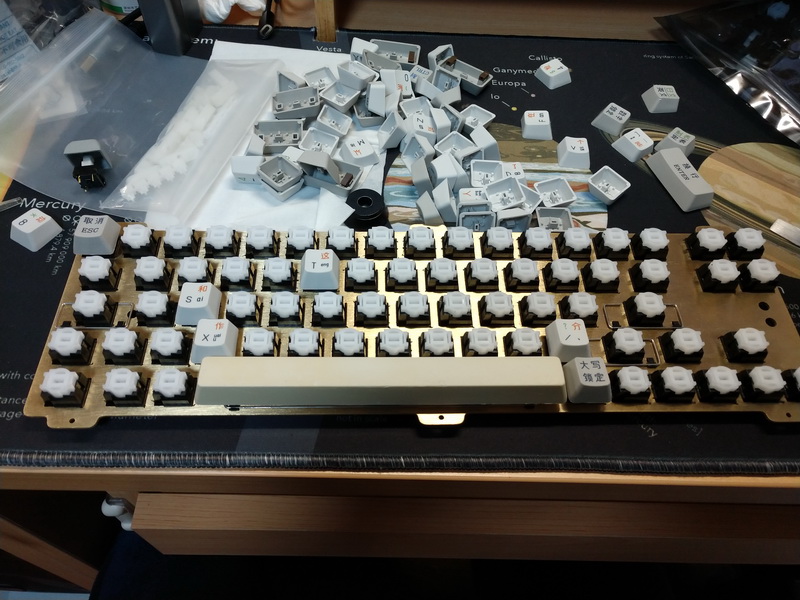

morbid42
04 Oct 2021, 15:22
Wonder if I can purchas some of your awsome keycaps :D , cause I can made the whole keyboard except for the keycaps.

morbid42
05 Oct 2021, 10:49
timw4mail wrote: 04 Oct 2021, 15:26 What's with the tape on the spacebars?
:D to stop the ABS spacebar form yellowing

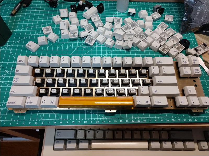

I got some interesting comments for my keycap manufacturing video. A lot of people suggested to use a 3d printer for the keycaps. Actually, I did some experiments with 3d printing in the early prototyping phase. My first idea was to use resin casting in conjunction with 3d printing and I made several 3d-printed bases to make the moulds. Also, I have experimented with 3d-printed inserts. The results looked like this:
Definitely usable but the surface was too rough. Also, the edges of the inserts were not sharp enough so the letters look fuzzy. Interestingly, the keycap on the left was originally in French blue. The pigment was not UV-stable and now it looks like something forgotten at a public men's room. :lol:
The original bases were 3d-printed from Nylon on a commercial-grade 60-micron SLS printer and it has been a few years ago. I think that with the modern SLA printers with monochrome displays one can get better results but I am not sure if such printers are a good choice for making bases because the printed models are usually brittle (removing the cured silicone from the base requires some force).
My initial bases were inspired by the :~$YNTH system:
The next logical step was to abandon the 3d printed bases and use machined bases . At this point I still thought that the 3d-printed inserts were the way to go. This was definitely an improvement—the surface of the keycaps was smooth but the legend was still fuzzy:
The trouble with 3d-printed inserts is that the legend was not aligned with the top of the keycap dish because of the printing precision and material properties. Since the polyurethane precursors have a very low viscosity, the material has a tendency to fill all the tiny holes that result from the misalignment, hence the fuzzy edges.
Another trouble with 3d printers in general is the part orientation. Depending on the machine and material, orientation of the insert in the printer may have a drastic impact of the sharpness and thickness of the edges. For instance:
These two were created using the same insert that I made to test the line thickness. The lines on the left are thicker even though the insert model is the same as in the previous case. It actually came from the following insert set that was all printed at once:
Not much later after these experiments I came with the idea of machining the legend bases from polyurethane copies of the original bases. This in theory ensures the best alignment with the keycap dishes and is closer to the classic two-shot moulding.
Finally, one more photo from the tough beginnings:
Yes, polyurethane does stick to untreated aluminium. There went my 250€ investment. :lol:

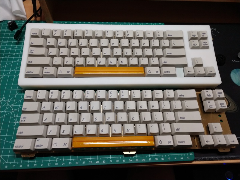

lispnick
15 Dec 2021, 23:50
Recently, I have made some beefy stepped keys to replace two 1U keys. This idea came to me when I was asked if I can make the layout more ‘normal’. I did not want to tamper with the mount plate nor the PCB, so making a twin-stem 2U key that occupies the place of two adjacent 1U keys seemed to be the solution. The keys are stepped, of course, because there is no stabilizer wire and an ordinary 2U key would bind when pressed on the edges. The following video shows, among other things, how I make a base for a new keycap. For simplicity, I have used polyurethane instead of aluminium. One step in the video is missing—the bead blasting of the base (the video footage did not turn well).
lispnick
31 Dec 2021, 03:34
Spot the difference:
Detail of the classic bottom-right corner:
Stepped cursor keys:
… and how they are made:
