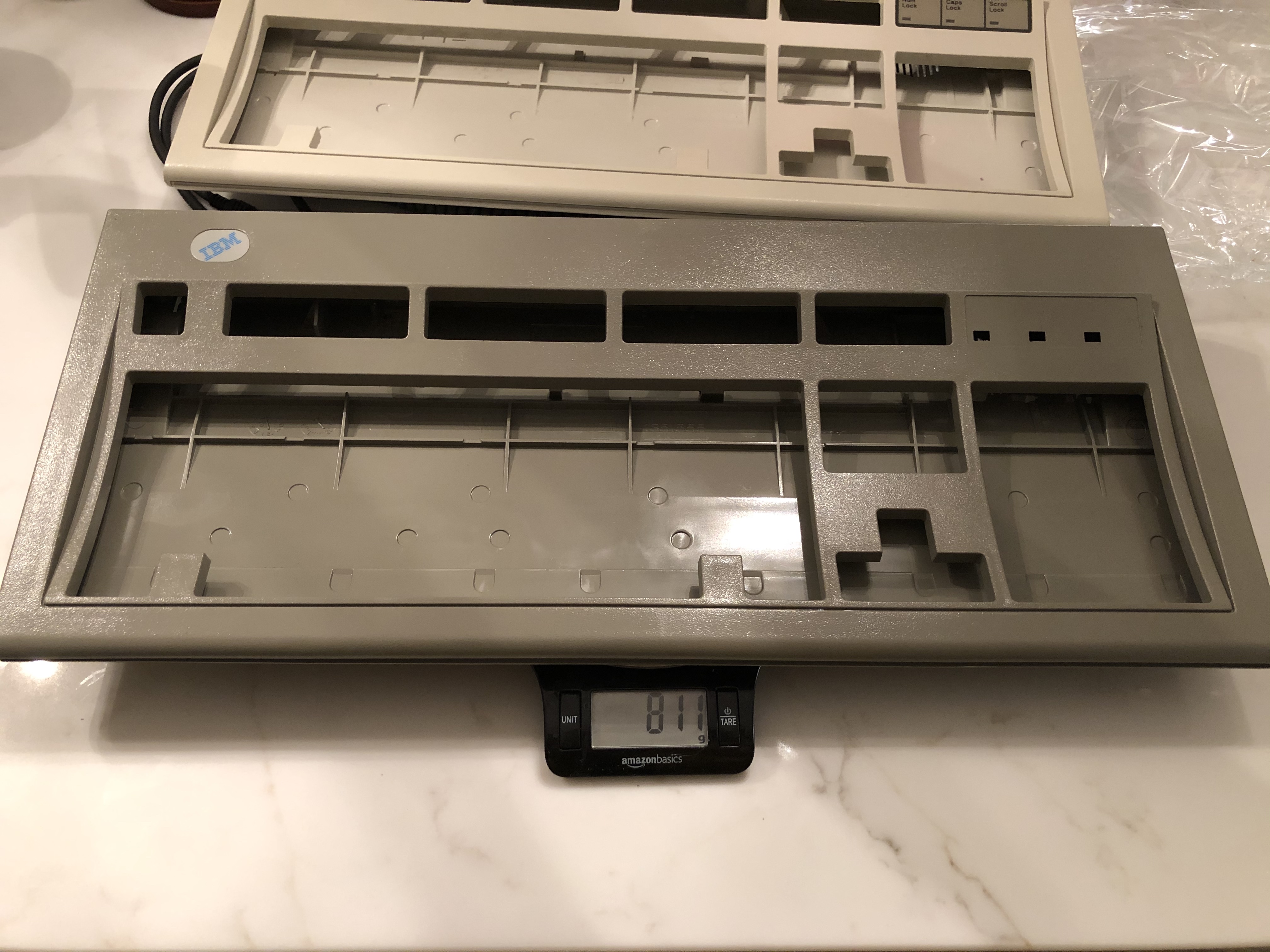

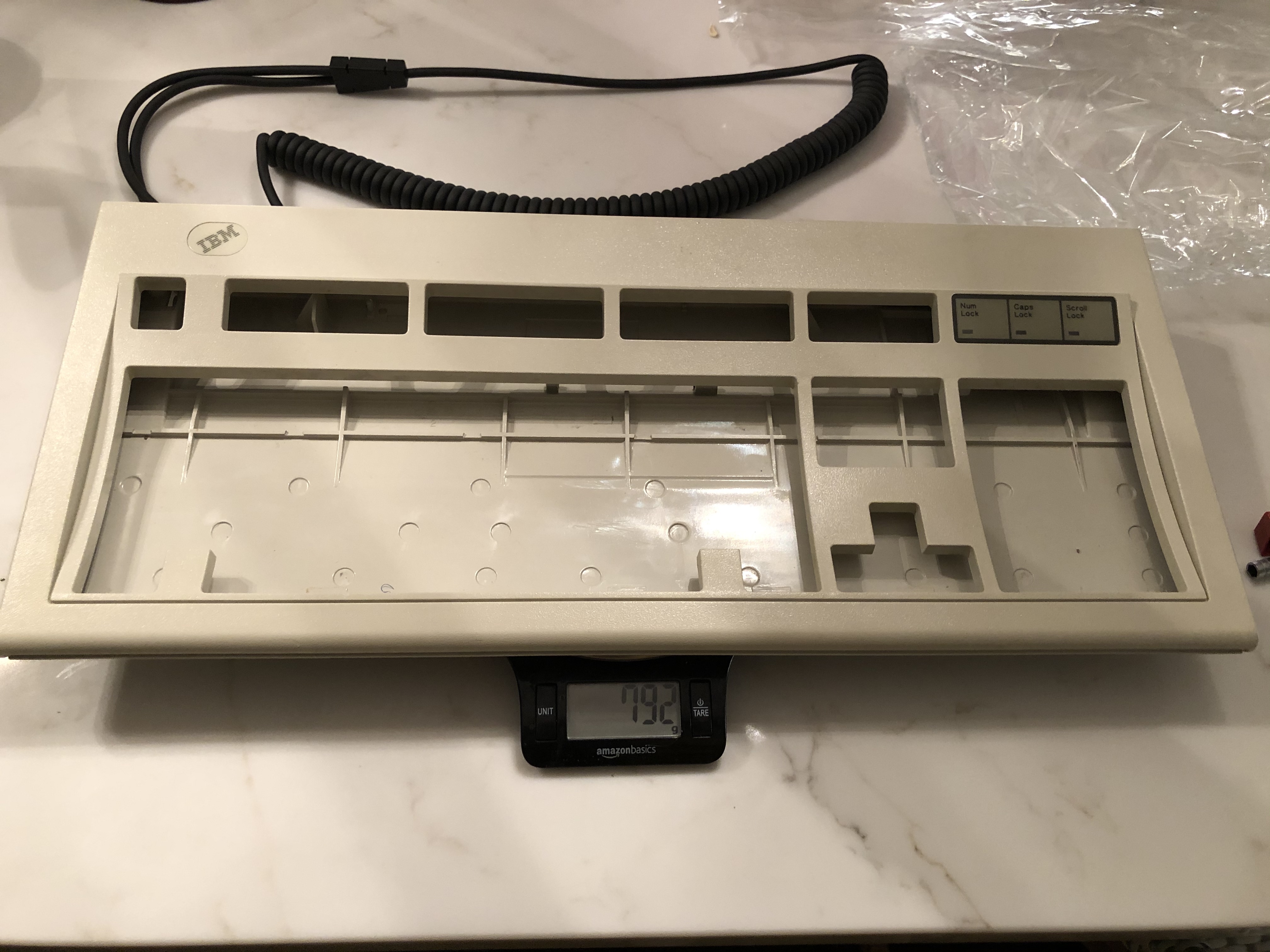

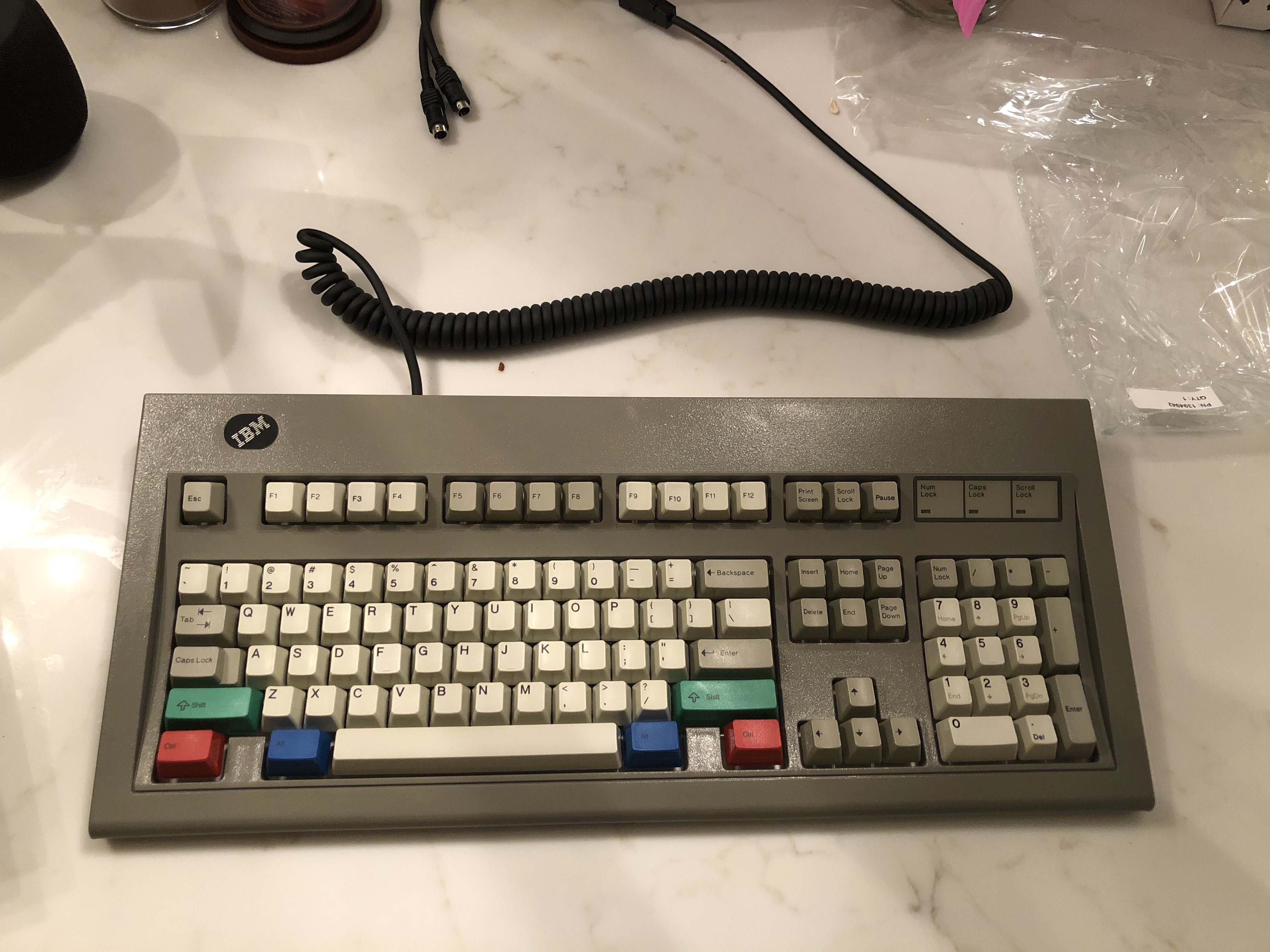

After a bit of procrastination, I’ve finally assembled my “$750” model m for $30. (Any takers? No?)
I have to say, the case looks and feels kick ass, really smooth and shiny. Kind of makes me want to get a nos model m.
For curiosity, I weighed the empty cases. I expected the grey one to be lighter since it’s from the mid to late 90s era presumably when Lexmark began making thinner cases. Either that or it would be much heavier as it’s an industrial.
To my surprise, the grey one was actually heavier, but strangely, hardly by much.
